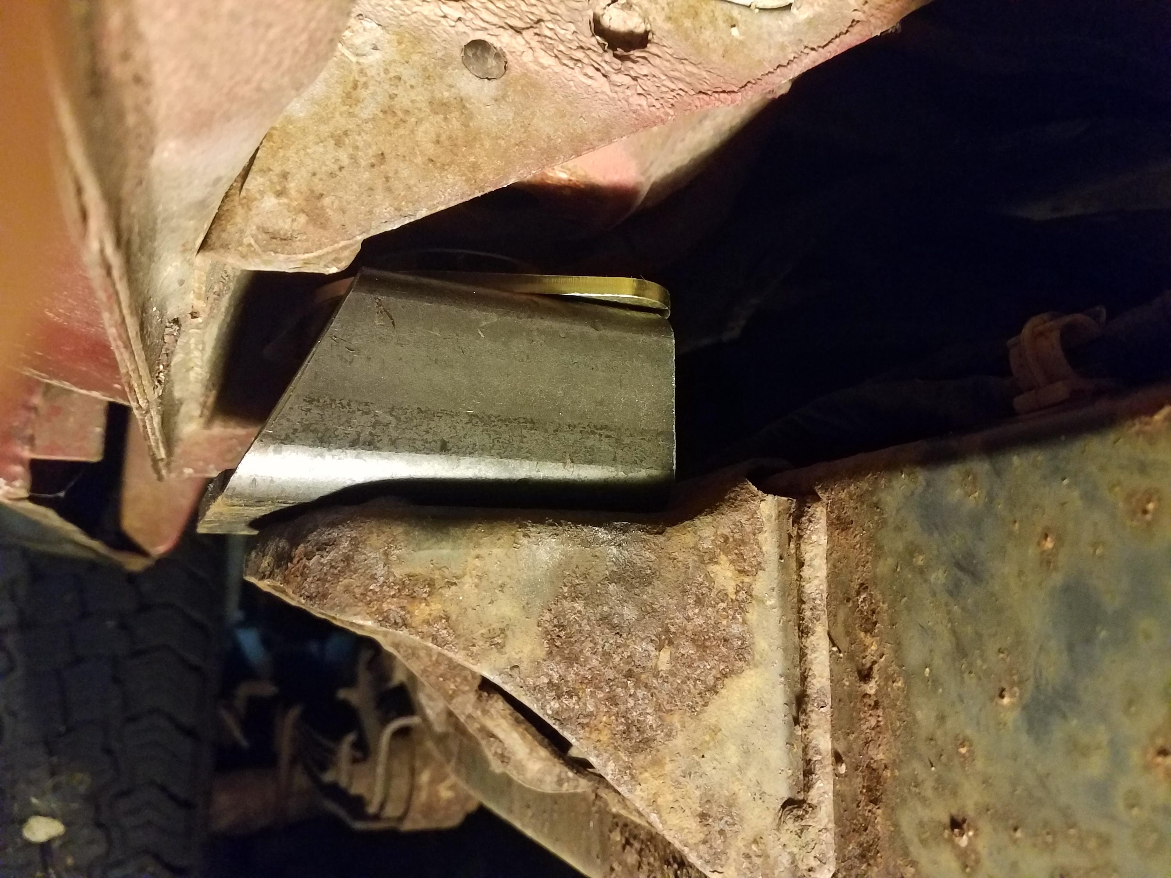

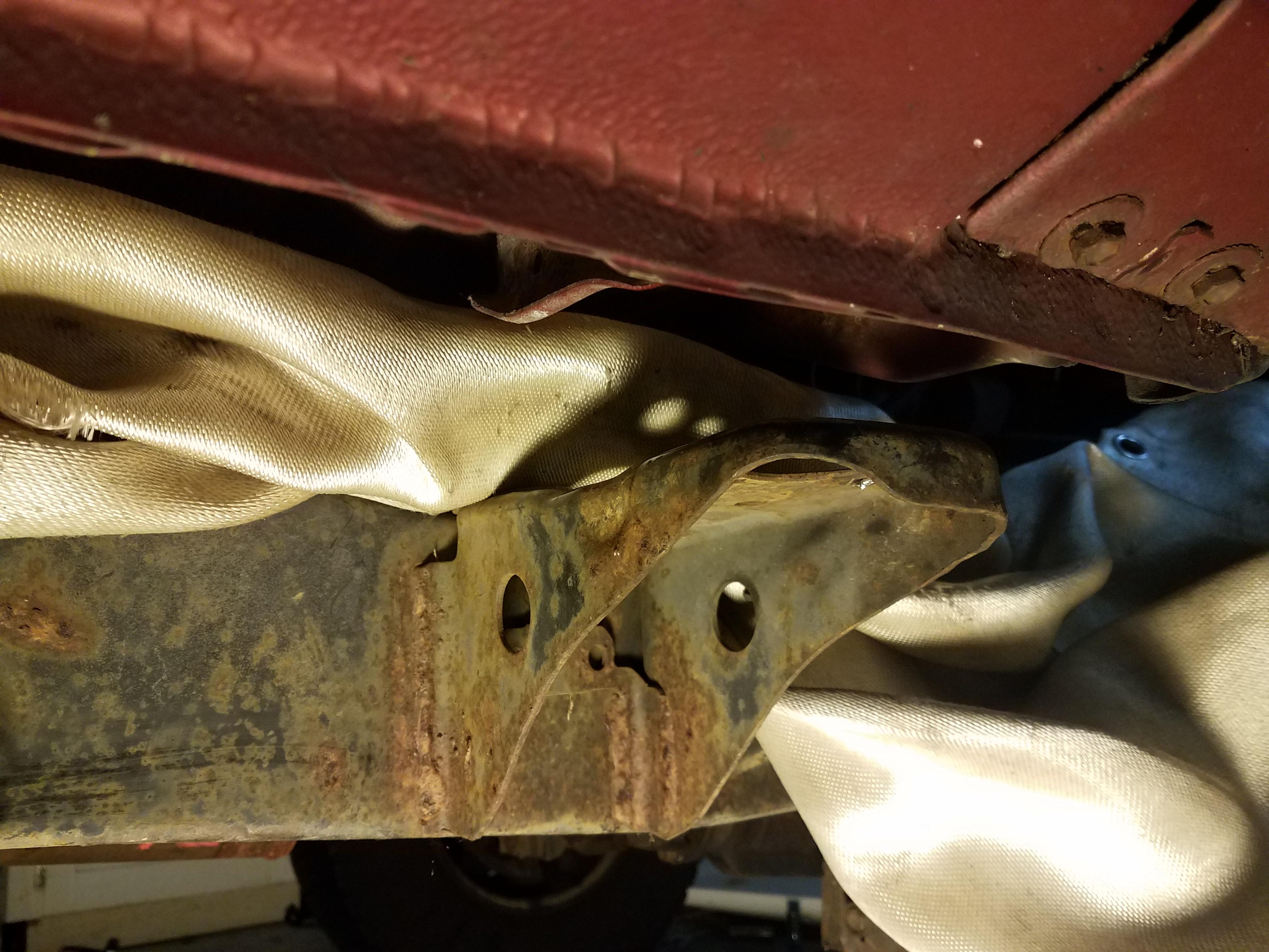

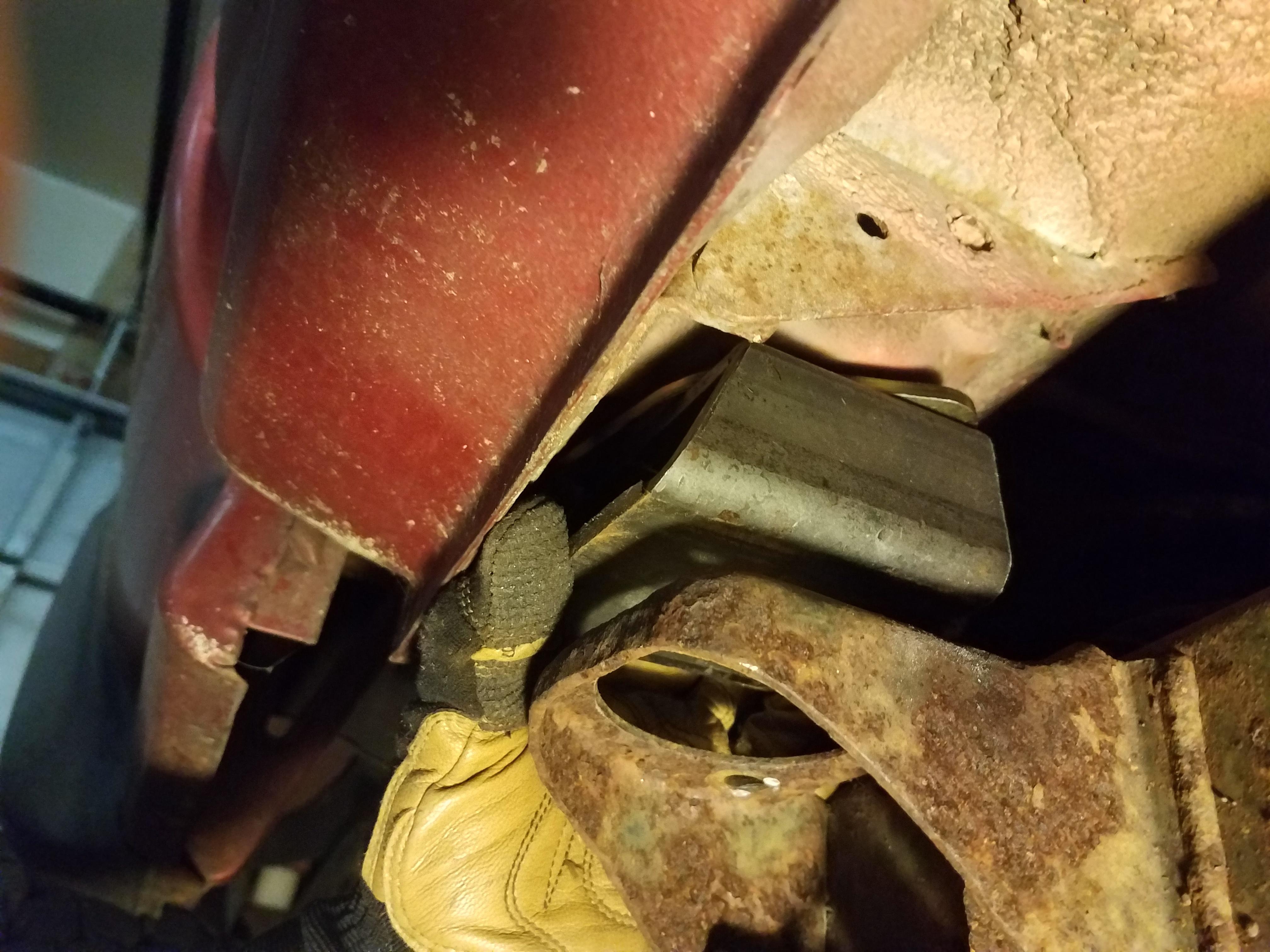

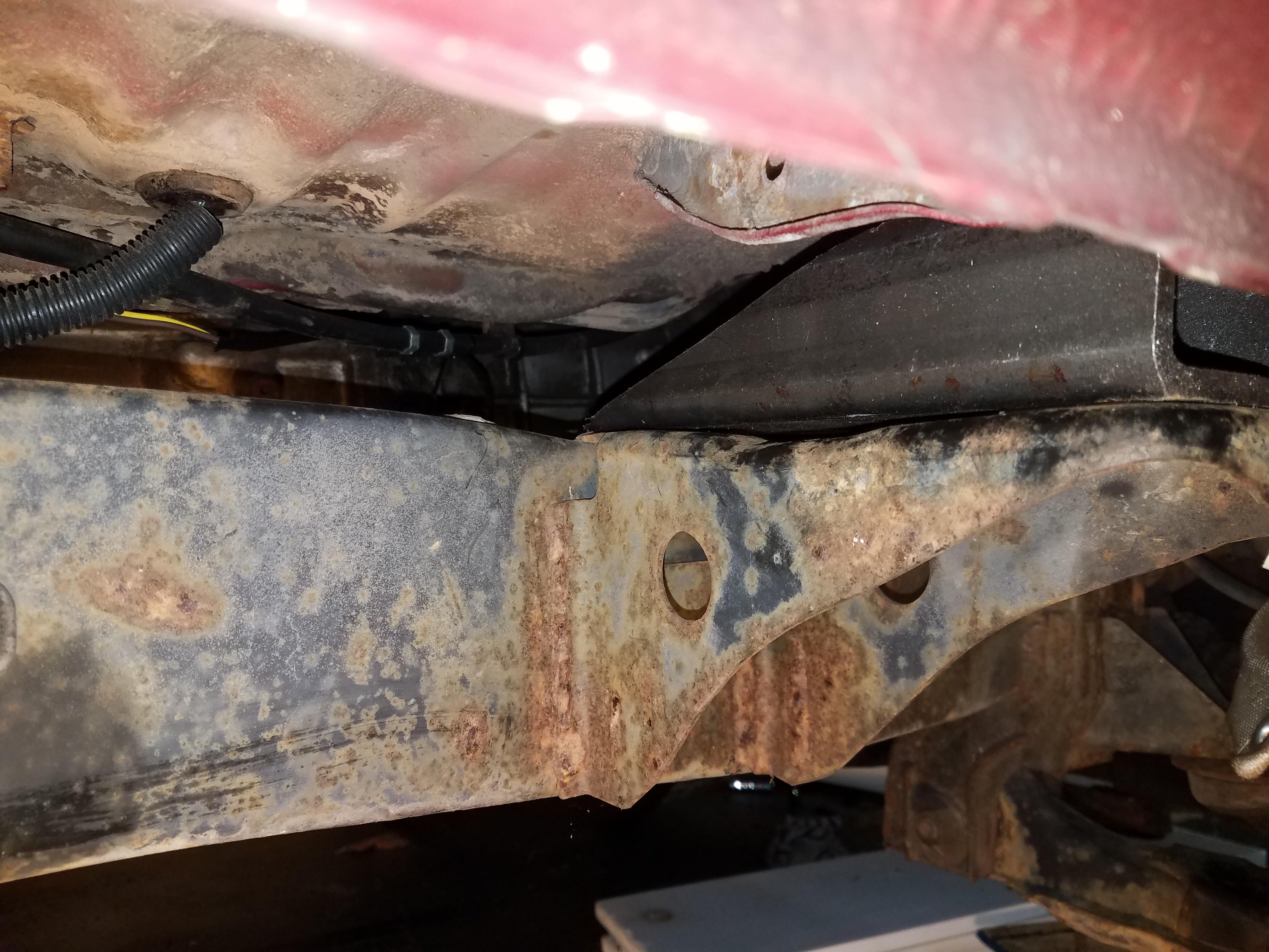

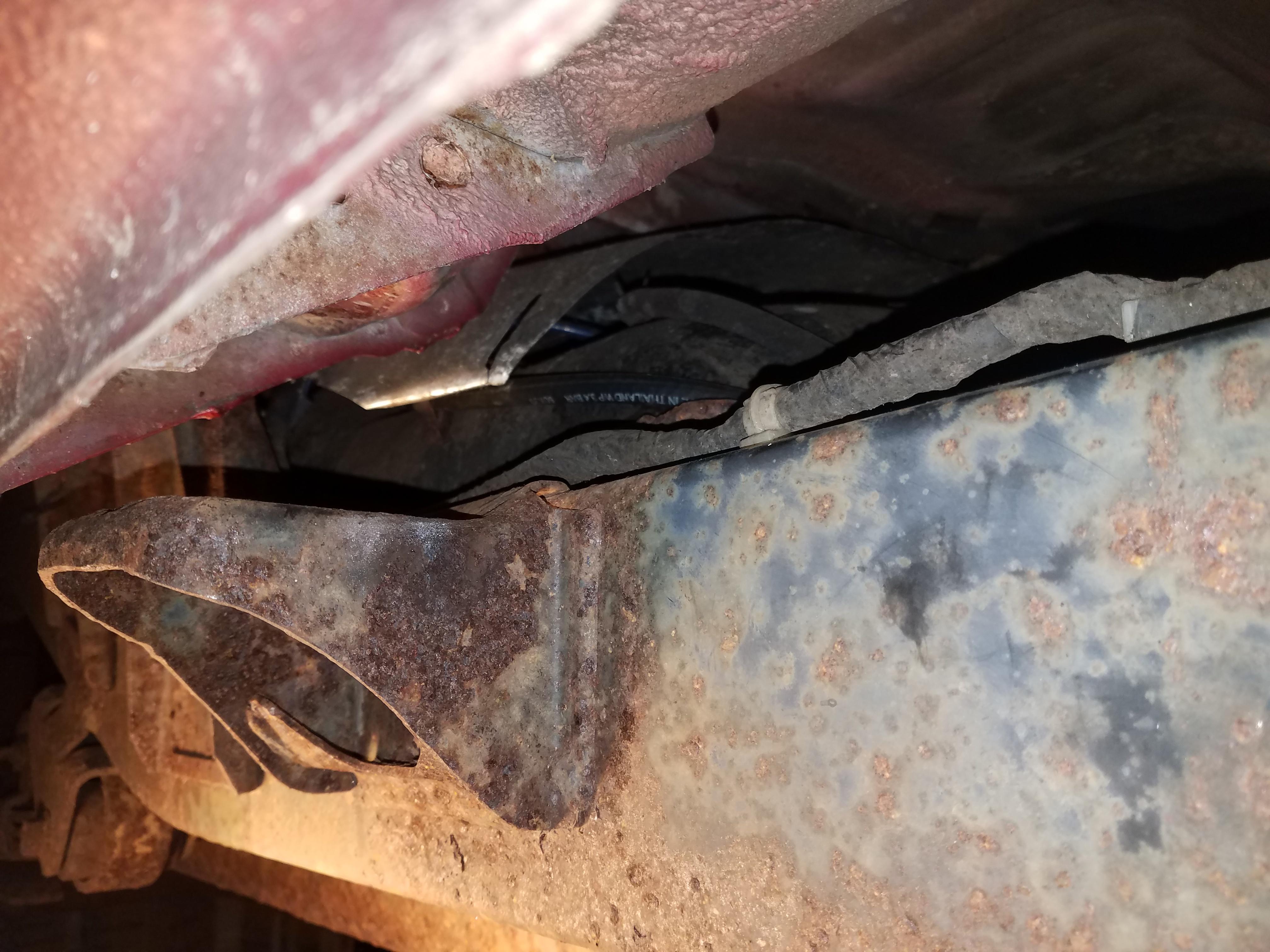

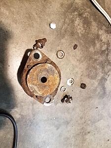

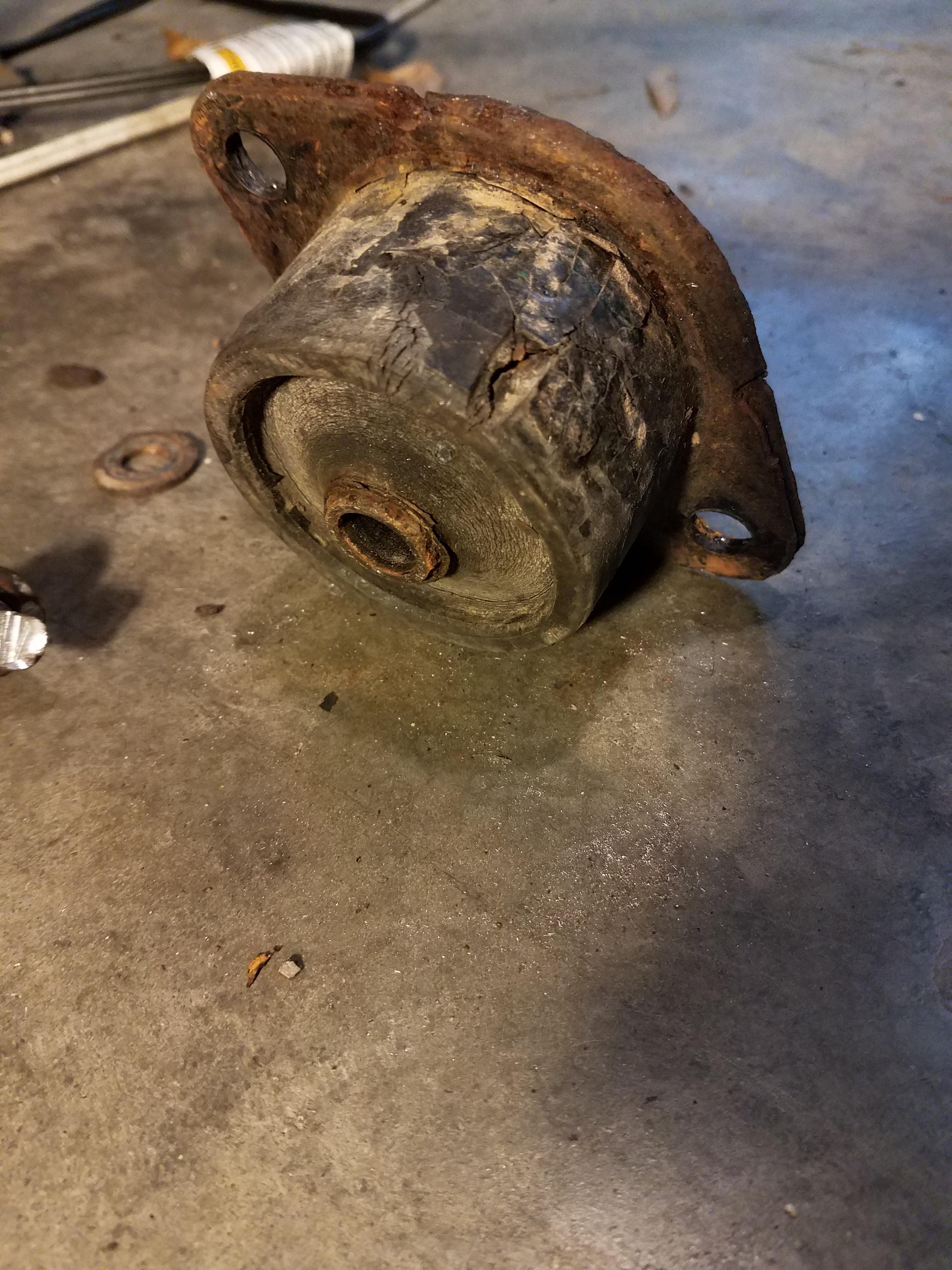

Knocked the passenger side body mounts out today. Captive nuts are a pain, but not as much as oscillating tool blades through bolts. I killed about $40 of blades getting this side off.

Rear out.

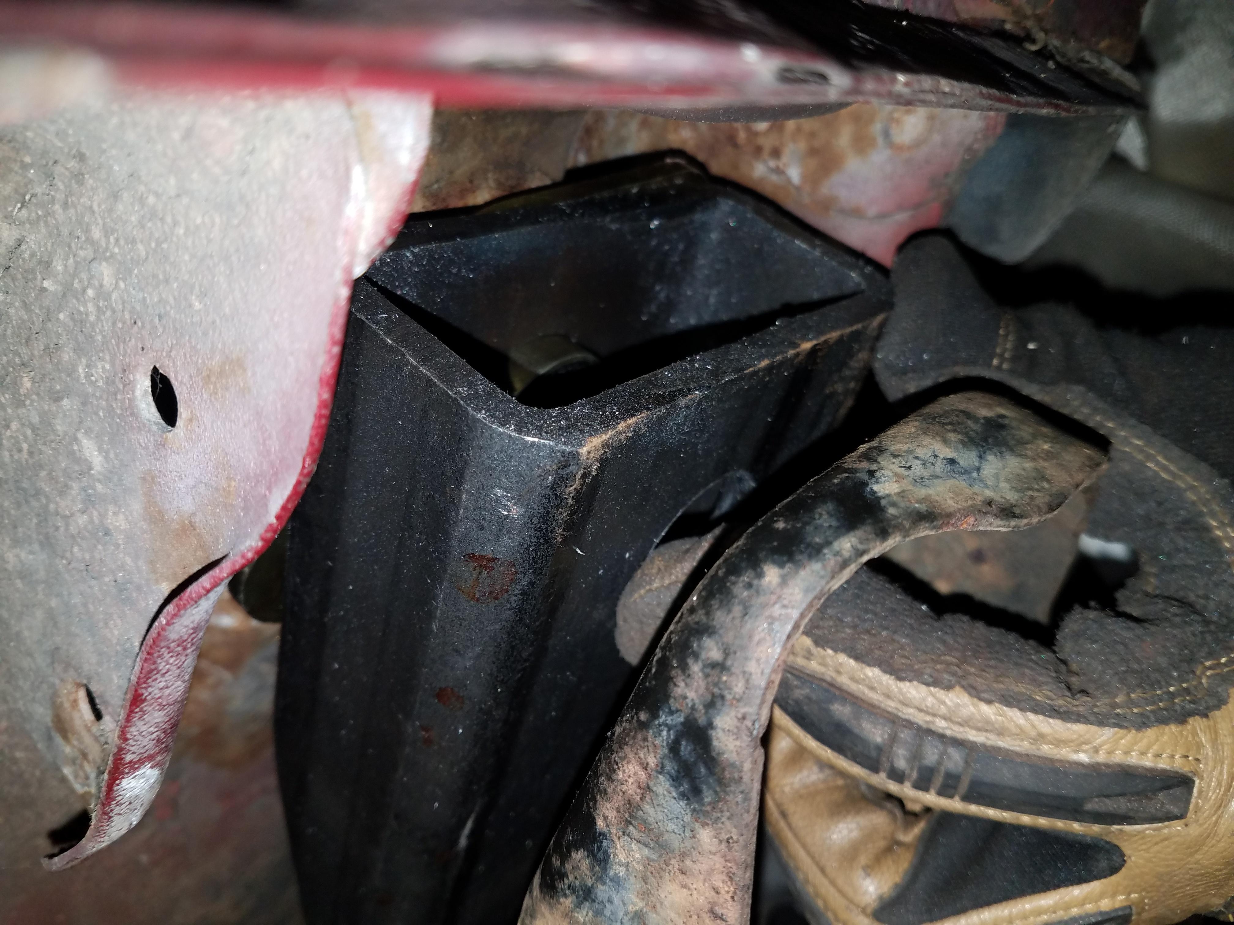

The riser tube hits the inside of the mount... what ever am I to do?
mmm... turn it around! Now it fits nicely.

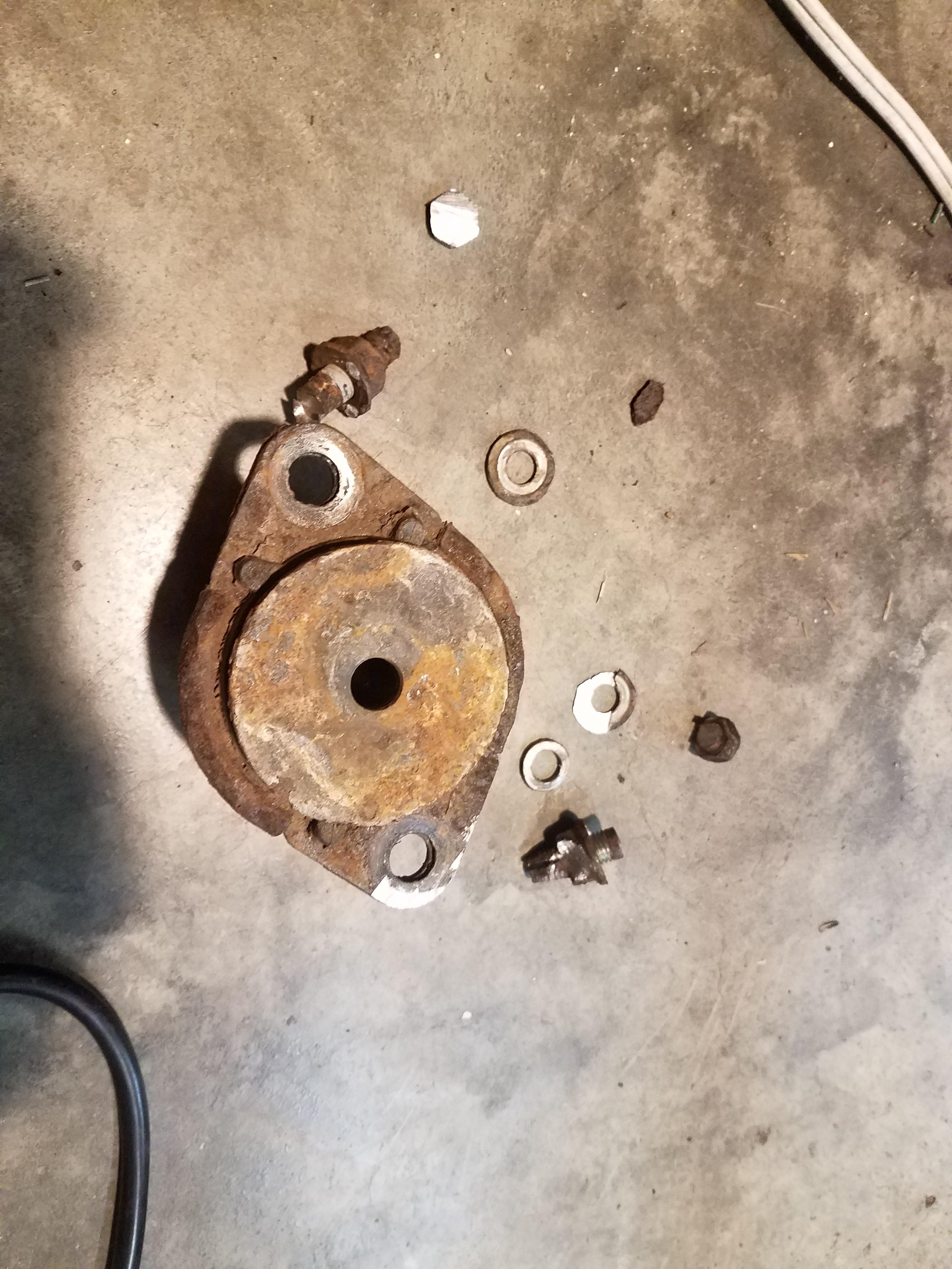

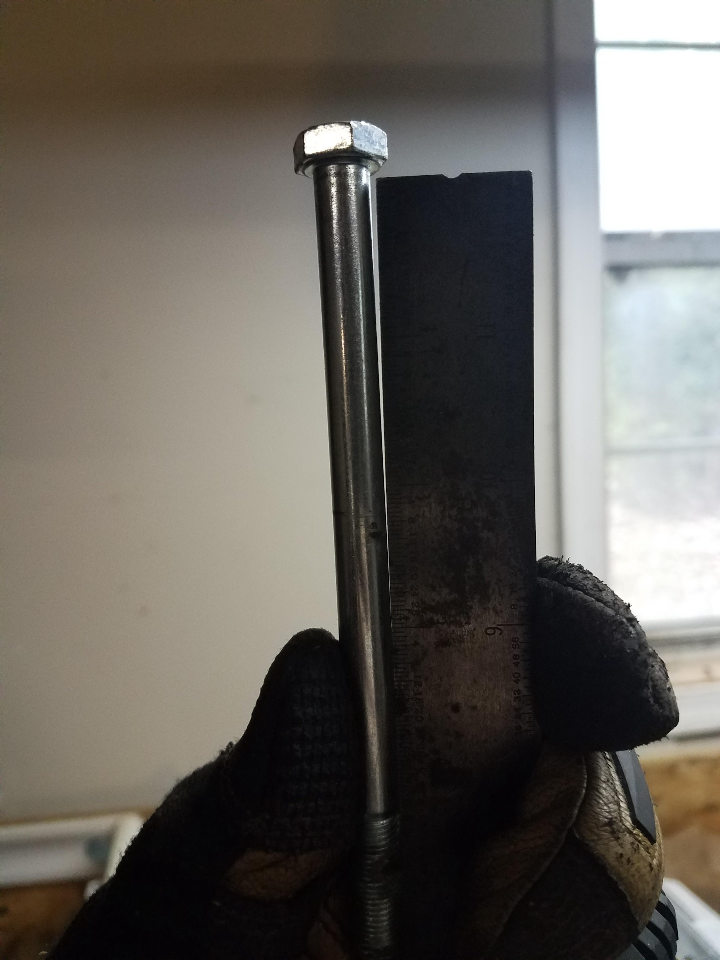

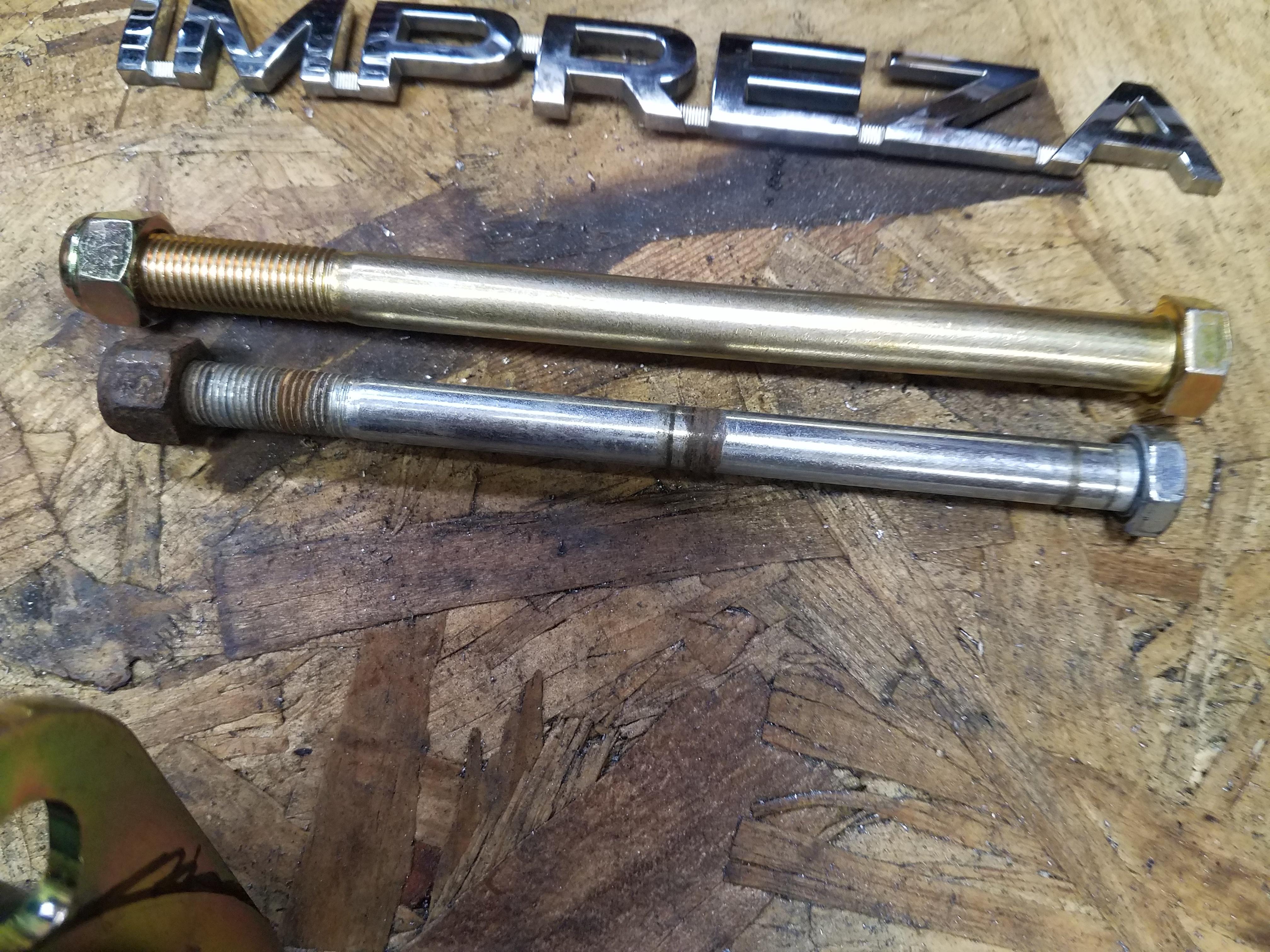

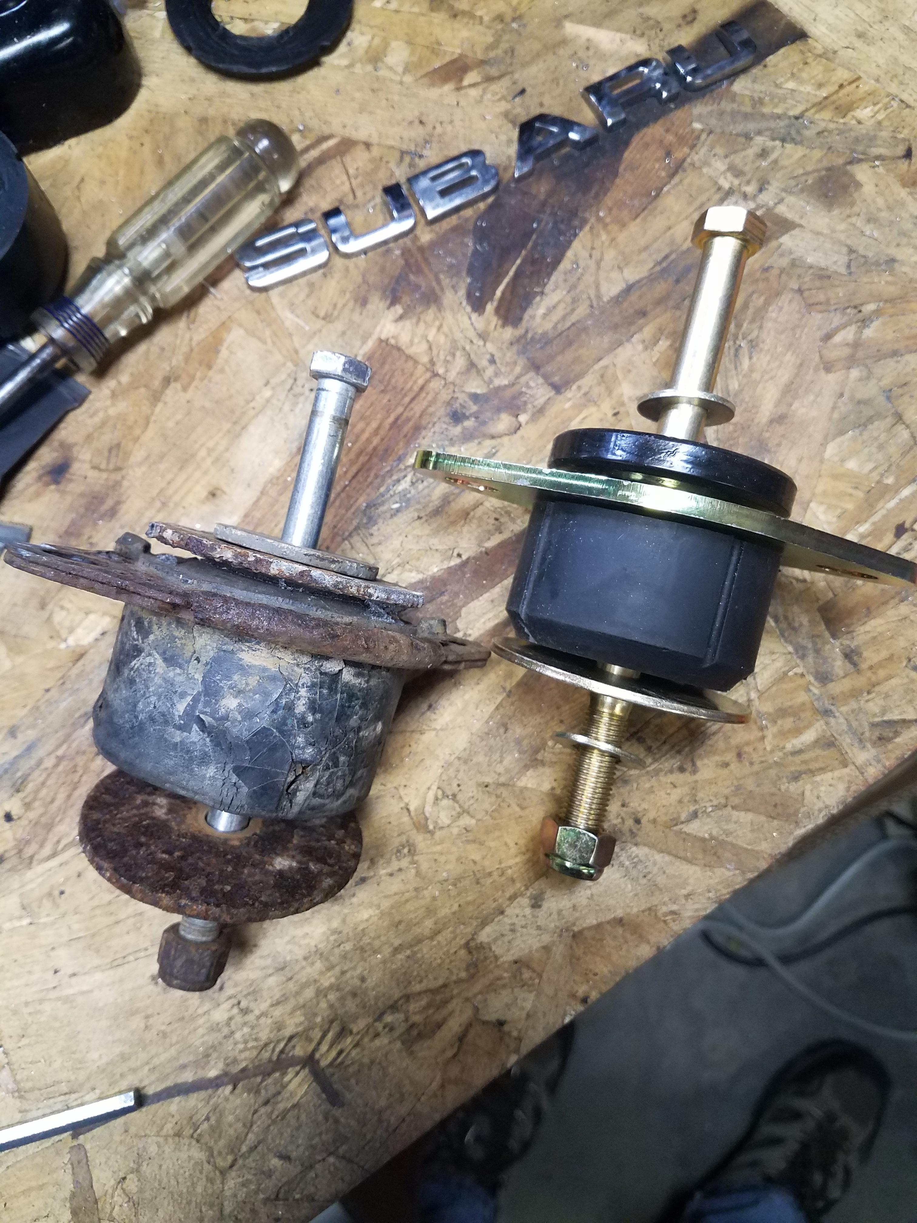

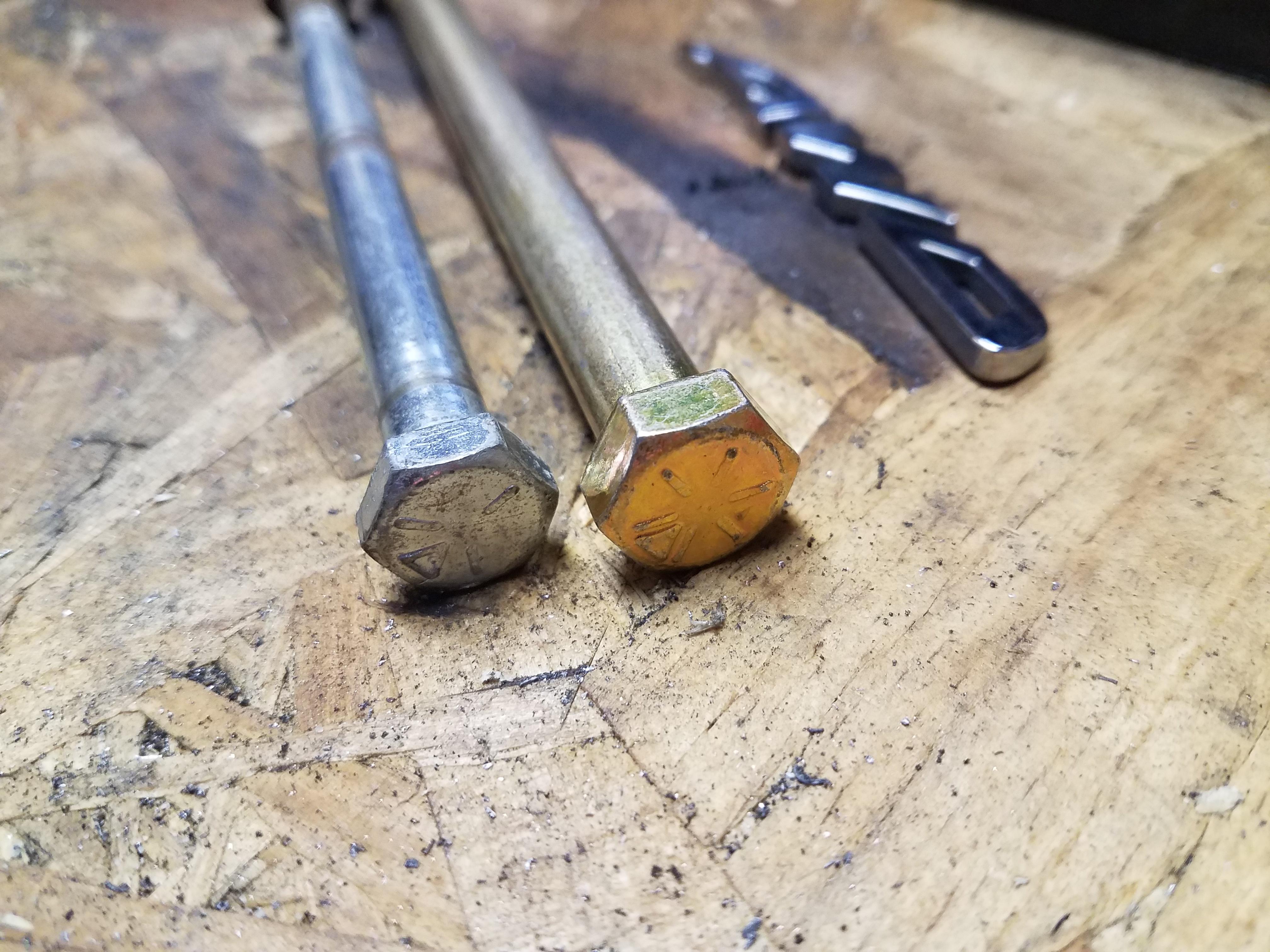

Old vs new. Larger hardware, grade 8. And I'll be using shorter bolts. I got the long ones just in case.
A bit of a bend in the old hardware.

Front off.

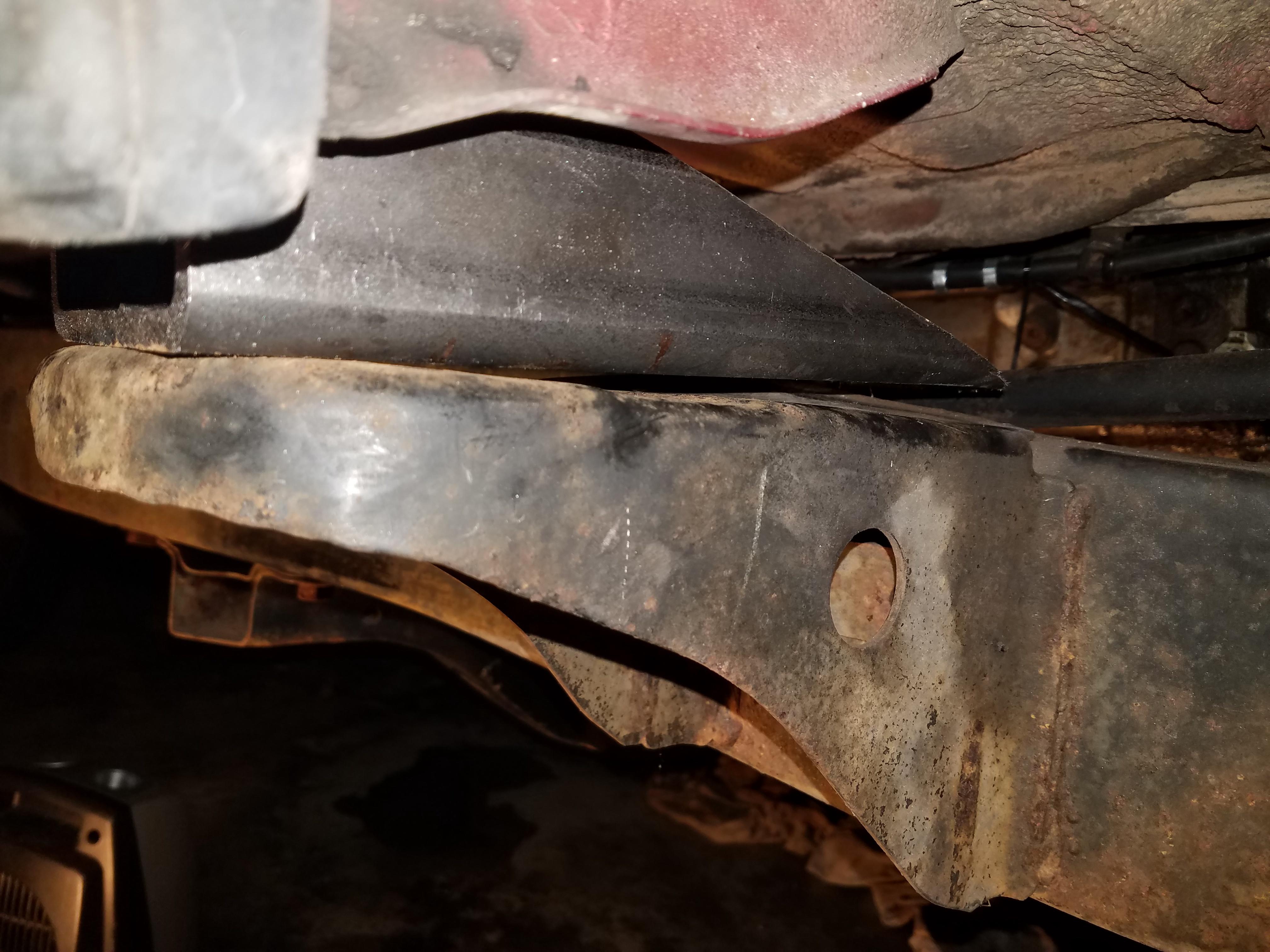

Almost all flat, a little rise in the rear inside.

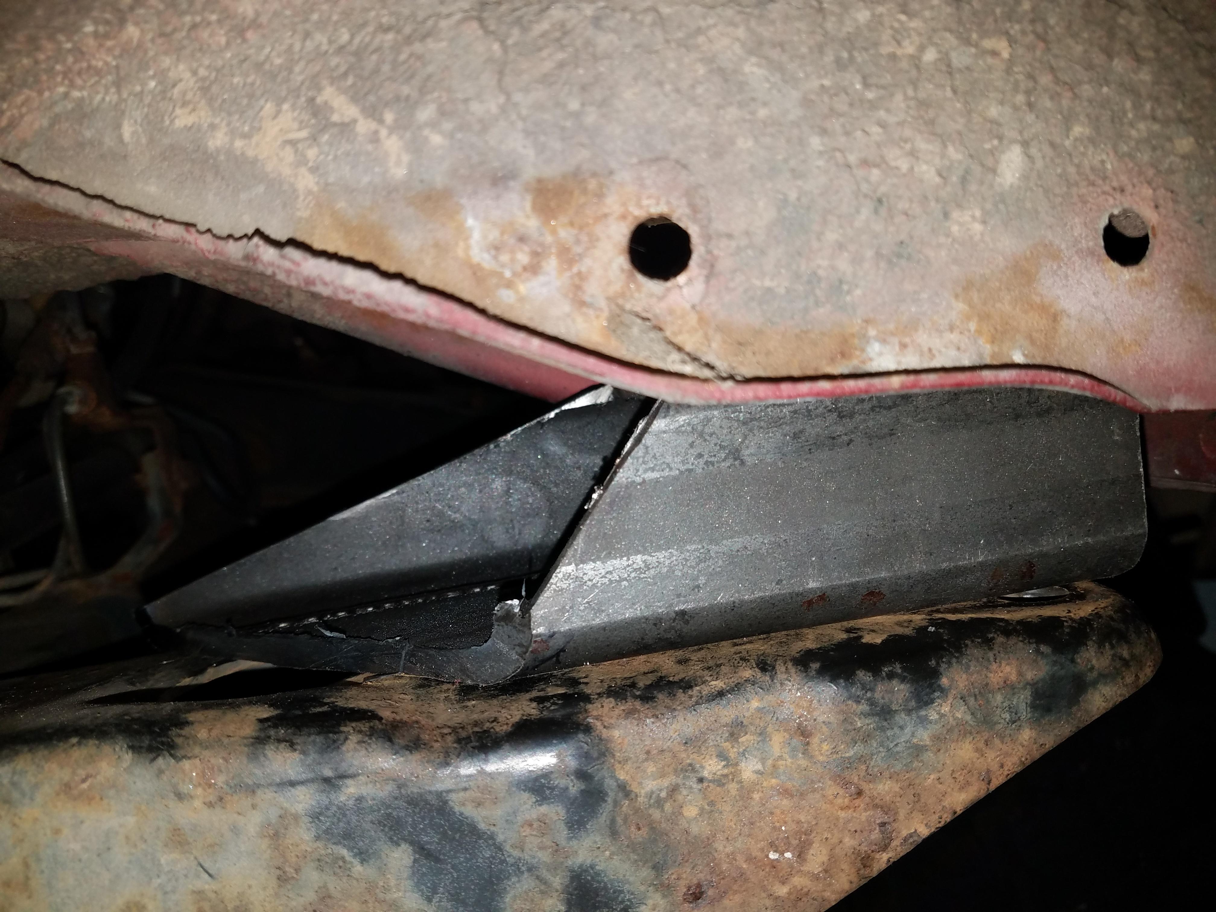

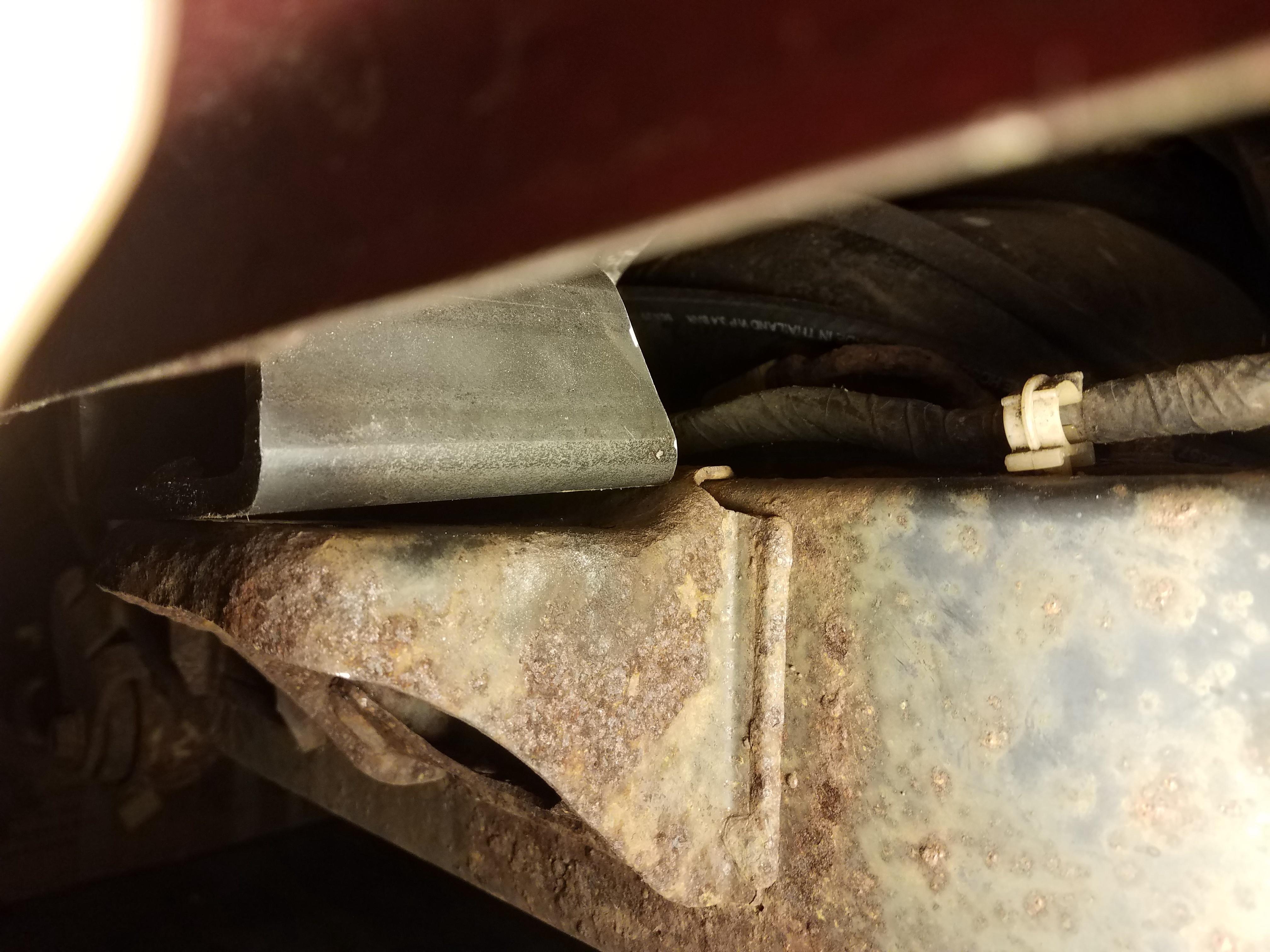

Fits up just fine.

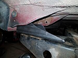

So I need to trim a bit. Once I cut this, I'll trace the outline onto the other side.

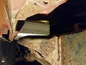

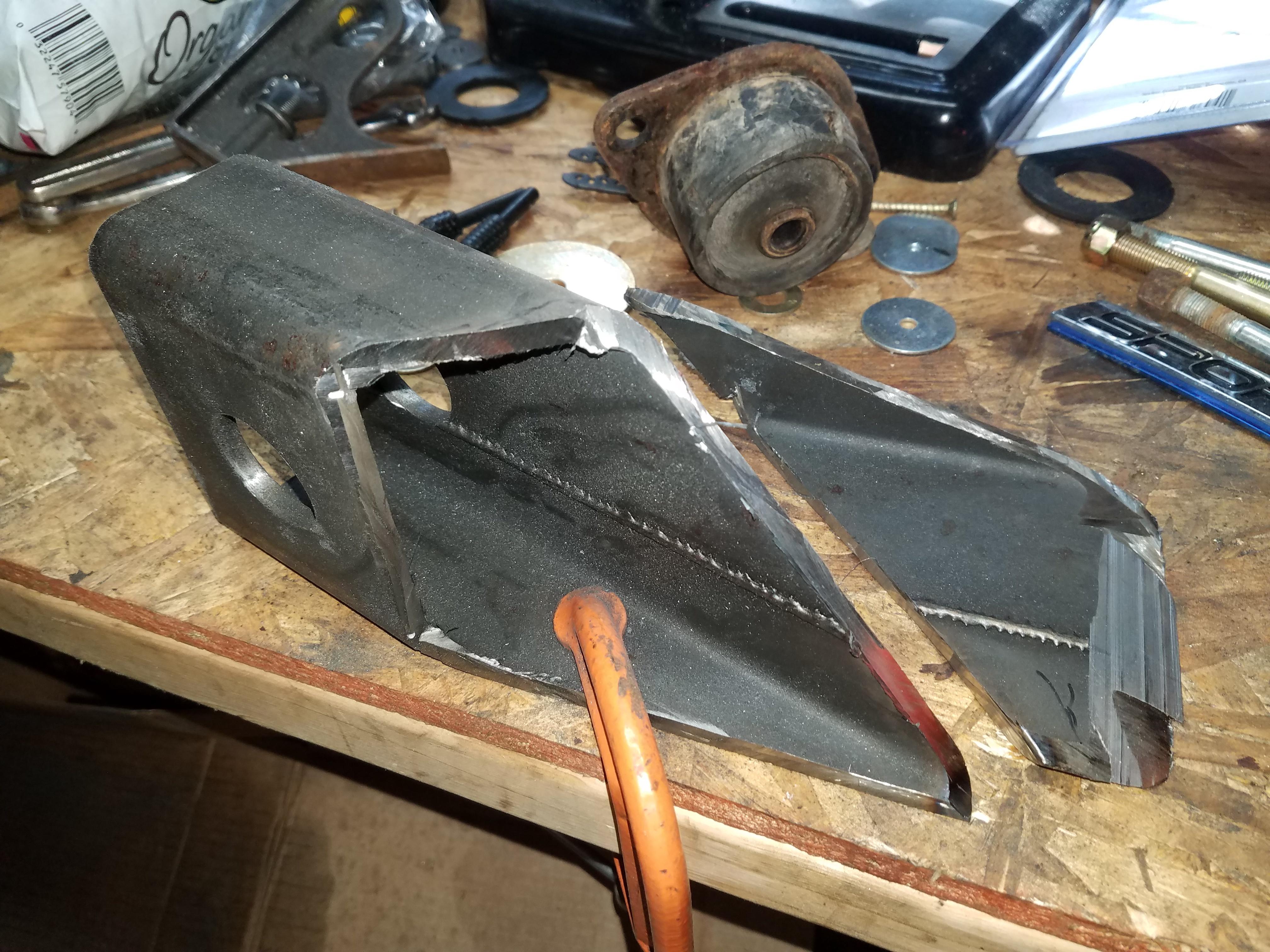

Today I trimmed and test-fit. Everything went well, the trimming fits the front spacers nicely.
And once I knew the mount will fit, I marked and cut out the driver's side.

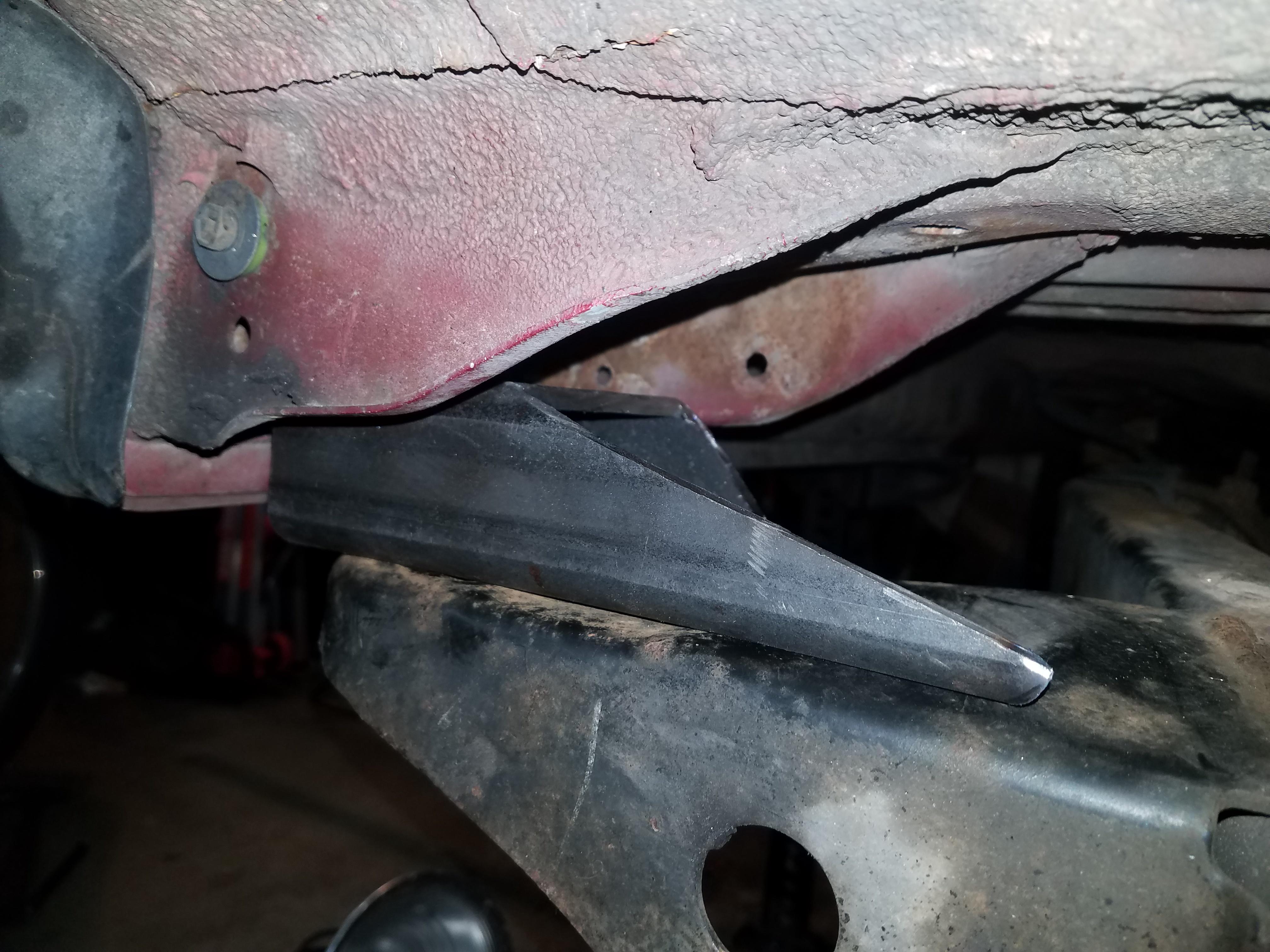

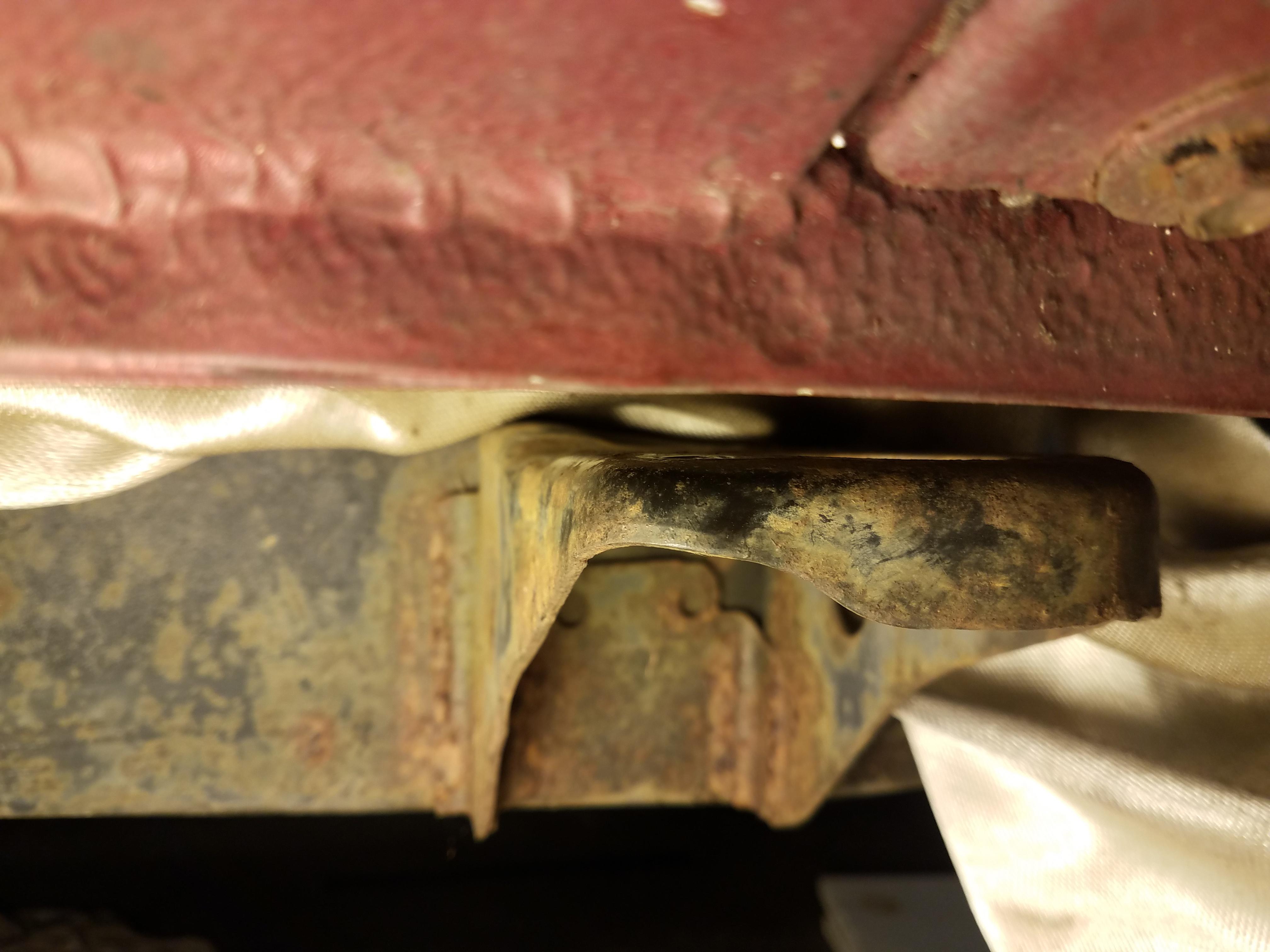

Thanks guys. I kept having doubts about the thickness of metal, but seeing them lined up with the factory perches is good. They are much thicker and fully boxed.

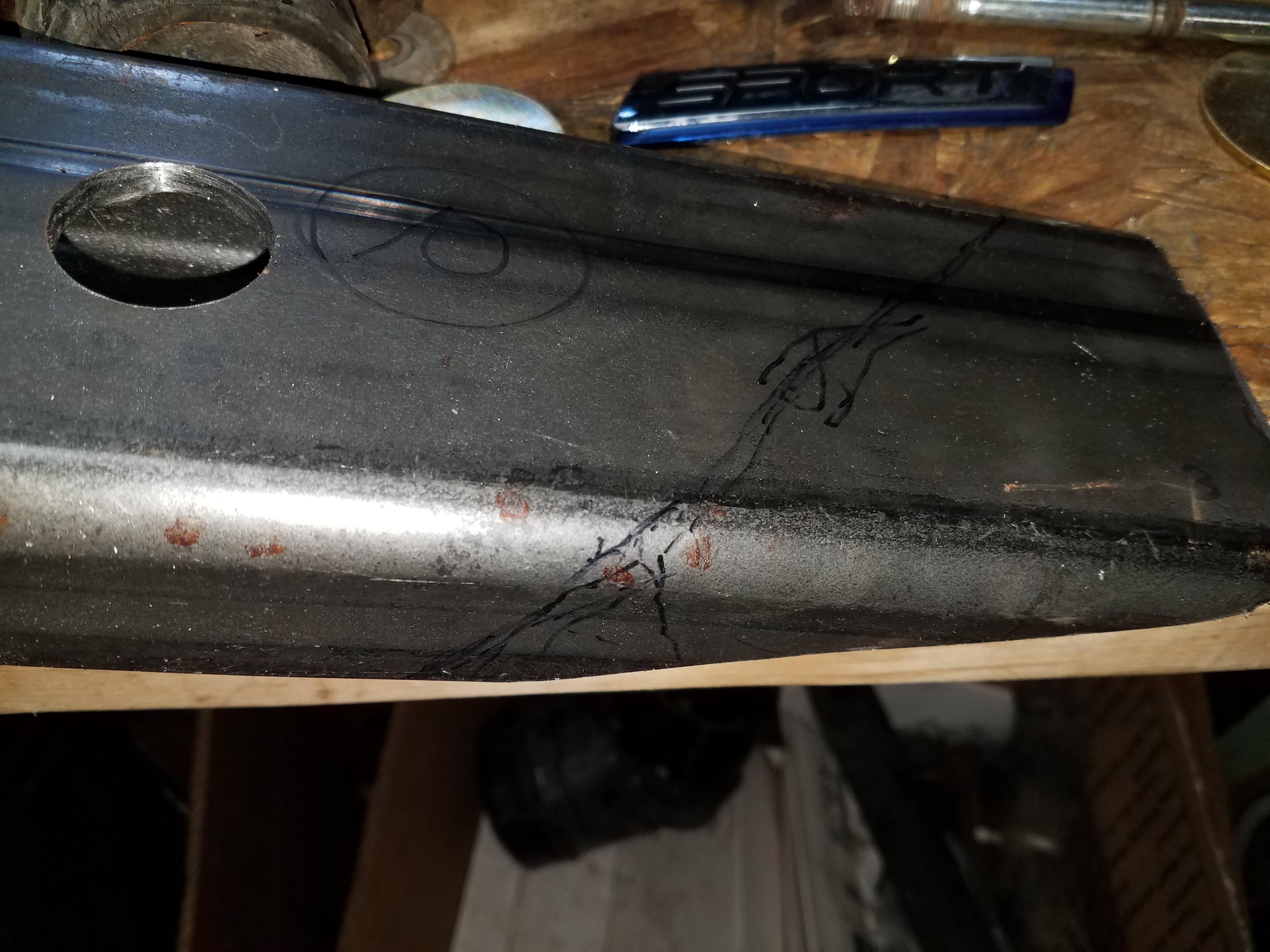

Also, I just noticed the cracking in the bigger body lift as well, same as the front two.

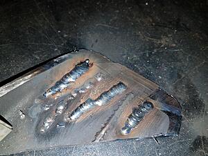

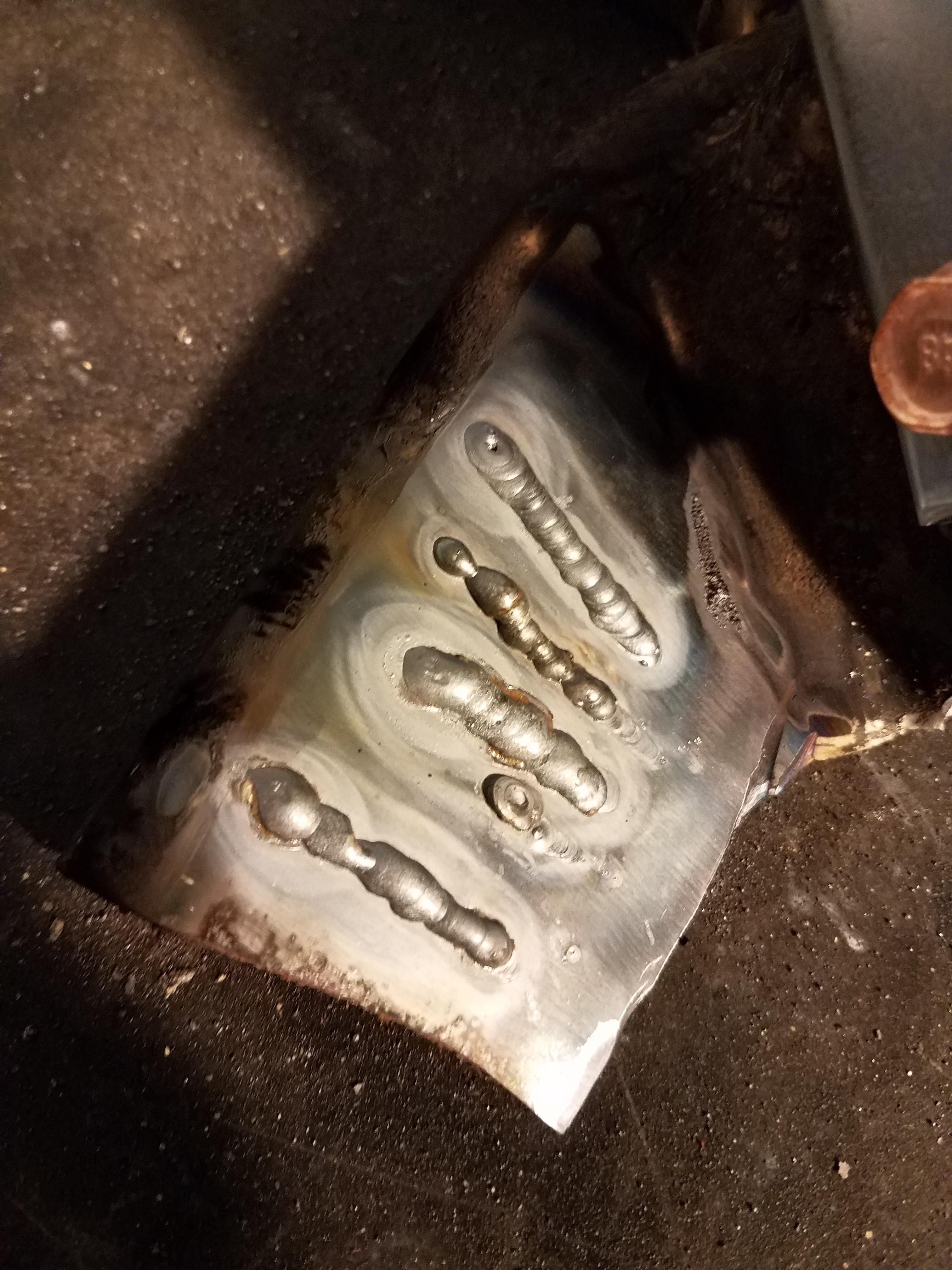

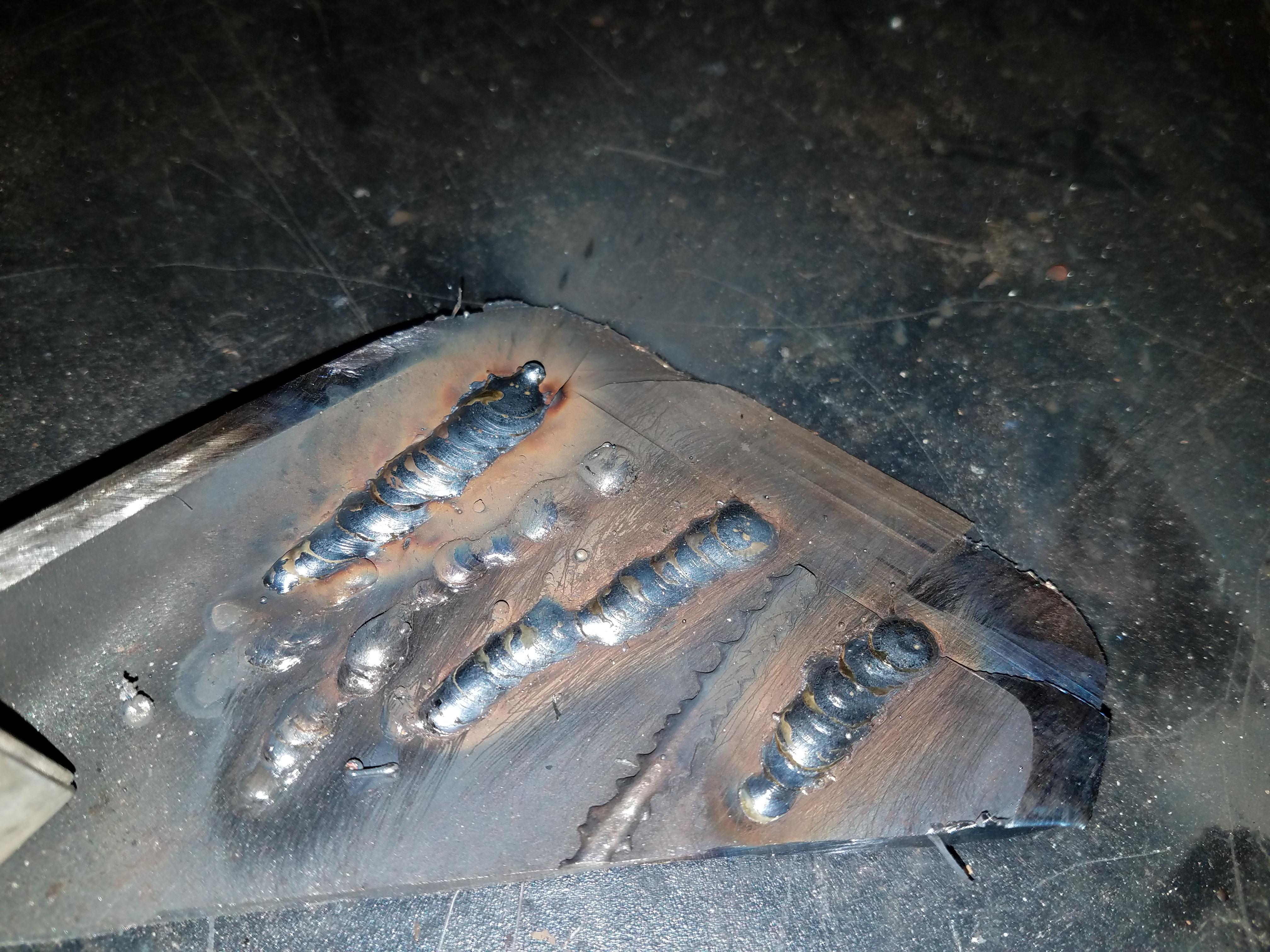

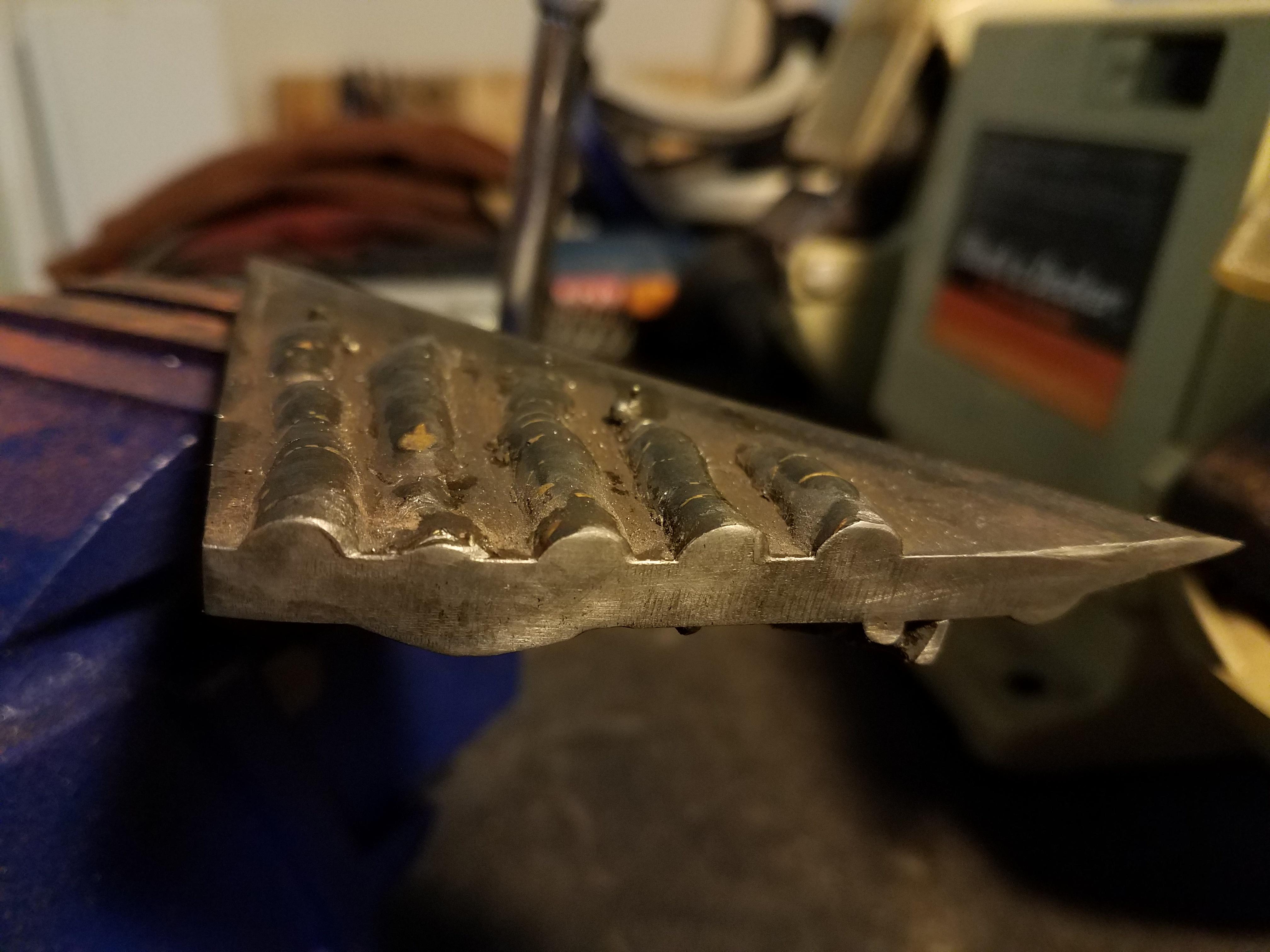

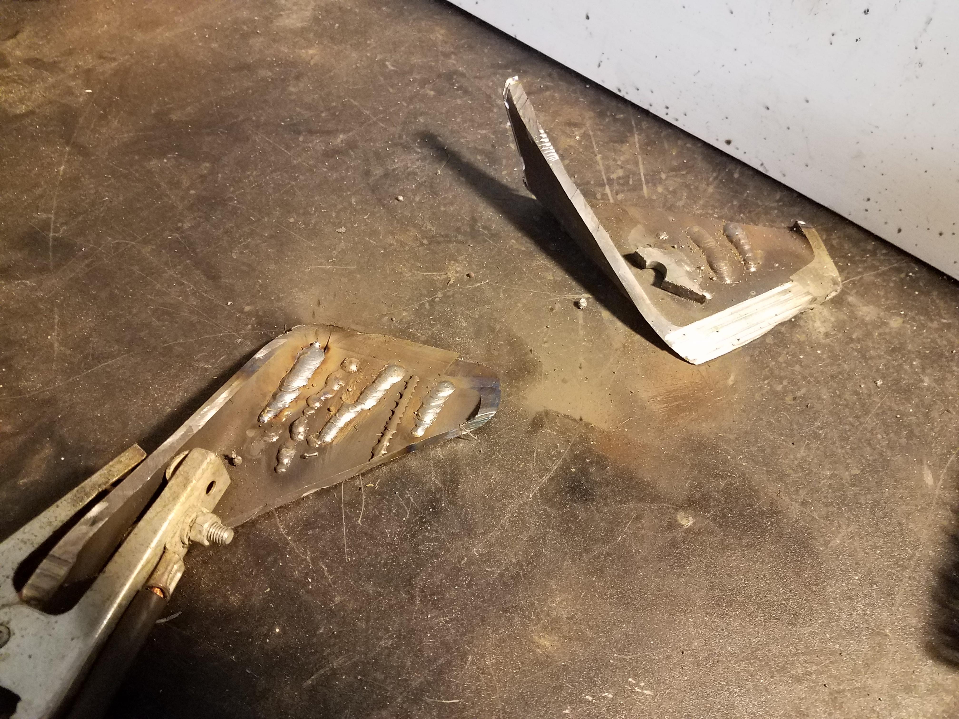

Anyway, hooked up the gas and practiced some beads. After reading online, I think I'm gonna either switch to flux core, or tack it in and have someone with a 220v welder finish it off. The 140 is a nice machine, but it's limited.

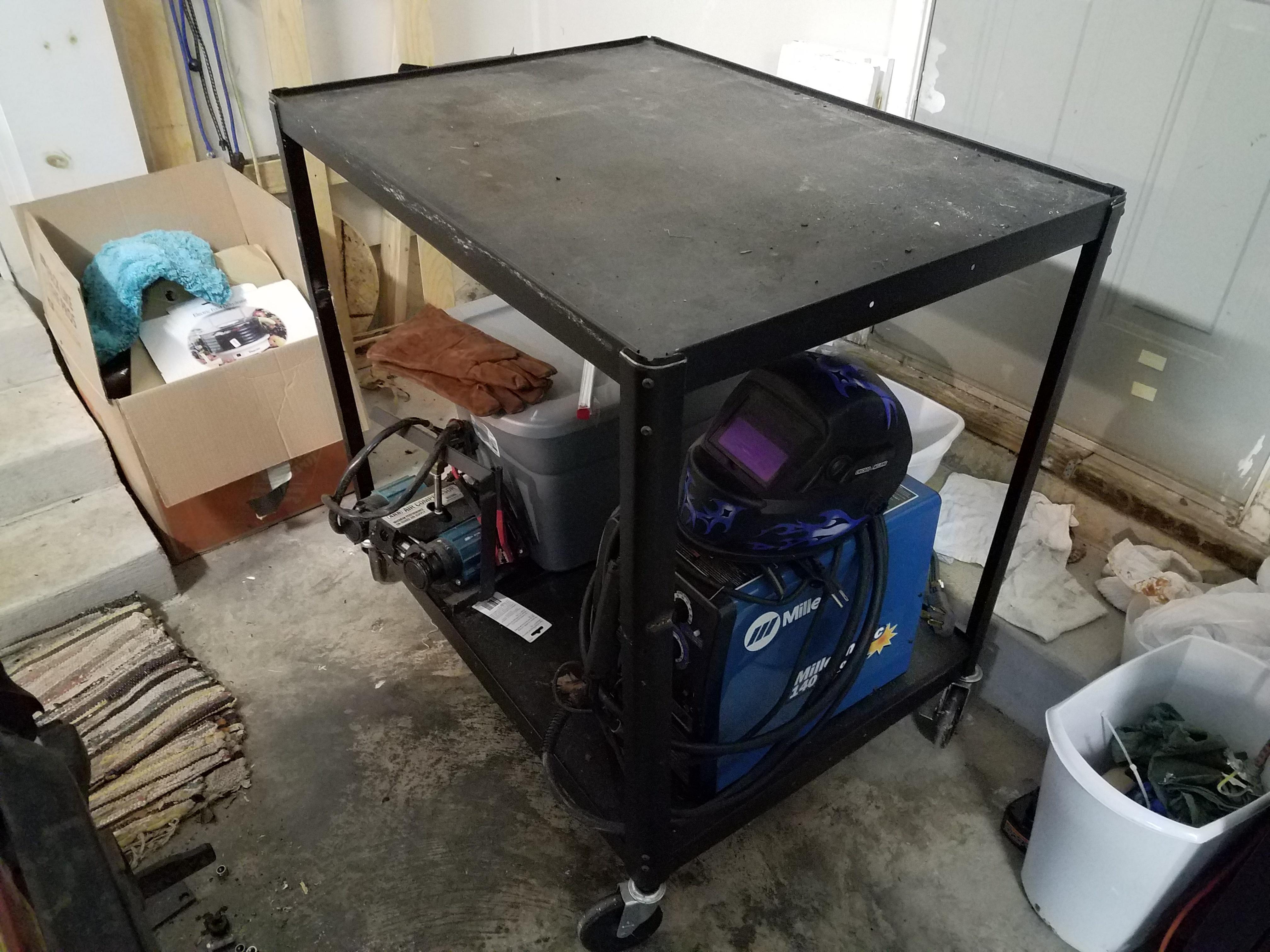

Cart! Used to be an AV cart, picked up from a yard sale years ago. The tank (size 80) is too tall to fit, so that'll be another project sometime.
And my beads. Not terrible for not having welded in forever, but definitely needed the practice. I want to try a few things tomorrow, but I'll probably swap material out soon.
Old Apr 25, 2021 | 06:16 AM
  #2551
RBX's Avatar
RBX
Joined: Jan 2010
Posts: 3,795
Likes: 33
From: Bloodymore
Looks like you need more heat or slow your wire speed. Also, clean the metal until it’s shiny, remove ALL mill scale will help. Best way is to dip the metal in muriatic acid for a few minutes.

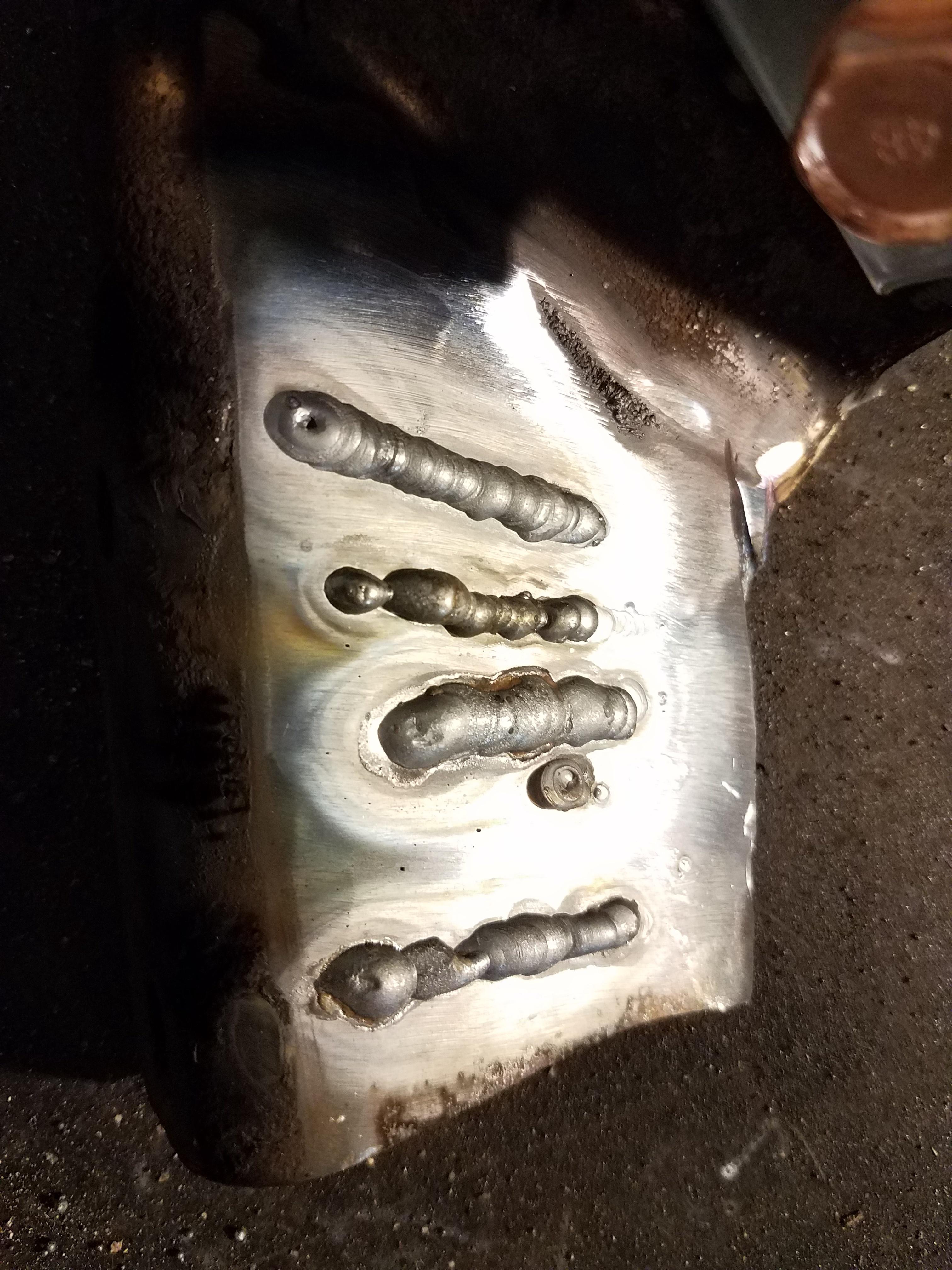

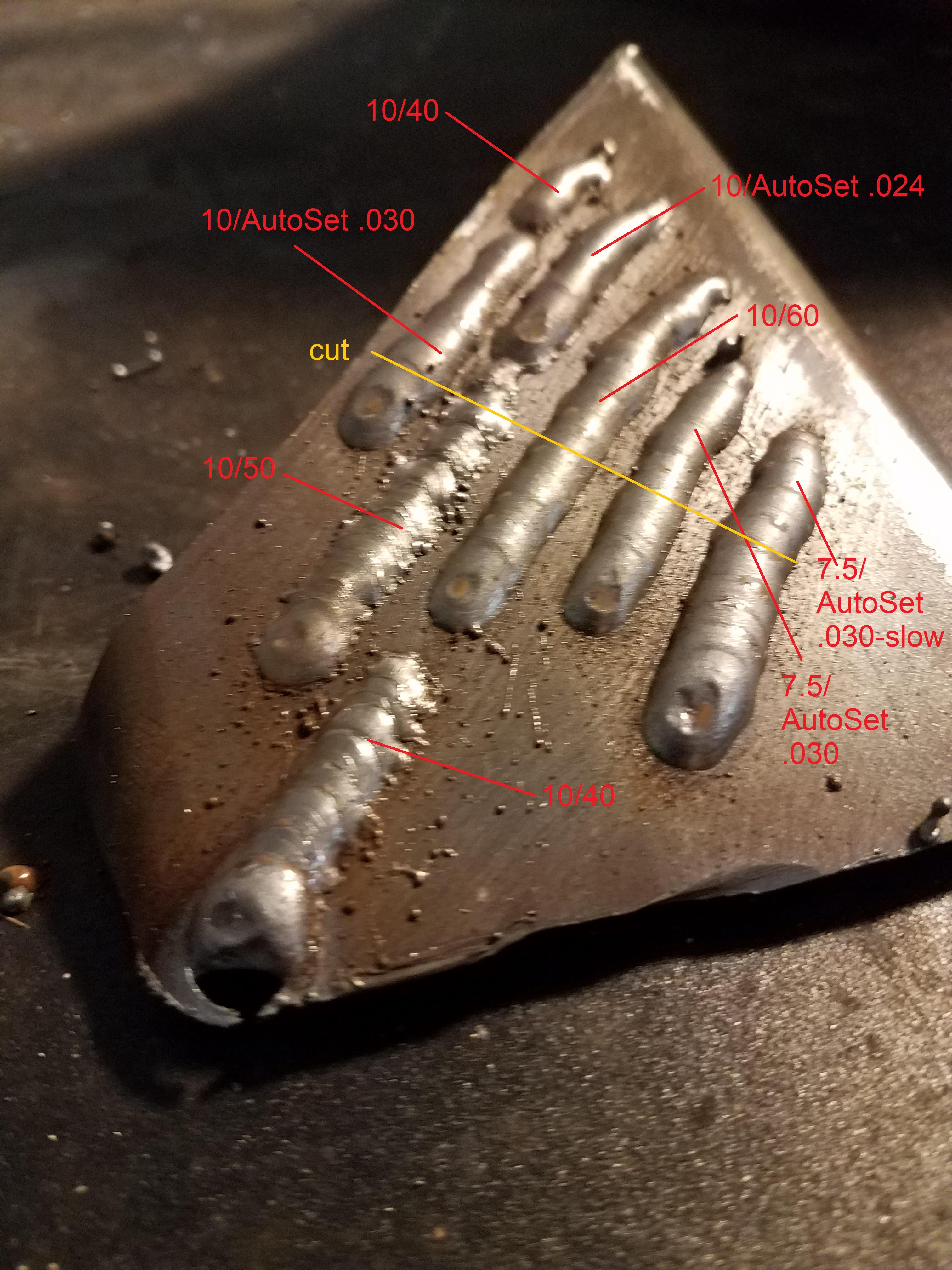

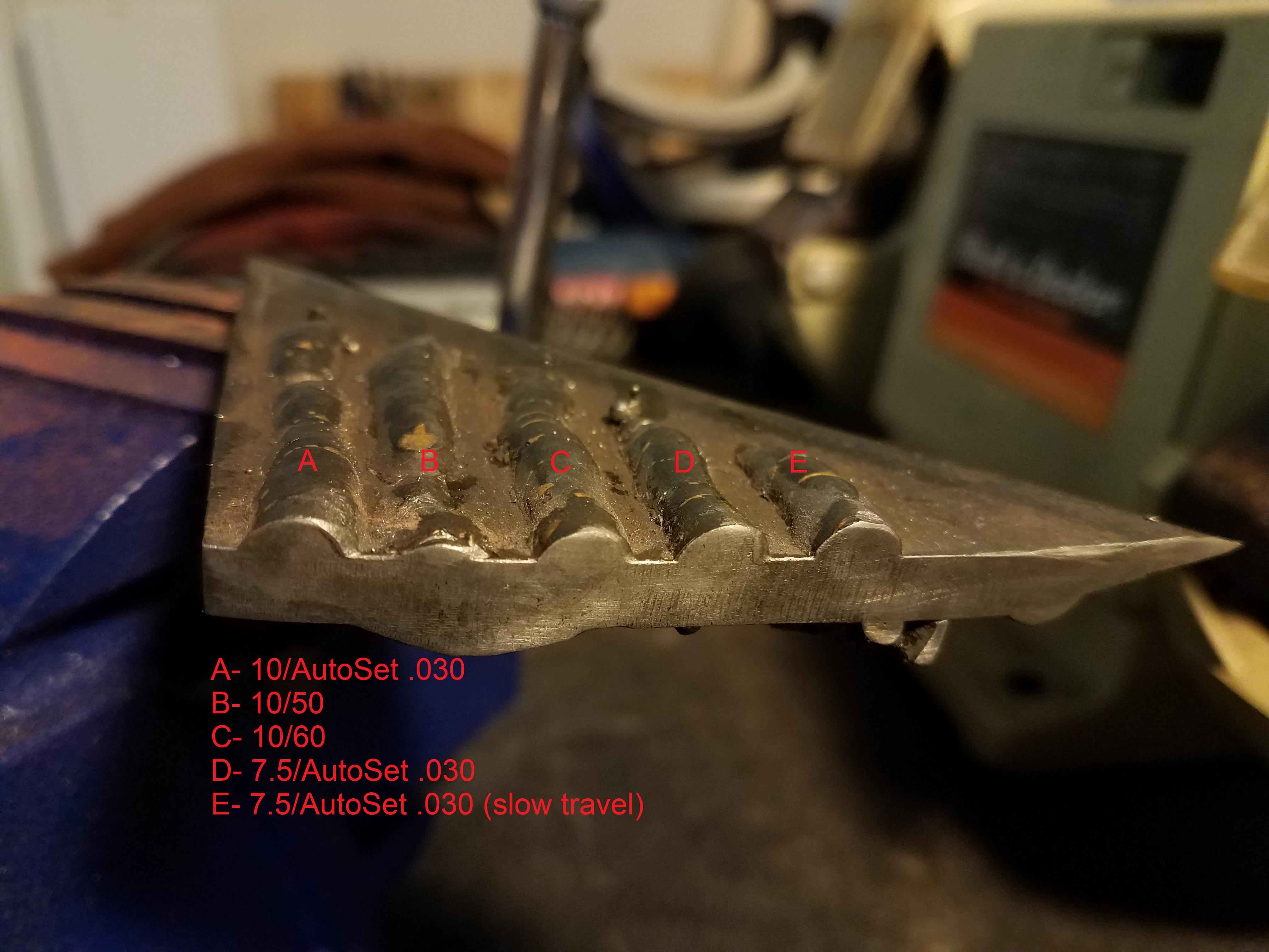

No muriatic acid here, so wire knot wheel and alcohol wipe got it pretty damned clean. The machine is up all the way, I played around with feedrate today:
Annotated:
When I turn down the speed, it starts "hiss......pop- hiss........pop- hiss......", and it forms globs at the tip. Already messed up one tip with low wire speed. And higher just builds up more. When it's welding nicely, it's more crackling than sizzling. Like I said earlier, I don't think this 140 is going to cut it for the structural welds. On the few test parts for the "washer" on top, it seems to be fine.

Does the welder have a chart on the inside of the door for the wire? You may be right about the limit of the welder.
Old Apr 25, 2021 | 11:05 AM
  #2554
irab88's Avatar
iTrader: (4)
Joined: Jul 2010
Posts: 6,499
Likes: 37
It does. It only goes up to 1/8" with 0.030 and Ar/CO₂, so I'm pretty sure I'm just out of range.

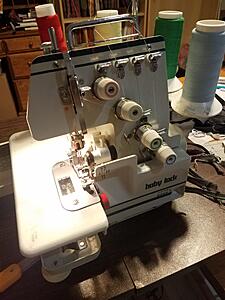

Got a serger, promptly took it apart, fixed it, put it back together...

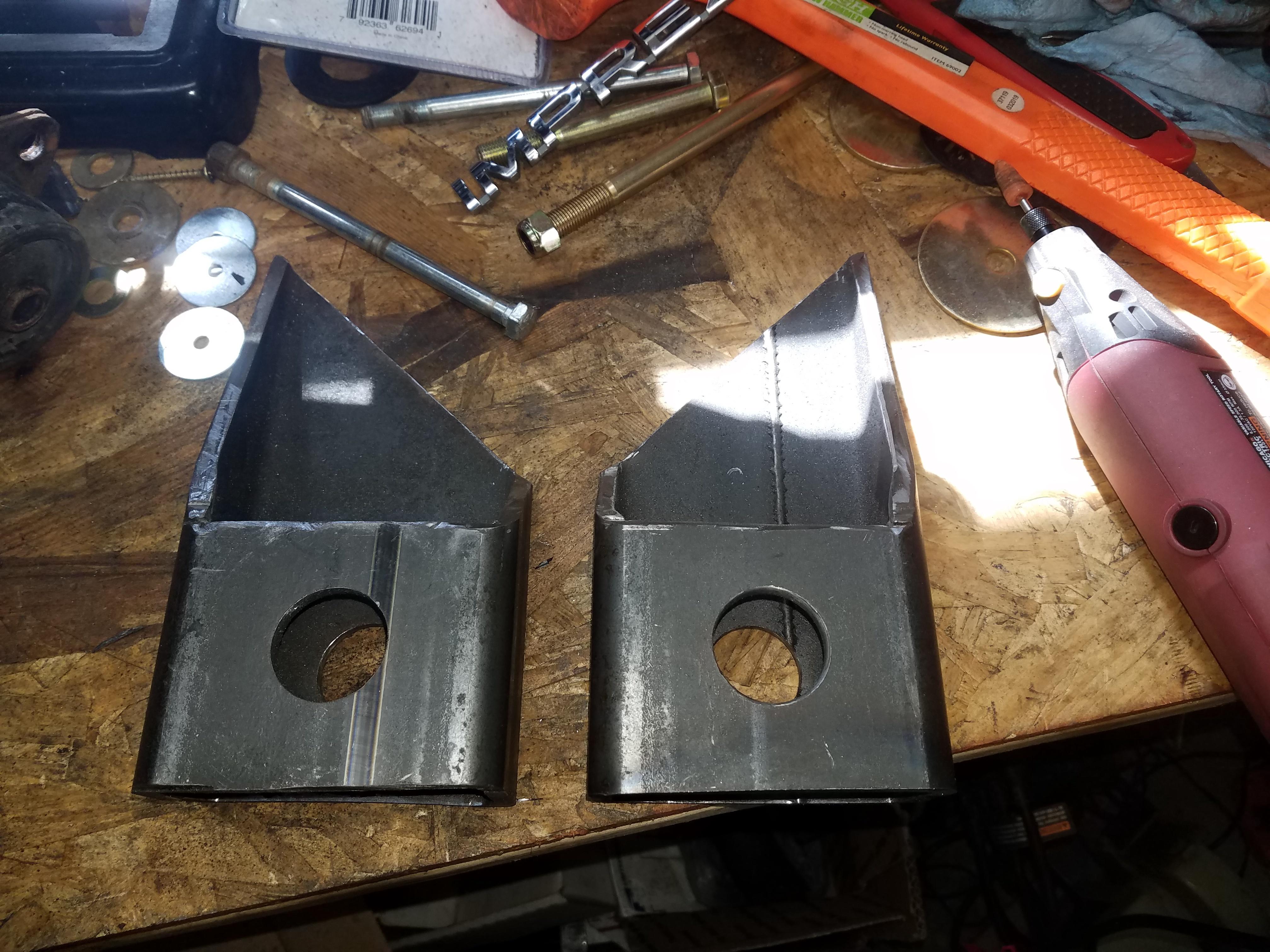

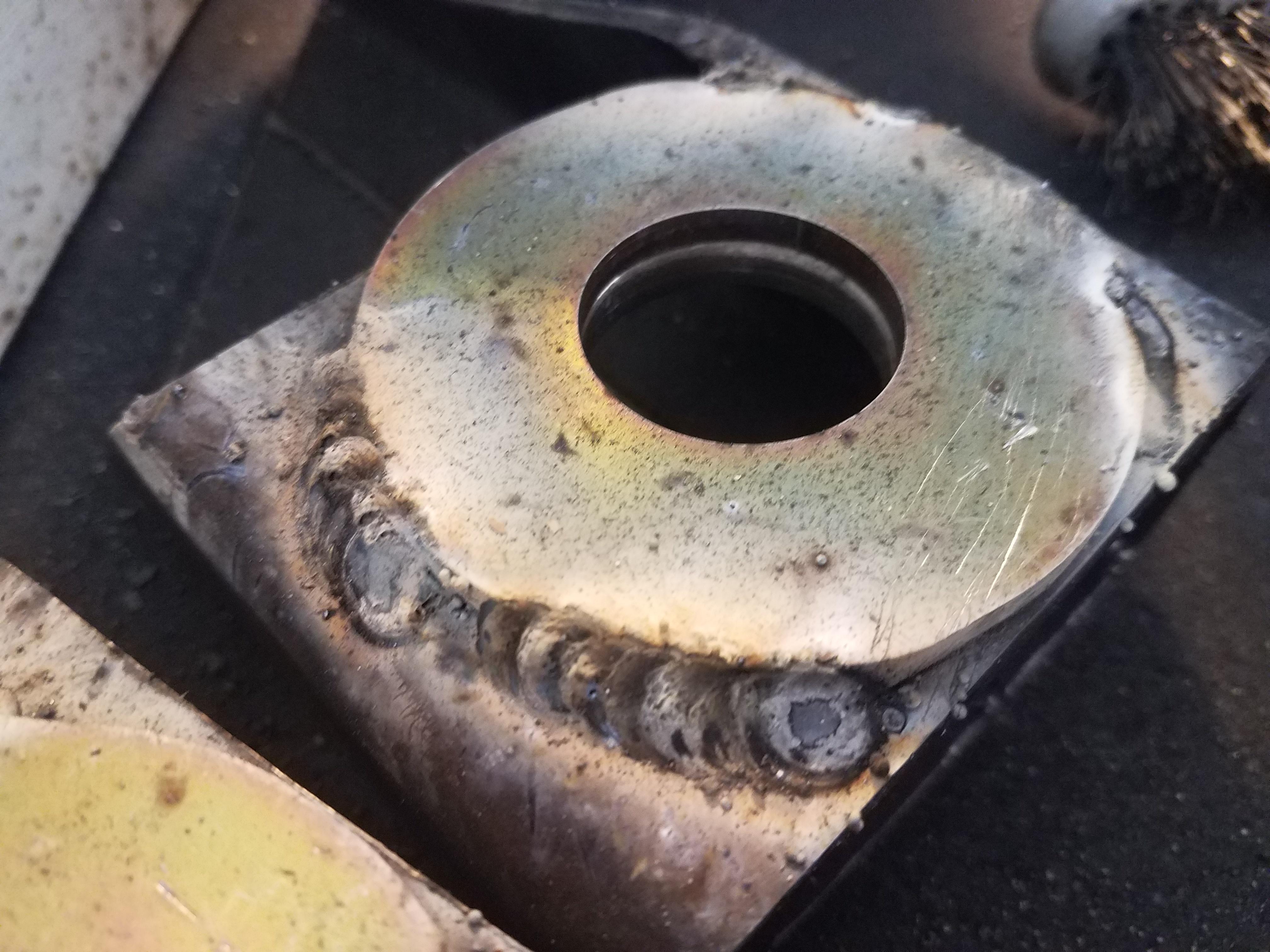

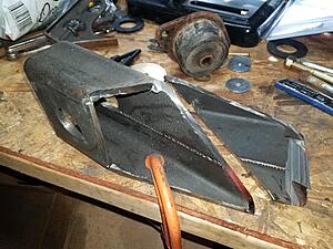

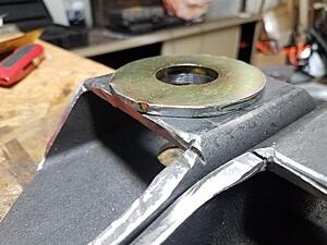

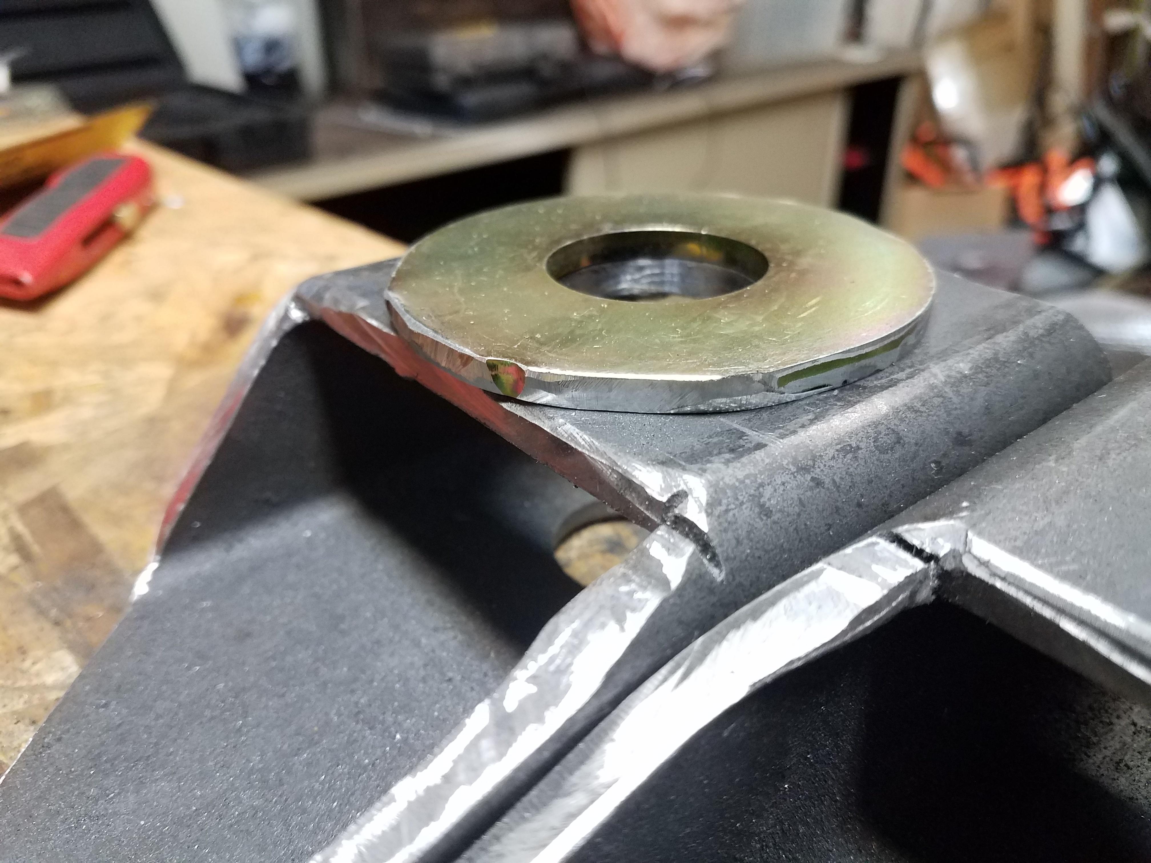

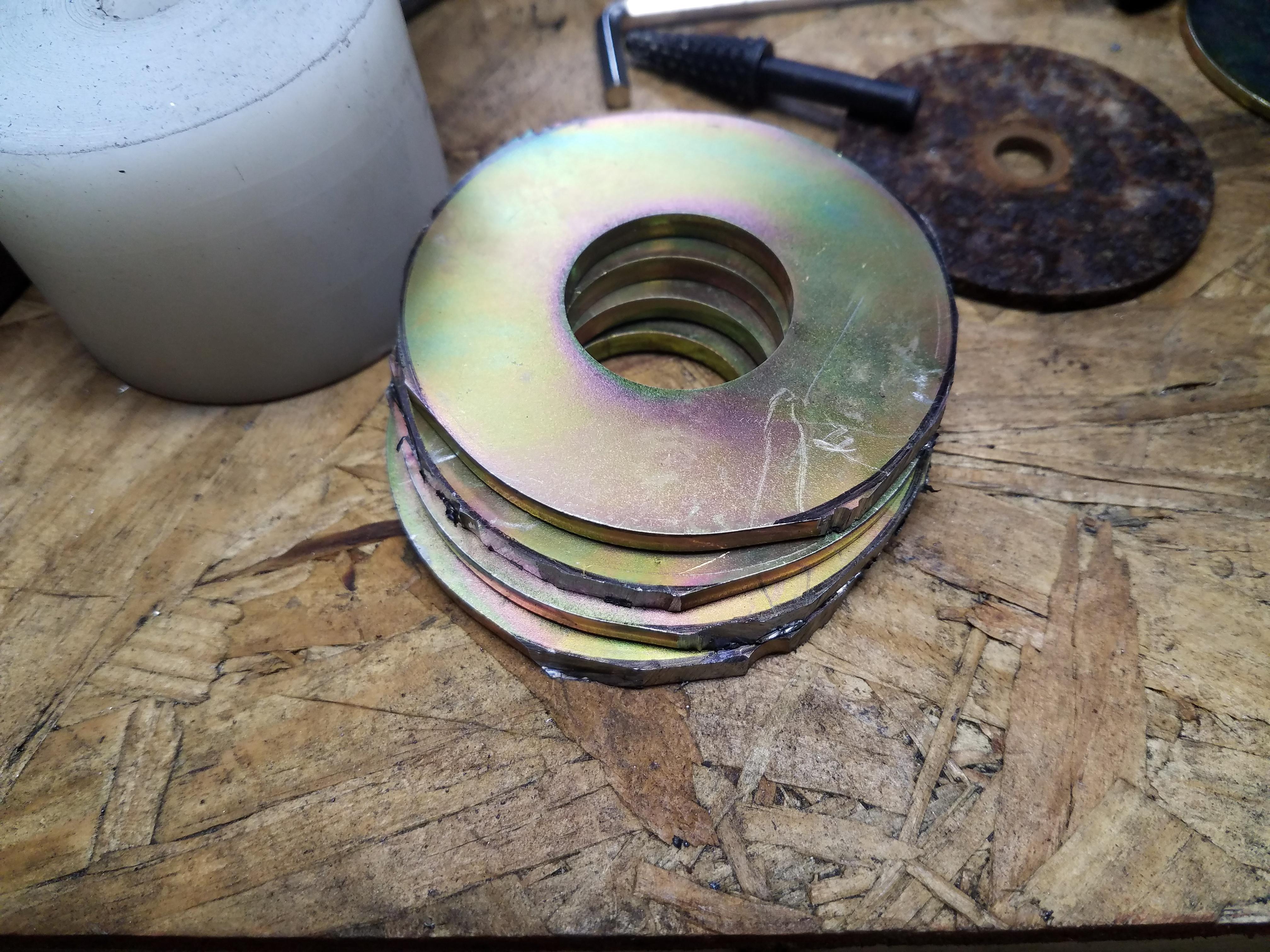

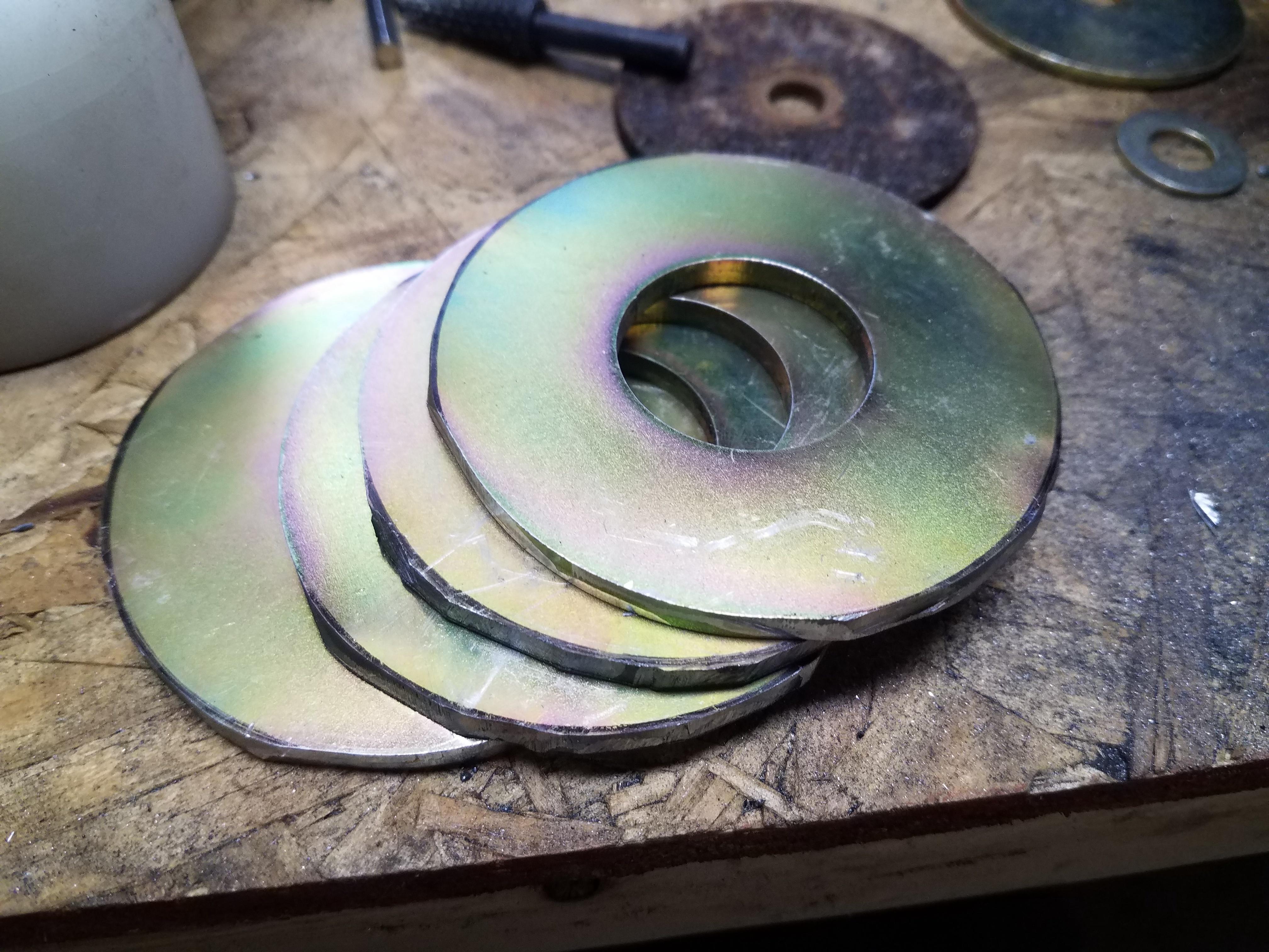

But on to the (little bit of) progress this week. Broke out the welder and opened the doors to burn in the top washer/spacers made last time. I'm happy with how they turned out.
I got the last bit of mounting hardware, so we'll see how this all stacks up soon. I want to get the other side done so I can drive again!!
