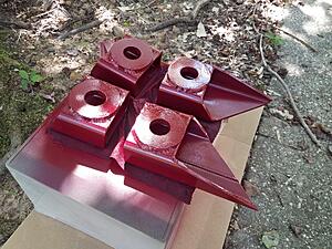

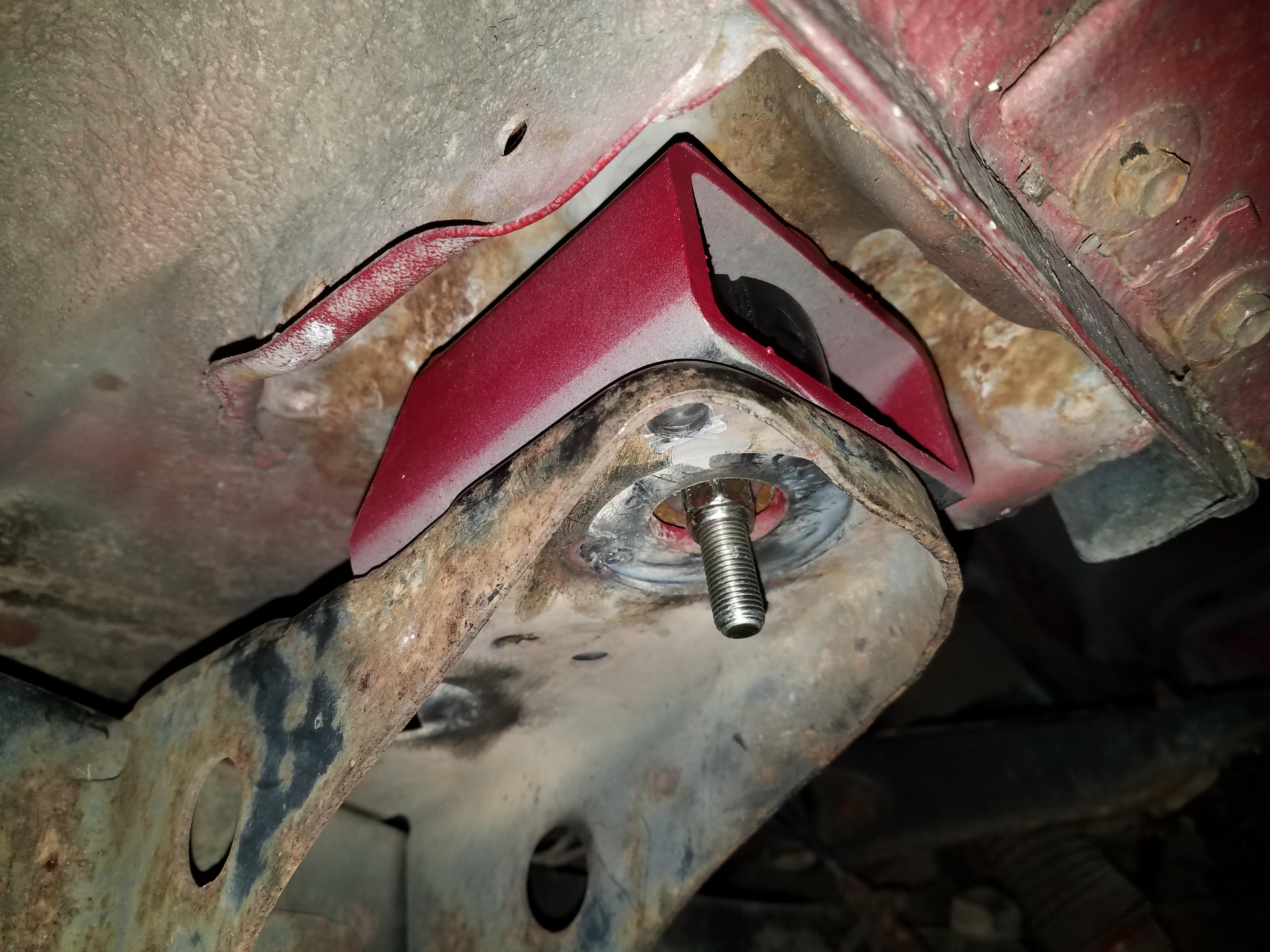

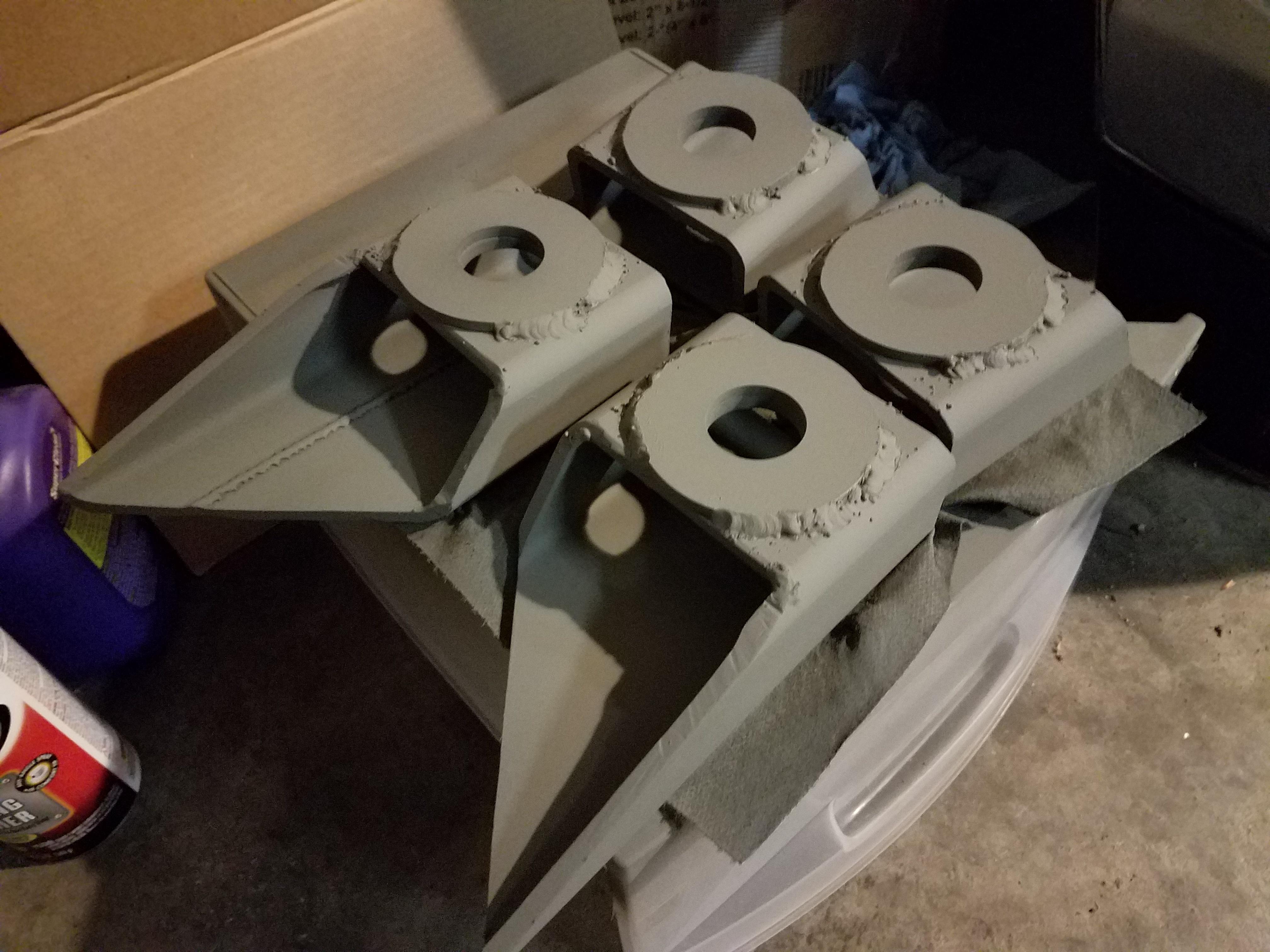

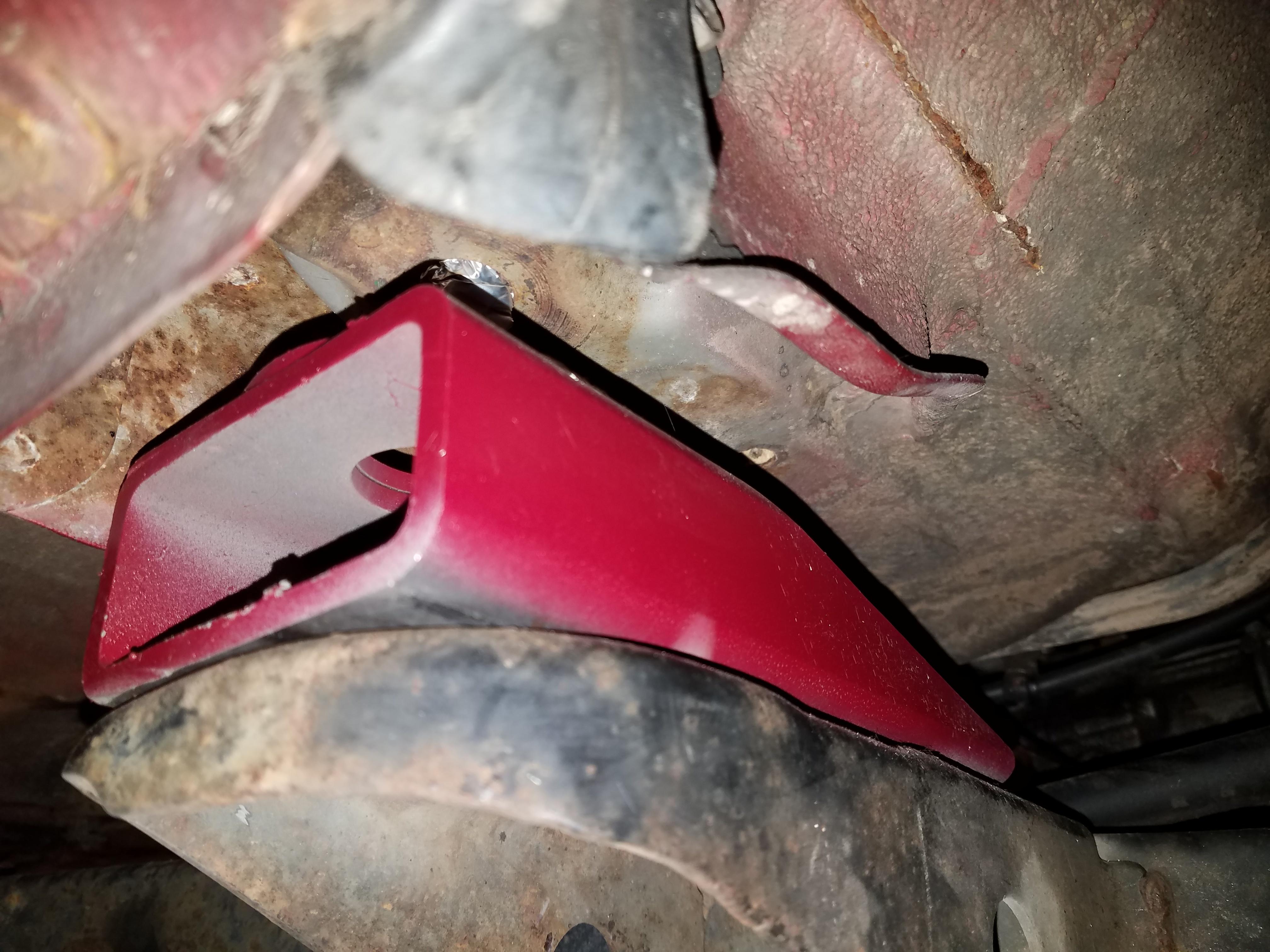

Was about to test fit the mounts, then realized they weren't painted, and probably wouldn't want to take them off once I had them mounted.
Primer, followed by some burgundy I wanted to try out.

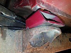

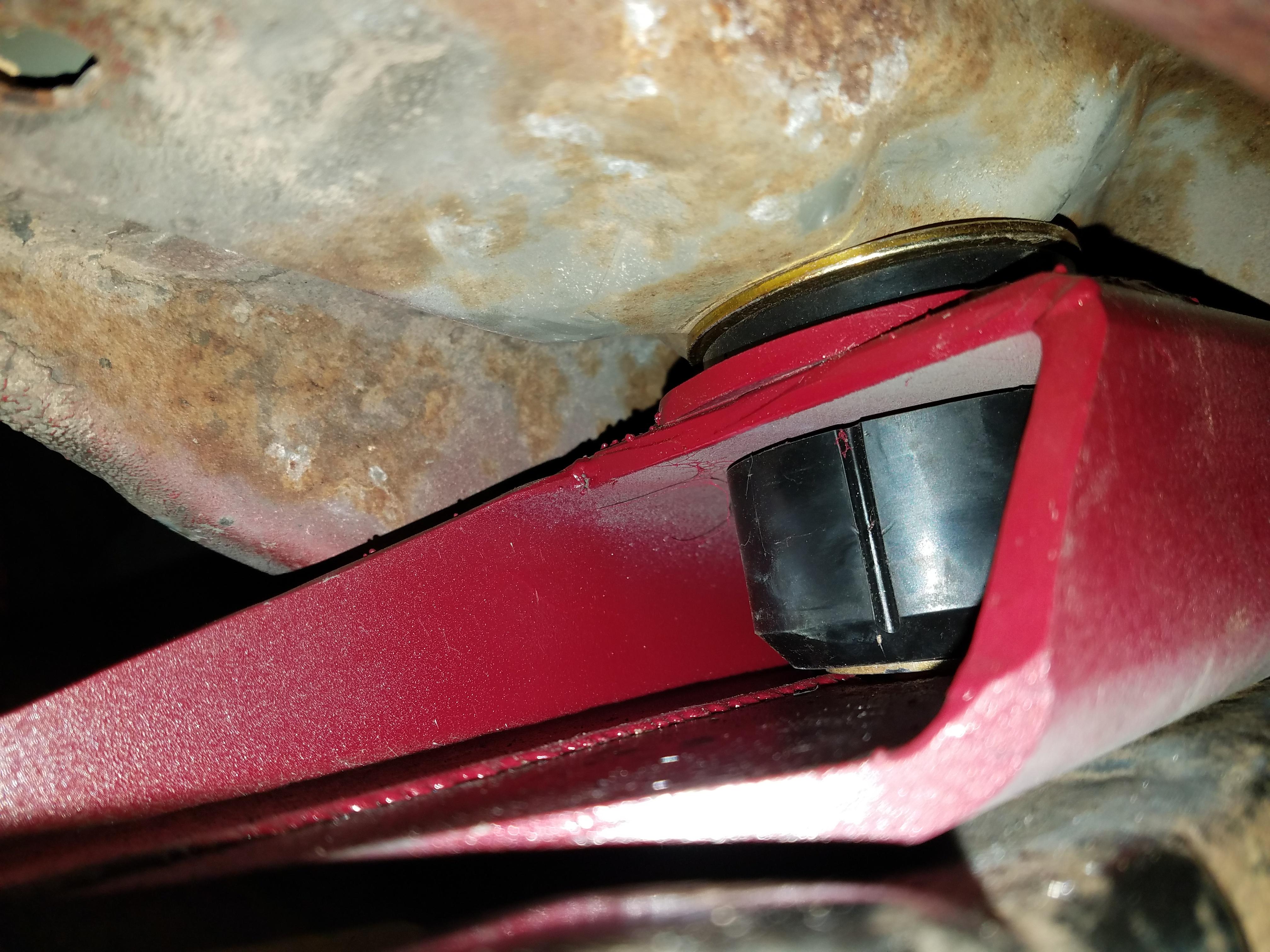

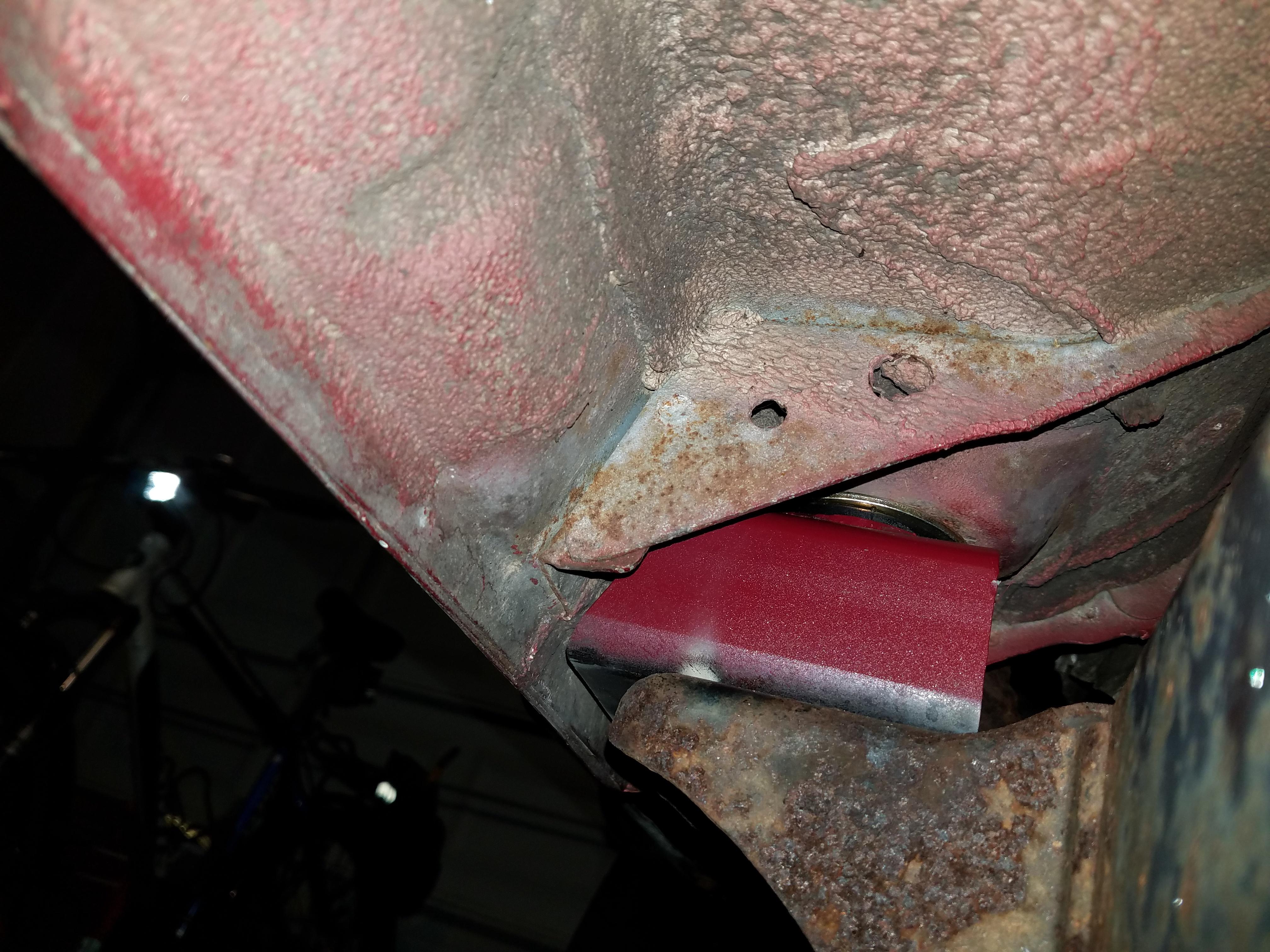

Test-fit nicely, I purposely didn't paint the bottom because I knew I would have to weld under there. Once it's all done, more paint!

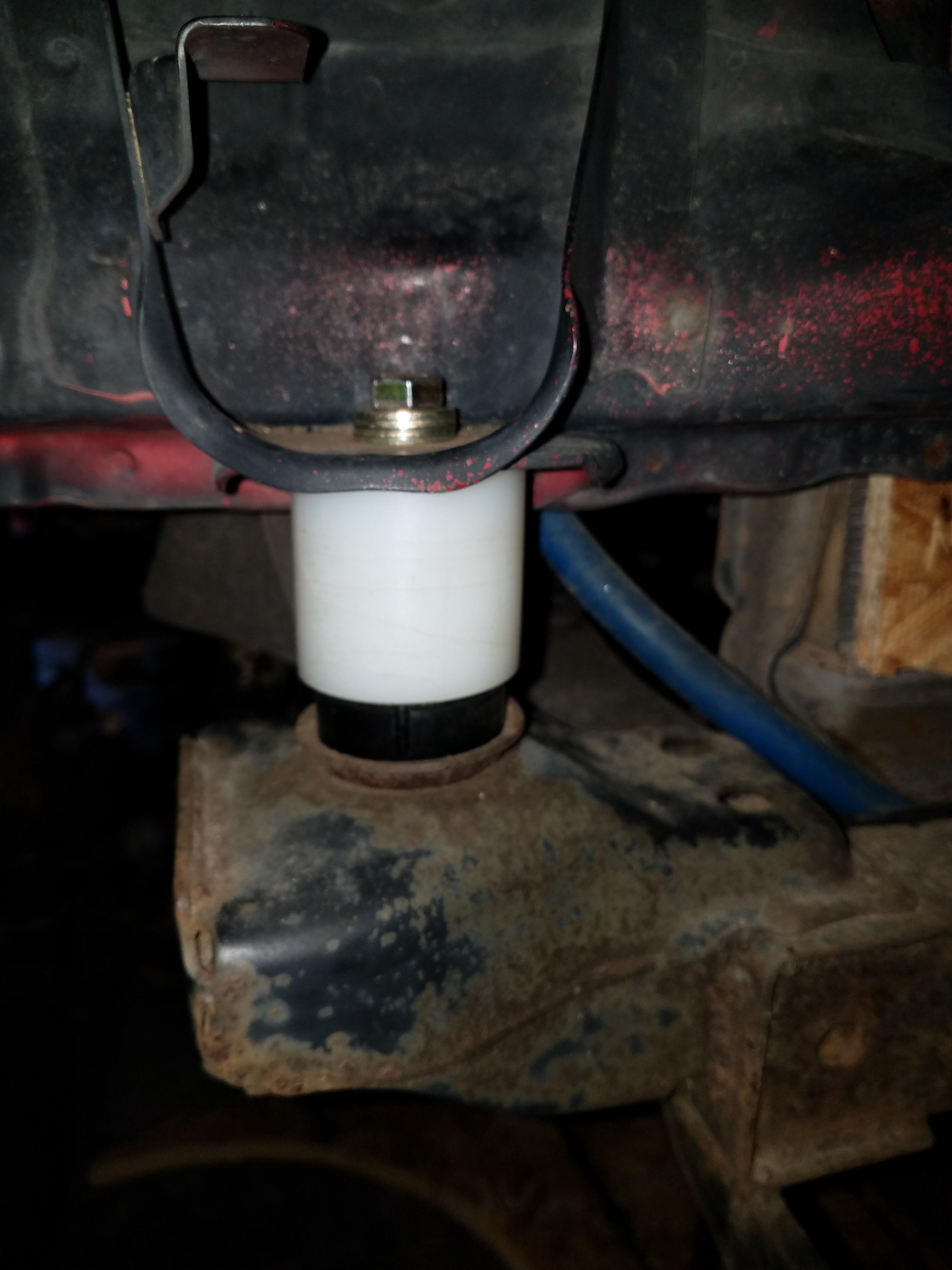

And finally, tacked in with the mig (FC) and fitted with all hardware (not tight yet).
I have a few washers for the bottom coming this week. I still have to do the driver's side, but now I know how to go about it. Cut the old mounts off, clean up, new mounts in, tack weld, new hardware. I don't have confidence in my abilities to TIG upside-down yet, so I may look for some outside help on that. For now, it'll support its own weight.

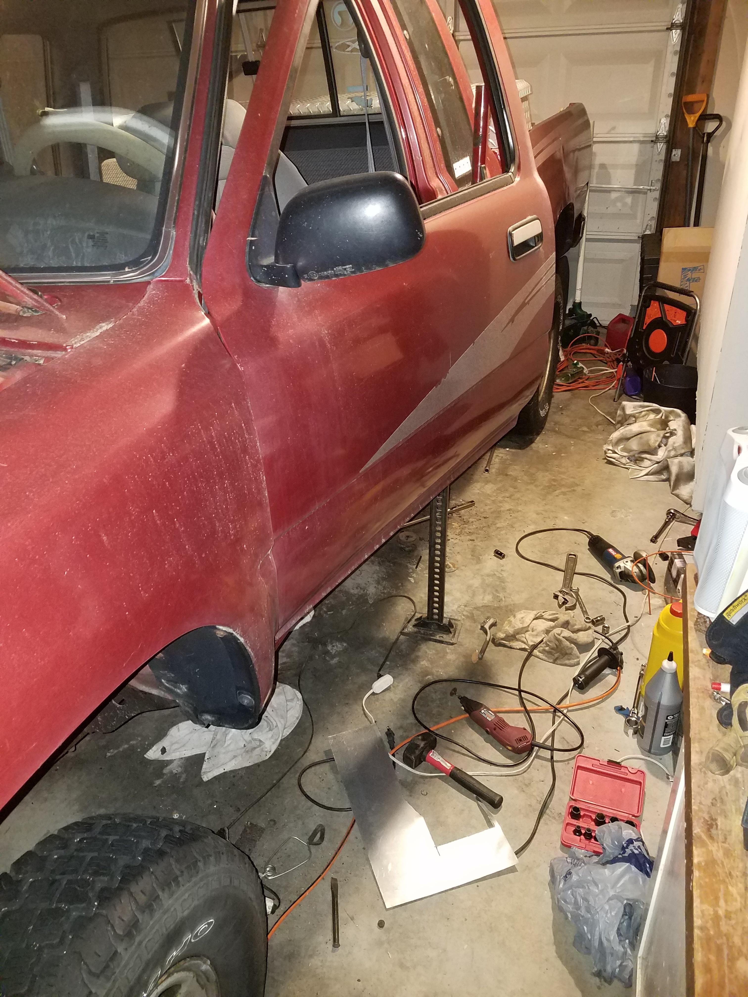

And on to yesterday's progress. I actually got everything done Friday that I planned to! That's a first!
As long as I'm working on my truck, no one can say NOTHIN' about the mess.

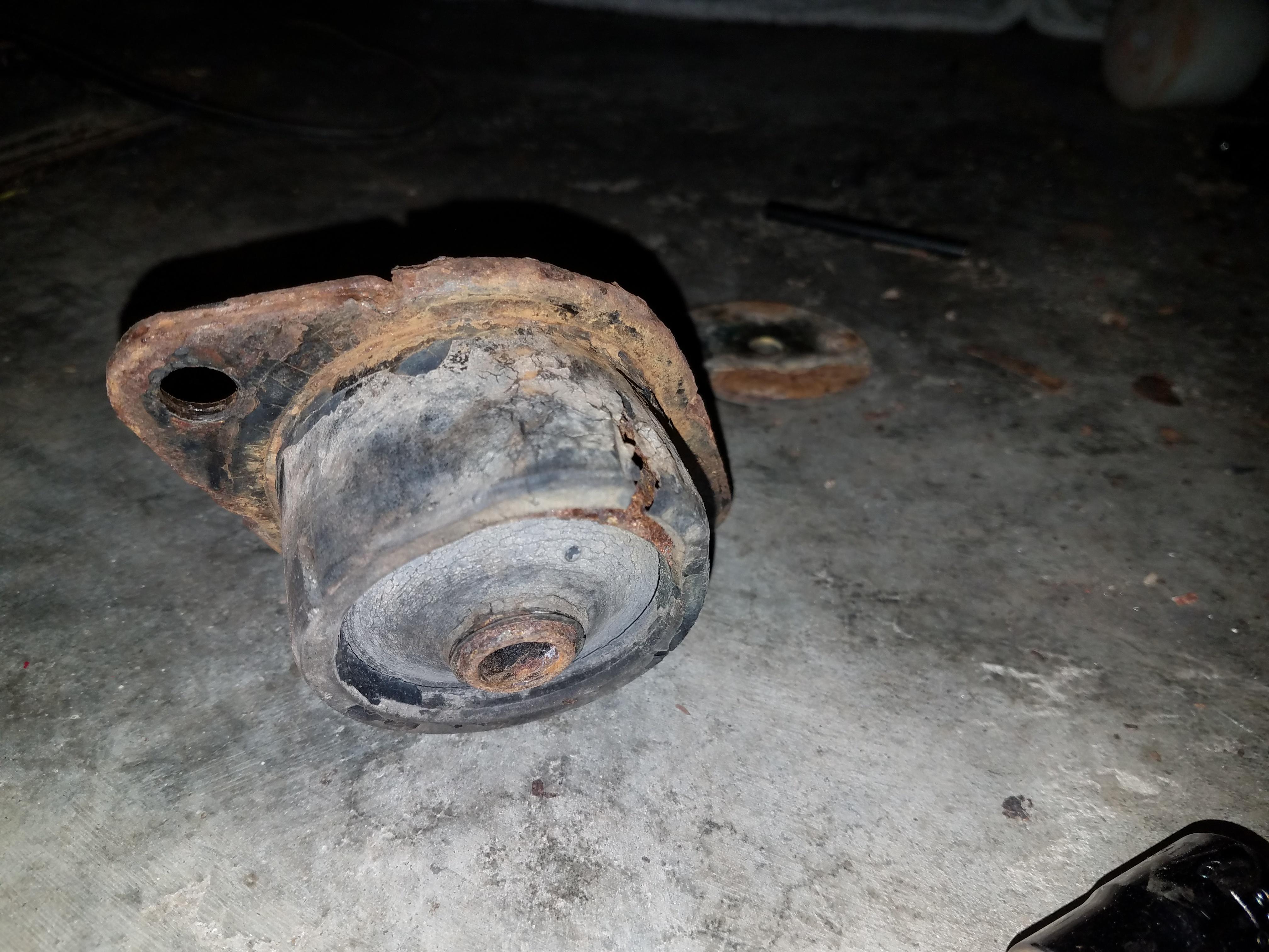

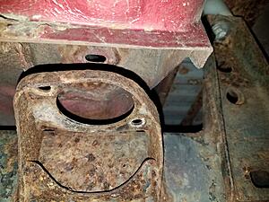

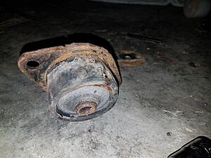

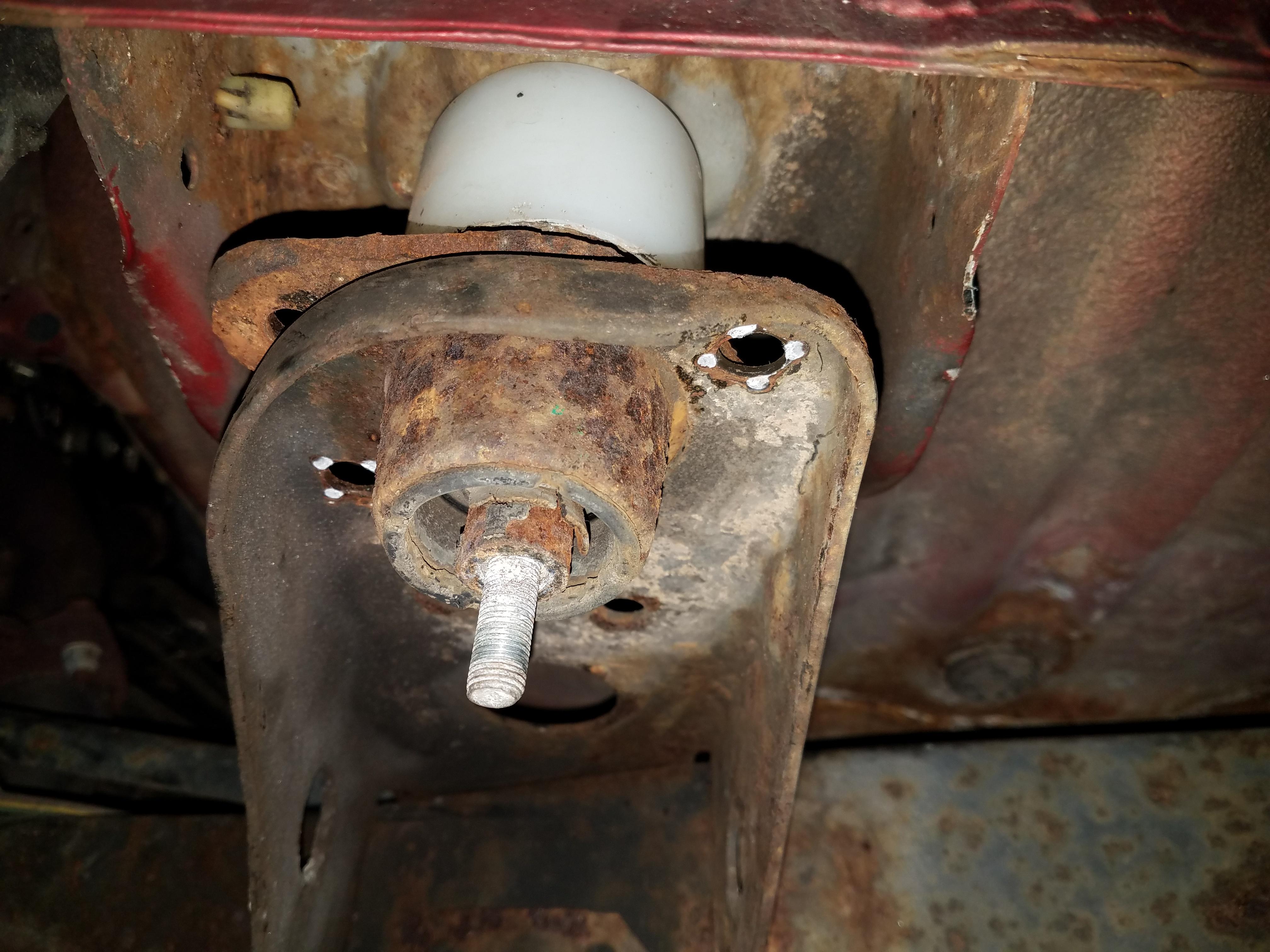

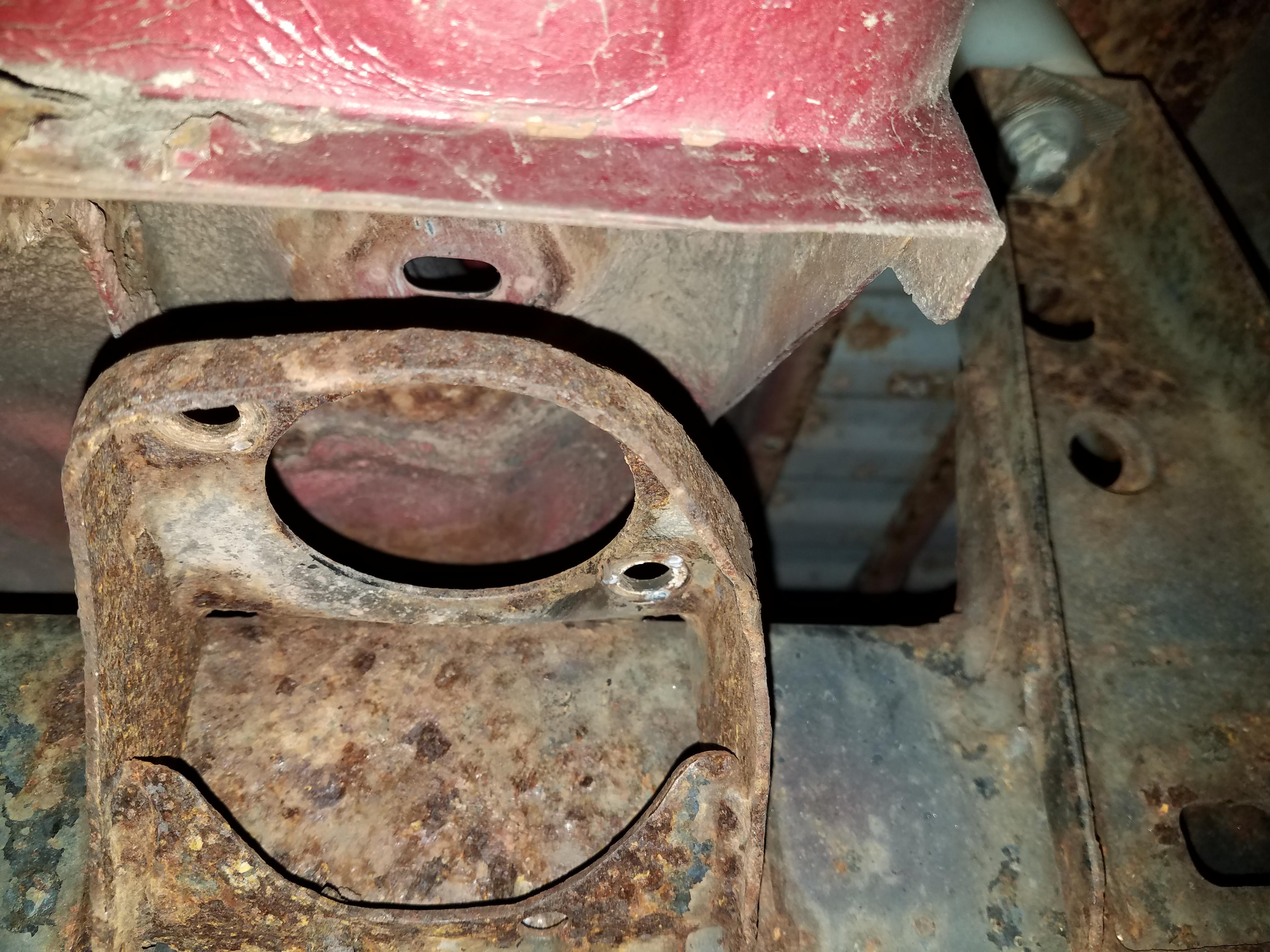

And old bolts out! Spent a good deal of time with the oscillation tool and HF-Dremel clone. The bolts spot-welded on the bottom were persuaded to vacate the area by Mr. Hammer and Mrs. Chisel, surprisingly easy.
The rear one had different nuts and bolts than the other 3; It had flanged hex nuts spot-welded in 3 places, as opposed to the others with square nuts tacked in 4 places.
Eh, I think I could get another 100k out of these bad boys...

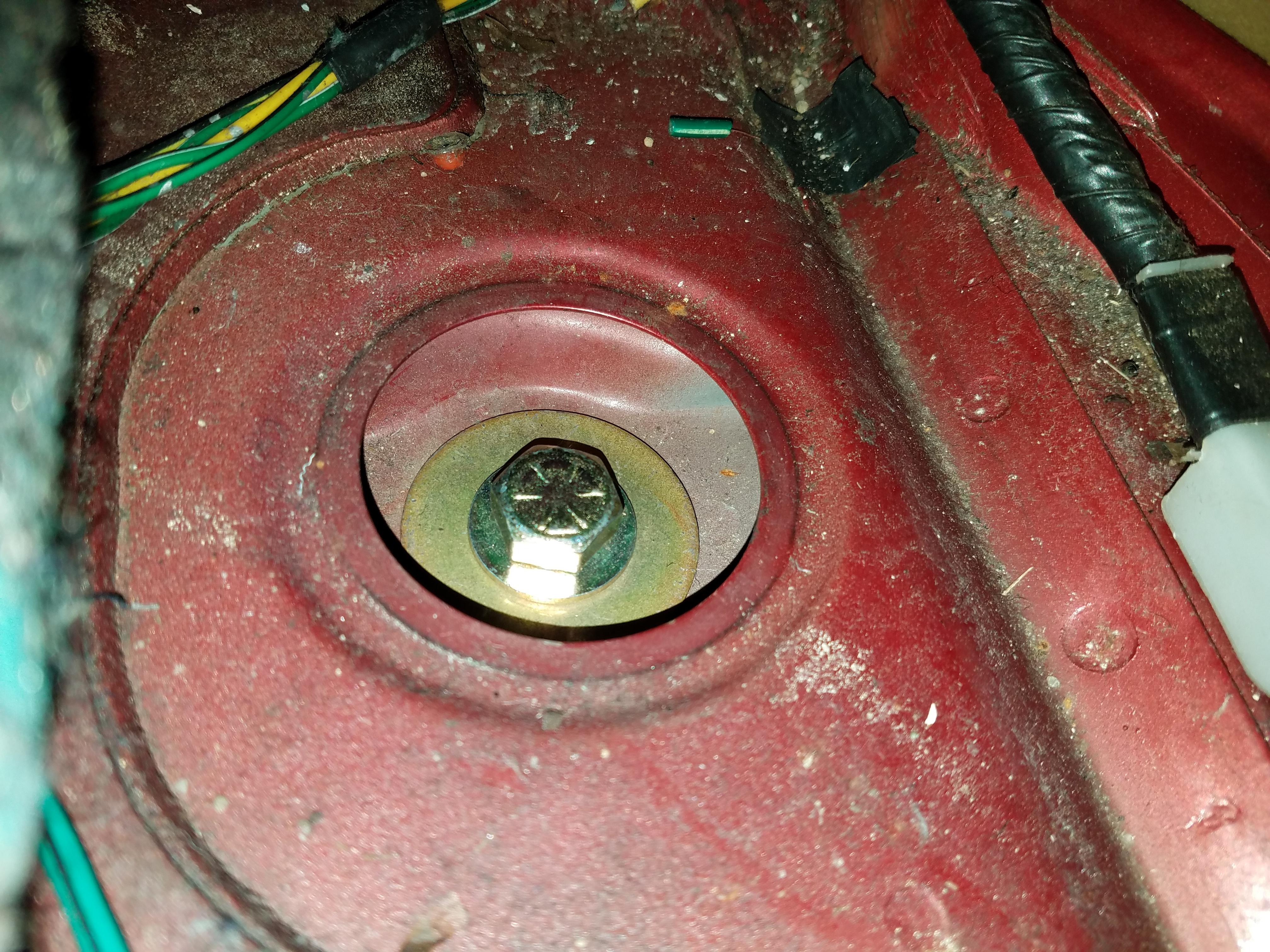

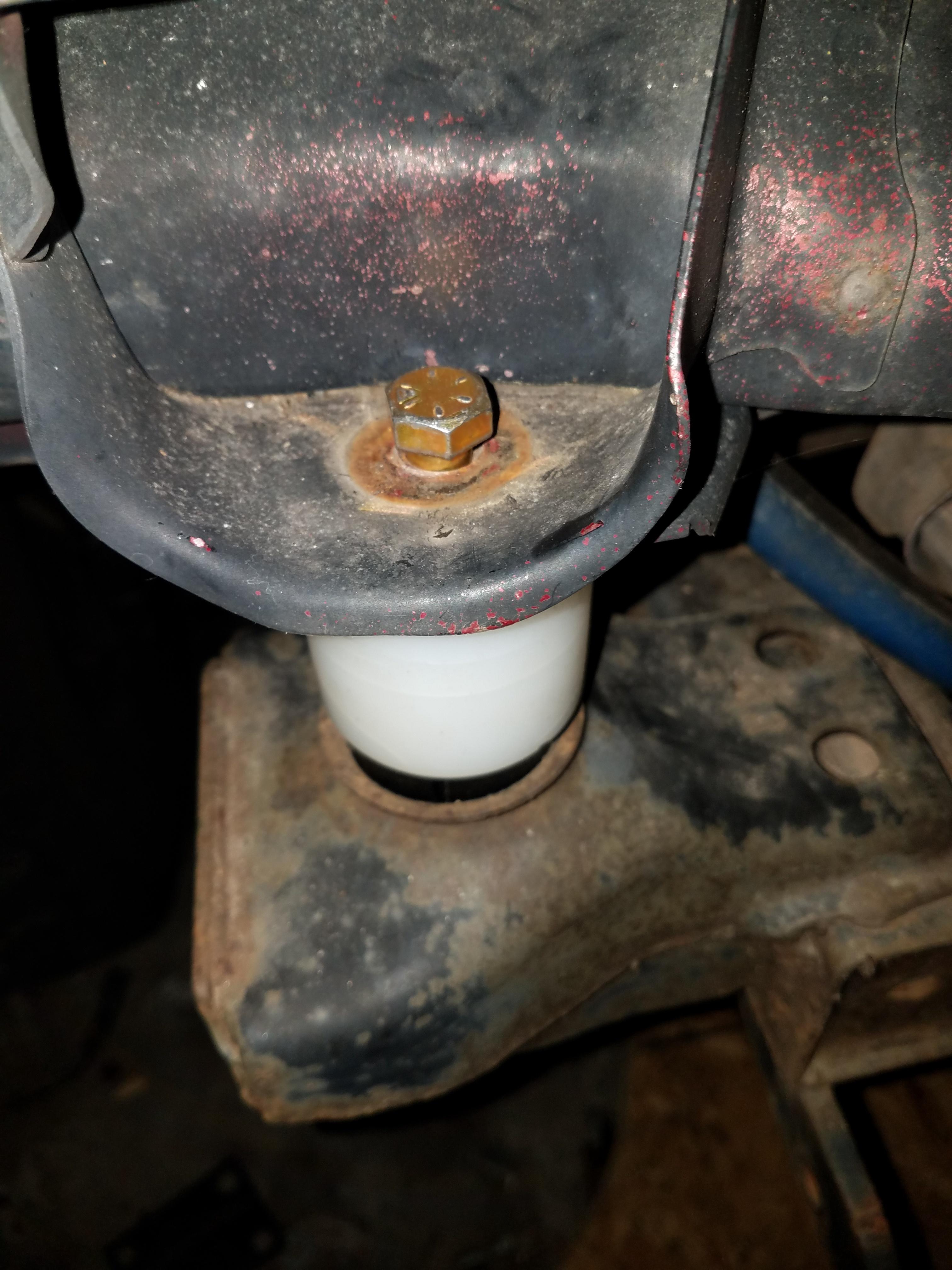

I'm not doing the front mounts due to how they're a hair different, and they aren't taking a brunt of the weight. I did want to change out the hardware, and found out that the 7/16-20 grade-8 bolts I already had fit nicely. A 7/16-20 x 5" would be perfect for a 2" lift, but I ordered 6" and 4" for the main mounts. So I'll see if I can get the 6" to work for now.

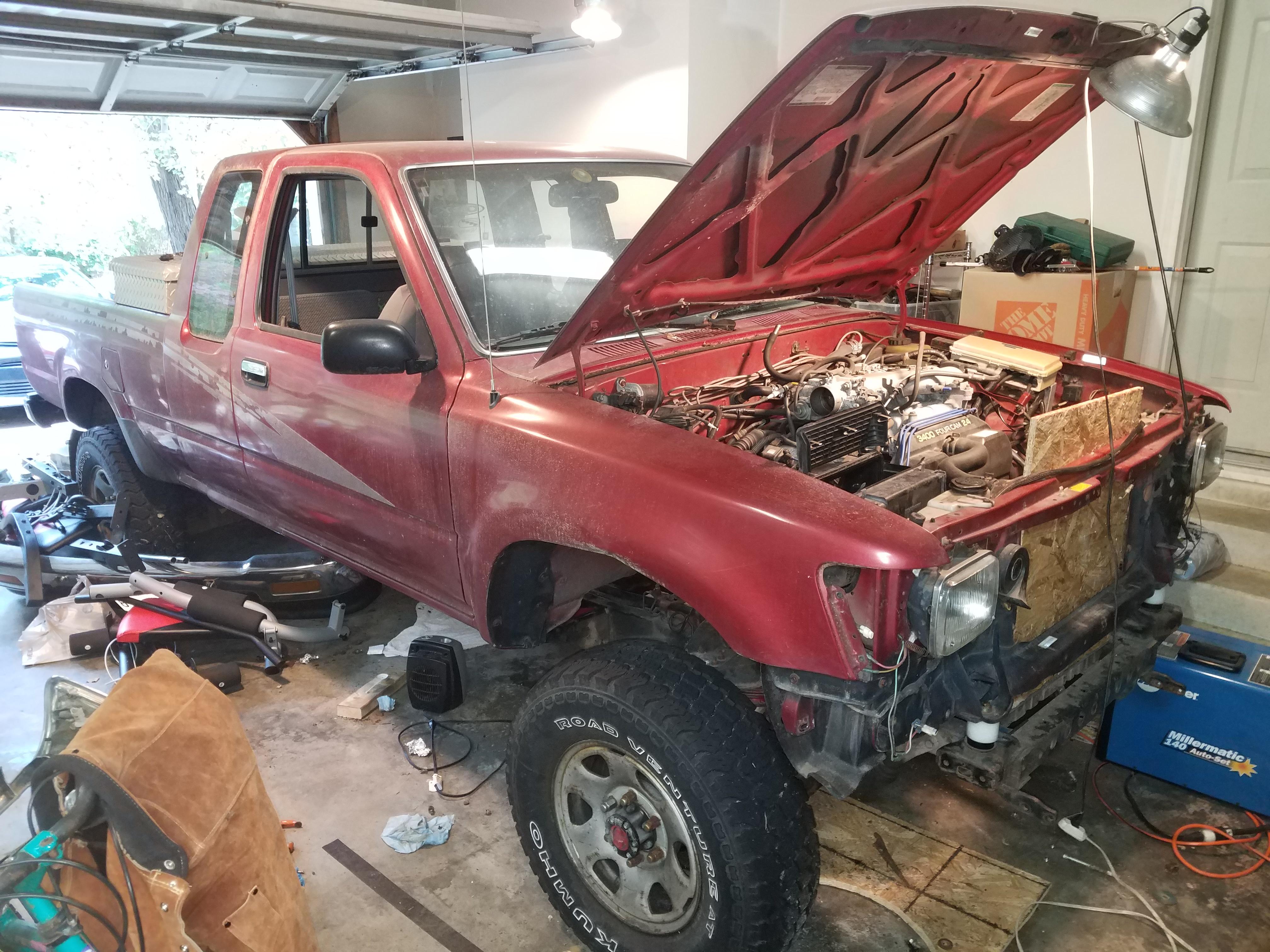

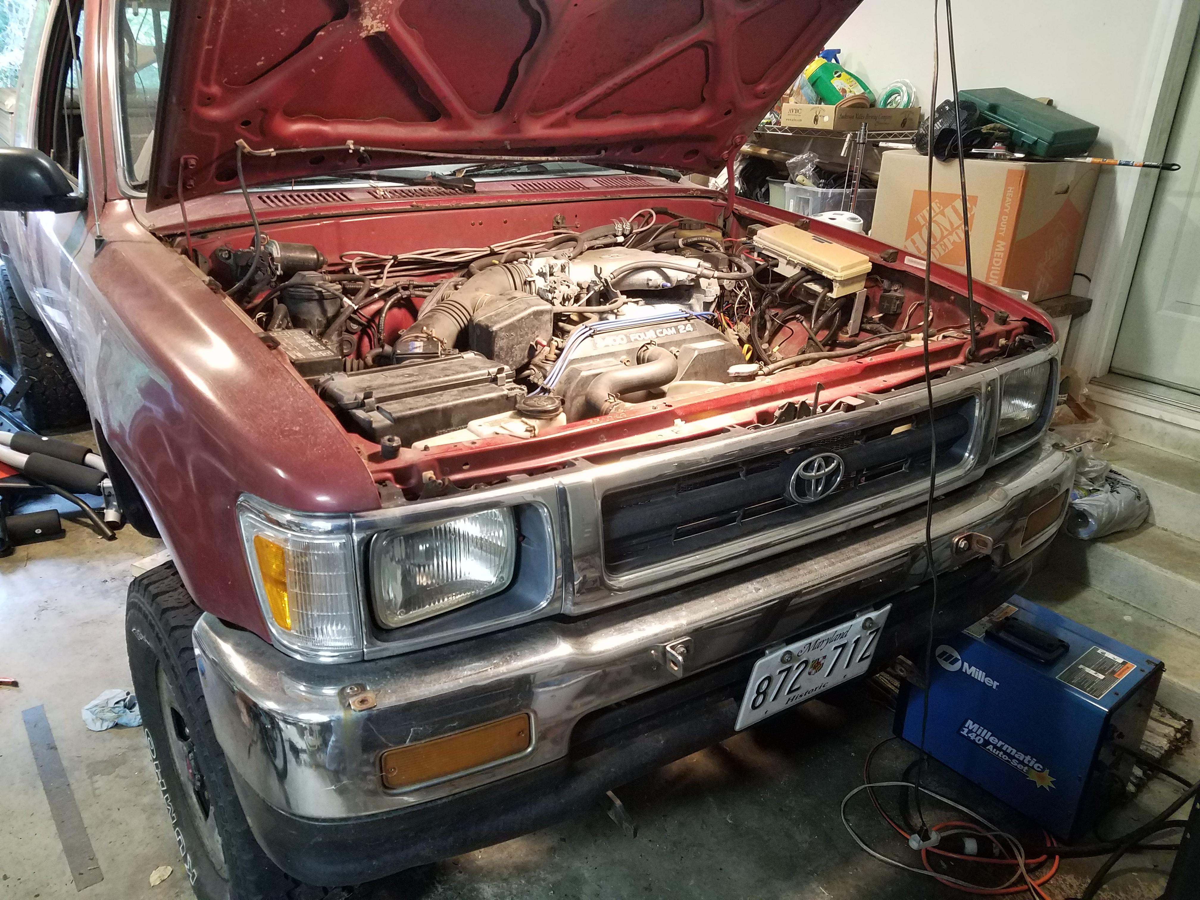

Both sides got tacked in and torqued this weekend. Engine is back together and front back on. Today I'm stopping by to get a new battery (old one went to the celica) and finishing a few last things. The goal is to drive it before the weekend.
pictures soon

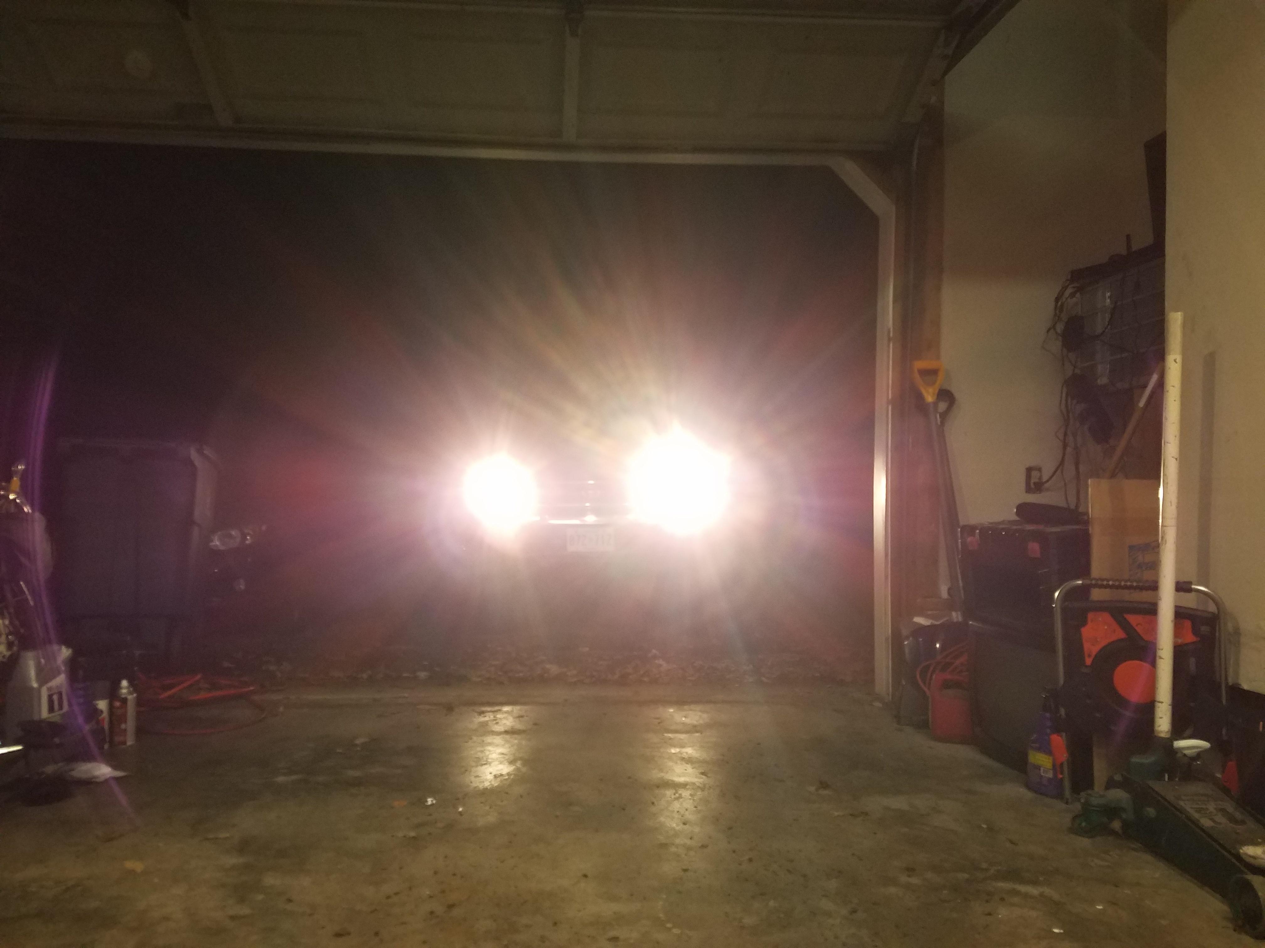

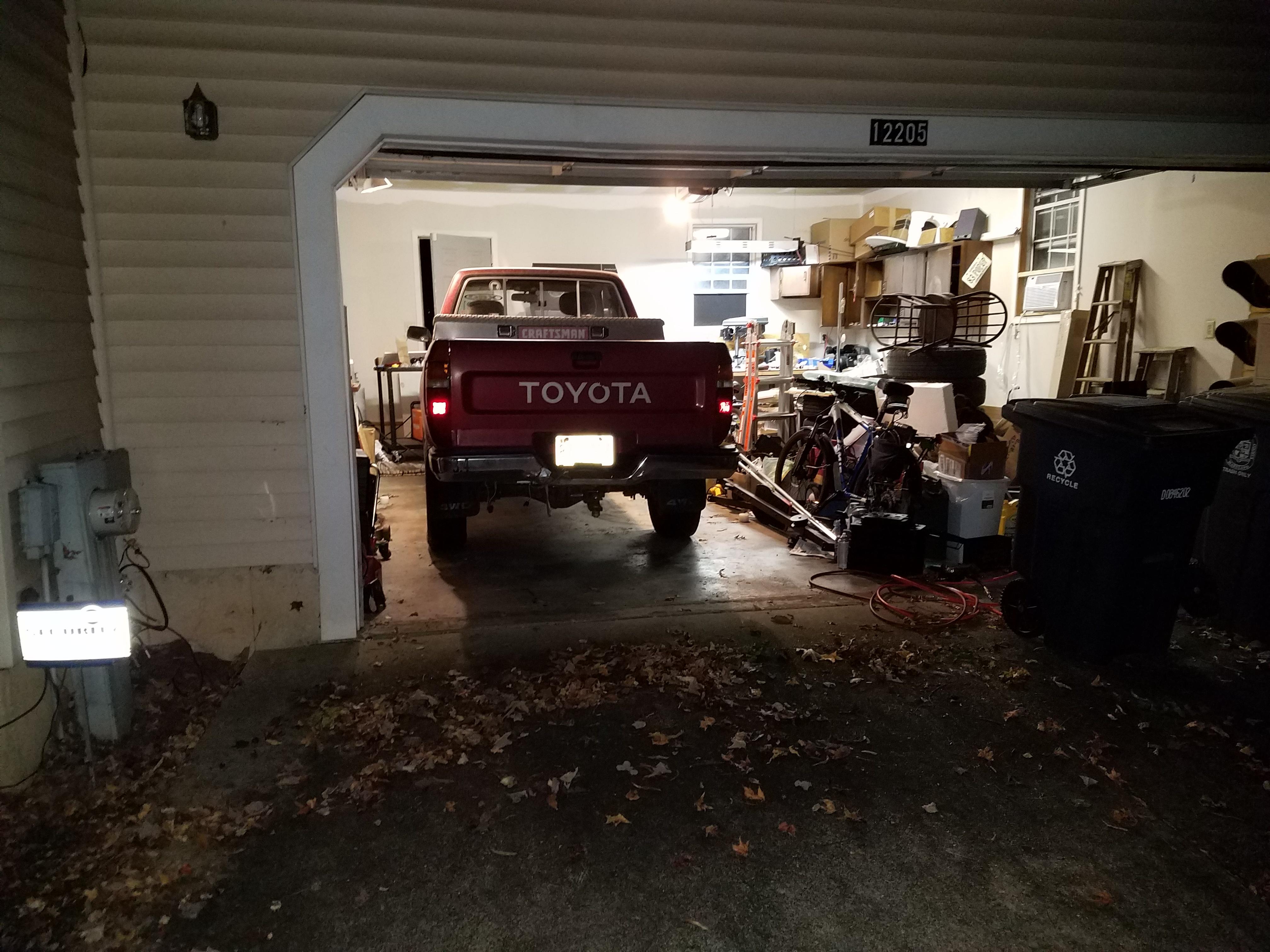

Moar big piktures
No labels, just pics. I'm tired and have grownup paperwork to look at.
I'll be driving her in to work tomorrow, I'm excited for that. Been a WHILE.

Nice job getting it back out of the garage! How was the drive in this morning?
