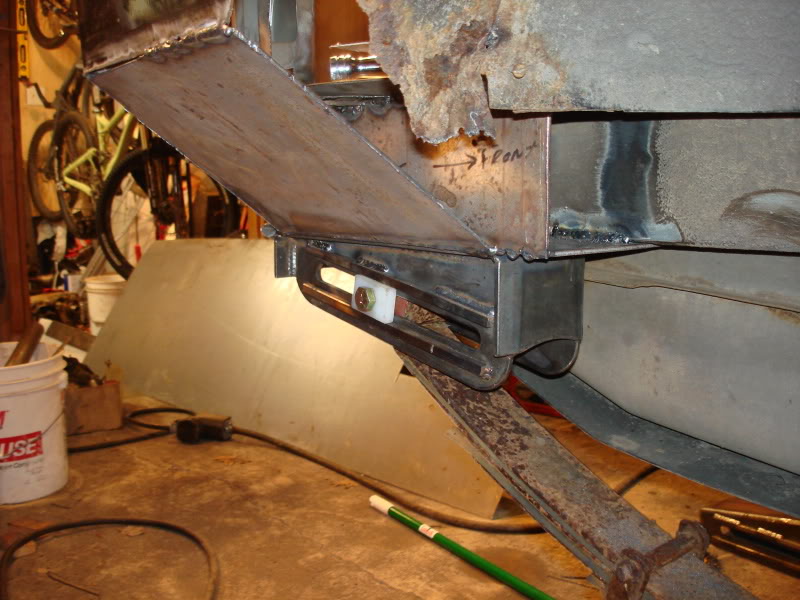

and i came across these. i might put them all around to give me a lower stance:
not too bad on price, and it'd keep my front end down by a good 3 inches
http://www.liquidironindustries.com/...e=0&featured=Y

Seen those before,pretty cool. They safe for street use? Lateral force on the nylon slider...
I thought the reason for lift on a leaf setup was arch so the histeer will clear?

i'll make the steering work, even if i hafta notch the frame a wee bit. and i'm sure they're fine for on-street use. i mean, leaf bushings take a good beating, and they hold up fine, so i don't think there'll be any issue. i can throw a fender washer on if need-be.

You bring up a good point about the bushings, but bushings absorb vibrations. I'm just thinkin out loud since I have no FHE. I'll check the link thx

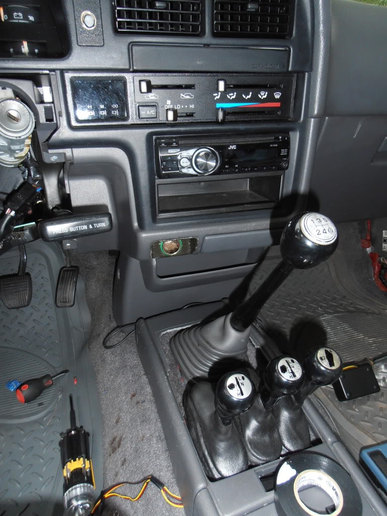

i didn't actually set it up, but i can give you the run-down. it's got 2.28/4.70 with a marlin adapter. one of the cases is an advanced adapter housing. i haven't driven off-road with the new setup, but so far i like having the option for low, double low, or 8x low (roughly). a 2.28/2.28 could work well, 4.70/4.70 is waaaaay too low, and a single 2.28 was too high for me sometimes. if you're worried about tunnel modifications, talk with rory from radesigns. he should be able to help you move all the levers forward (like mine)
hope that helps!

it all starts here:
https://www.yotatech.com/forums/f199...l#post51941082
and inside, so far

Wow, looks confusing.
I want!

Helps much, thanx! I have two 2.8'ers right now.... I need to figure out if I just want to go for the 4.7 now and stack it up against the 2.8 I just got. I definitely have some bearing noise in my tranny now, hoping its not also in the transfer case... It never has let me down and seems to ride really nice off road, never really having much of a problem keeping up... But man, I don't think I've ever heard one bad thing about dual cases from someone that has them. I suppose I could just get the adapter and slap these two together... Then I suppose I would definitely have to think of the shifter aspect, under and in the cab. I saw one guy that modified his standard bezel for twin sticks... It was a really sweet setup but I can't find the dang thread anymore! Grrrr! Lol.
I can't wait for some action shots! love the shots of your camper as well... Always look forward to those

Btw, that pic/set up is SICK! LOVE how you kept the plastic bezel!
