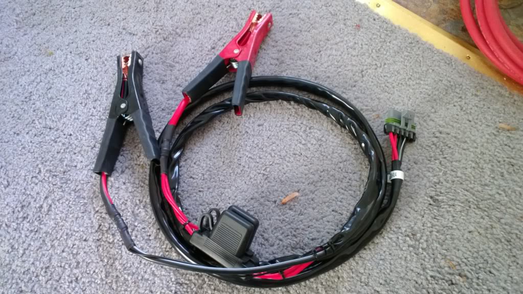

just thought i'd share my compressor setup. someday, i want to mount it properly on the truck, but for now, it works great
i used empty propane tanks because a) they were free and b) they are good through 300psi
air hose and jumper-cabled harness

it's like a mini contractor-style compressor, but with more cfm
