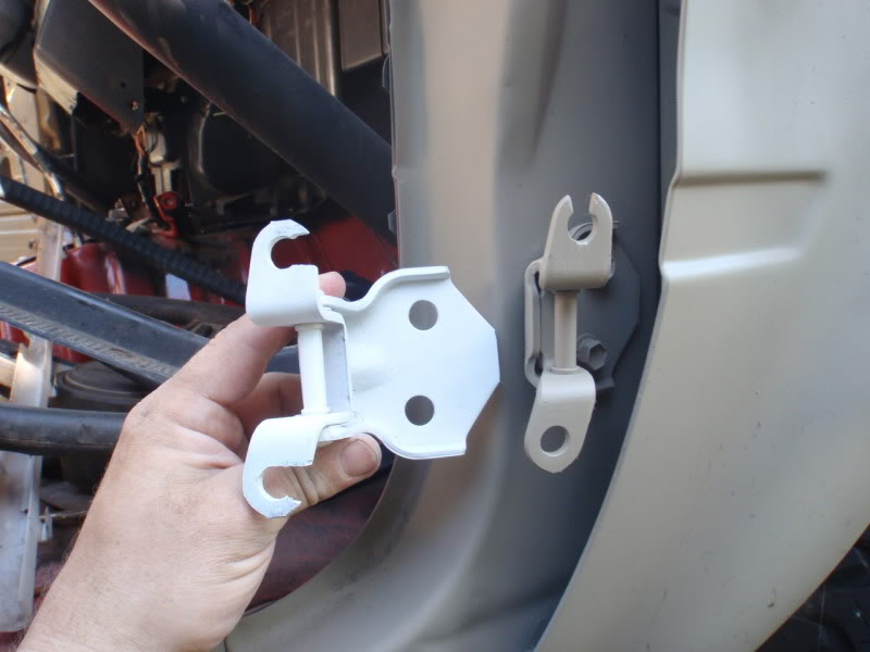

there's a much easier and cheaper way to do removable doors:
https://www.yotatech.com/forums/f31/.../#post51500394
(the hinge on the right, installed)

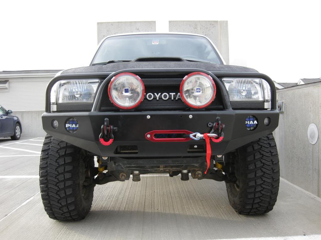

Thanks again for all the help man! I definitely couldn't have done it without you.
Old Apr 15, 2013 | 06:43 AM
  #2232
irab88's Avatar
iTrader: (4)
Joined: Jul 2010
Posts: 6,499
Likes: 37
not a problem. glad to see you got the fairlead on; looks slick! i still have to upload my pictures, i'll post 'em on your thread when i do. so while i did that on saturday, i re-wired my truck a bit on sunday. i put my hella's back on and did a 100% better job than before, and the difference is incredible; faster turn-on and brighter. i also rewired my aux-box for switched power instead of the switched ground i had before. it makes wiring the rest of the truck so much easier. and the old solenoid was on it's final legs. that's what i get for ordering off of amazon (the ebay replacement is much nicer ). lastly i added a large engine ground cable, which seems to work nicely, as in quicker starting and higher alternator idle output.
Thats a good idea. Might have to try it.

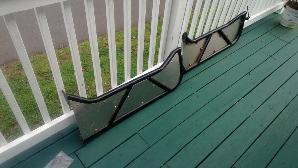

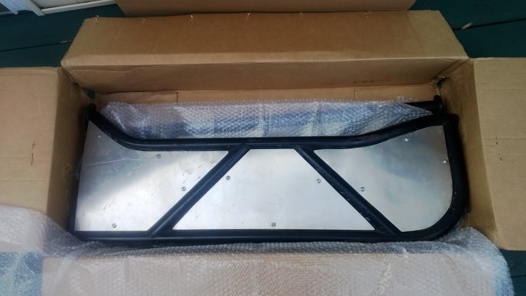

Those door are awesome. The more I look at your pictures, the more I want to get a set now! I like how they already have the skins on the outside.

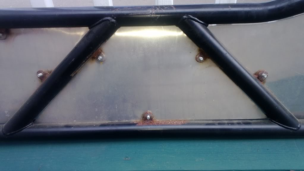

A little time with the wire wheel and prime and paint and those will be good as new...
just be careful where you park the tweakers love those kind of doors...

Damn those look sick! For the price you paid, I was expecting them to be completely beat to hell but all they need is a little TLC and they'll be good as new!

yup, just missing a tab (not hard to add)
darn right! i'ma get some of that self-etching primer, too.

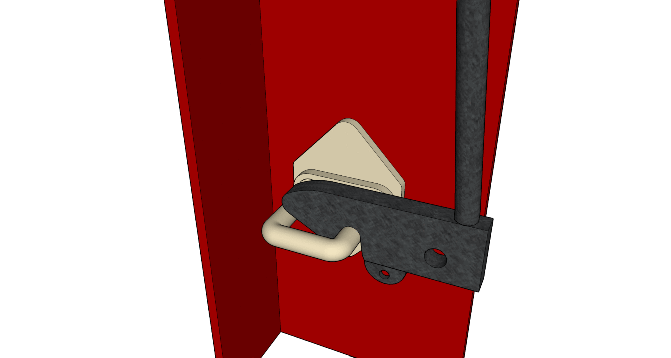

i can't wait to put them on. i'll wait until i have the right tools, though. the only thing i want to modify a bit are the latches. right now, they aren't slam-shut, so i was either thinking of buying some universal latches (less than $30 on ebay) or modify the existing ones like this:
there will be a spring attached to the eyelet at the bottom
I like the slam-shut idea, very cool. What tools do you need? I might have them and would be happy to help if I do.
