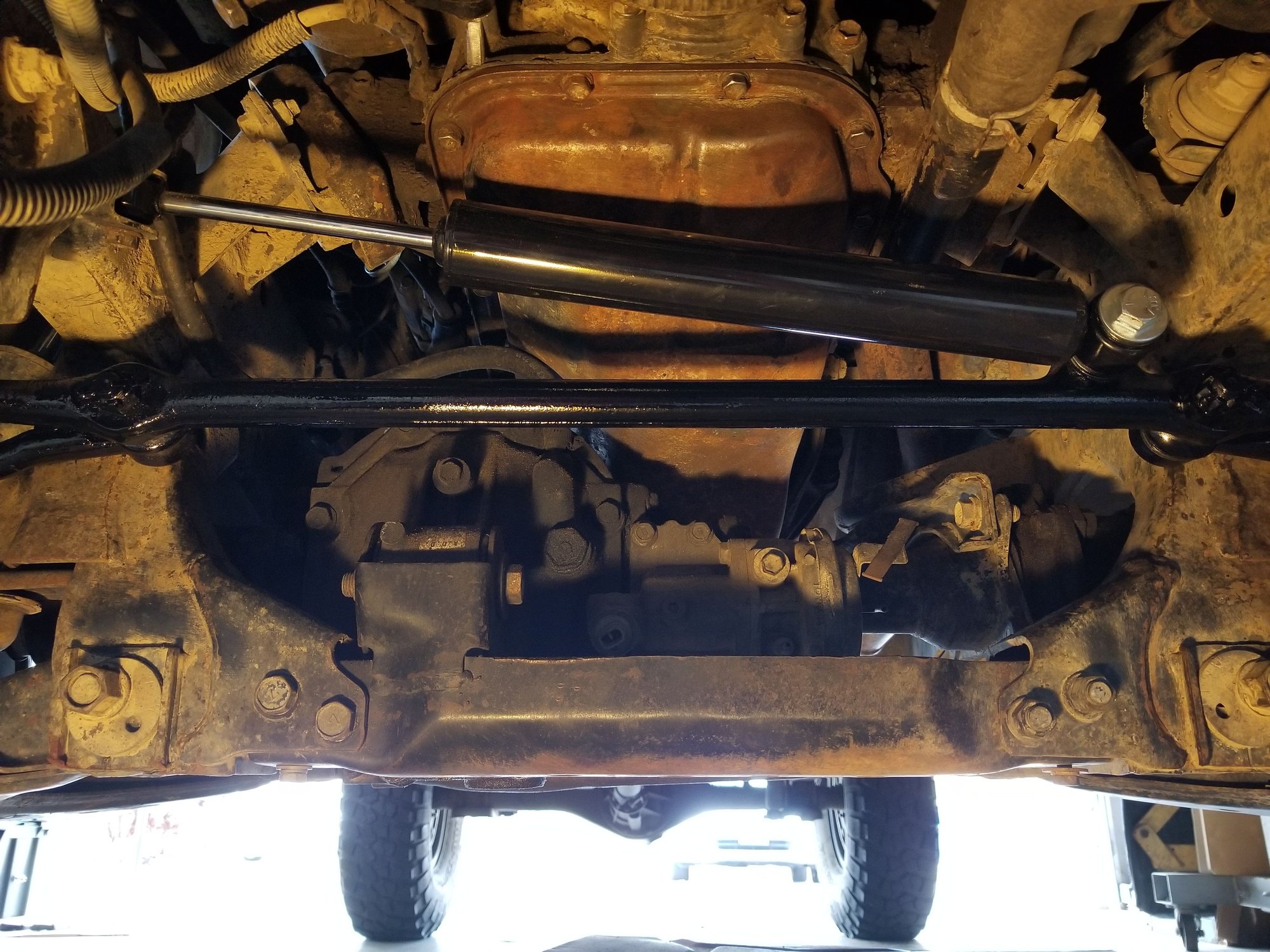

Saw 5fists thread where he changed his steering stabilizer and made me think of doing my own. I ordered the KYB from Rock auto, pretty easy to change, no magic to it. My old one I'm guessing was original and it has no damping to it at all anymore. Also I wire brushed and degreased the relay rod and tie rod adjusters and hit then with some black spray paint.

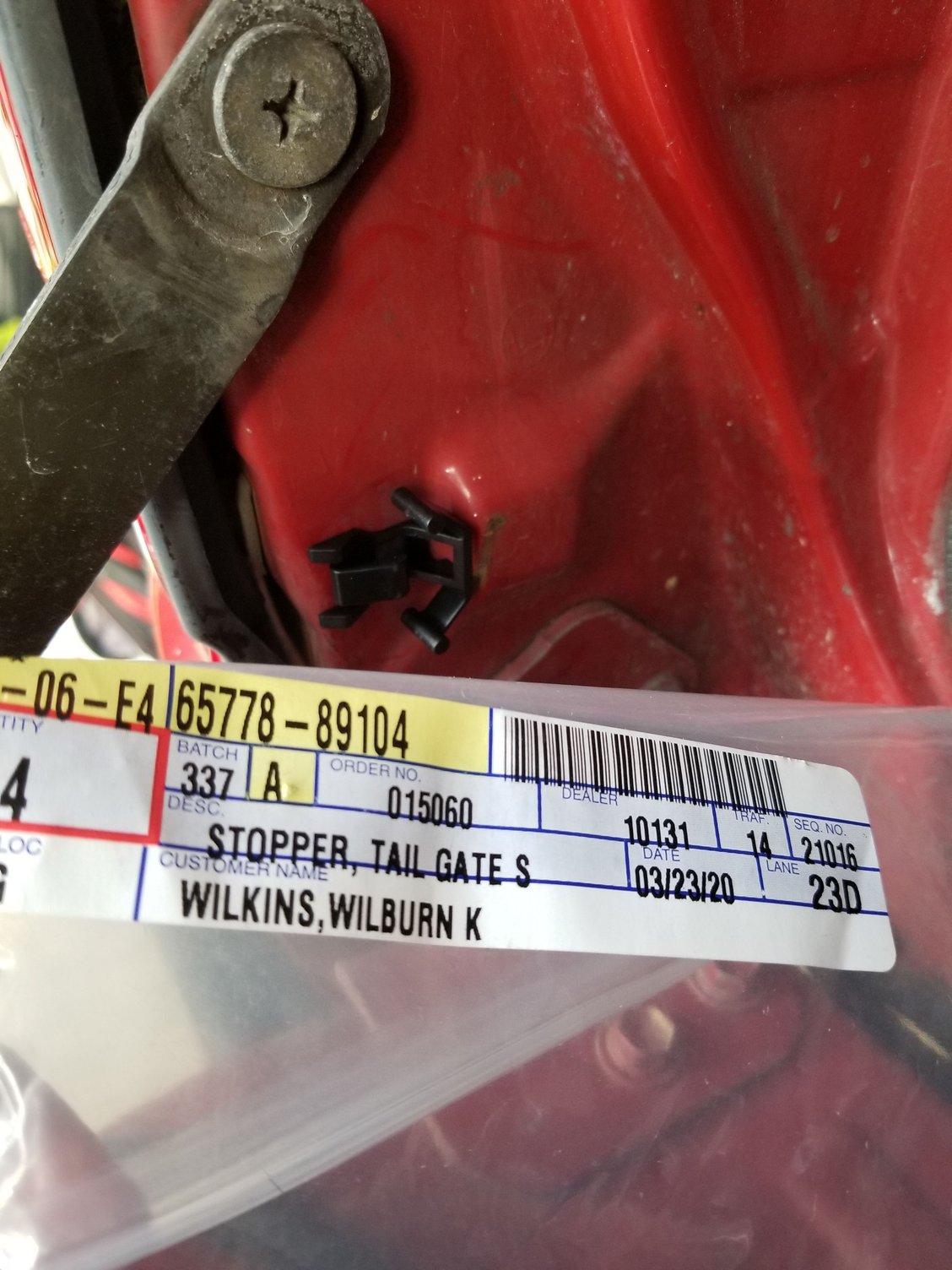

Put in an order for a few little nut bits and pieces from Toyota. One item was the tailgate strap stoppers. All 4 of mine have been busted since I've had the truck, pried what was left of old ones out with a trim tool, popped new ones right in. This is such a simple thing but boy it makes a huge difference not hearing those straps rattle around over every bump in the road.
EDIT: Adding written part numbers for tailgate stoppers: 65778-89104

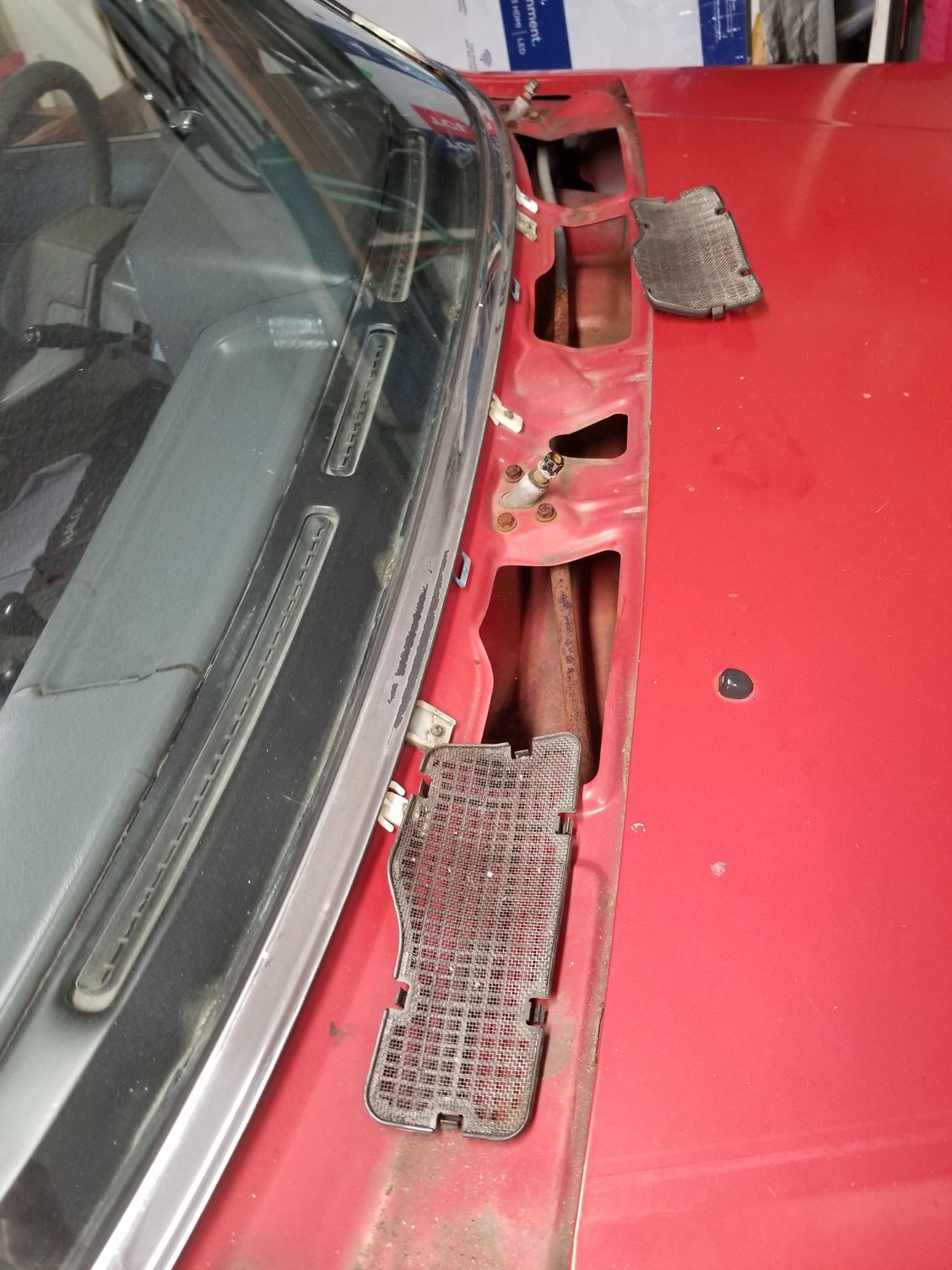

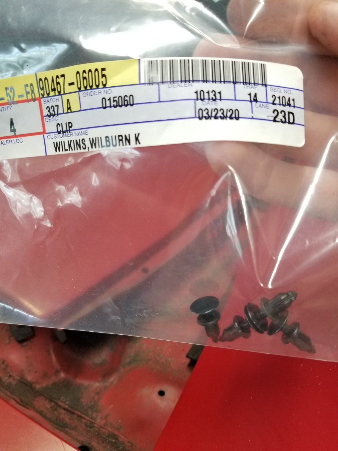

Continuing on my quest to occupy my free time, I finally installed the cowl opening screens that I harvested from the only first gen 4runner I've ever seen at the u pull it down here. As part of that Toyota order, I bought some new cowl clips, 2 are needed, because mine were already broken. The cowl is held in by a plastic trim clip on each end, then 3 Phillips screws across the middle, which you need a stubby screwdriver to get out.
EDIT: Adding written cowl clip part number: 90467-06005, you need 2 of them.
I think these covers came on SR5s and I'm sure do a good job of keeping debris out of there. I keep the 4runner in the garage, so there wasn't much down in there, but I shoved the shop vac down in there and sucked out some leaves and twigs.

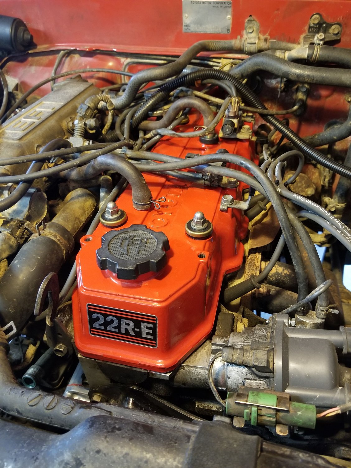

Continuing to find ways to occupy my time during this crisis, I cleaned up an extra valve cover that I've had stashed away for several years. I degreased it, wire brushed it, degreased it some more, then hit it with brake cleaner and finally painted it with some Rust-Oleum oil based paint. I happened to have a new 22re valve cover sticker, and ordered a new pcv valve and grommet. Paint has been dry for a few days, so today I installed it on truck.
Want to get some new vacuum lines here soon. Might go silicone.

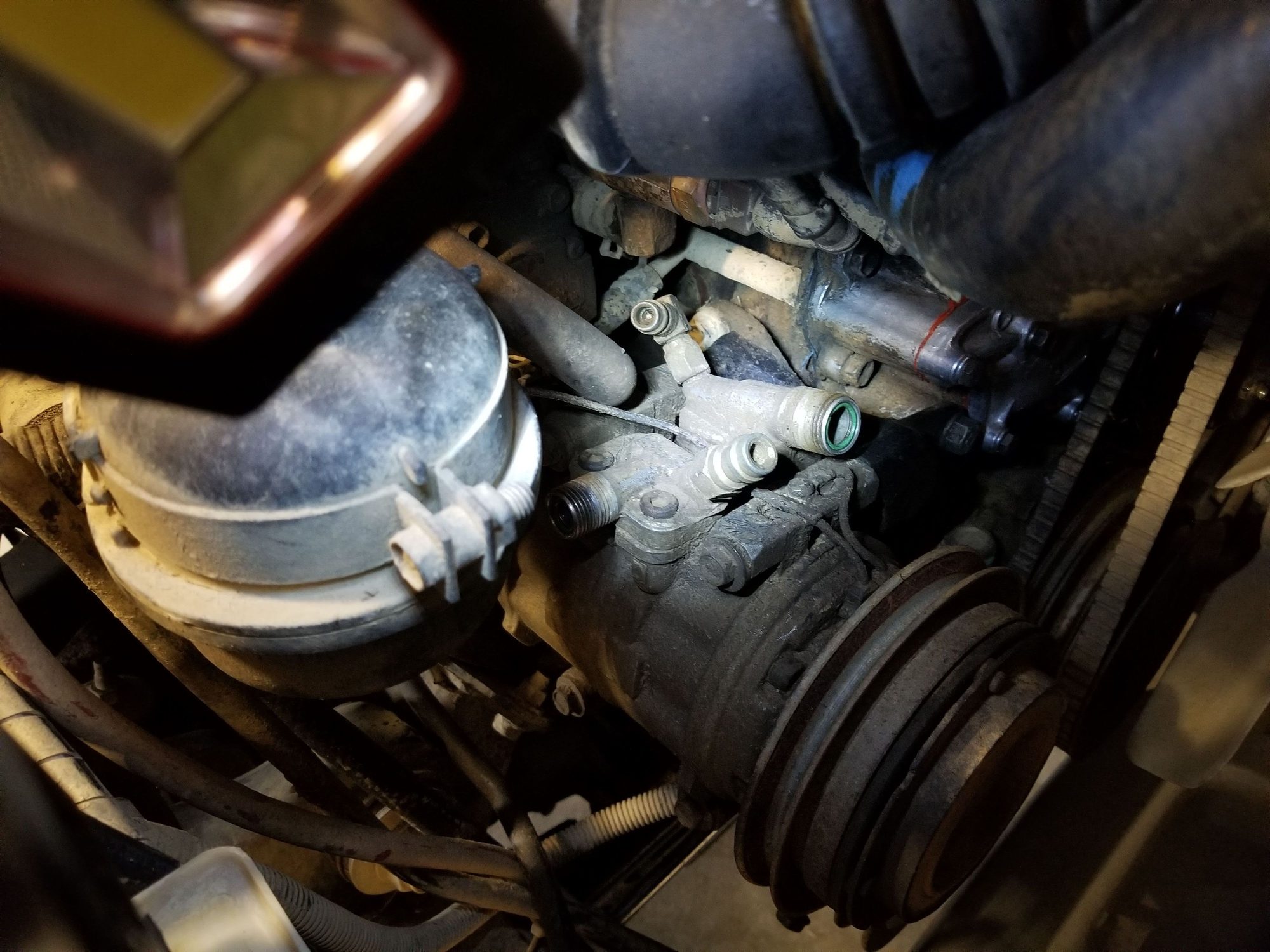

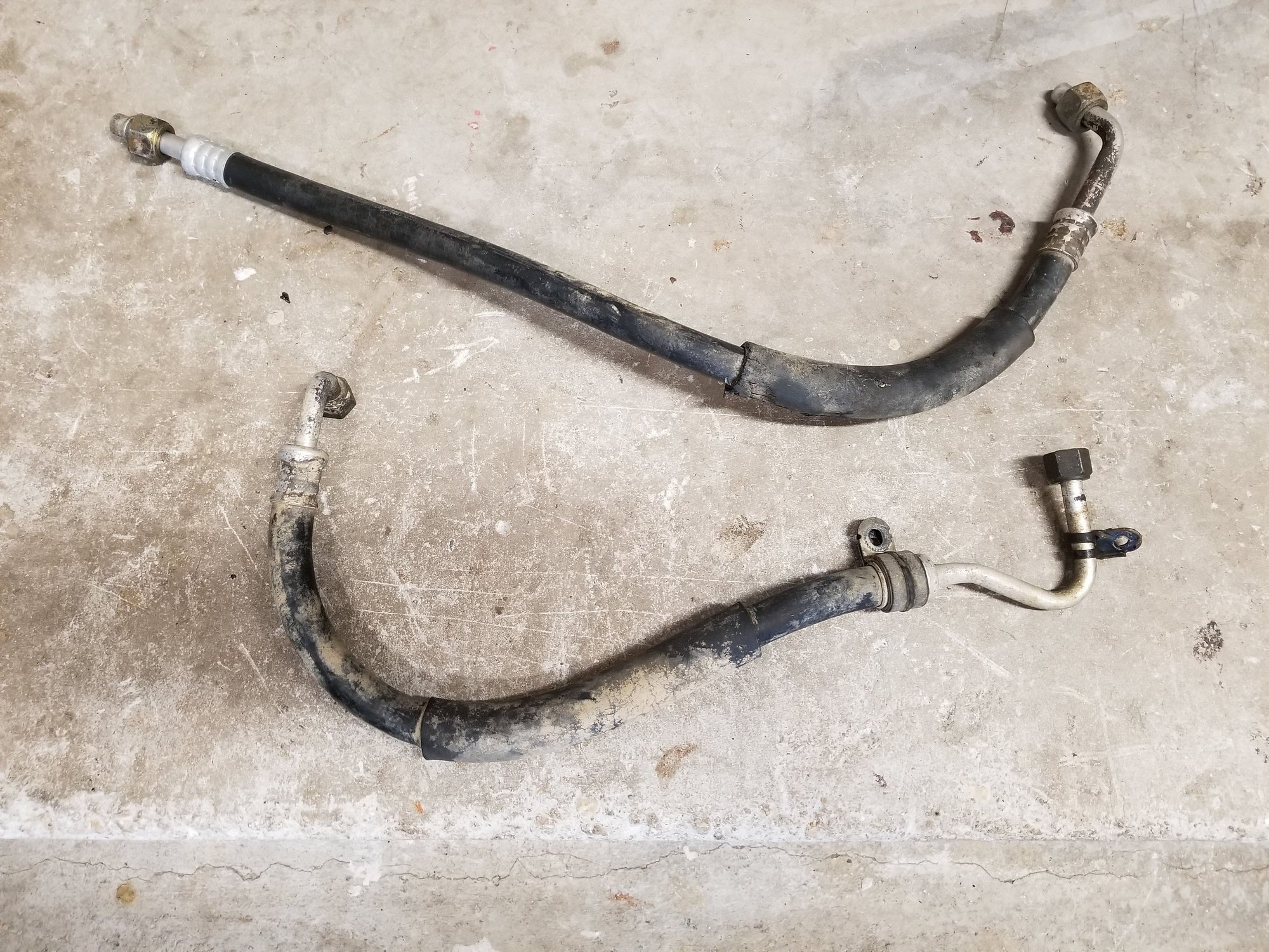

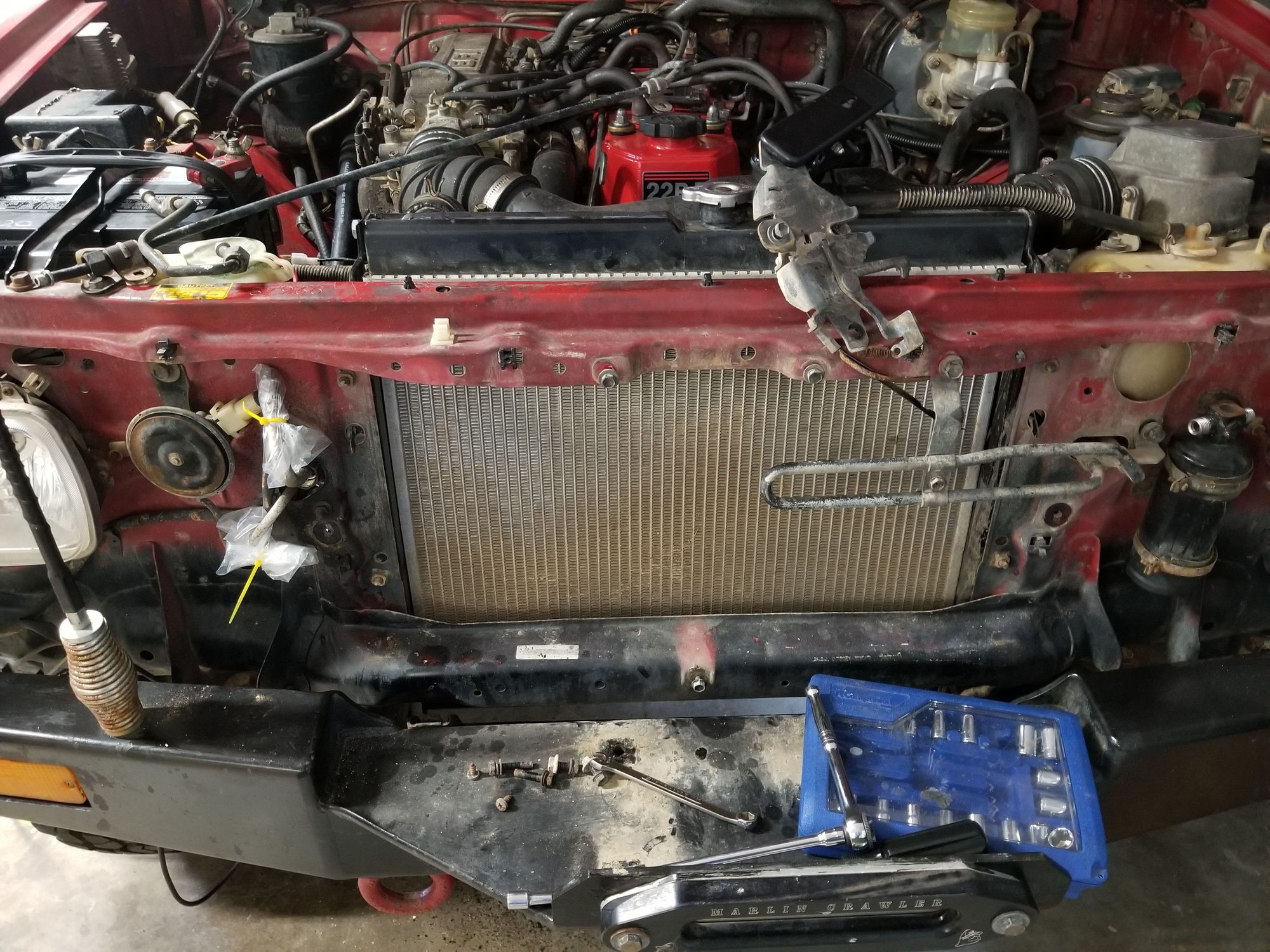

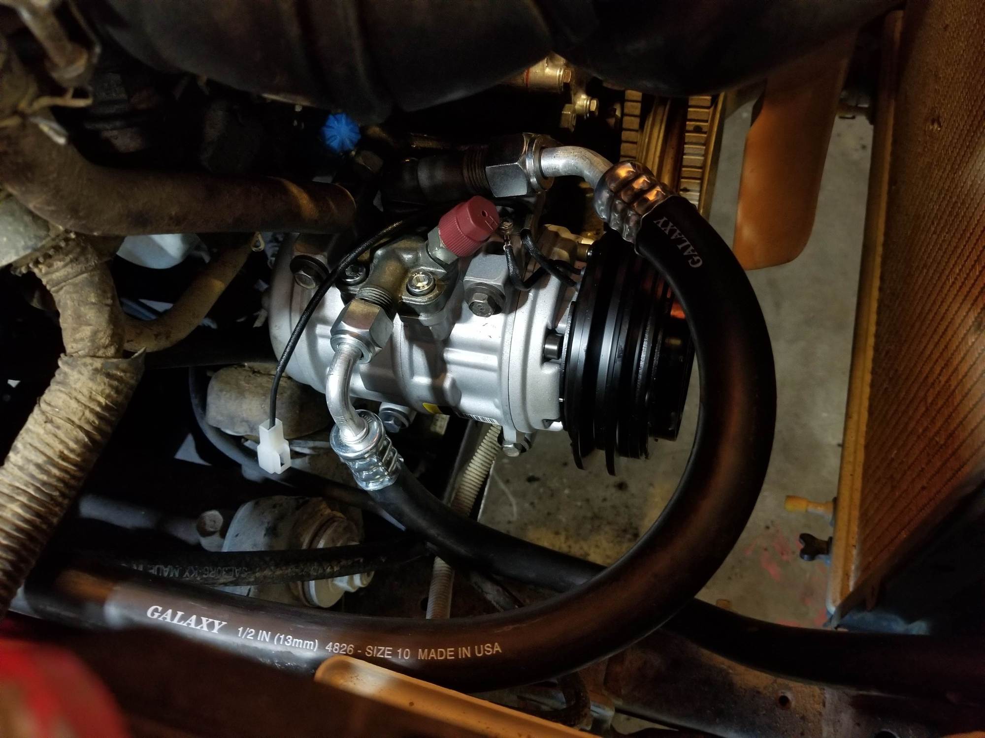

Been working on my AC, started off accumulating parts, and I removed my soft lines and ended up sending them to business called coldhose.com and they re-made the lines with all new metal ends and rubber hose, they did have to re-use one end that was sortof ? shaped.
Here's a shot of what my original hoses looked like:
And here's kindof what my original compressor looked like down in there, interesting that different years have slightly different manifold connections on top of the compressor.
Once I got the new hoses made, I started ordering parts. I ordered the UAC Compressor kit from Rock Auto, came with compressor, drier, o-rings, expansion valve and PAG oil. I also ordered the 4Seasons Evaporator, a set of new AC valve cores.
And, because of the issues this guy (https://forum.ih8mud.com/threads/how...unner.1210923/) had with a non-Denso exansion valve I also ordered the Denso expansion valve.
Notice my compressor already had R134a fittings, I thought I would need all new ones, but turns out I just put new valve cores in them and o-rings up inside them.
RockAuto was out of stock on the Denso Condenser (only option for my 4Runner), so I ended up ordering it from SummitRacing, but guess what, turns out it is being shipped from manufacturer and it is on some kind of backorder, so I'm currently still waiting for the condenser, Summit says it will ship on July 30...ugh.
So first up, my soft lines were removed and sent off to coldhose to be remade. Meanwhile I ordered all the above stuff, and then started some dis-assembly. I removed the compressor from the truck, 4 12mm bolts holding it on there. Then I started the evaporator removal. You have to pull the glove box and then you can get the evaporator box out fairly easily.

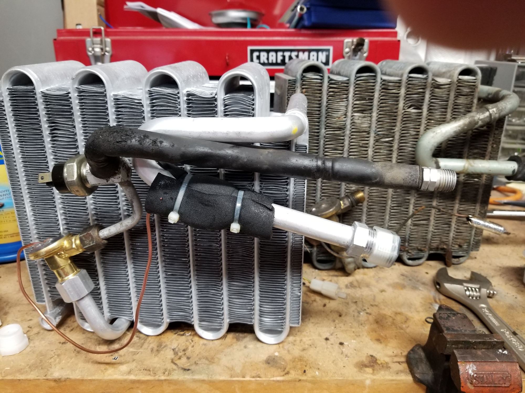

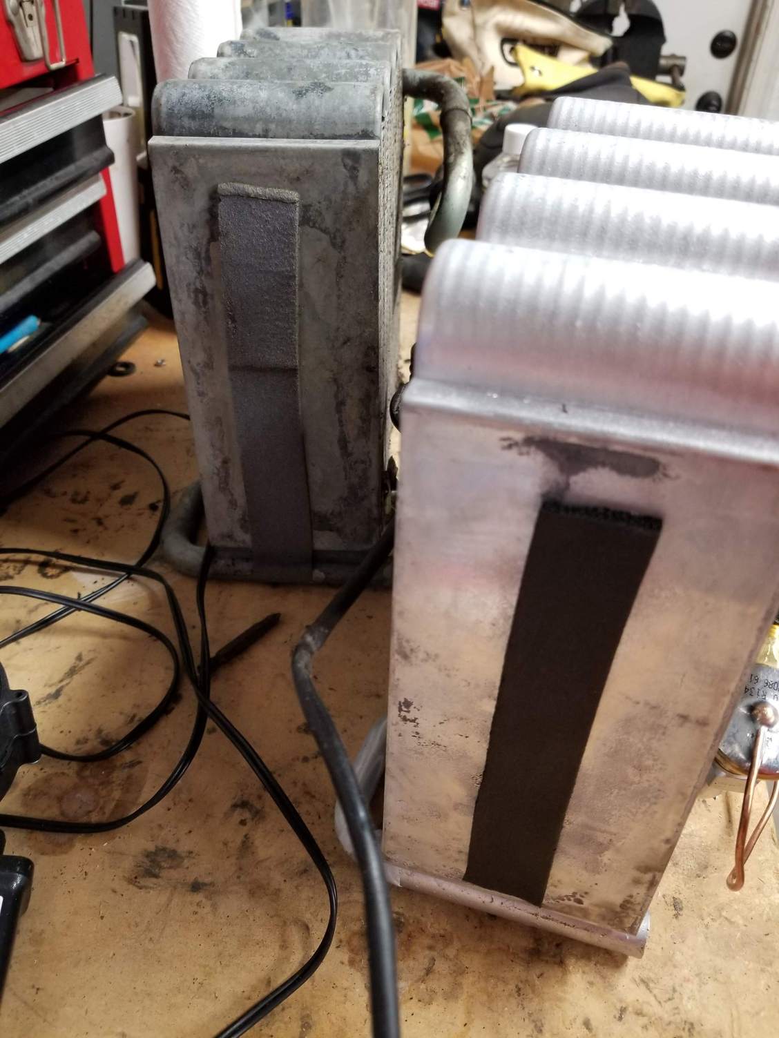

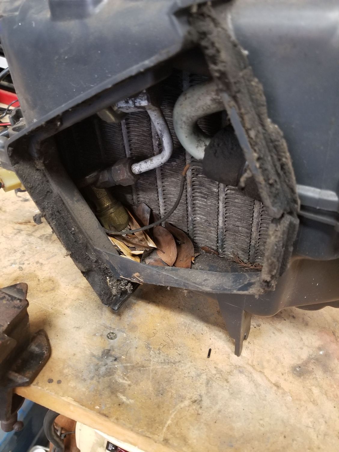

Here's mine sitting on the bench. You can see all the sealing foam has disintegrated, so I'll be replacing that.
Didn't take long for my RockAuto stuff to show up, here's my new evaporator sitting next to the old one. Note that the hardline with the pressure switch in it is not in the right position, I had just installed everything here and set it inside the evaporator box and noticed something wasn't right. The small hard line needs go BEHIND the larger evaporator line.
Couple of points I'll make here:
1) I dipped ALL orings in PAG oil before installing.
2) The little coil on the end of the copper line from the expansion valve, I followed the advice from the ih8mud thread listed above and I put heatshrink on it before attaching it to the evaporator line.
3) I cleaned out the empty evaporator box with degreaser, a brush, and the water hose and let it dry overnight. I also scraped all the remaining old foam off the edges of the evaporator box in preparation to put new foam on.

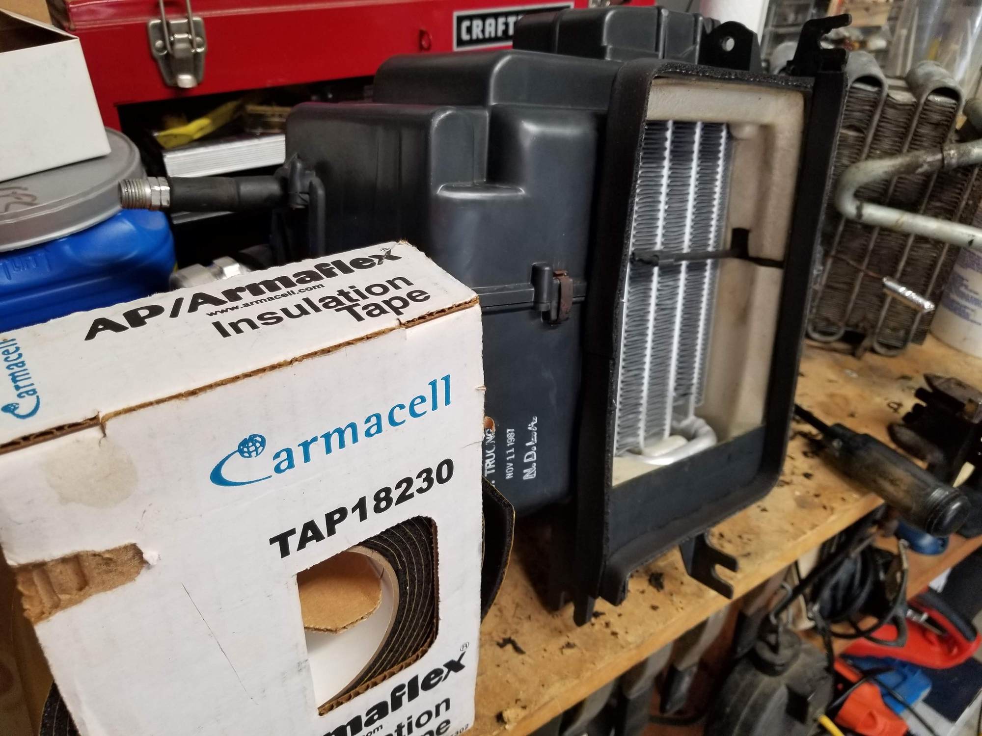

So with new evaporator all hooked up properly and that little hardline BEHIND the large evaporator line, I put some pieces of foam tape on each flat side of the evaporator to match the original. Then put it inside the freshly cleaned evap box. Got the little temperature probe thingy in place on the other side of the evaporator, which you'll see in the 2nd pic below.
This pic shows the foam tape that I used, I cut it into thin strips to fit on the edge of the evap box.
So with evaporator box all ready to go, I simply shoved it right back into position in the truck. I kindof aimed it where it needed to go, met a little resistance because it's hard to line up the holes in the firewall when you can't see them, so I went around under the hood and used my fingers to guide the evaporator lines and then went back inside truck and pushed, and it went right in.
Then I turned my attention to the compressor. It was VERY hard to free the manifold bolts on the original, but I soaked them in WD40 overnight and tried again with just a big allen key, and they broke loose...turns out I do not own a set of allen sockets.
Cleaned up the manifolds and then went to install them on the new compressor, fresh o-rings dipped in PAG oil, installed them, and then I tipped the compressor on its side accidentally and a bunch of PAG oil poured out of it. I did not realize it came filled with oil...my bad. Since I didn't really know how much poured out, and they shipped me a fresh container of it anyway, I just dumped all of it out into a container. I think used a syringe to squirt about 45mL into the suction side, 10mL at a time b/c it was a 10mL syringe, while slowly turning the compressor clutch. I plan to put another 40mL into the drier.
Cleaned up the R134 conversion fittings that were already on there, removed the valve cores, and put in a fresh o-ring where it seats onto the R12 fitting and then a fresh valve core. I dipped the valve cores in the PAG oil as well.
With that all done, I cleaned up the 4 compressor bolts with a wire wheel and installed the compressor and hooked up my new softlines.

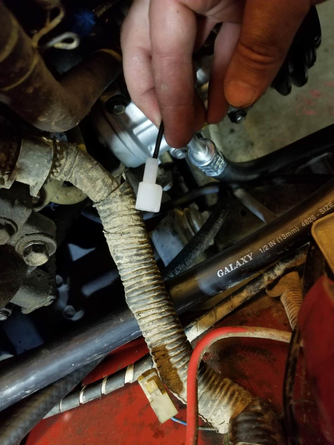

It was about this time I noticed that the darn AC clutch wire was too short to reach...wish I had noticed that before I installed it. So I cut the connector off the compressor side, added in a section of black wire, and re-soldered the connector, now it reaches.
This kindof brings me up to current state...which is waiting on the condenser to ship from Denso. Meanwhile, old condenser is out, and I have sprayed brake cleaner and compressed air through all of hard lines that I will be re-using. The hardline that goes from the evaporator to the condenser is long and has several twists and turns in it, I could not for the life of me snake it OUT of there, it has to go through a hole in the front brace and I just could not see a way to get it out...so that line I cleaned in place and blew brake cleaner through both ends of it, then compressed air, the smaller lines I was able to fully remove and clean away from the truck.
Some other misc things that I bought to replace while I'm doing this are a new AC belt, a new AC idler puller from Toyota, and a new grille from eBay because mine was beat up.
Once I get the condenser, I'll be following this thread from scope103 as far as charging the system https://www.yotatech.com/forums/f116...-r134a-284801/, I've done it before, but it's been a while and I'm certainly not good at it. I do have a vac pump at my disposal, but I'll need to buy or loan the gauge set.

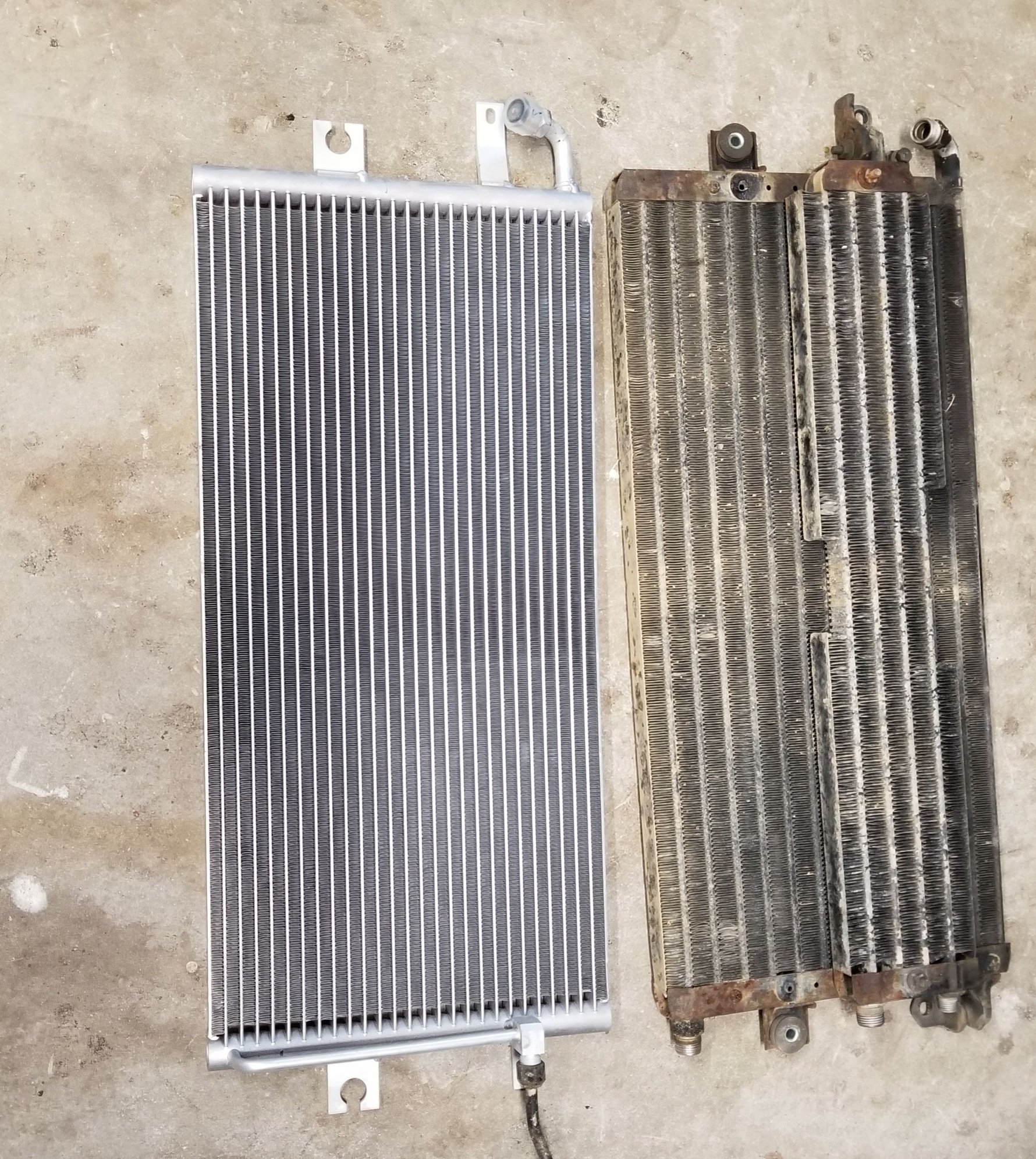

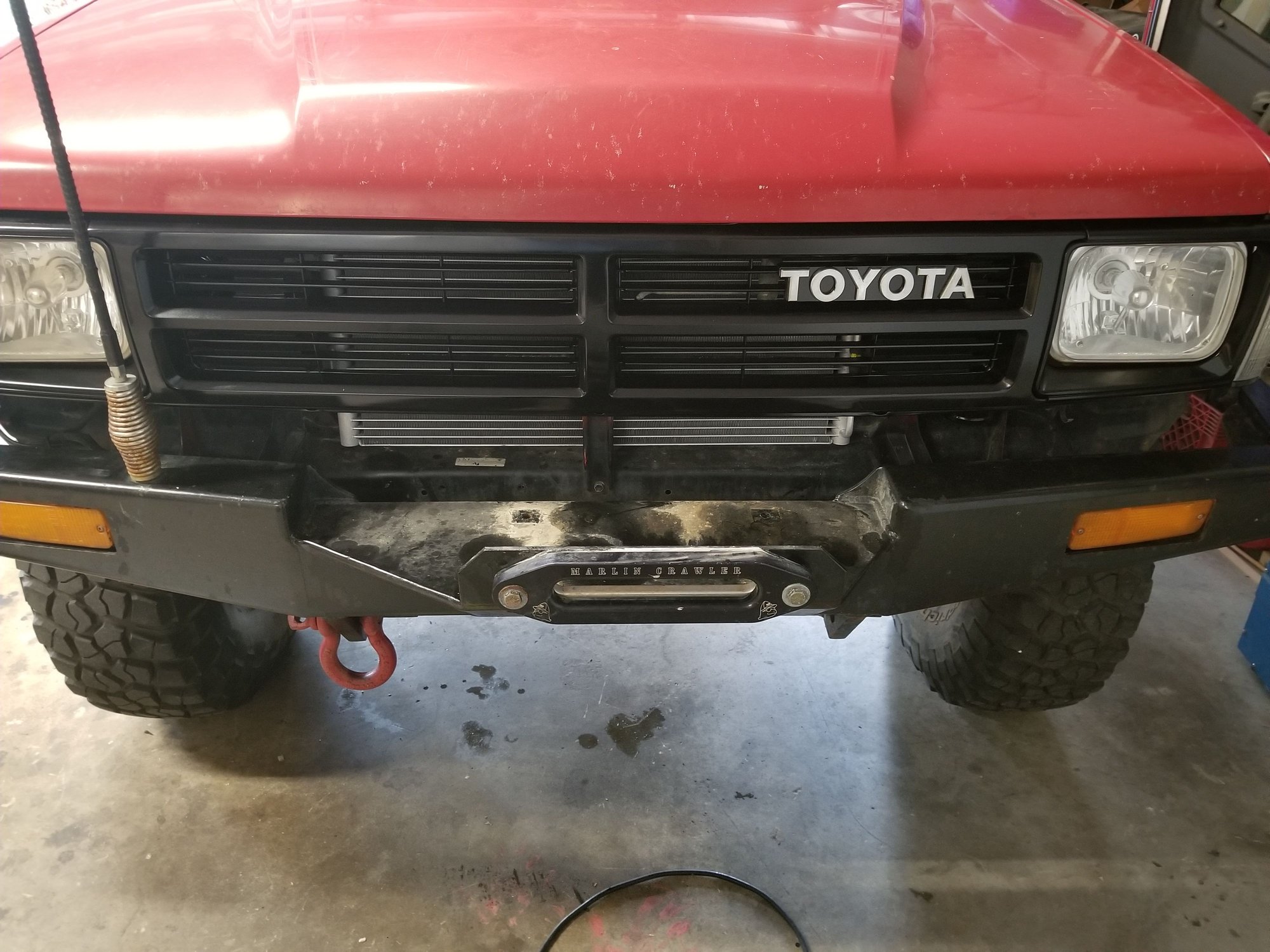

Long saga on the condenser, Denso is on some kind of major backorder, so after waiting weeks I was going crazy trying to figure out another option. I made a separate post here and on mud trying to get some advice, what I finally ended up doing was buying the Pacific Best condenser. I saw it on eBay, almost dismissed it immediately because it did not have the extra condenser section that the Denso has. But it looked like the fittings were in the right place, so I went to PacificBest website to read more about it. Turns out it is parallel flow. Found it online for $71 shipped and figured I'd take the chance.
Here it is next to my OEM. I'm no AC expert, but the PBI one has 26 freon passages where the OEM has only 17. I hope that means it will be more effective.
I installed it, fit nicely. Tightened all connections, and then grabbed the loaner gauge set from auto store. I vacd it for over an hour, and then let it sit for another hour and no leaks.
Old Aug 8, 2020 | 04:38 PM
  #918
coryc85's Avatar
Joined: May 2005
Posts: 1,977
Likes: 231
From: S. FL

I reused my original pressure switch. I did not see an aftermarket one available, so it might be a dealer only item, not sure.
I did not know that the Spectra condenser was parallel flow, but then again I did not see a Spectra one listed for the 4Runner, only the truck.
So after the vacuum, I filled the system. I put it 2 cans or about 680grams. Technically it needs 700grams, but I was watching pressures and I did not want to overfill. After filling, I left it overnight since it was late by this point.
Next day, I checked pressures again, I was getting around 35 to 40 on low side and 185 to 195 on high side. It was 80 ish, maybe 85 degrees in the morning inside my garage.
I set the ac idle up to about 1200, then I put fan shroud back on, which had not been on in years (still missing bottom lip of shroud) and then I test drove the truck.
AC is cold, my temp probe on my multimeter is not working so I don't know exactly how cold yet my vent temps are, but I'd say comfortable. My windows are not tinted, and it got up into low 90s with 70 percent humidity and after a few minutes of driving it was getting comfortable in truck.
I want to get that fan shroud bottom lip on there because when stopped in traffic, air is slightly less cold. While moving it feels good.
Also, I'm no AC expert.... The Toyota TSB says to put in 700grams, I've only put in 680, but my pressures seem ok. From what I've read, low pressures are a sign of low charge, but my pressures don't really seem low.
I could always add a bit more refrigerant, and I might still do that, but I need to get a gram scale so I can monitor how much I've added.
For now, it is working and I'm thrilled. I can actually drive this thing with the windows closed. Might even look into getting my windows tinted.
All buttoned up, freshly painted grille.
