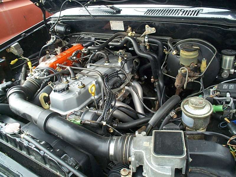

Decided it was time for some general maintenance...I've had a Denso cap & rotor for a while sitting on my workbench. So today I ordered the Denso plugs and Denso plug wires from RockAuto, hard to beat their prices for the Denso stuff. My underhood is a bit messy, the plug wires are kindof zip-tied to the power steering hose to keep them off the exhaust...what I really want is to make them look like this:
Note:Not my engine

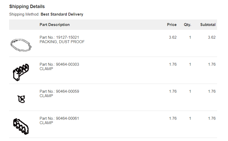

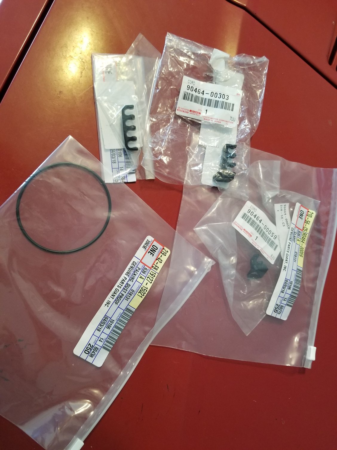

I'm missing the 2 keepers that attach to the tabs on the valve cover, I have the tabs, so I found the keepers on the ToyotaPartsDeal website for a reasonable price...and I realized I need the o-ring that goes under the distr cap, so grabbed that as well...
Should be here by the end of week (I think) to be able to install this stuff.

Originally Posted by NEyoda
Beutiful engine bay.
Hah, YES it is a beautiful engine bay, unfortunately as Jake says, it is not mine....I do hope mine looks closer to that one here soon!

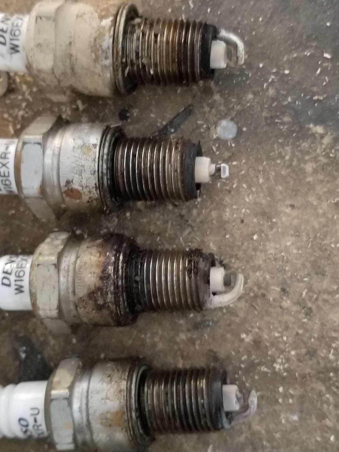

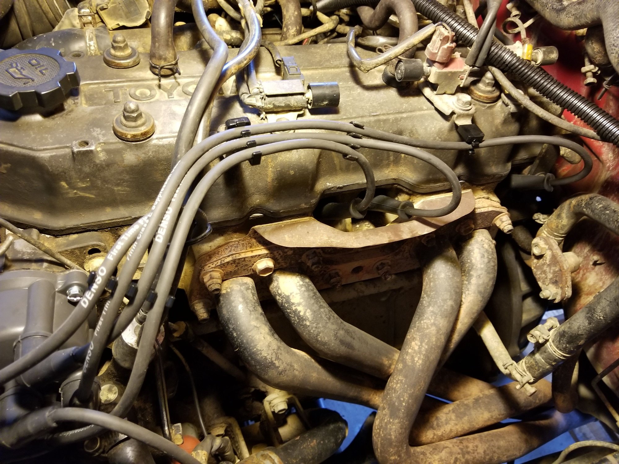

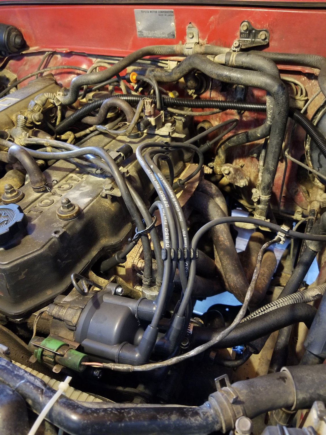

Received my plugs and wires from Rockauto so decided to get started on the work. Old plugs were also Denso, just for kicks I checked the gap, old ones were all about .041, new ones came gapped to .031, which I verified on each.
I'm still waiting on my little plastic keepers and distributor cap oring, but I got all the wires routed where I think they need to be. Also trimmed a couple of extra long vac hoses and routed that one coil wire that goes from under intake over valve cover to coil around near rear of valve cover over to brake master and to coil. It barely reaches...I also wrapped it in some new wire loom.

Took a break to eat and make that previous post and mail showed up with my package of Toyota parts.
So good to have the keepers to keep wires off exhaust. Also my oring was crispy and hard, probably was original. Here's everything installed.

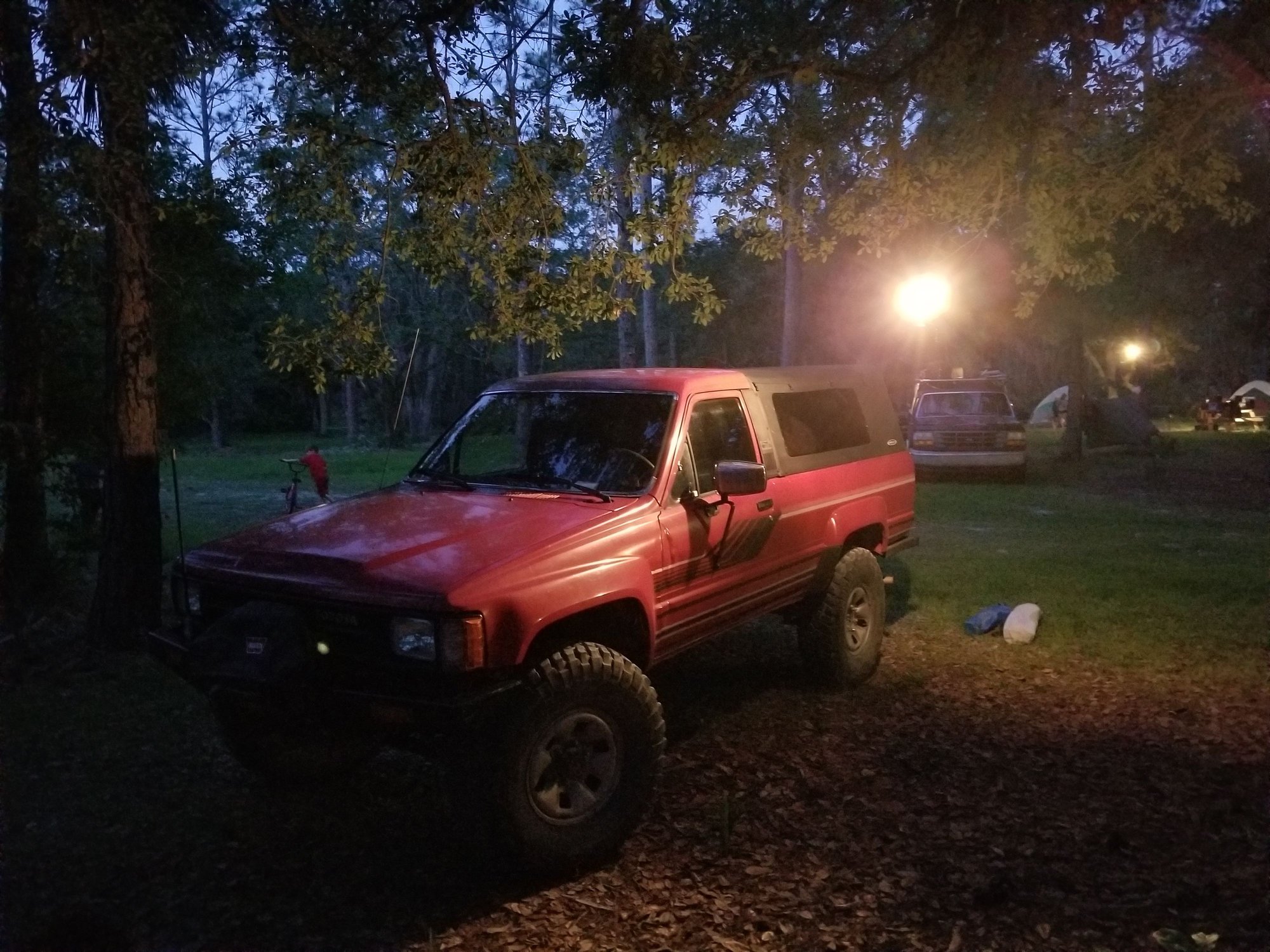

Took the kids up to Christmas FL to camp with my buddy and his 3 boys. My buddy is active in a FL Coleman group, so this was their spring Meetup.
From my house to the campsite is about 170 miles, boy the old 4runner cruises nicely on these flat FL highways. Here it is at camp by lantern light.

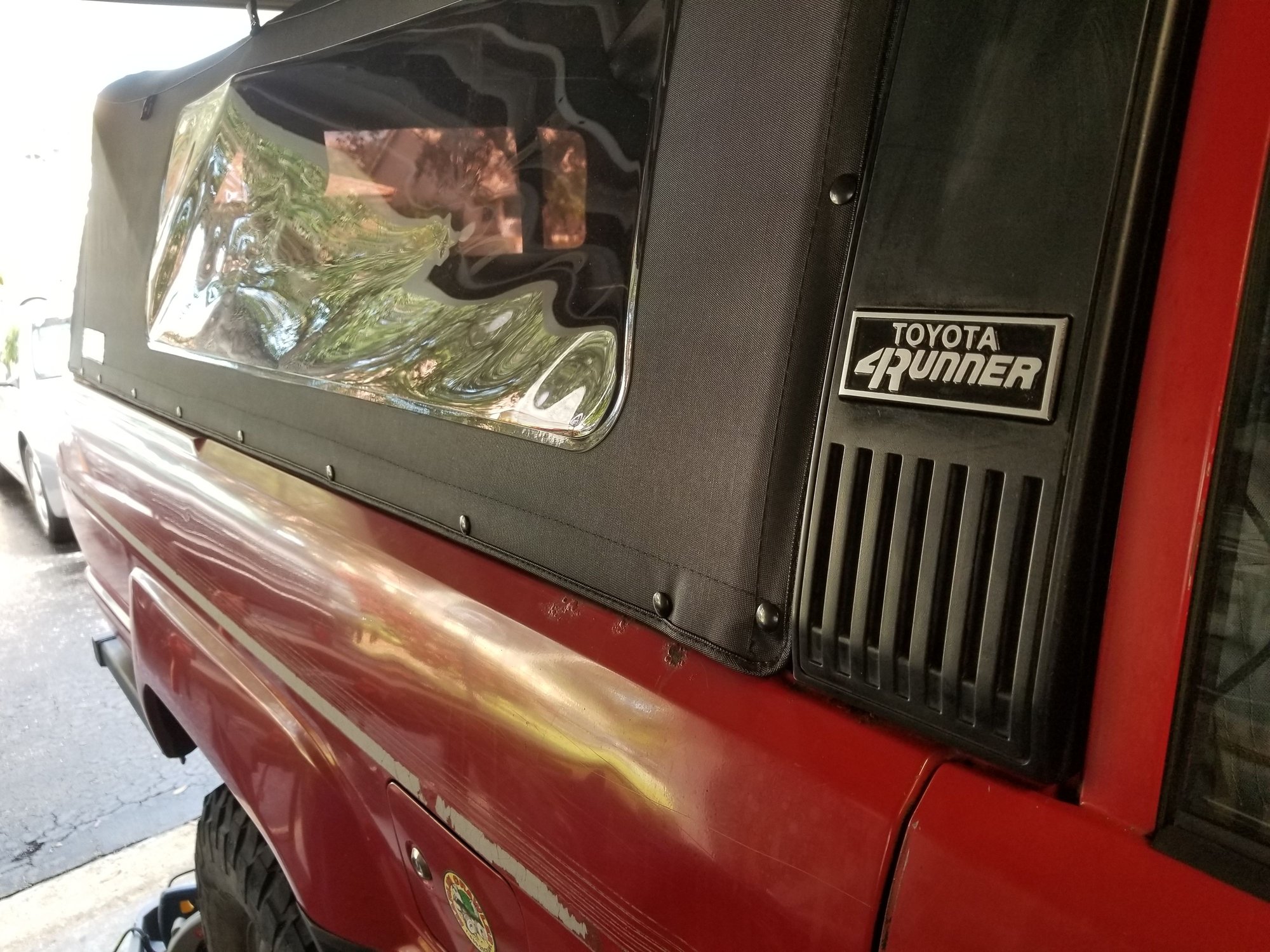

My side emblems have bothered me for a while. And I've been emailing Brad Hicks at bh3d printing for a long time and he finally came out with some that are like his aluminum enameled landcruiser badges... They are awesome. I have what I think is the very first set.
