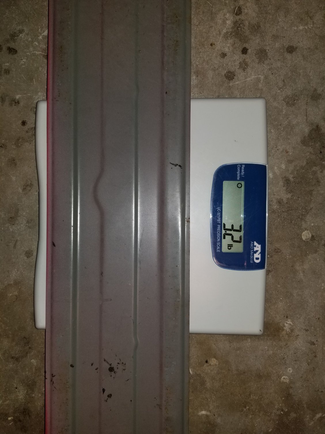

Tonight I weighed the items I removed from tailgate.
Regulator and motor: 6.6lbs
Inner tailgate panel: 3.2lbs
Glass:13.6lbs
The carpeted trim is back on otherwise I would have weighed it as well. Total weight removed is 23.4lbs, minus whatever the new panel weighs. I'm sure it will be a net savings of over 20lbs.

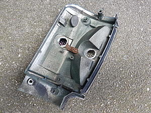

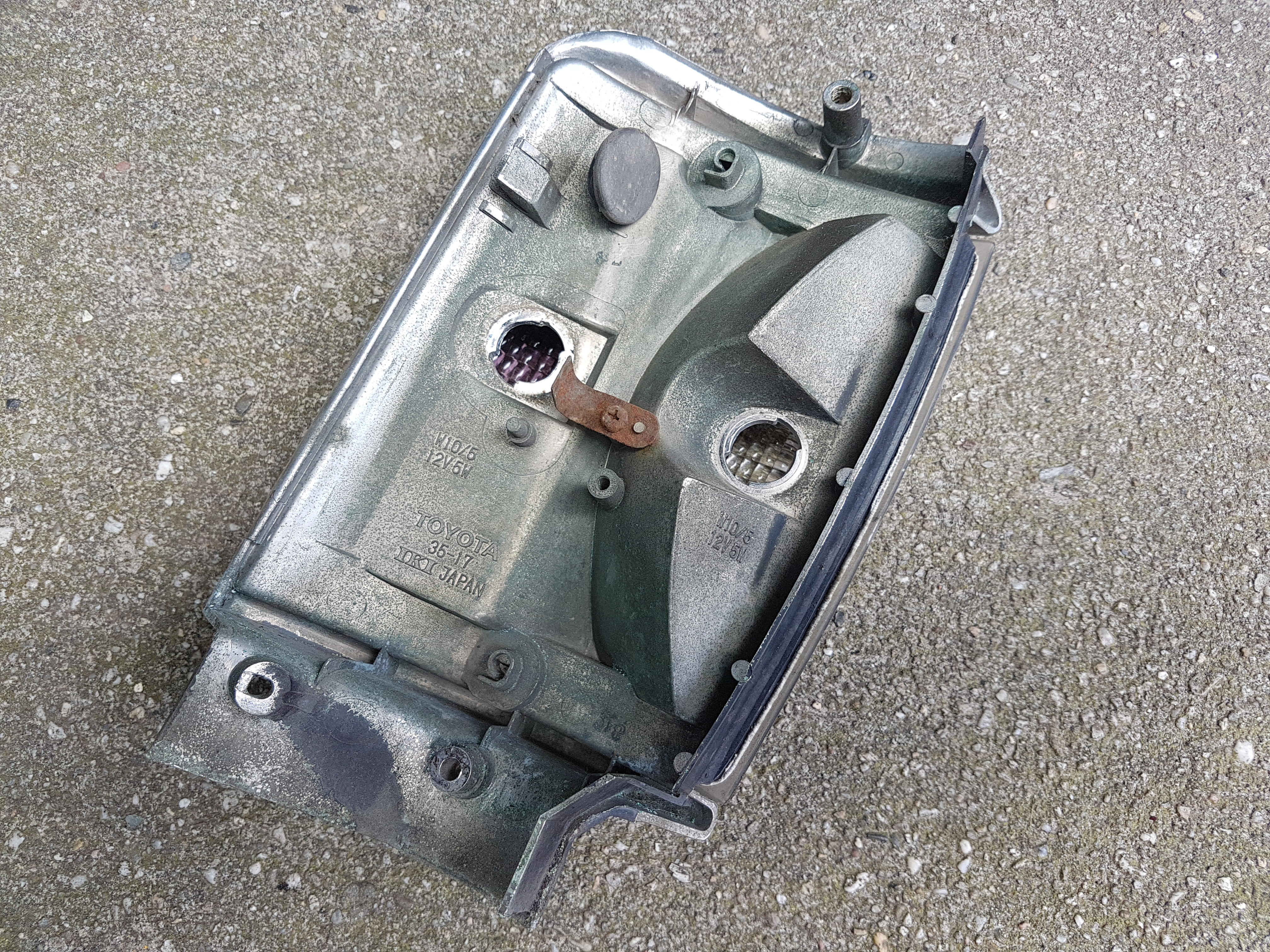

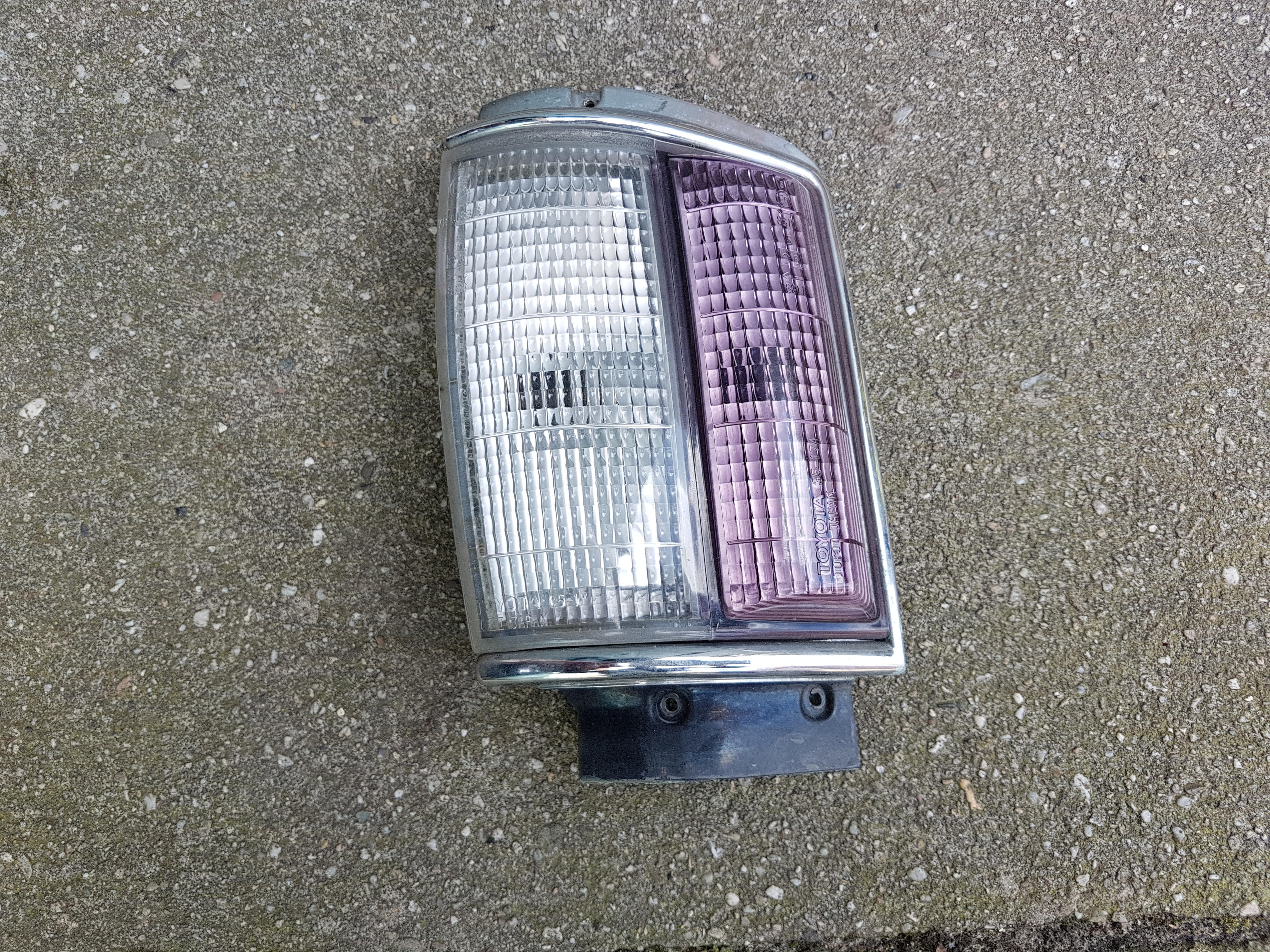

Mine're pink for some reason I don't know.
Attached Thumbnails coryc85's 1988 4Runner Build-Up Thread-20170426_145857.jpg   coryc85's 1988 4Runner Build-Up Thread-20170426_145652.jpg
Could be a styling thing. Our old Honda Civic also has pinkish "clear" lenses.

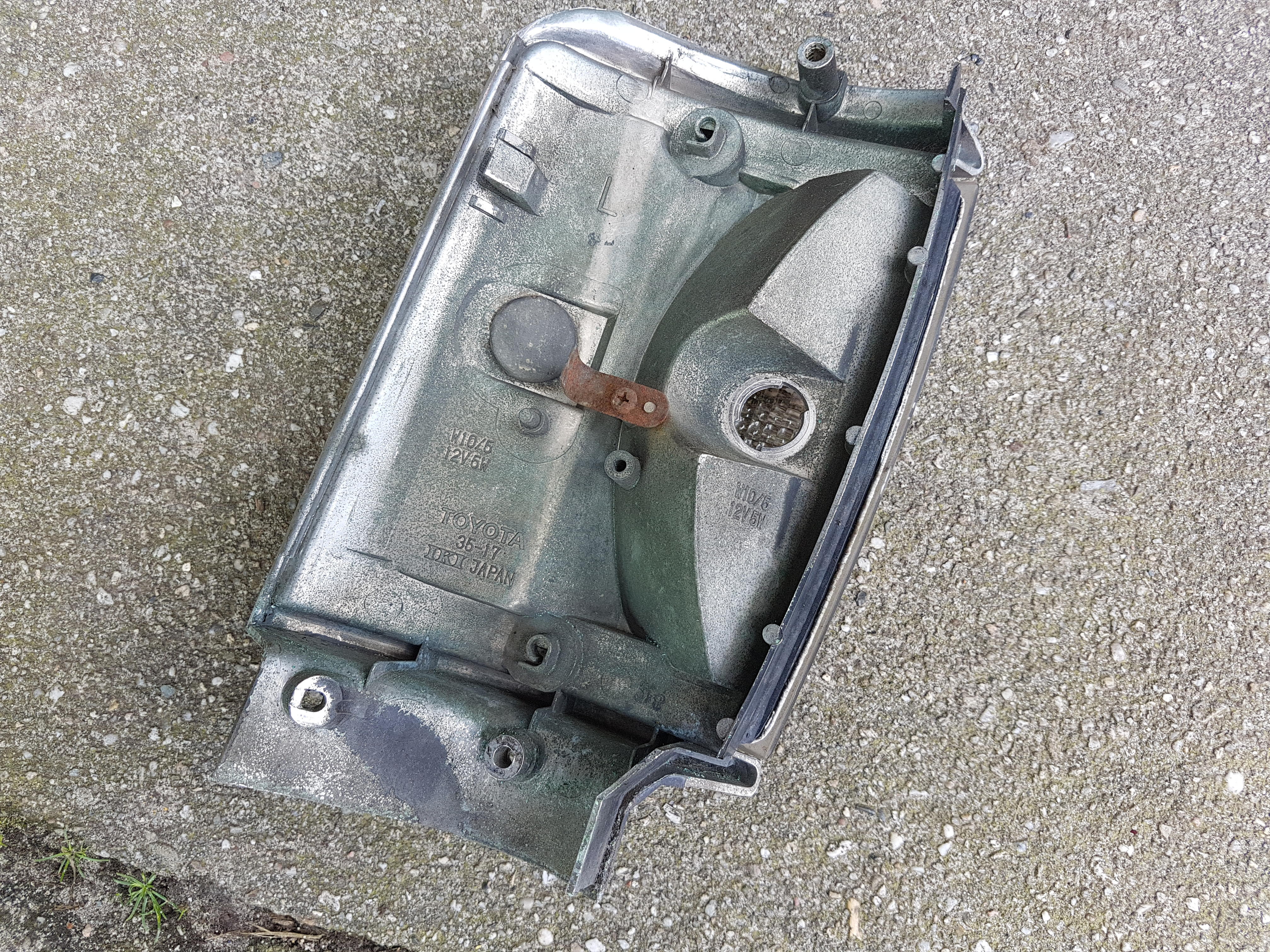

Originally Posted by coryc85
SomedayJ - well yours look like factory Toyota, at least they say Toyota on the back of them. Mine are cheap aftermarkets from Thailand. BTW, what country are you in? In your truck, are those "pink" lights also turn signals? If so, do they blink in unison with your bumper mounted turn signals?
My 4R came from Germany. The corner turn signals don't blink in unison with the bumper turn signal ones, in fact, the holes came blocked with a rubber piece/plug (see photo attached). I'd like to wire them in parallel as RAD suggested.
Attached Thumbnails coryc85's 1988 4Runner Build-Up Thread-20170426_145709.jpg
The plugged hole is behind the pink / corner-facing light, correct? Yes, put a 194 or 921 LED in there and connect in parallel with the bumper turn signal.
Front facing will be marker light, side facing will be turn signal.
or... IF YOU USE INCANDESCENT FOR BUMPER TURN SIGNAL, we can wire so BOTH bulbs in the corner housing will be markers, but will blink alternately with turn signals, KINDA like the way MY side-facing marker lights / turn signals are wired now
Enhanced visibility when turning / changing lanes...
