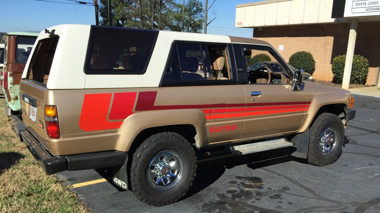

Originally Posted by coryc85
Your 4Runner is very interesting, I've never seen that color\stripe combination, but I like it. The blue 4Runners have always been my favorite.
Ah! I prefer red color and the American stripes style in the 4Runner first gen.
I belive my 4R stripes came in the European and Asian 4Runner market.

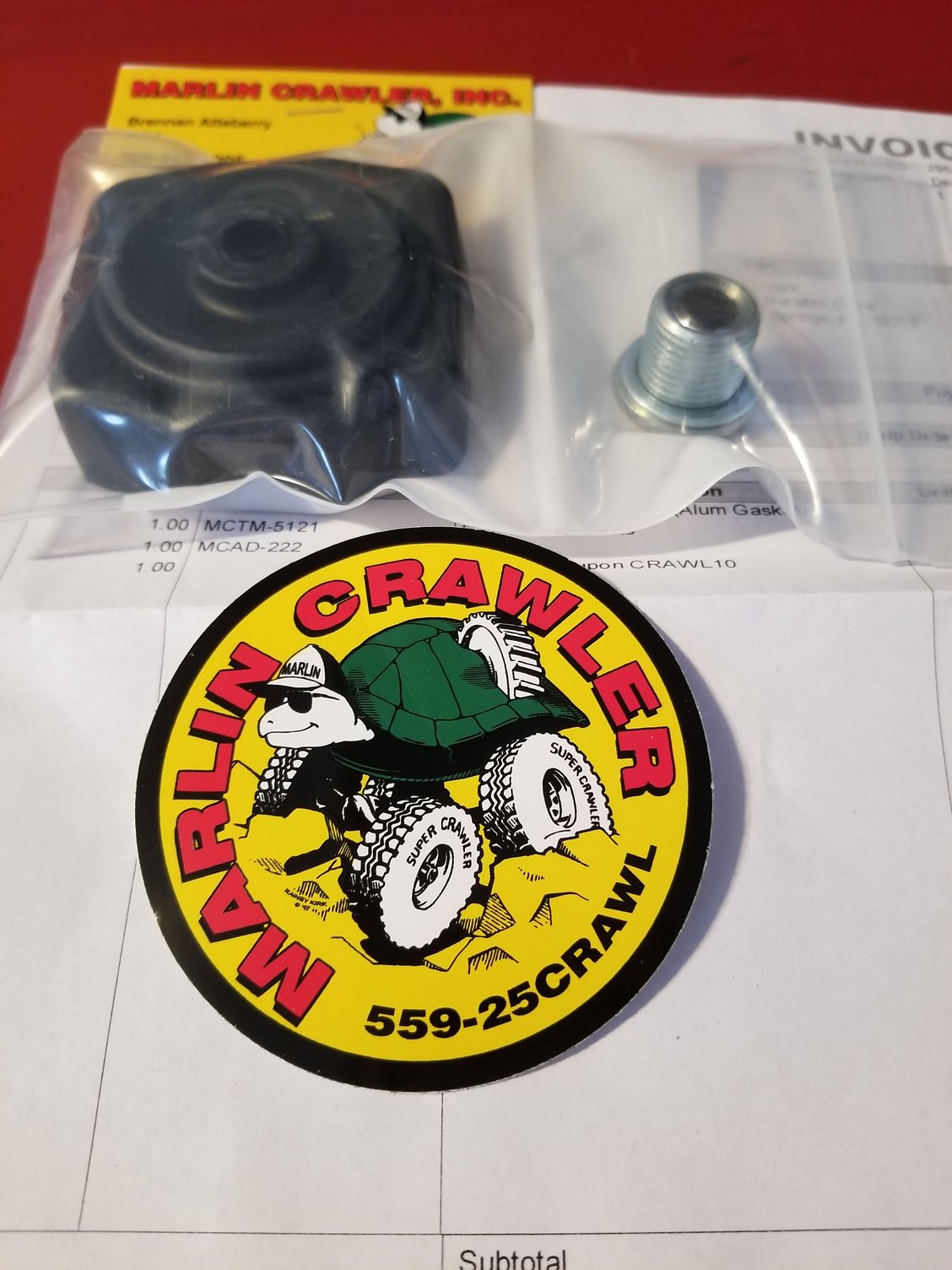

Small update. I bought a rubber shifter cover from Marlin crawler, the small square one, and I got a low profile tcase drain plug.
Install of the shifter cover is nothing special, but since I had to take the shifter boots off I took the opportunity to route the power cable for my center console under the vinyl floor.
Continuing on, when I installed the Budbuilt skid plate, the tcase drain plug rubbed on it. When I first noticed, I used my grinder to take some material off drain plug but you can't really remove enough to make it flush and still leave enough shoulder there to be able to get a wrench on it. Here you can see the plug after my grinding.
And here is the low profile plug.
So if you have a Budbuilt, you really need a low profile drain plug. Another tip given to me by a member on here is to always put antiseize on the skid plate Allen head bolts, or else you won't be able to get them out. You can see it oozing out of the 4 bolts here. One was stuck in this plate when I originally got it.
