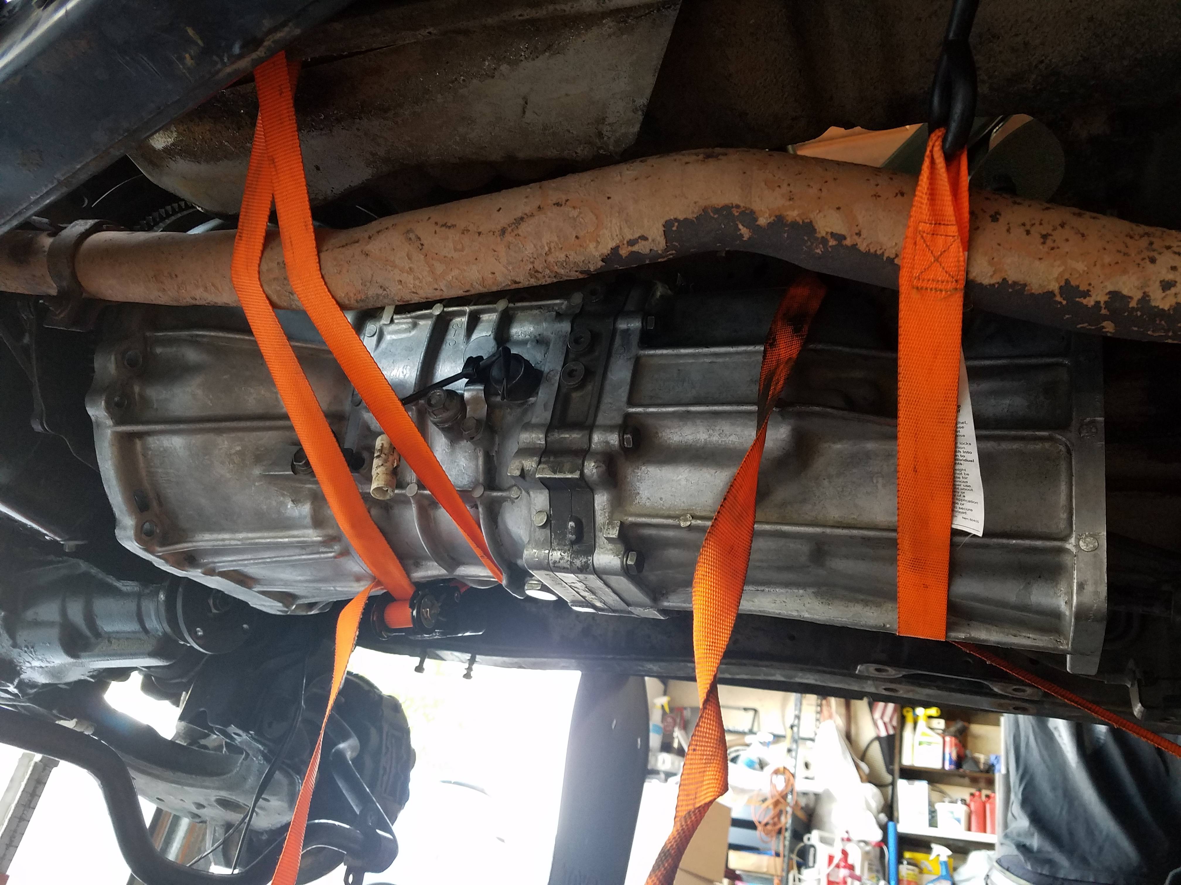

I used two basic floor jacks just to get it up as high as possible then ratchet straps across the torsion bars to lift mine into place. It was able to swing enough to get the input lined up with the clutch, haha.

That's slick, you've got to work with what you have! This cheapo tranny jack is worth the cost, like $50 at HF. My truck is the perfect height too, so that once tranny jack is lowered all the way, it will roll right out from underneath the frame with the trans sitting on it.
