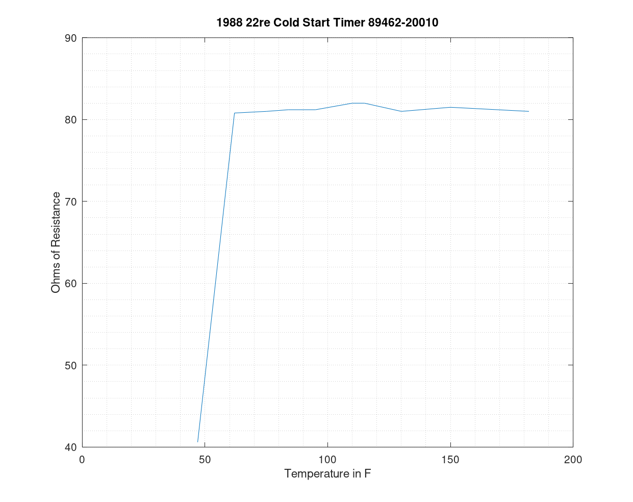

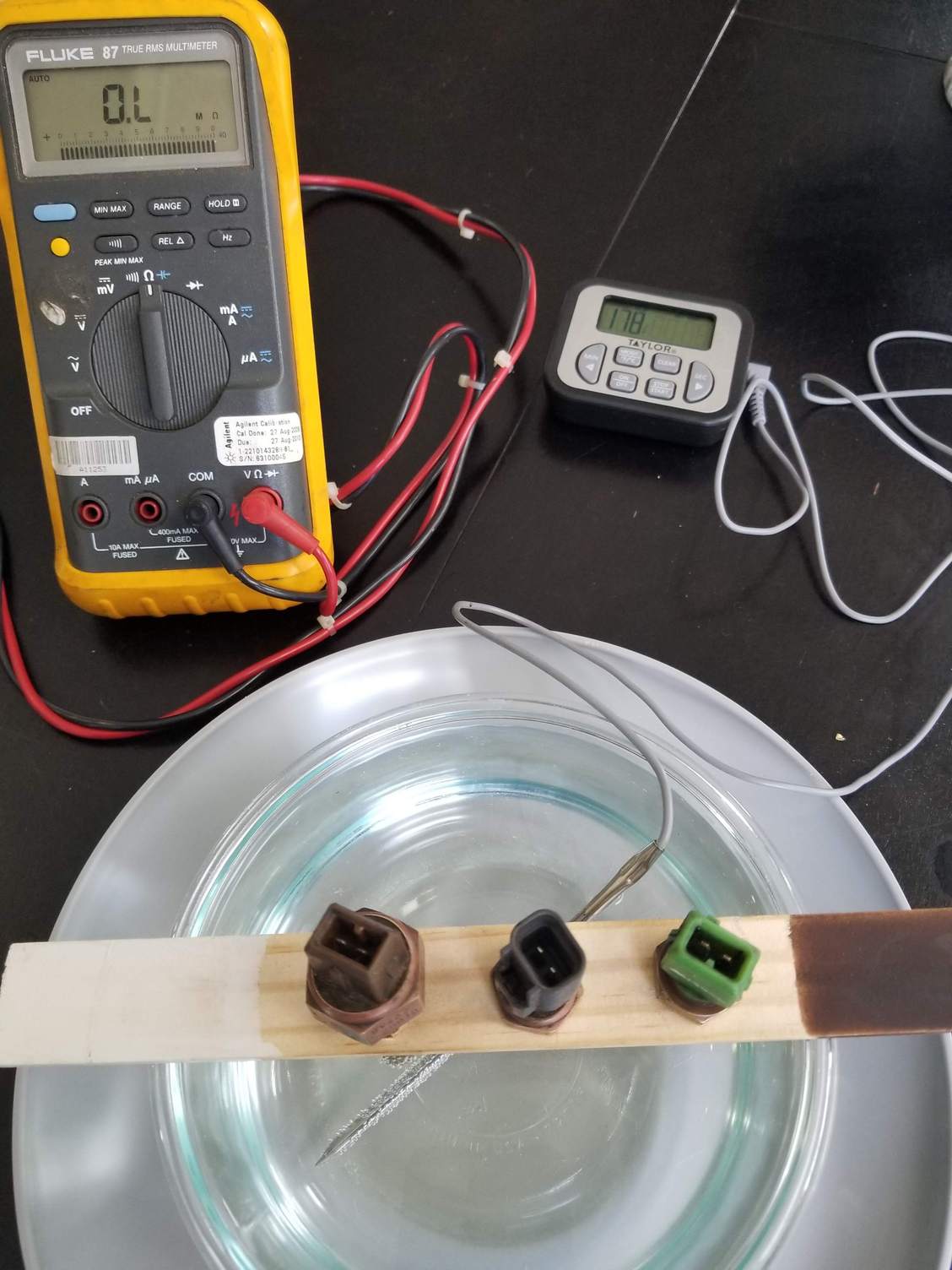

For some reason, been doing some reading on some of the hard warm start threads on YT, I have pretty much always had a warm start issue that is a bit of an in between case, meaning that it starts fine anywhere from immediately after shutoff, to maybe 45 mins or so, I don't have exact numbers, but quick runs into a store and out no problems, but after some period of cool down, where I am not quite at cold and not really at hot, the engine just does not start on that first crank. Usually what happens is I crank it, and it wants to start but just dies when I let off the key. So then if I crank again, it will usually do same thing, so then I stomp on gas pedal and wroom it's running. I have tested my cold start switch in the past and it seemed fine according to readings, my IACV works and opens and closes. Not really a big deal to me, this is kindof a rare situation for me, but still it is there in the back of my mind as something to fix.
On the 1988 (and possibly newer) 22re, the ECU can provide a ground path for the STJ signal to the cold start injector, and if you read this info from Ray: CSI System, it talks about the ECU providing that ground path for the CSI at temperatures up to 113 F. So that got me interested to go pull both my cold start switch and the water temp sensor and actually measure them.
Here is my test setup, I drilled 3 holes in a paint stir stick, a glass pyrex bowl for the water, an oven temp gauge, a Fluke multimeter for the resistance readings. I then boiled a big measuring cup of water in the microwave, and then dumped it here in this bowl, let it all sit for a few minutes and then started taking readings. And yes you do see 3 sensors here in the picture, one is the cold start timer switch, one is the water temp sensor both OEM original to the truck, and the other is an aftermarket temp sensor that was a snafu that I bought prob 10 years ago and mistakenly put in the truck...more on that later. I just wanted to compare the aftermarket readings to the OEM sensor.
Ok so first up, my cold start sensor is Toyota PN 89462-20010. The FSM really only has 2 temperature areas where resistance is spec'd, below 50 F, and above 77 F. Doesn't really say what the resistance should be between 77 F and 50 F, but as you can see in the data, my resistance stayed at about 81 Ohms until somewhere around 48 F where I saw it flip like a light switch over to about 41 Ohms. Note I did have to throw a bunch of ice into the bowl to get it to start dropping down into the range where cold start timer would even kick in. Here is my data plotted out. I'd say my cold start timer switch works fine. I did clean it up good with some steel wool and a toothbrush, cleaned the copper washer really good and scuffed up the intake face where the copper washer touches, and ran a battery wire brush into the threaded hole to clean that up.
Next up the water temperature sensor. So the backstory on this is that maybe 10 years or heck even 12 years ago, when I first got this truck, the temp sensor connector was busted off and just hanging there unconnected. So I purchased a connector end from a YT member cut from a 1988 22re. The connector though did not fit on my water temp sensor....confused, I went to auto parts store, and they pulled out a water temp sensor for a 1988 4Runner that DID match the connector. I was bewildered, but went home with the aftermarket sensor, took the one installed out, and replaced it with this aftermarket and soldered up the connector and that is how the truck has been for all this time. Now as I do some research I see that Toyota changed the temp sensor style in mid 1988....my truck is Jan 1988 so it is the earlier style....so bottom line the 22re plug that I bought from a YT member belongs to a later 22re. I was so young and dumb that I did not realize what I was doing at the time. Anyway, luckily I did not throw the OEM sensor away, and now I am in process of gettng the proper plug to put it back into operation. Okay....on to the data...
The blue line is my OEM sensor and red line is the aftermarket, and it lines up almost perfectly with the aftermarket one....so I guess good news for the aftermarket community they did a good job. I was hoping that there would be a big difference and installing my OEM sensor would alter truck behavior but now seeing data I don't think so (still waiting on my replacement connector to be able to actually start the truck up). Yellow line is data I pulled as the lower limit from the FSM which really was only a graph with not really any lines of graticule, so I copied the graph into PowerPoint and drew straight lines on it to kindof get as close as possible. Bottom line here, both my OEM sensor and the aftermarket one seem pretty close to the FSM spec in most places. I did clean up the OEM sensor with steel wool and put a new copper washer on it and cleaned some crud out of the threads....so heck maybe something will be different when I start it all back up.

Finally received my Standard Motor Products HP4585 connector from Rock Auto...took a while to get here. I removed the other water temp sensor connector (that was wrong) and then soldered this new on and taped up the wiring real good. I refilled the coolant I drained and then took the truck out for some errands. Running fine so far so I don't think I screwed anything up, I have not encountered my odd hot start scenario yet, so not sure if anything has changed, I really doubt that I made the situation better, but I feel better having the proper OEM sensor in there.

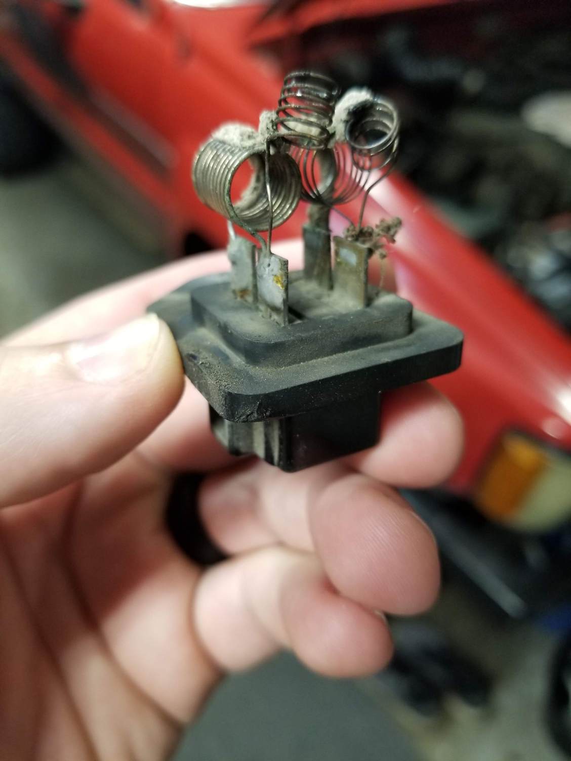

On an unrelated topic, I have not had a low speed fan setting for a while, I figured my blower resistor was burned out on one setting....and then recently I found that another fan setting was also gone. So ordered up a new blower resistor from Rock Auto and threw that in there while I was out there. Here is the old one.

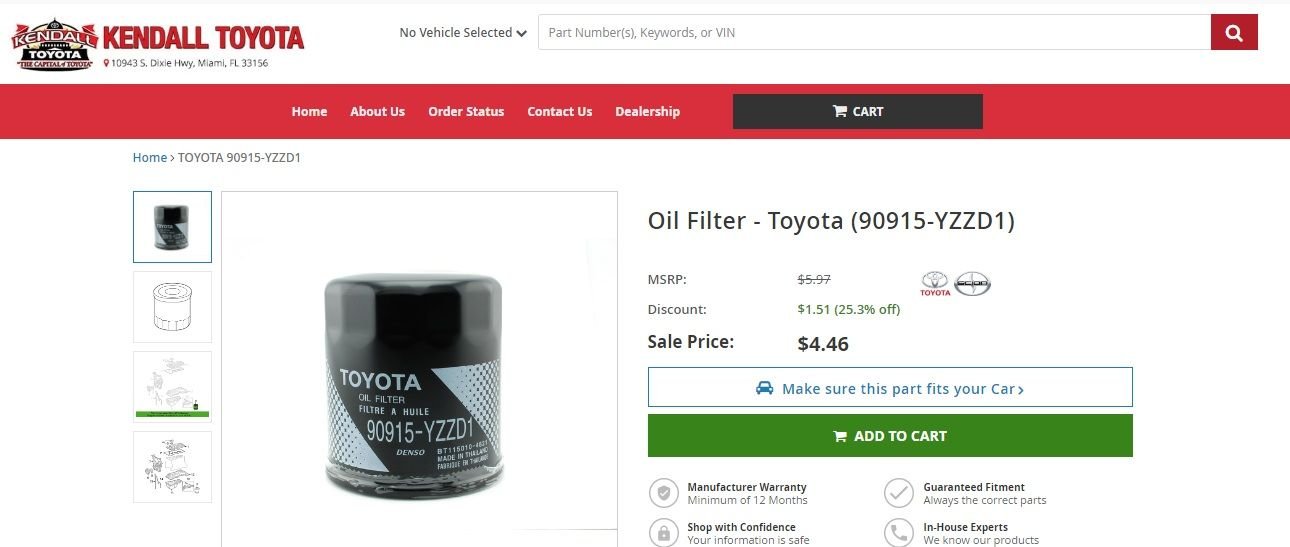

Hey Cory... Thats not bad, myself I've learned that if I can get OEM at close to or near aftermarket OEM wins.
Oil filters are the same way, but they are climbing slowly....

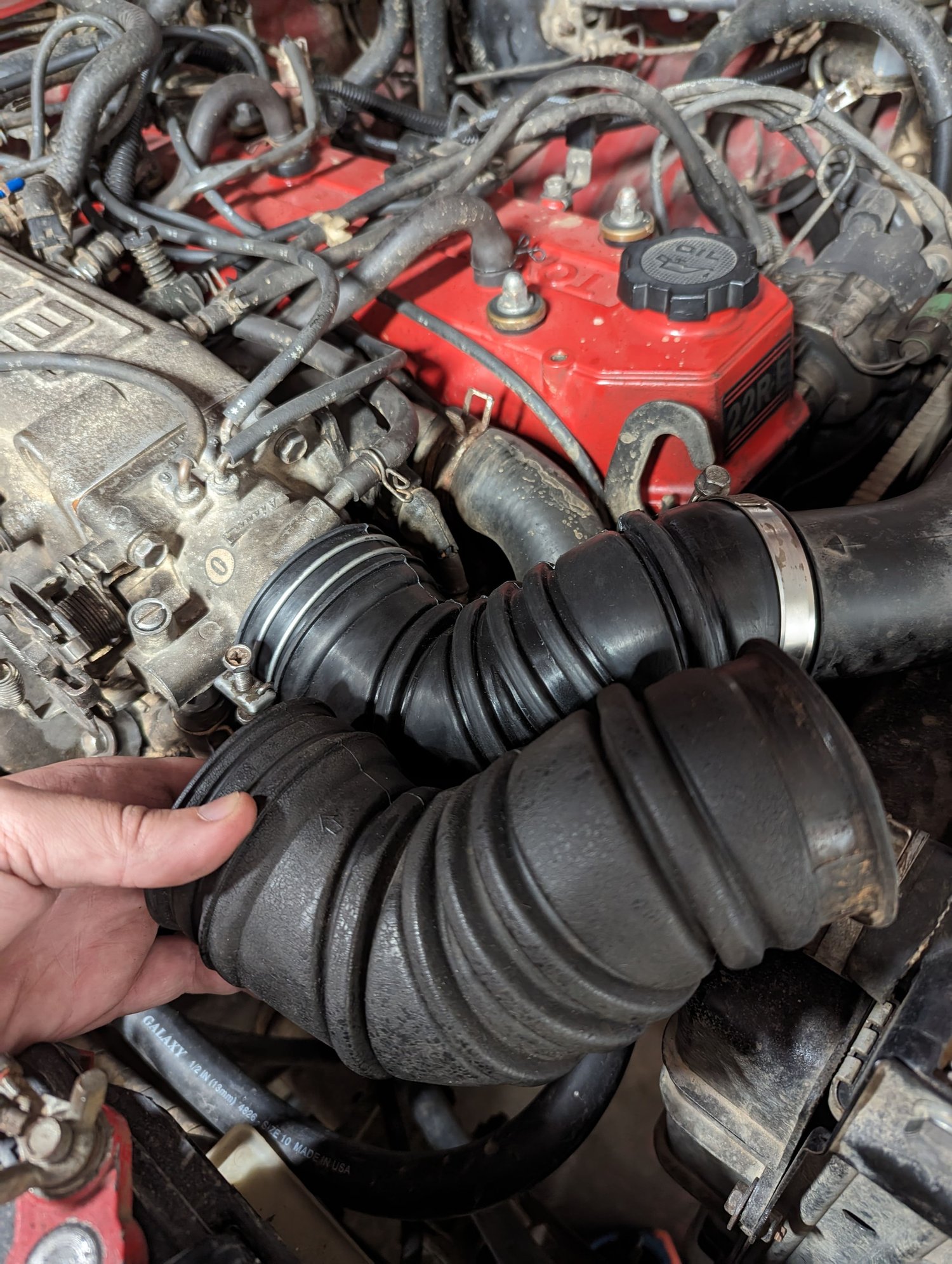

My intake rubber tube from the plastic cross tube to the throttle body inlet was getting very hard and non-rubbery, so I decided to order a new one. I decided to give one from ebay a try since they are so cheap, this one was $12 shipped, hard to beat.
Also, on the plastic crossover tube from the AFM to the throttle body, it kindof lays on top of the radiator shroud a little bit, and I noticed it was starting to wear an indent in the radiator shroud and a wear spot on the plastic tube, I'm guessing because the foam padding in the middle of the tube was long since gone, so I scraped and cleaned the area as best I could and I attached this piece of foam tape, hopefully it holds up. For now it looks like it is spacing the plastic tube away from the shroud.

I've used one of those knock off rubber boots for about 5 years now, it looks way too good and performs too well for the little amount of money they charge for them.

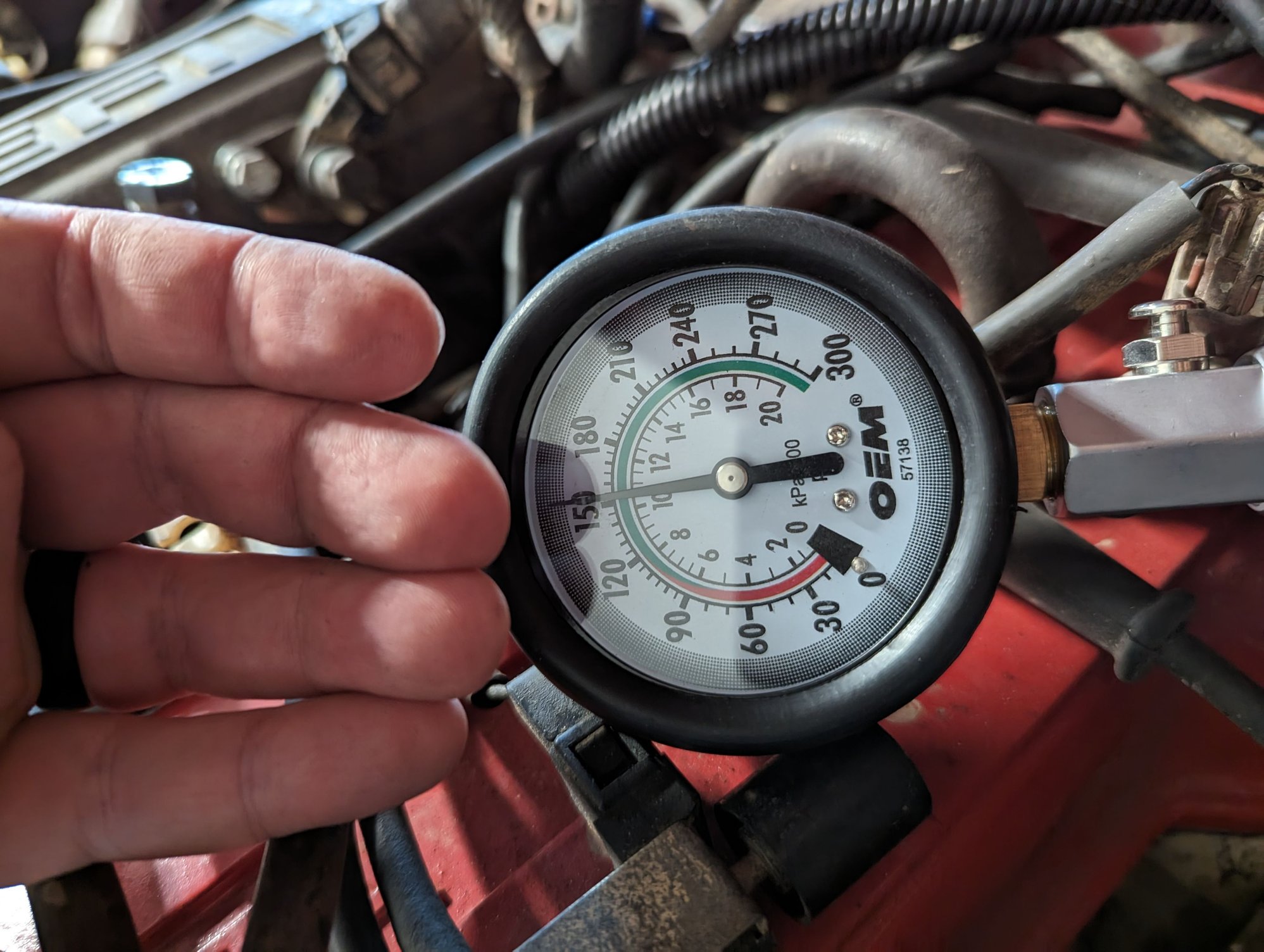

My truck has been smoking\burning oil for probably years, but I'm starting to notice more, maybe because I drive it more, not sure. Especially after idling for a bit, it will smoke when I accelerate, and just in general I have to keep an eye on the oil level because oil is disappearing. It runs pretty darn good, but I'm thinking that at 35 years and a bit over 200k miles, maybe the engine is getting pretty tired. I did a compression test on it this morning for first time ever, and it shows pretty much 150 across the board, cylinder 3 was a tad under 150, maybe 145. Trying to decide here if getting the head redone is worthwhile or if it needs the whole engine rebuilt.
Old Nov 11, 2023 | 08:47 AM
  #953
cashmoney00's Avatar
Joined: Jun 2015
Posts: 238
Likes: 67
Those are good compression numbers. You could try a leak down test and see how that looks but I doubt it’s the engine. Could be valve seals.
