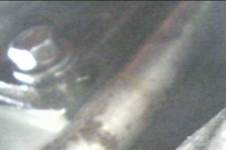

Well, been a little bit distracted from the 88 4Runner lately because a couple months ago I bought a 2024 4Runner TRD Off Road.
However, I noticed when driving the 1988, as I parked it back in the garage, there would be a little spot of liquid on the ground, it was coolant...the first few times I saw it I thought it was condensate from the AC and I ignored it, but I got to looking and smelling it. So investigating where that coolant was coming from I could kindof see it dripping up near the head. But hard to really see from the ground. I used this snake camera thing I have which takes terrible pictures, but pretty sure it is coming from this EGR cooler plate on the back of the head. It is bolted on by I think 5 12mm bolts. I replaced the gasket on this plate back when I had the head work done....but clearly something is not right. What you see in the pic below is I think the driver's side rear of the head, it is oozing out of the bolt hole(s) and then collecting on the plate and then dripping off the corner right below the bolt if you stare at it you can see a drip forming there. Not going to be fun trying to remove this plate with the head installed, but I'm going to try. Any suggestions here....obviously I will order a new gasket (the replacement I used was Toyota), but does anyone use any sealer on this, like permatex copper?

Have not been driving the 88 4runner much since the rebuilding of the head. But I start it up and run it for 20 minutes or so every 2 weeks. This coolant leak from the back of the head....the egr cooler plate is really bothering me. So first I thought let me check that all 5 of the bolts are tight, and they were. I put a new OEM gasket on when I had the head work done....but remembering back, one bolt had broken and I had the broke bolt removed and helicoiled, and I kindof had a mismatch of bolts back there. So I looked at the 22re performance page and I believe there are 2 different bolt lengths to go back there, a longer bolt for the 2 bottom holes and a slightly shorter bolt for the 3 other holes. So I took mine out 1 by one and I definitely had a longer bolt in the top hole, passenger side, so I swapped that out with the lower hole, and I made sure that all the others were correct in the sense that the longest bolt was in the other bottom bolt hole. In my head, I was thinking, well maybe this slightly longer bolt in the wrong hole was the problem it was bottoming out....but alas that did not fix the leak, I still get a drip drip drip back there with engine running.
So....ugh, I really probably need to replace the gasket again....maybe I boogered it up somehow. It is very tight back there, I was able to get to each of the bolts and remove them and look at them and put them back, so that certainly can be done in place. However, I'm concerned about getting that cooler plate out from under the little metal coolant line that is bolted to head thru this plate, and you know, maneuvering the whole shebang back there with a fresh gasket on it.....I guess it has to be done, but has anyone ever removed and replaced that EGR cooler plate while the head was in the truck? I really really do NOT want to remove the head again for this.
