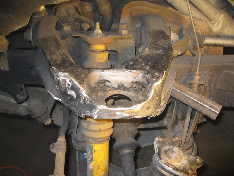

I put 35's on. However, I think you'll find even 35's a bit small for mudding. Seems most like a lot of power and 44's.
However, before putting a 35" mud terrain on my own truck, I already had 4.88's in the diffs, ARB air lockers front and rear, dual transfercases, a custom 3link rear, full flatbelly, tons of armor, etc...
So, my experience may not be totally applicable, as my truck is not all that stock anymore, except for the front end.
I had to trim my upper a-arms down:

rewelded:

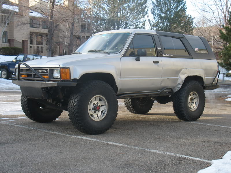

Here is a pic of my rig at near stock height (rear is a little high) with the 35s:
