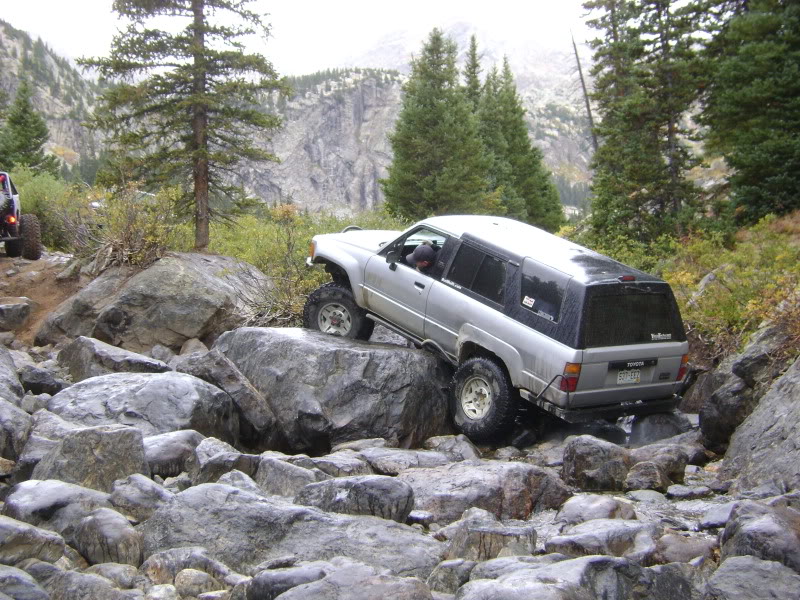

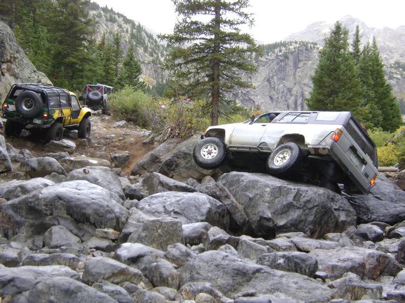

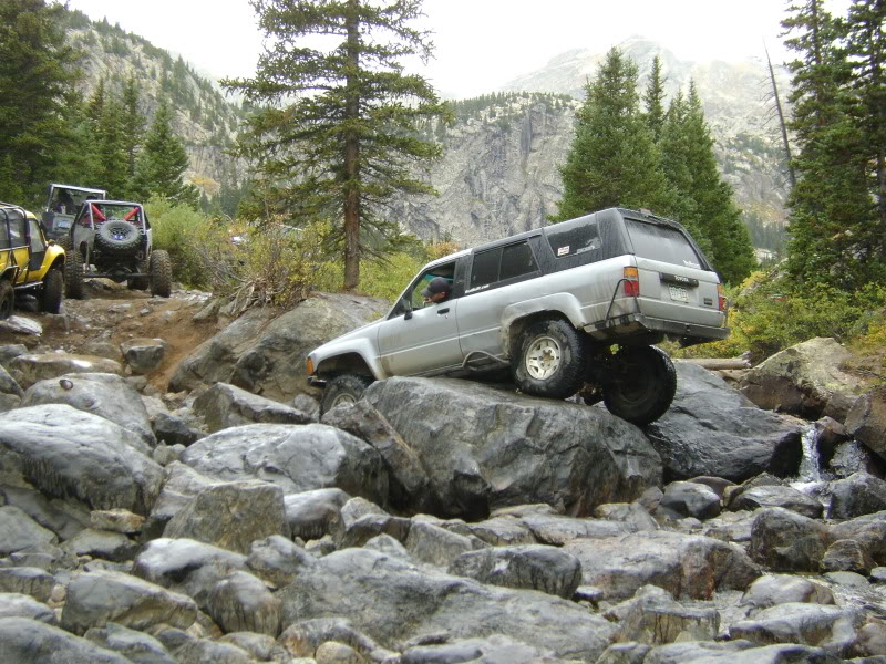

ARB air lockers give you a significant upgrade in strength in the carrier on early IFS trucks. Later trucks with clamshell diffs have issues due to a weak housing design.
People who say lockers in IFS is a bad idea either don't have one and read a bunch on the net, or have one, and can't drive.
IFS is a different system than most are used to. If you understand the system and drive to the strengths, you can do a whole lot with it.
In my experience, for general wheeling and mild rocks, IFS likes to be driven slow, while avoiding extreme angles on pressure situations.
So, stay off the throttle, and avoid turning full lock and trying to climb/descend something.
Also, IFS likes a smaller tire. 33's are a good compromise for decent clearance and parts stress.
Not sure what you consider showing off, but you can do at least moderately difficult trails with your IFS. You won't be doing any hardcore stuff, unless you like body damage, but you can get up most things.
Mine does pretty well with a front locker and 33's:
And no, nothing broke, and yes it drove through without any assistance from another truck.
