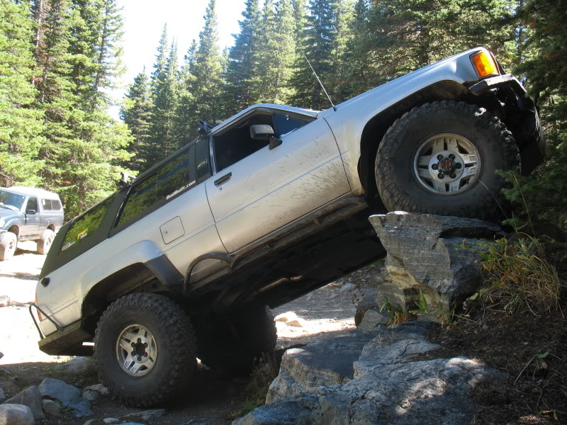

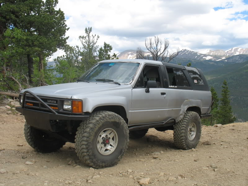

This is my old truck:
35x12.5's, ZERO lift. Stock Toyota alloys. It requires tubbing the firewall, but it is a very cheap way to get 35's on a truck.

Yotabeast, just put on the ball joint spacers, and tub the fenders or put on a body lift. Blocks are a bad way to go. You'll wear the steering parts out, but you will be able to sit pretty level.
Could you possibly explain that process? And it looks like you have little room in your wheel wells there, does that ever become a problem?
