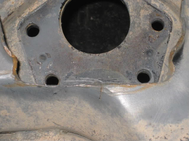

FYI- For those of you who have installed the BJ spacers, Blazeland will not accept your modified Upper Control Arms for a core exchange. Why? BJ spacers require your to carve out a portion of the UCA that accepts the spacer; weakening it! For a BJ spacer application this is probably not an issue, but for the Blazeland UCA Extension Bracket- where your putting additional leverage on the arm it could be.

A customer sent me a set of core that were modified for BJ spacers. Compare the modified UCA to the un-modified. Both modified RH & LH control arms had developed a hair line crack in the middle just below the cut away portion.

Yeah, I am am with BMcEL I can't see BJ Spacers being offered from Toyota. I'm surprised alignment shops would have issue? I have never had a set of BJ Spacers so I can't comment with them on any first hand experiences. The concept seems valid. I could see getting more travel by increasing droop. But it seems to me reconfiguring the droop stops would be achiving the same thing. How it affects the preloading of the torsion bar and ride height adjustment may be another feature of the BJ Spacers that brings desired results? The guy who sent me the modified UCAs as cores beats on his 1990 4Runner in the desert pre-running arena so not surprised to see the hair line cracking.
I've gone through about 60 sets of UCAs as cores. I have seen some issues in the same area caused by some brands of Drop Bracket Lift kits too! Because the way the spindle spacer makes contact with the UCA at extreme angles it sometimes bends up the lip of the pocket. This deformation conflicts with the fit of the UCA Extension Brackets. But even the worst case was repairable with some minor metal work of bending and hammering back into shape.
As far as the set of UCAs that were cut for BJ Spacers its not some minor bending back of material. It would be cutting a new piece of 11 GA metal, bending in a 90 degree fold, then grinding to shape. Then welding the patch in place. Too much work!
