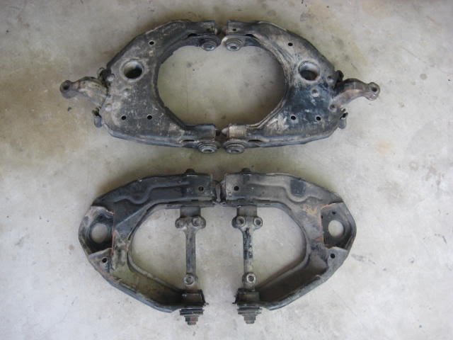

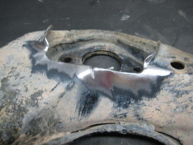

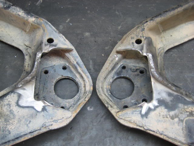

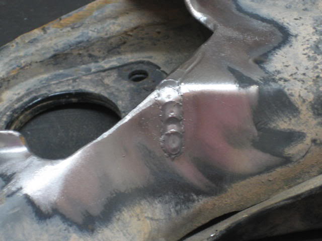

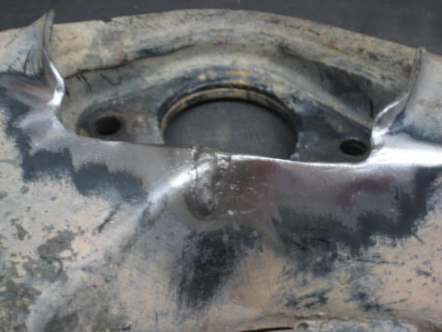

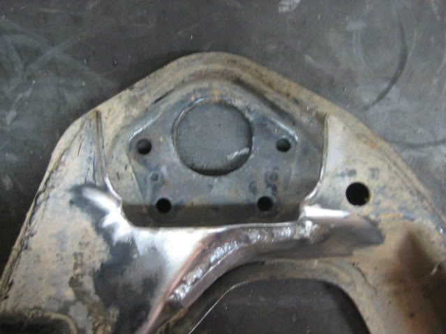

I had some tim to kill this afternoon so did some repair work to the UCAs.

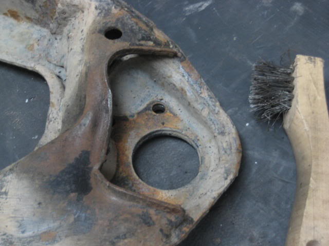

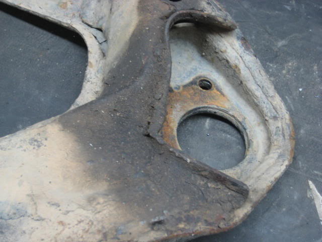

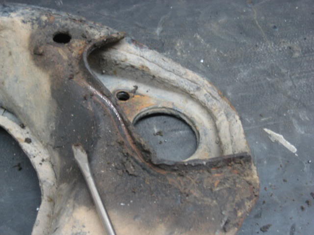

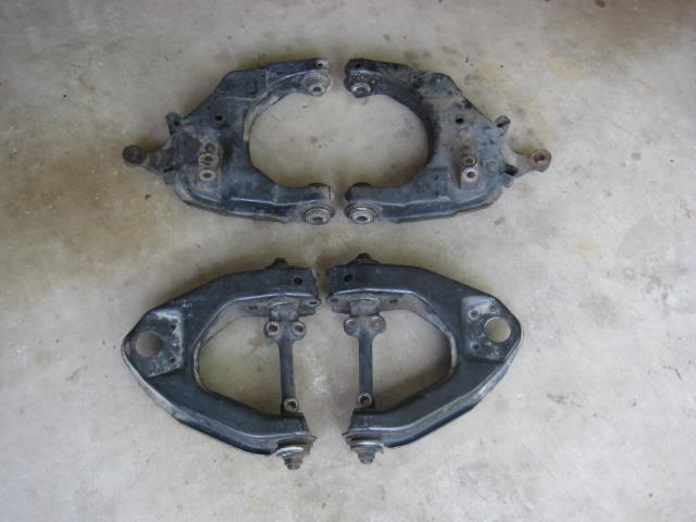

I recieved some cores this morning. On first glance they looked clean. I flipped them over and found damage! Rejects! Bummer! May give partial credit for the parts. A pair of UCAs are worth about $50 to me in good shape, these are worth about $25 (for the cross shafts and bushing hardware)

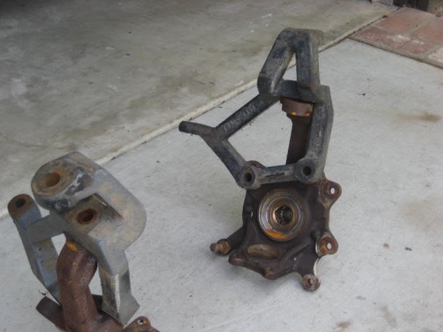

When I mentioned earlier about damage from the spindle spacer of a 4" Drop Bracket Kit here is what I was refering to.
