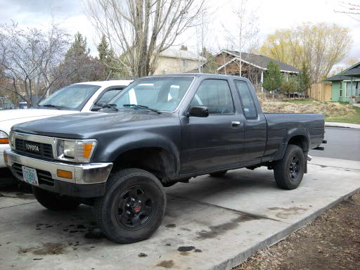

I need some help. I have 35x13.50 and I have 3 inch leafs in my garage but I want 6 inch overall. I was thinking of reversing the shackles and maybe blocks (not BL) but than we have the front IFS. Dont know how to get 6 in the front without spending a lot of money. If you have any suggestings or ideas please PM me or just post on here.
Thanks

Help me please
Haha alright well I need some advice.
I have 3 inch leaf springs for the rear and IFS, right.
Than I have 35/13.50/15
Im trying to get 4 to 6 inches of lift. (I dont like body lifts)
I was thinking 3 with the leafs a couple with reverse shackles and maybe 1 to 2 inch with blocks under the leafs and on top of the shackle
But now Im stuck with the IFS.
Maybe Ball Joint Spacers? That will add a inch or 2. I heard cranking the t bar is bad for your rig.
So I need some answers and Ideas. Im stuck, what should I do?
Heres the truck

IFS lift options are bracket lift, Blazeland, Total Chaos (or other) long travel, or solid axle swap. Blazeland and bracket lifts are the cheapest at around $1k each and SAS and most long travel kits will cost closer to $2-3k.
Ball joint spacers were designed to provide down travel, not lift, and cranking the torsion bars will wear out your steering components pretty quick.
