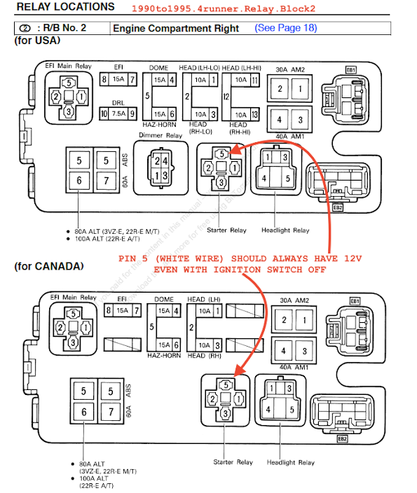

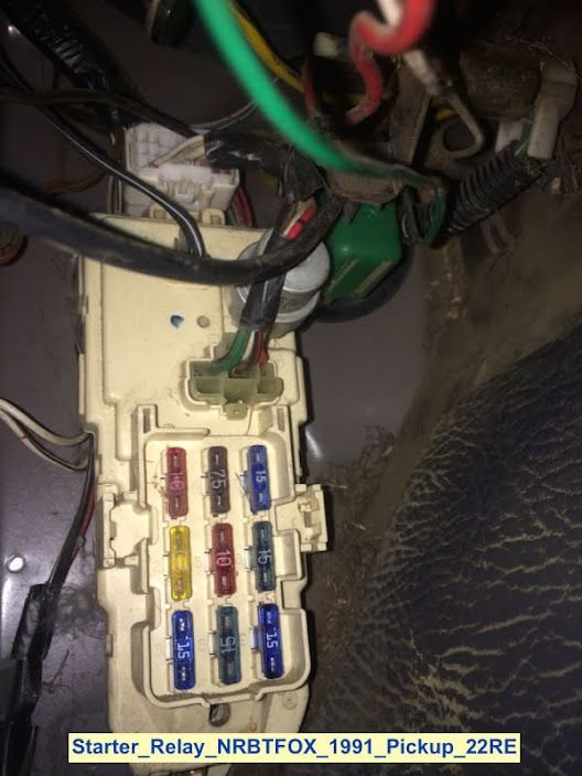

Is your starter relay in the engine compartment or is it in the driver side kick panel?
Starter Relay in Engine Compartment?
Starter Relay (green) in driver side kick panel?
There's a good chance this applies to your issue:
https://www.yotatech.com/forums/f116...runner-307493/

2. My starter relay is in the engine compartment: pin 5 is hot all the time with a white wire; pin 2 is wired black with red stripe; Pin 3 is black with white stripe and is eventually mated in the solenoid. Pin 1 is Black with red stripe.

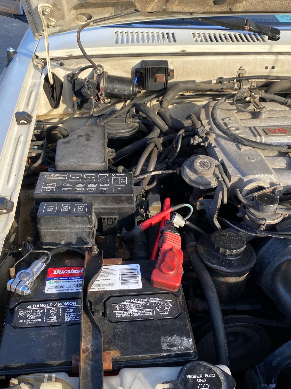

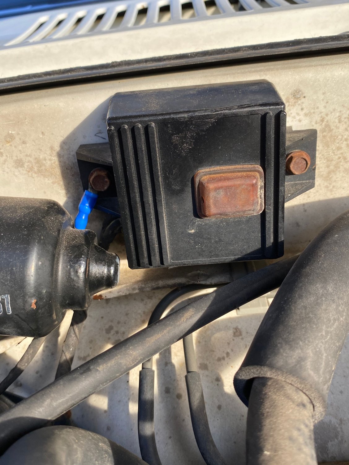

can anyone tell me what this is:
The Blue covered wire on this thing goes to the negative battery cable with a white wire spliced to the passengers headlight connection the black wire under the blue wire is spliced into the Solenoid connector (Black wire with White stripe that goes to Pin 3 on the starter relay). That brown rectangle is a dirty rubber cover over a toggle switch. There is no writing on this component.
Here is a larger view of that component on my firewall for location perspective.
Rad4Runner I have not I have not yet checked to see if my solenoid consistently works when wired to the battery as I am just getting back in the fight but will do so this weekend. I just wanted to update on the little I have done this far to get your alls comments…thanks much

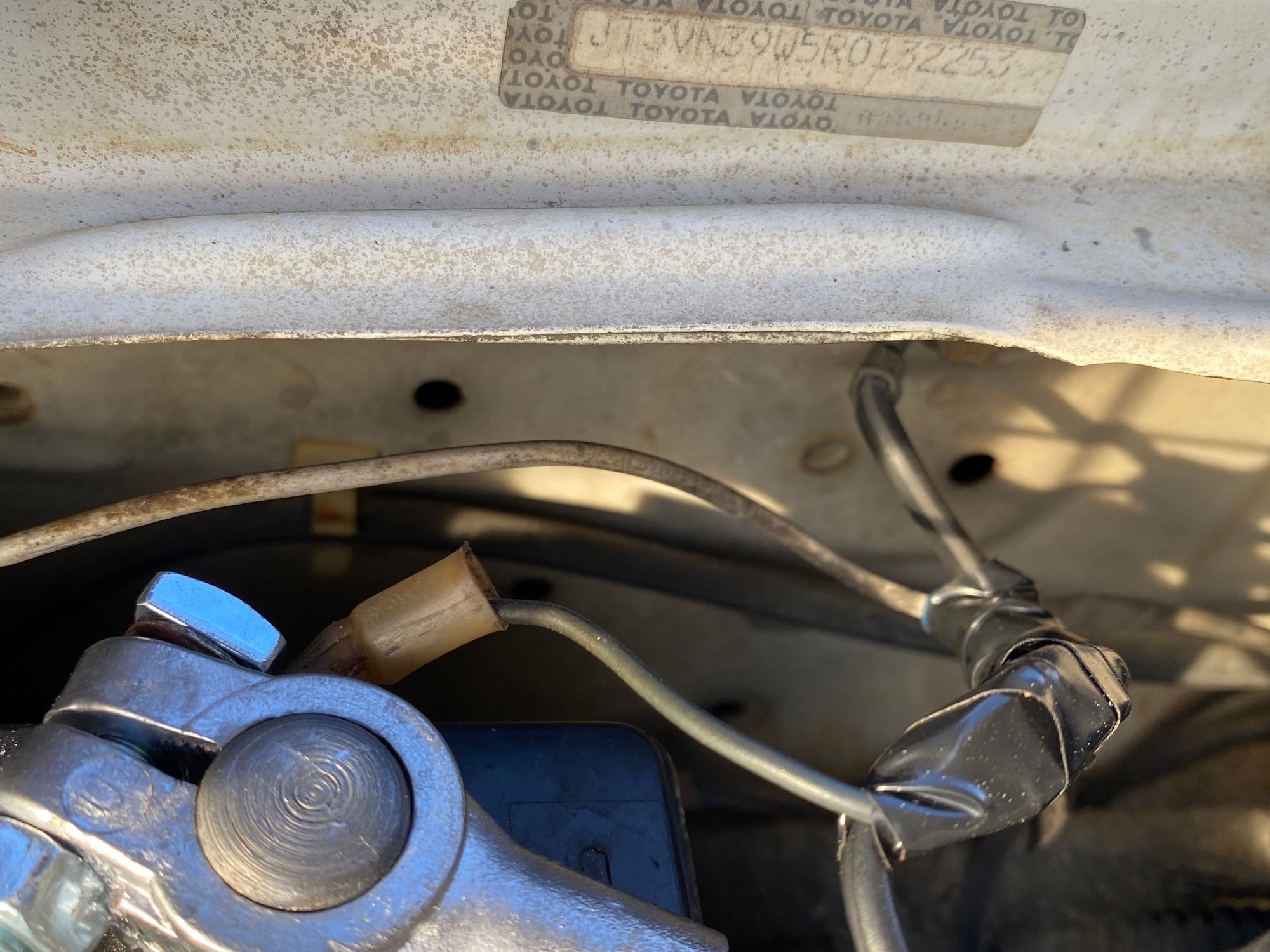

Oh, and here is a picture to show how the blue covered wire for the component on my firewall is spiced into the negative battery cable. It is grounded to the fender and then that dirty white wire runs into the passenger’s headlight connection
