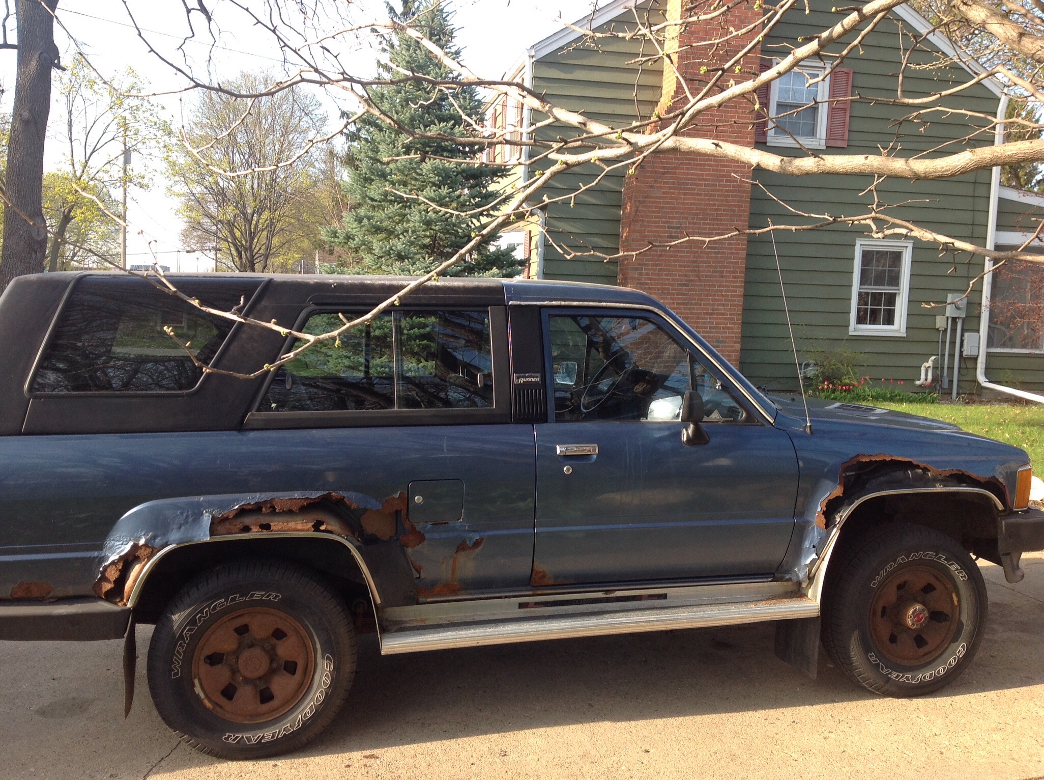

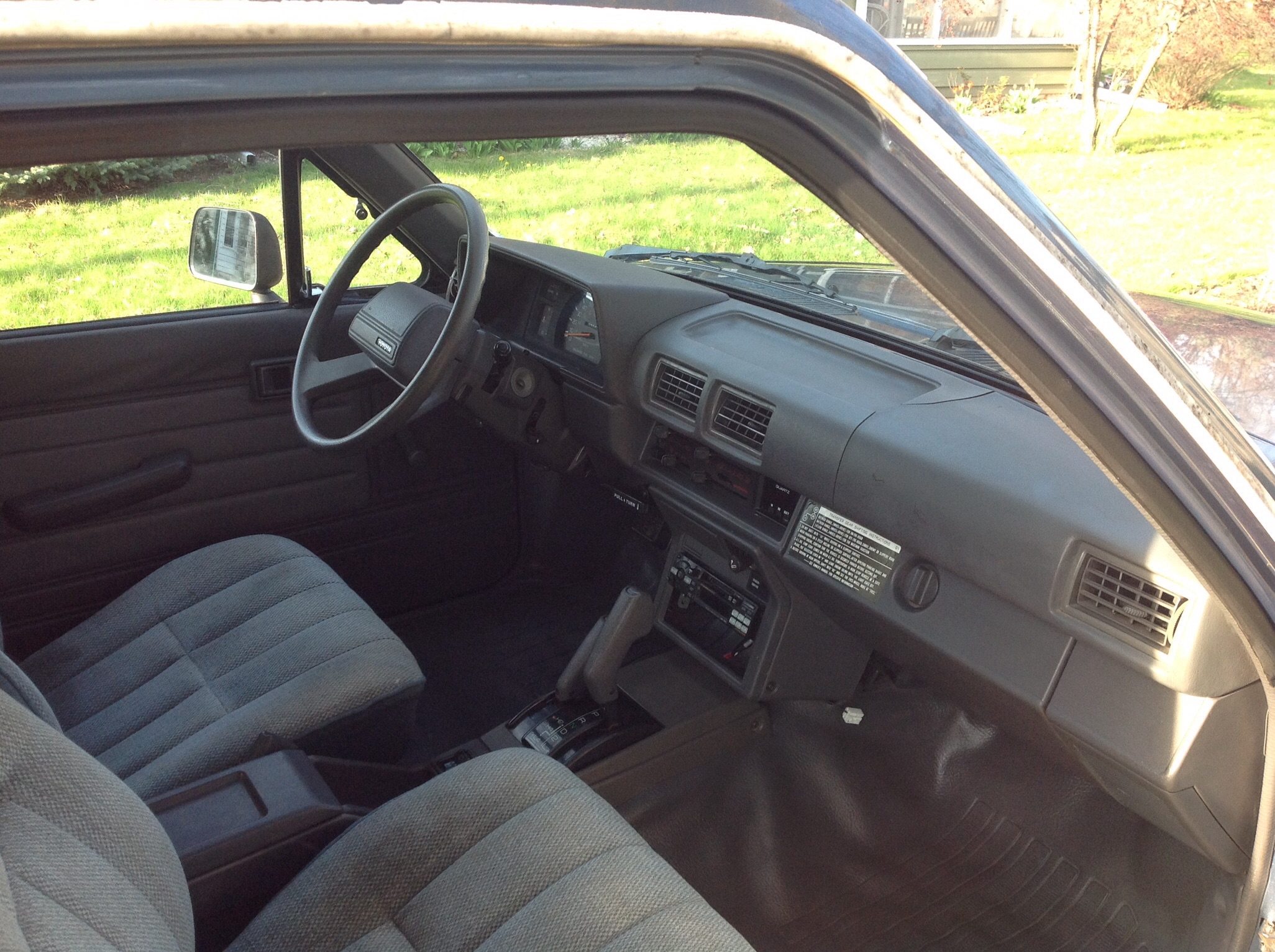

I picked up a rusty bucket recently. 1989 t4r 66500 and clean inside. That's the good,really just a little old lady with a antique store upgraded to a rav. The bad you ask ? I have a couple of rusty spots around the gaping holes in the body. I have worked with cut and patch and am somewhat comfortable with this. I usually get it right on the first try or two, but have never had experience with glass. Since I will be replacing two fenders and two quarters the idea of permanent fix intrigues me. I do have another toy project in the garage 3/4 done and have acquired knowledge from your boards before so I will trust the opinions given and weigh them sincerely. What think you sages of Toyota cages?thanks for the input.ps. I'll figure the pix out later , sorry

I guess it depends just what you like.
To me going the Fiberglass route was always to much money or the time frame to get the fiberglass parts.
When I have the metal and can have it done and painted in 2 days.
If your in the Great Rust Belt and can go fiberglass go for it.

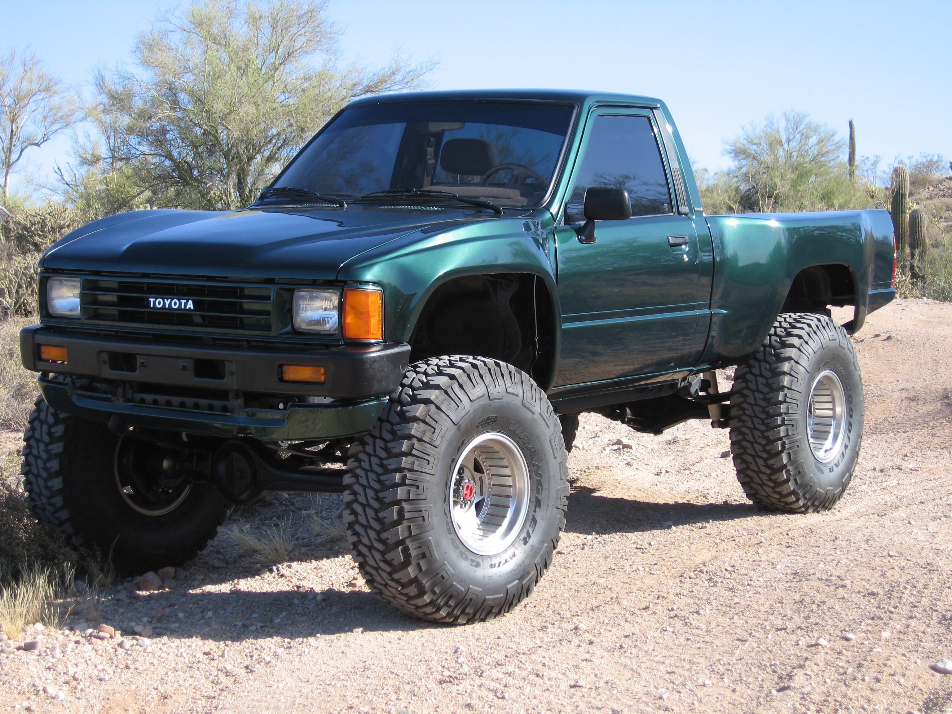

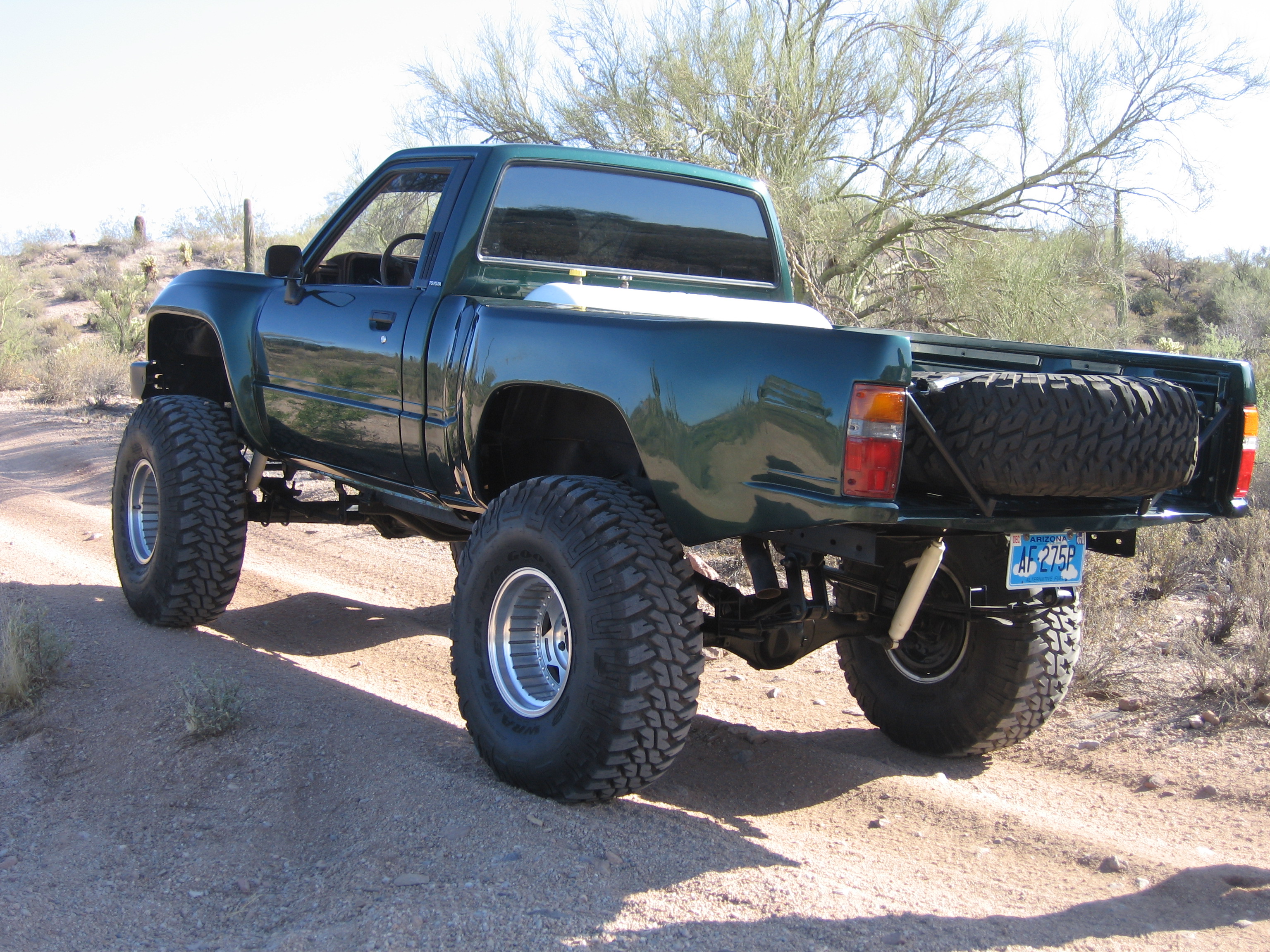

It was a lot of work but the glass gets compliments. My only complaint is rock chips from underneath. I undercoated but probably need something better.
Attached Thumbnails Fiberglas vs. steel panels-img_0805.jpg   Fiberglas vs. steel panels-img_0812.jpg
Old May 2, 2015 | 04:01 PM
slacker's Avatar
Joined: Jan 2006
Posts: 6,382
Likes: 301
From: BC Canada
typically , the "spider cracks" from underneath are a direct result of "cheep" resins ... just want to say out right , those are not my (toyotafiberglass.com) panels !
