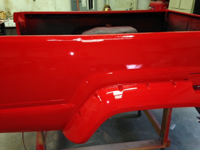

im painting my 87 now. in a open shop. base coat and 3 coats clear. Working great with a 75 dollar eastwood hvlp gun and eastwood paint.
This is right after spraying clear.
next
Wet same with 1000, 2500, 3000 compound then polish. its like glass now.
