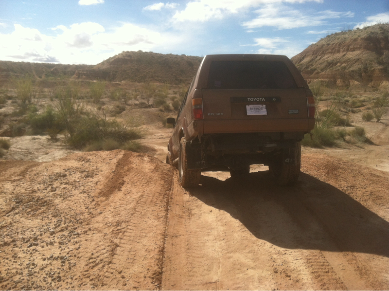

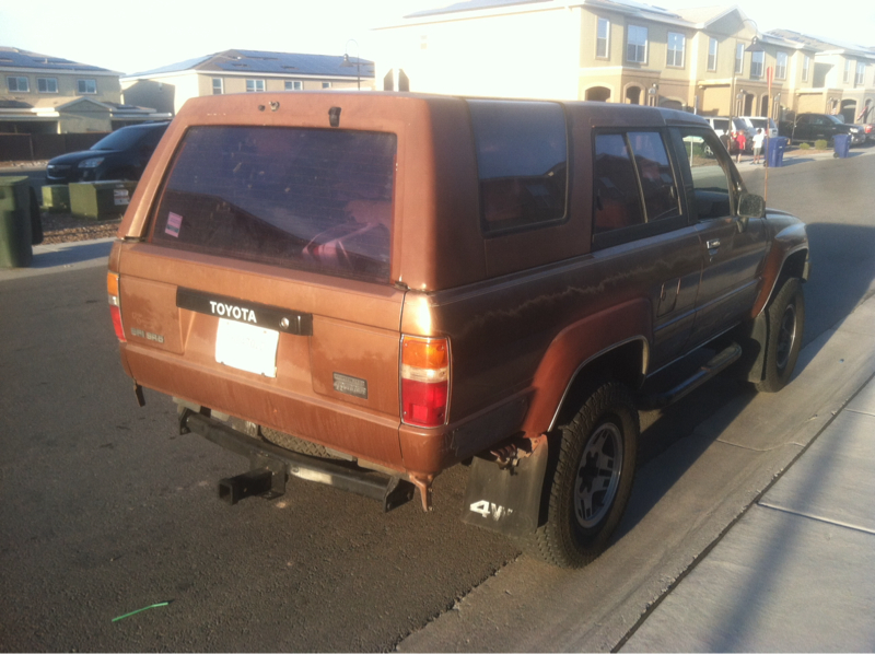

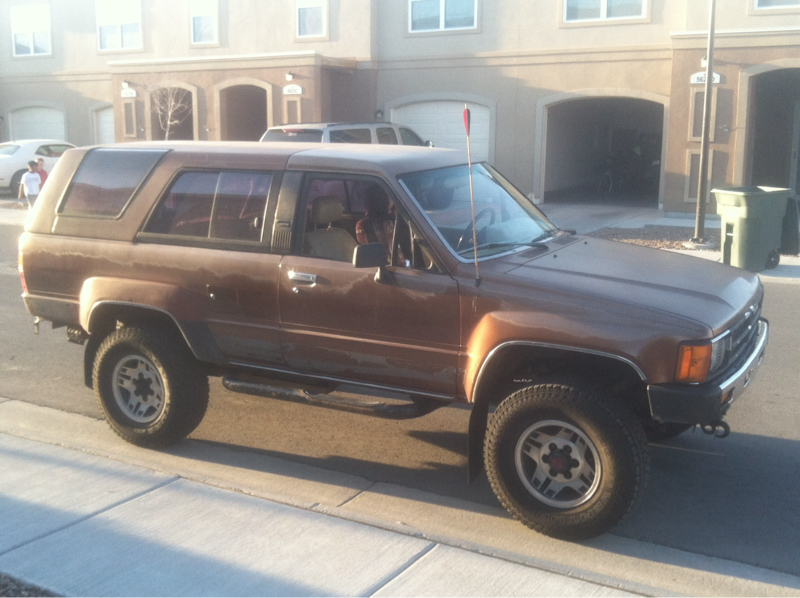

Ok so I had to move once again six moves in a nine year period sucks but good things can come from it. So bulletproof is put on hold and in cold storage (my 83 project truck) now I'm in El Paso with nothing to do and a single car garage from my three car garage. Well after getting here I needed something to do so I jumped on CL to find a cheep 4x4 just happened to stumble across a 1987 4runner with a bad head gasket. So I picked it up here's what I got 1987 SR5 22re 184200 mile and correct wow!! It had a blown head gasket so that was the first thing on my list so ordered all sort of new engine goodys ripped it apart to find I was correct timing chain guides were shattered all down in the oil pan and a really nice copper flake in the oil! Luckily I bought all that stuff! So I pulled the mains and rod bearing to find 3 and 4 were worn badly measured the crank no damage or wear still factory specs well I got her all back together now. Runs like a champ so now about the name 5runner I have 5 children and love to share the outdoors with them so I'm conceiving a plan for a third row seat but with that safety is key!!
Here's the plan
Two extra jump seat style seats rear facing
4xinovations full roll cage
Keeping IFS for daily driving
33x10.50 tires
Front and rear lockers
Custom front bumper
Tire carrier rear bumper
Soft top so kids can have fun with air flow and keep them cool on the trail
Custom recovery boxes built in to interior rear 1/4 panels
Water cans at least two military style
That's what I'm thinking so far if you guys have any input send it

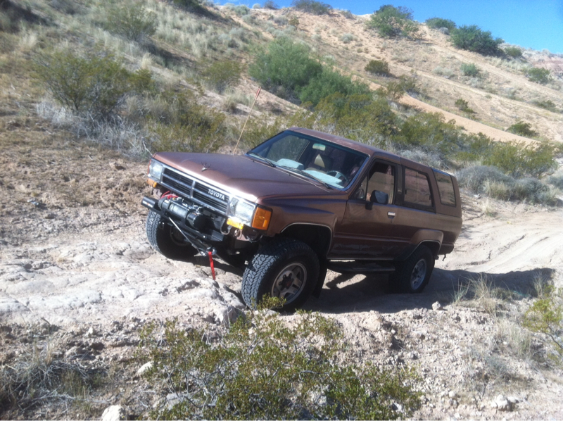

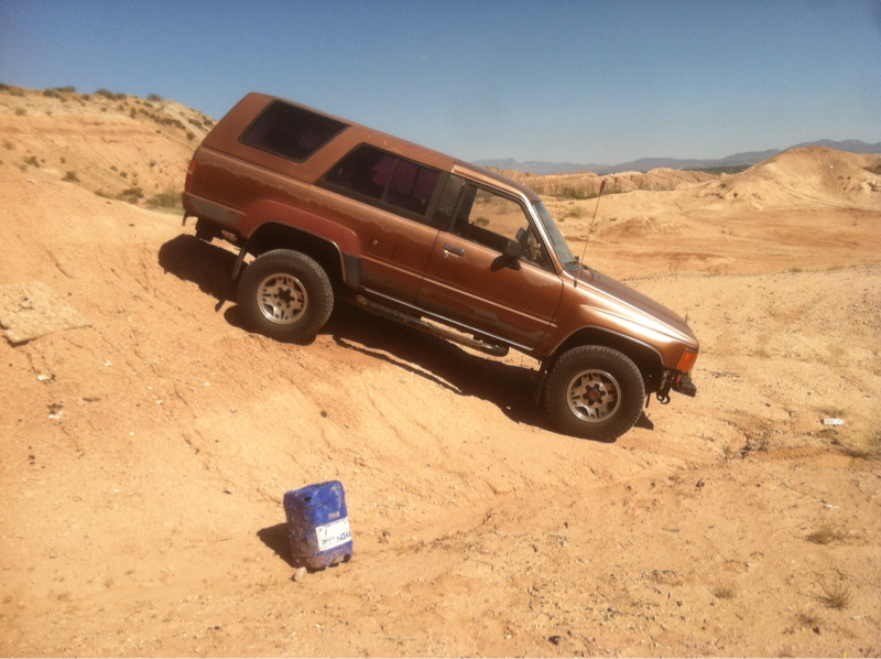

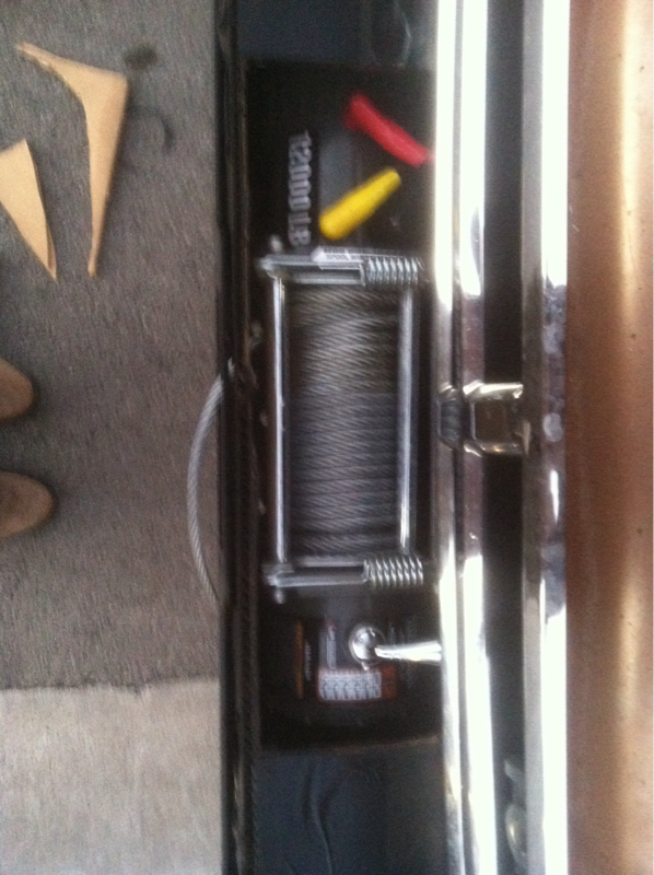

So did some wheelin today had a blast also got to build a mock front bumper for the winch before you knock me I know it needs more reinforcement before winching thought I would post some pics.

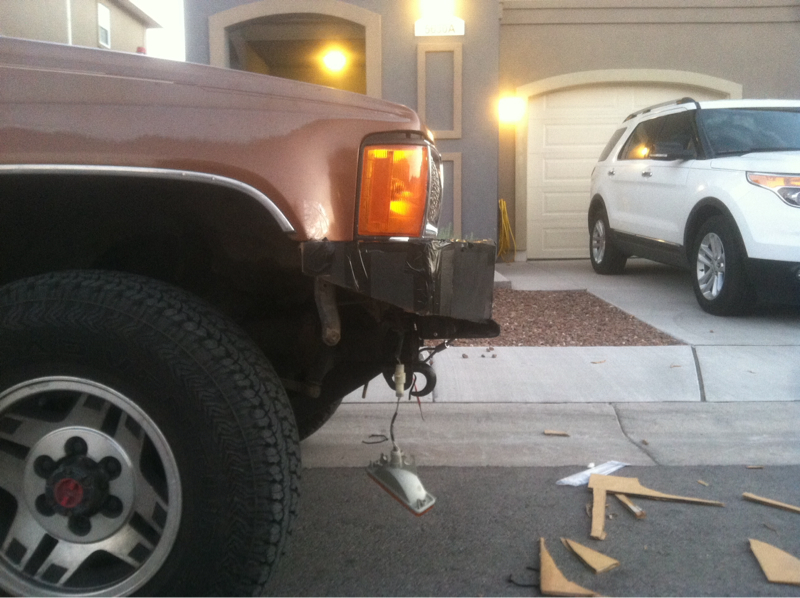

Bumper mock up

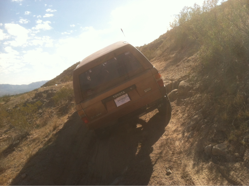

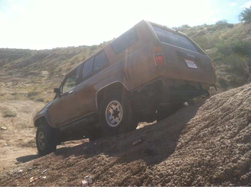

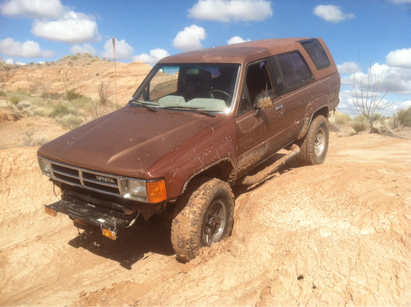

So got to take the older kids out today wheelin they had a blast I didn't get to take a bunch of pics but here is one spot where the kids didn't think the runner would get off with out getting stuck! The running board barely cleared and I could barely open the door it was a blast!!

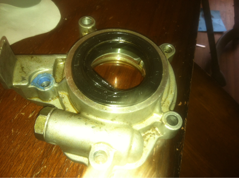

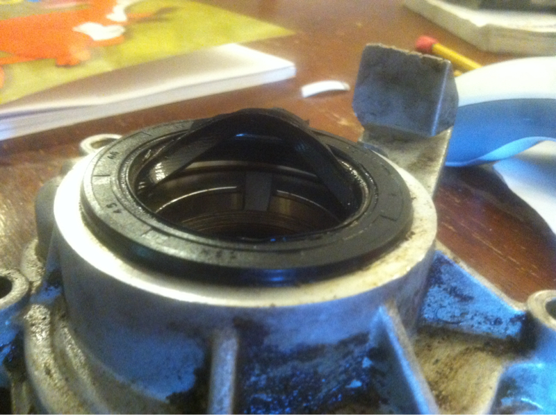

So I was playing around in the truck the other day and heard what sounded like a belt squeal didn't really think anything of it until the truck started running ruff so went to open the hood and everything soaked in oilafter about 10mins of driving. Got it home and had at least a qt of oil on the ground! So I washed the truck really we'll and the crank pulley was slinging oil everywhere ripped it apart and this is what I found!!
