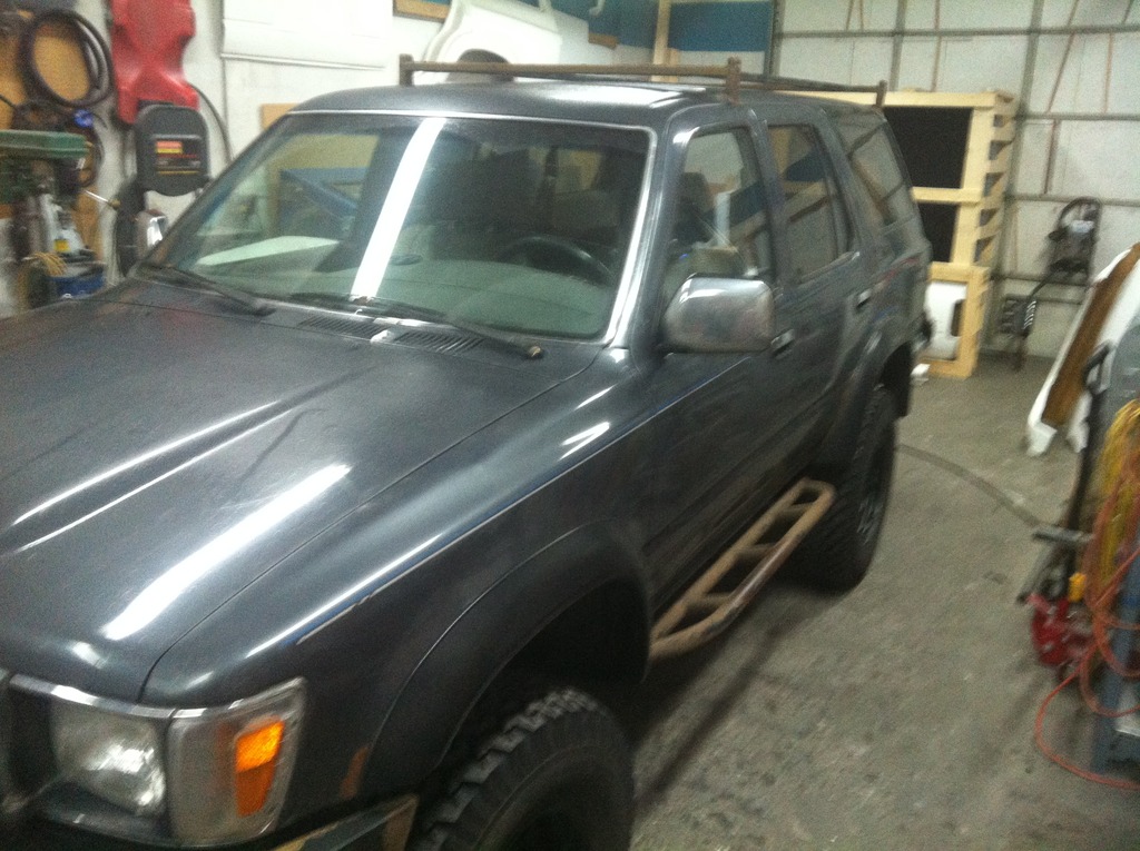

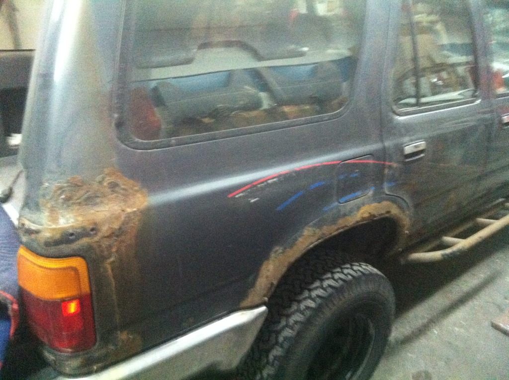

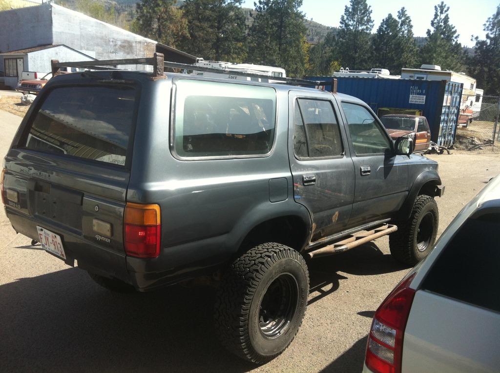

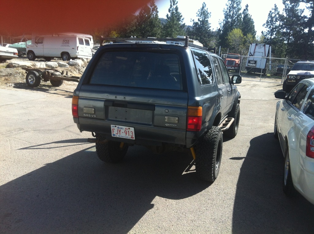

Nick rolled in today for his booked appointment to have his second gen 4Runner 1/4rs installed

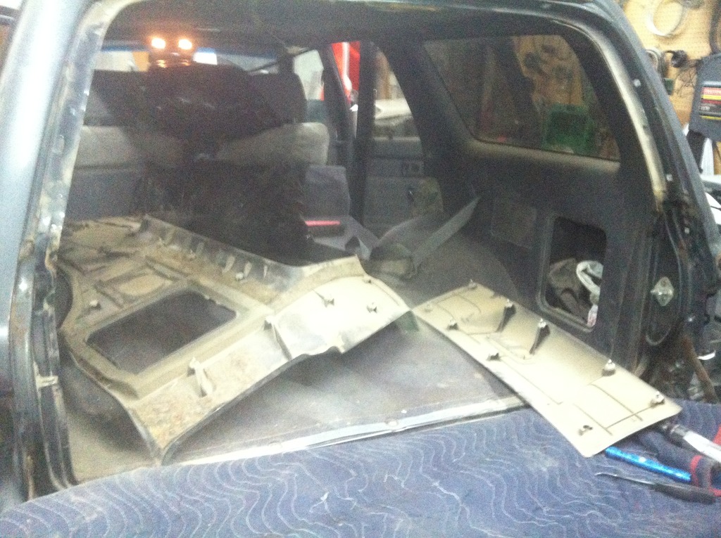

got started by pulling the interior out

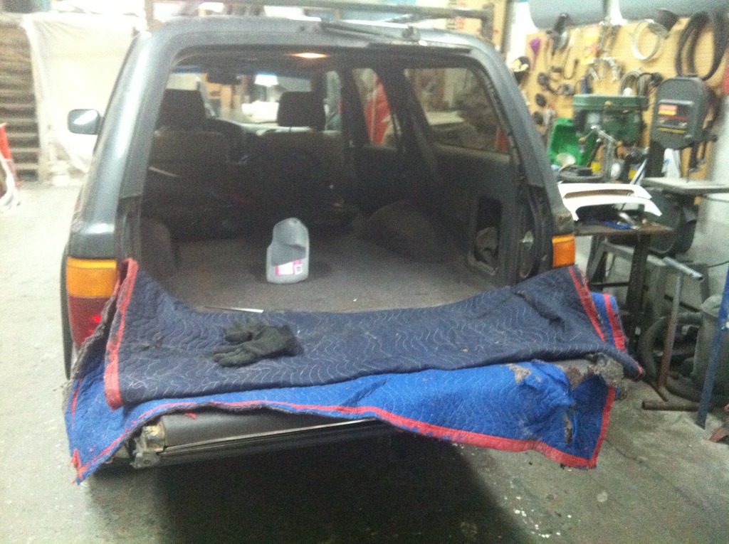

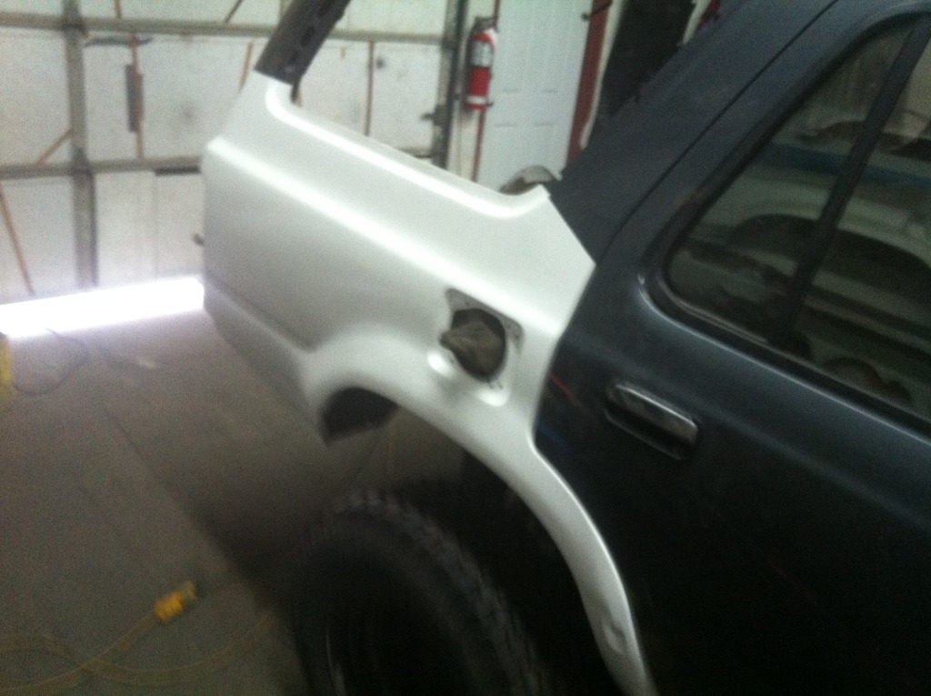

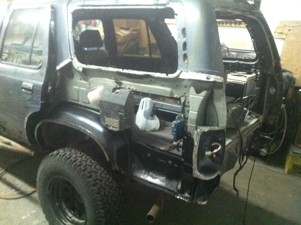

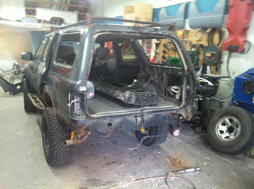

got the rest of the interior out , and removed the rear hatch

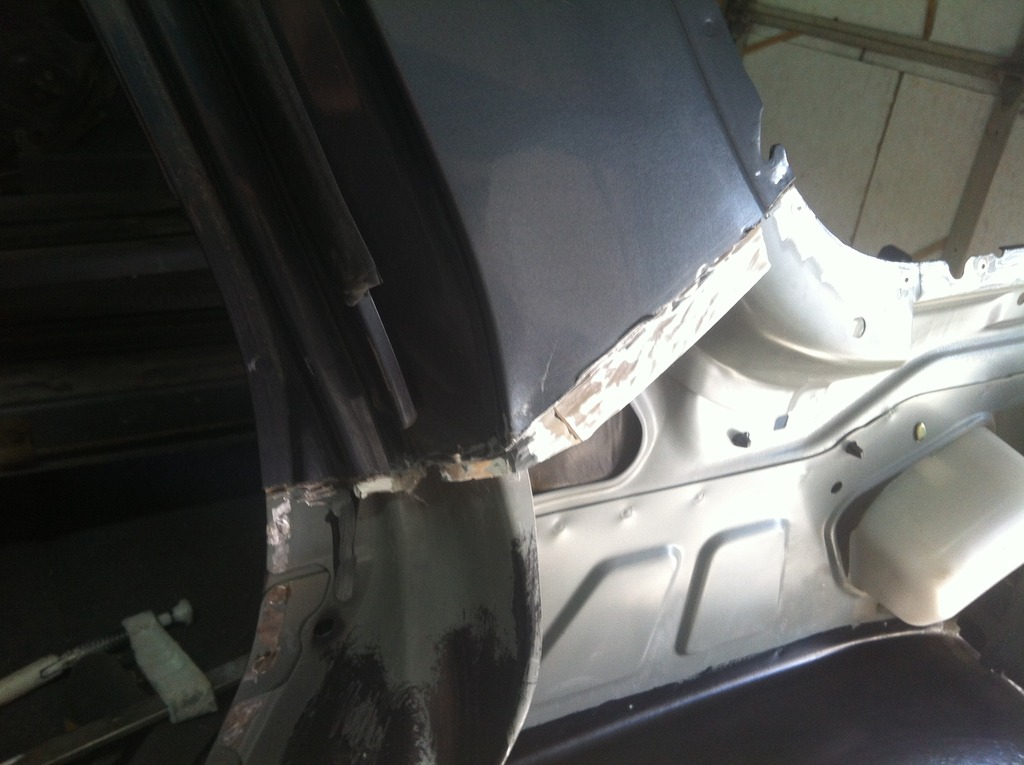

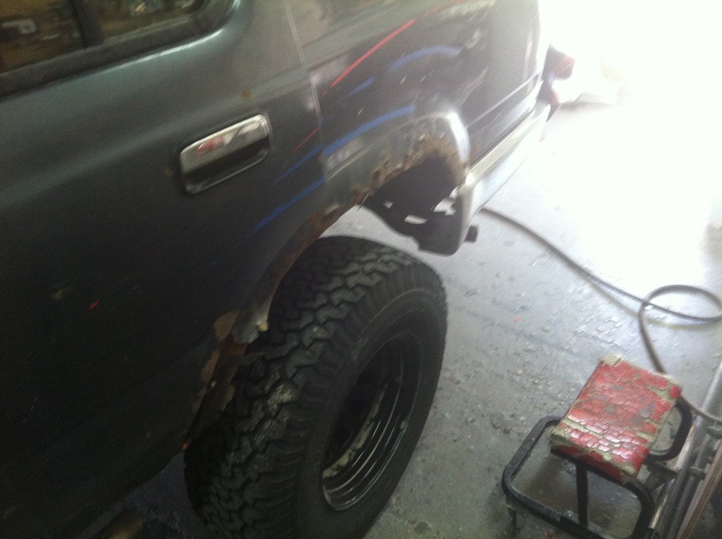

also removed the drivers flare , and as suspected , it's the same as the passenger side

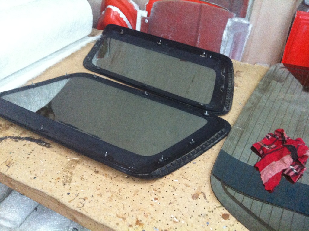

also , got the rear 1/4r windows removed

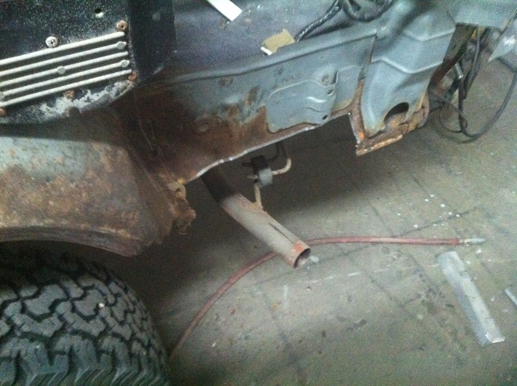

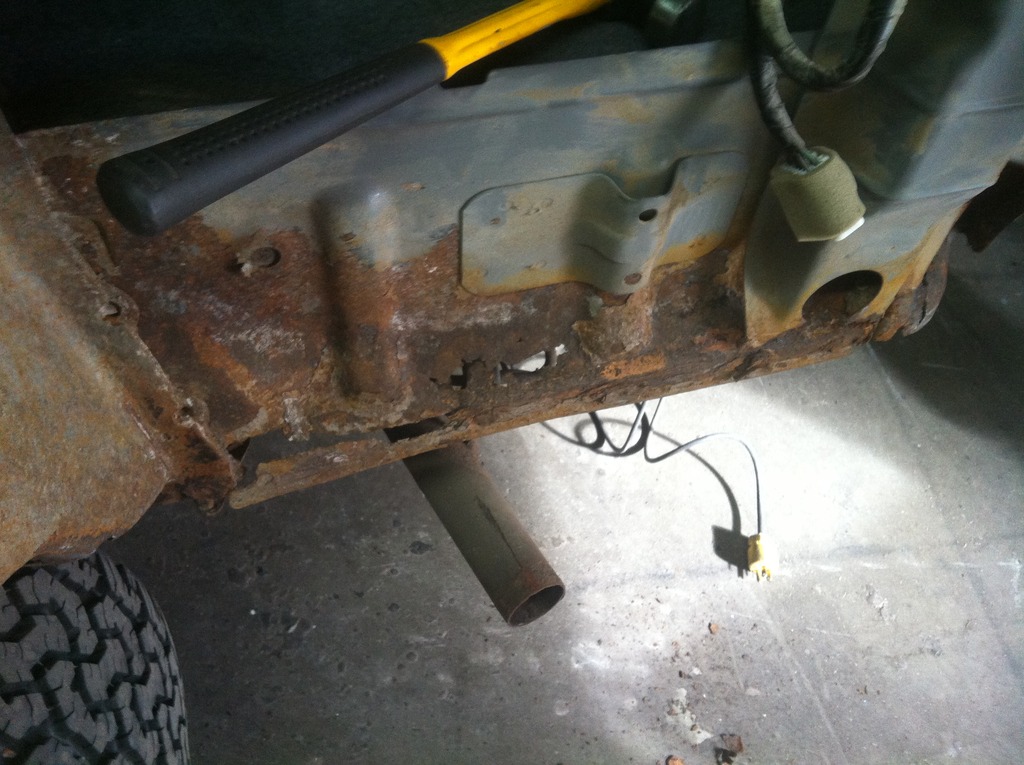

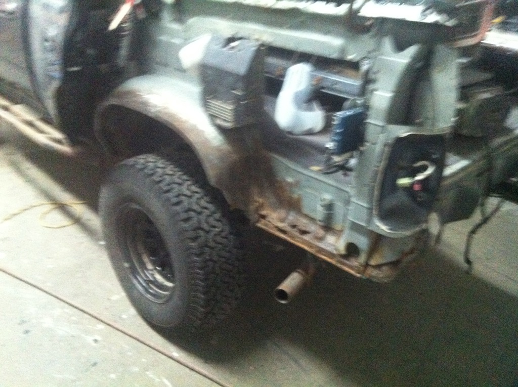

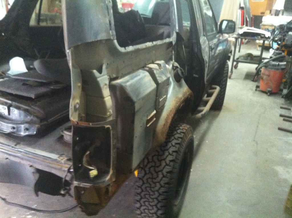

and time to take the 1/4rs off .
first is to cut the pillars , then drill all the rest of the spot welds .

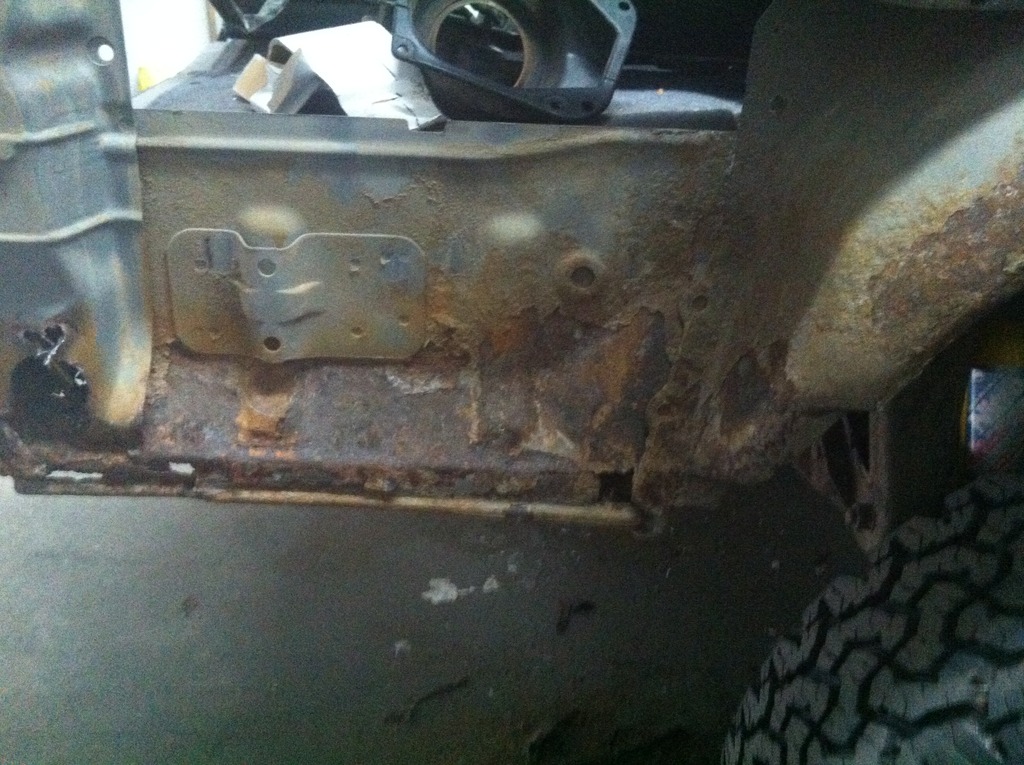

looks like I have some more rust to deal with

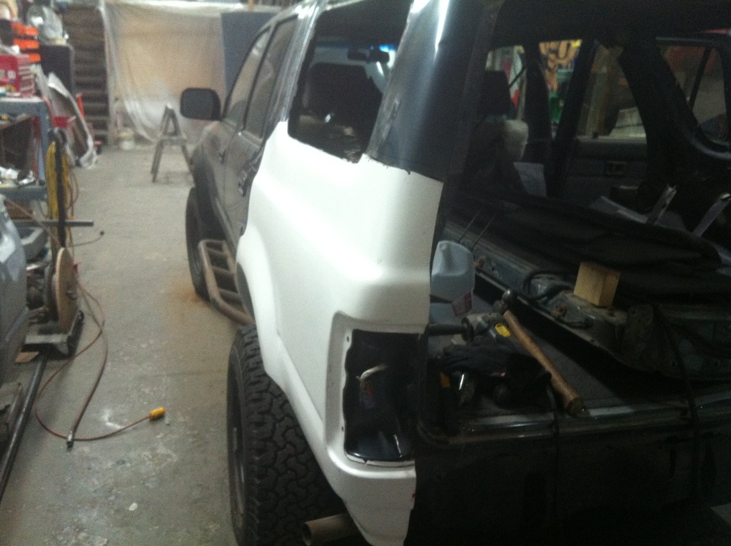

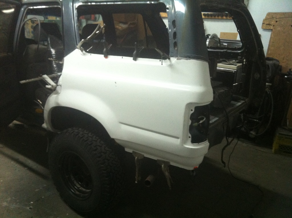

time for some test fitting
take your time .. this will take some time .. I'm about 3 hours total fitting and removing , a little trim here and there , off and on about 10 times , but you want to do this to fit them correctly

and now I'm happy with the fit ... time to fit the window
and happy with this ... I can now move on the the rust repair

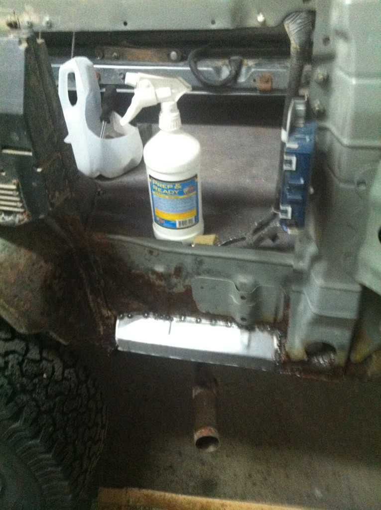

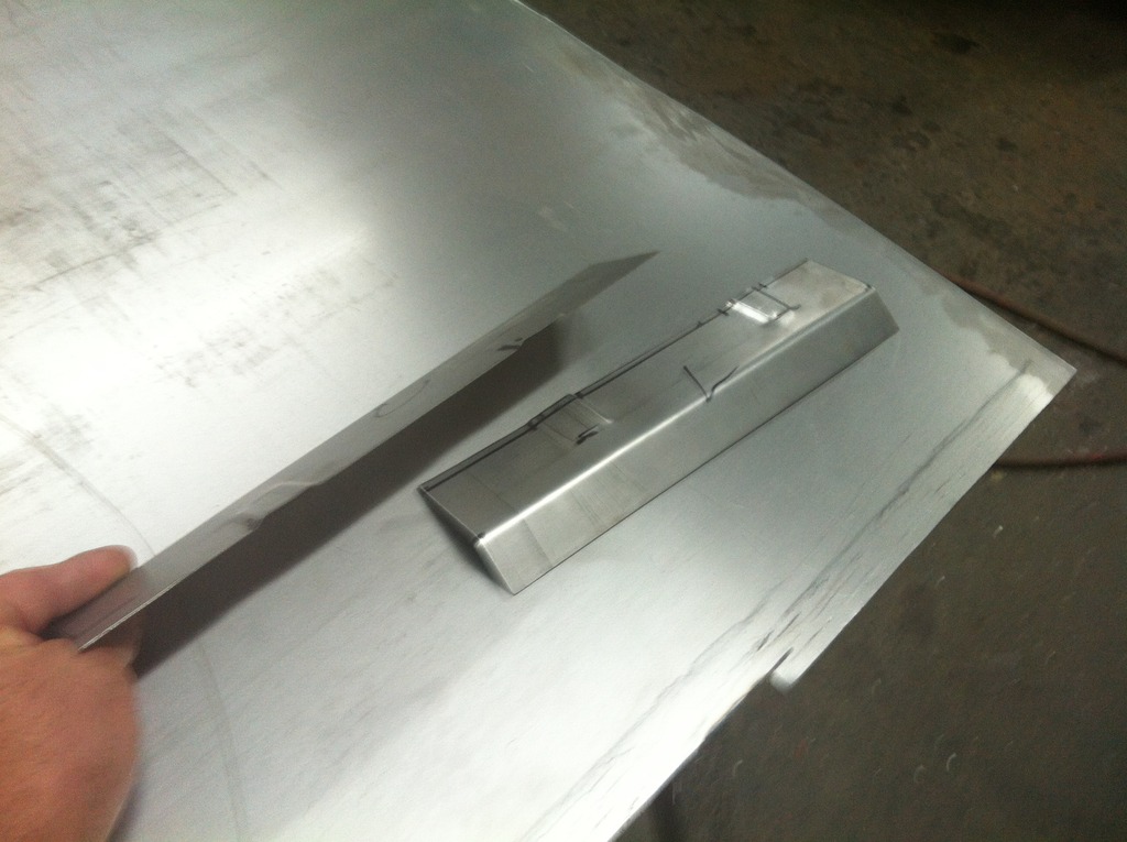

ok so now we have a great fit .. time to fix the rust

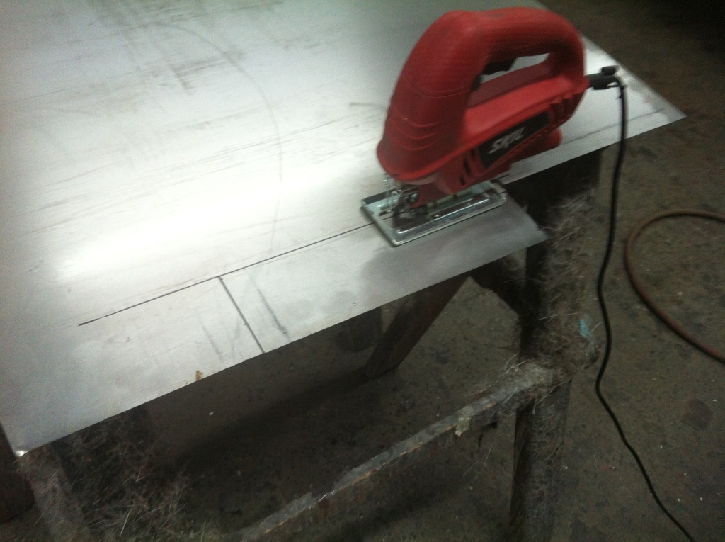

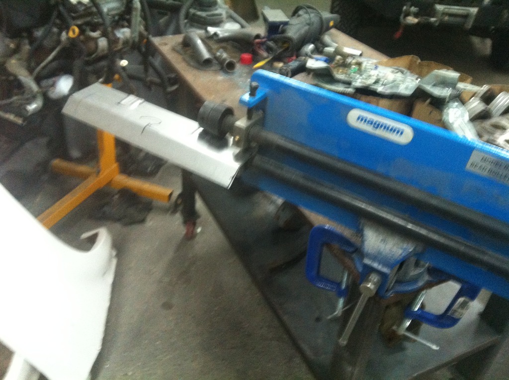

first I took a couple of measurements of the piece I would need to cut out . then got my sheet metal , drew the lines , and cut it out .. jig saw works great for these small pieces .

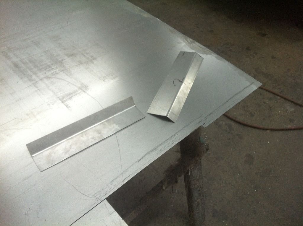

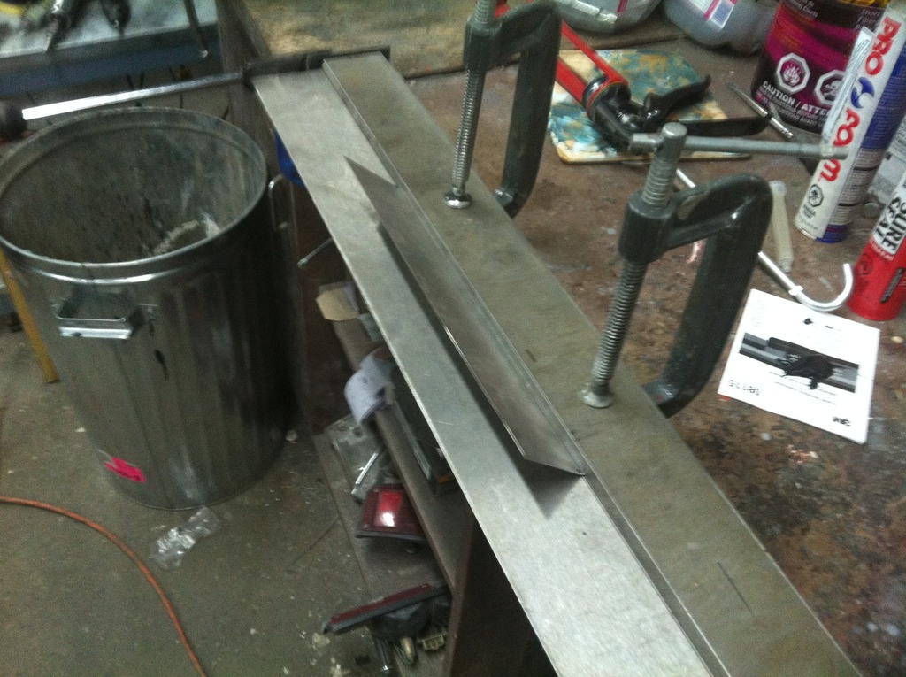

Then with the mini bender , you can put an edge on it .. a piece of 2X4 it counter edge will work as well

and now , I can take these pieces , and use them as my template for cutting the rust out

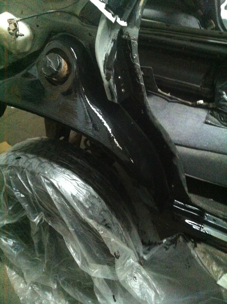

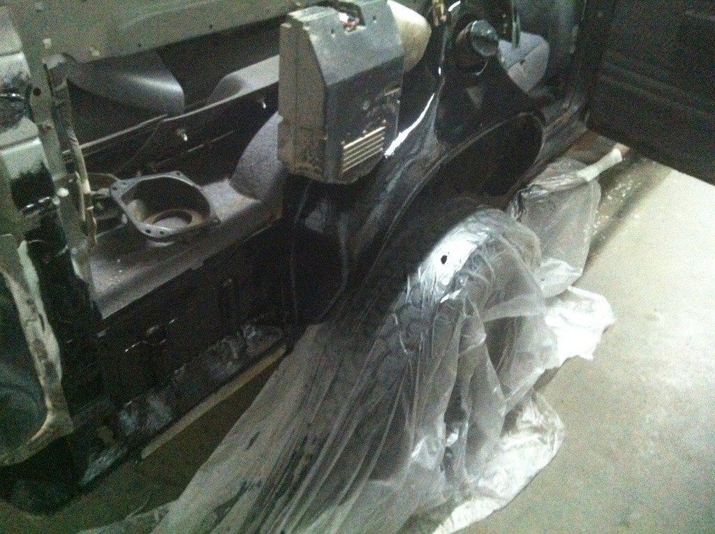

and now tacked in place I can now prep for the POR15 treatment
POR15 done .. to cure overnight

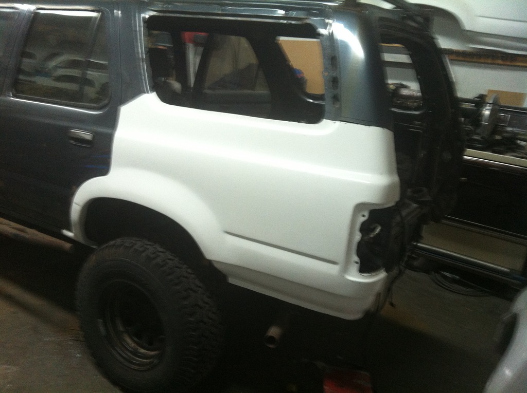

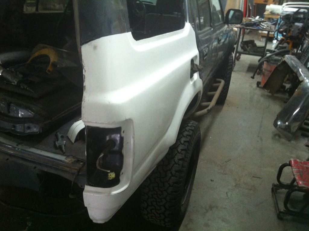

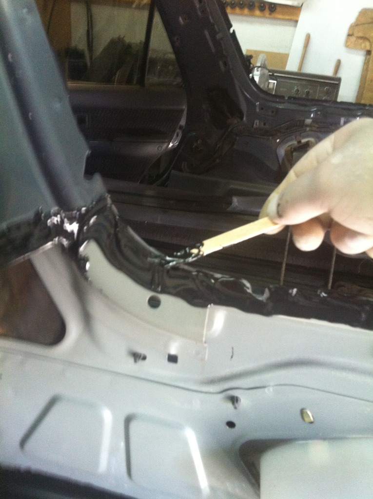

so with the long weekend over , and everything cured , time to make the sides permanent .
We use in our shop , and recommend 3M panel bonder #08115 . not cheep , but in my opinion , it is the best + it is the only product that offers a lifetime warrantee
be very liberal with it .. I use a popsicle stick to spread it out , and make sure I cover all bare metal
installed and clamped

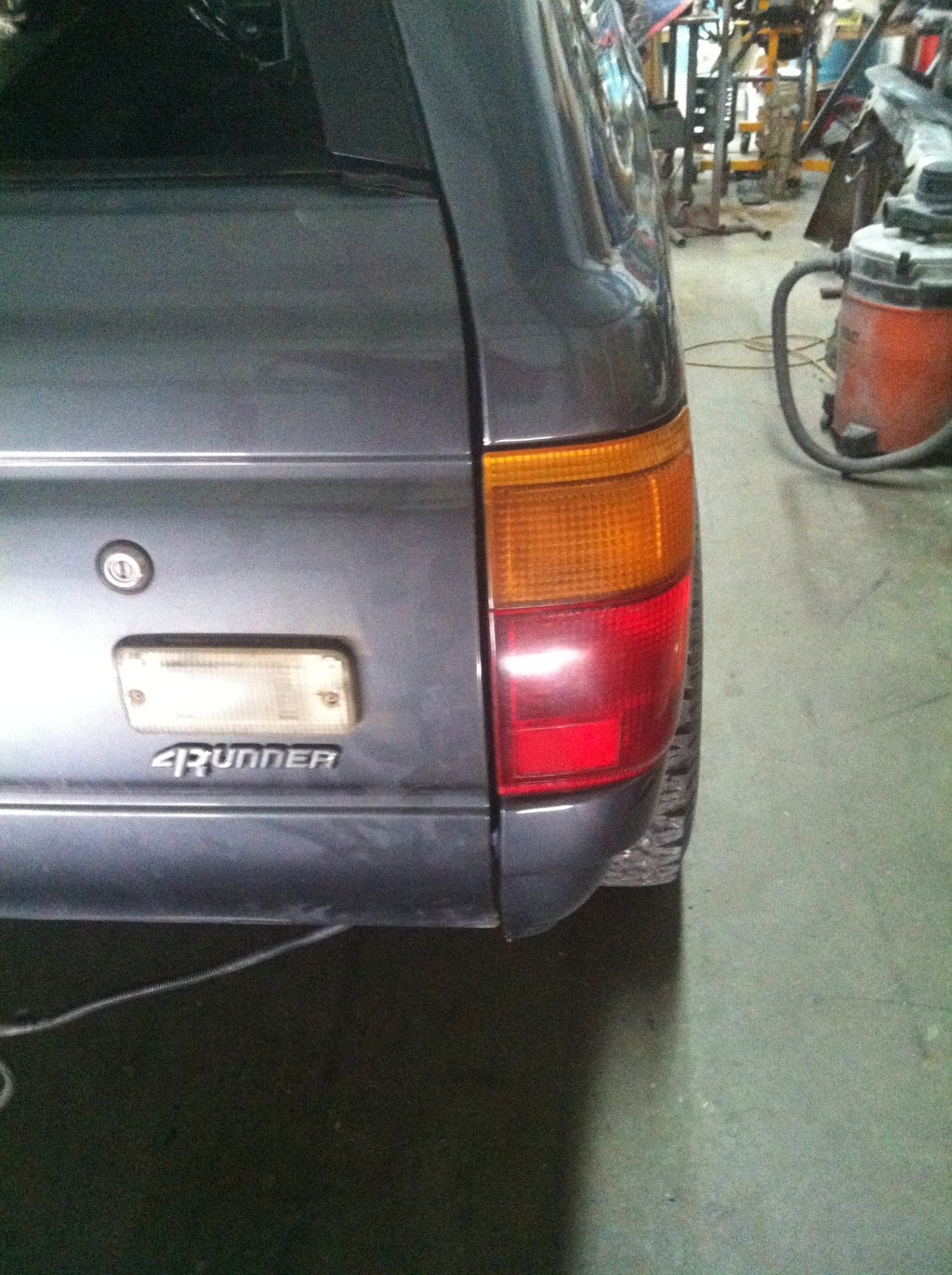

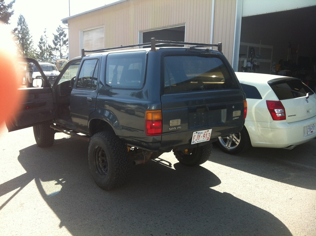

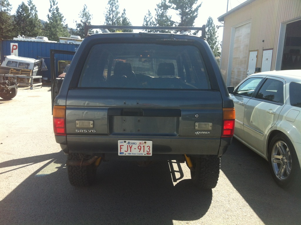

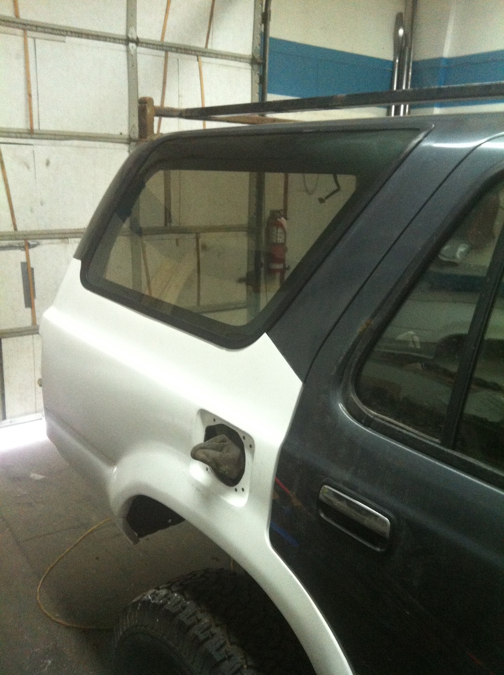

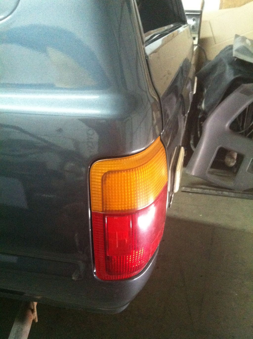

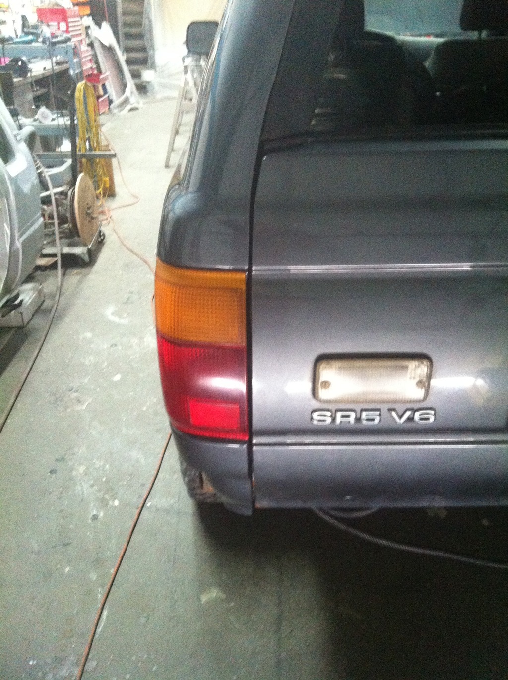

all done , Customer has picked up , paid , and even booked an appointment for next year , for more stuff .. maybe even a 3.4L engine swap ...
enjoy the pics
