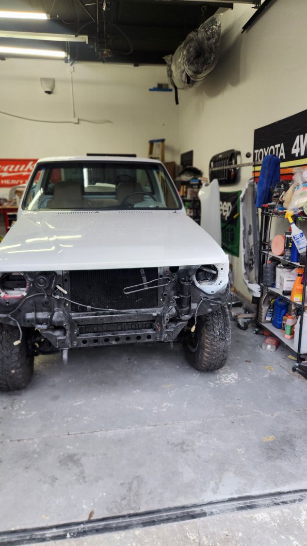

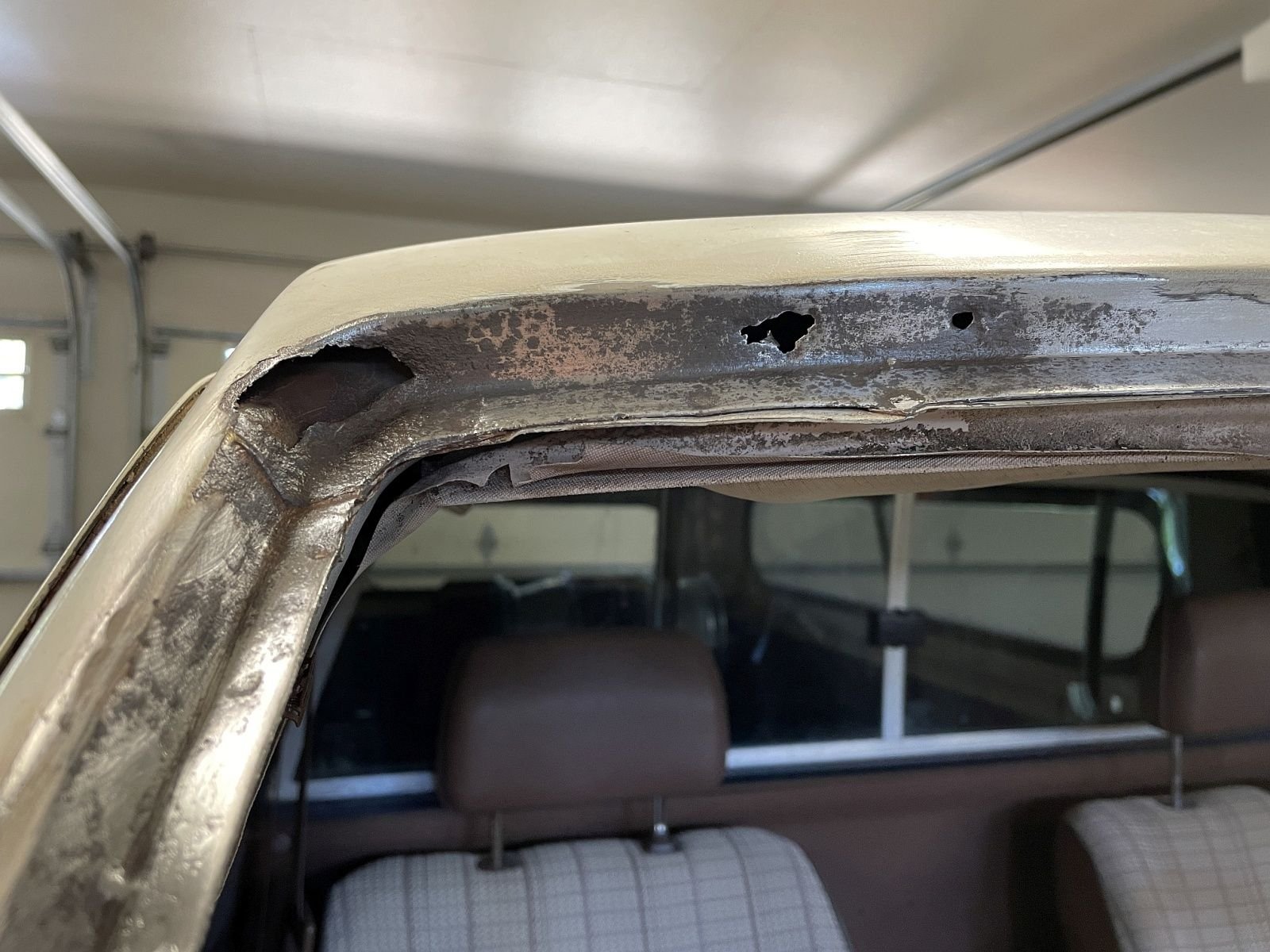

I finally found a good shop that could fix the rusted spots on my 1986 Pickup windshield frame. Marx Hot Rods in Albany, OR. Here is a before and after photo. They applied white primer, still need to paint over it.
