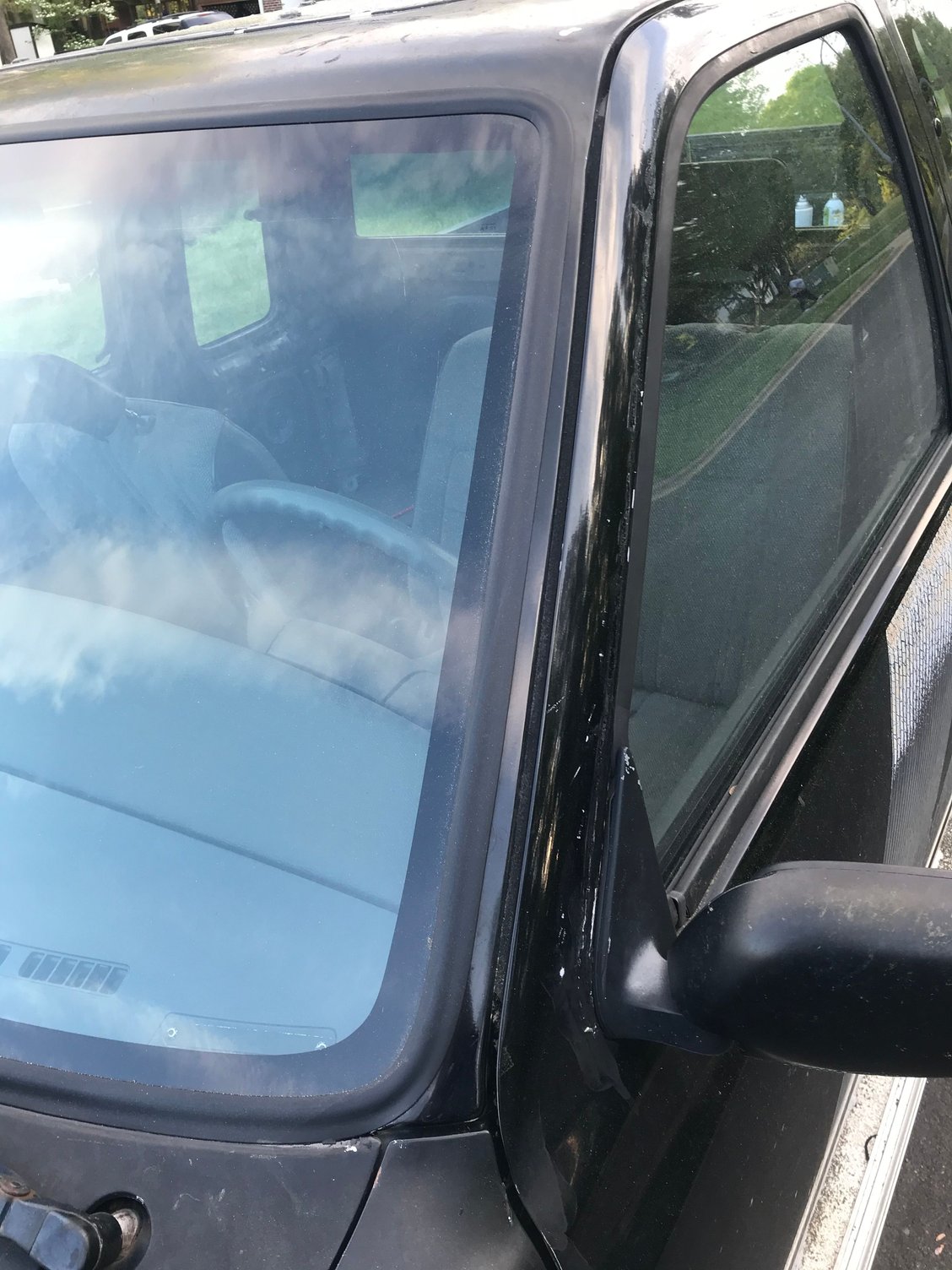

Hey vulture86. I don't know about the toyhead gasket. Back in Aug or so my neighbor was getting windshield replaced. So I asked the guy about doing my windshield.
After a bit he came over gave it a look. He had some generic (I don't recall exactly what the name brand was.) He put that around the sides and top, and about 4 inches on each side on bottom.
Then he applied some sort of 3M black glue or caulk. Said he had about 30 min to work. The stuff cured quite solid. Thats what holds the glass in. (Mine is a 95). The rubber just protects the edge.
CO gets a lot of rocks Looks pretty good for me. Might have to cut a little bit on the rubber outside on bottom. At least it looks like maybe when I put the cowl piece back on. WAs looking at that today.
Old Nov 28, 2022 | 12:26 PM
  #318
vulture86's Avatar
Joined: Oct 2022
Posts: 22
Likes: 5
From: PNW
Hey coopster, thanks for the reply. So that's one person who says yes, sealant should be used to hold the glass in the rubber gasket.
Old Nov 29, 2022 | 10:10 AM
  #319
coopster's Avatar
Joined: Jan 2011
Posts: 695
Likes: 103
From: exo-reality -wave if you see me; Front Range, CO
windshield gasket
Actually he said the sealant (some 3M stuff IIRC, in huge tube) was what holds the window on.
The rubber gasket (which only goes around top and either side on mine) just keeps debris out of channel, makes it look nicer, and I think helps maybe protect the glass edge just a bit.
I found some pics I took.
bottom edge of glass. 'gasket' seen slightly upper left
Adding back that crummy 'chrome' strip to fit under the louvre thingy
