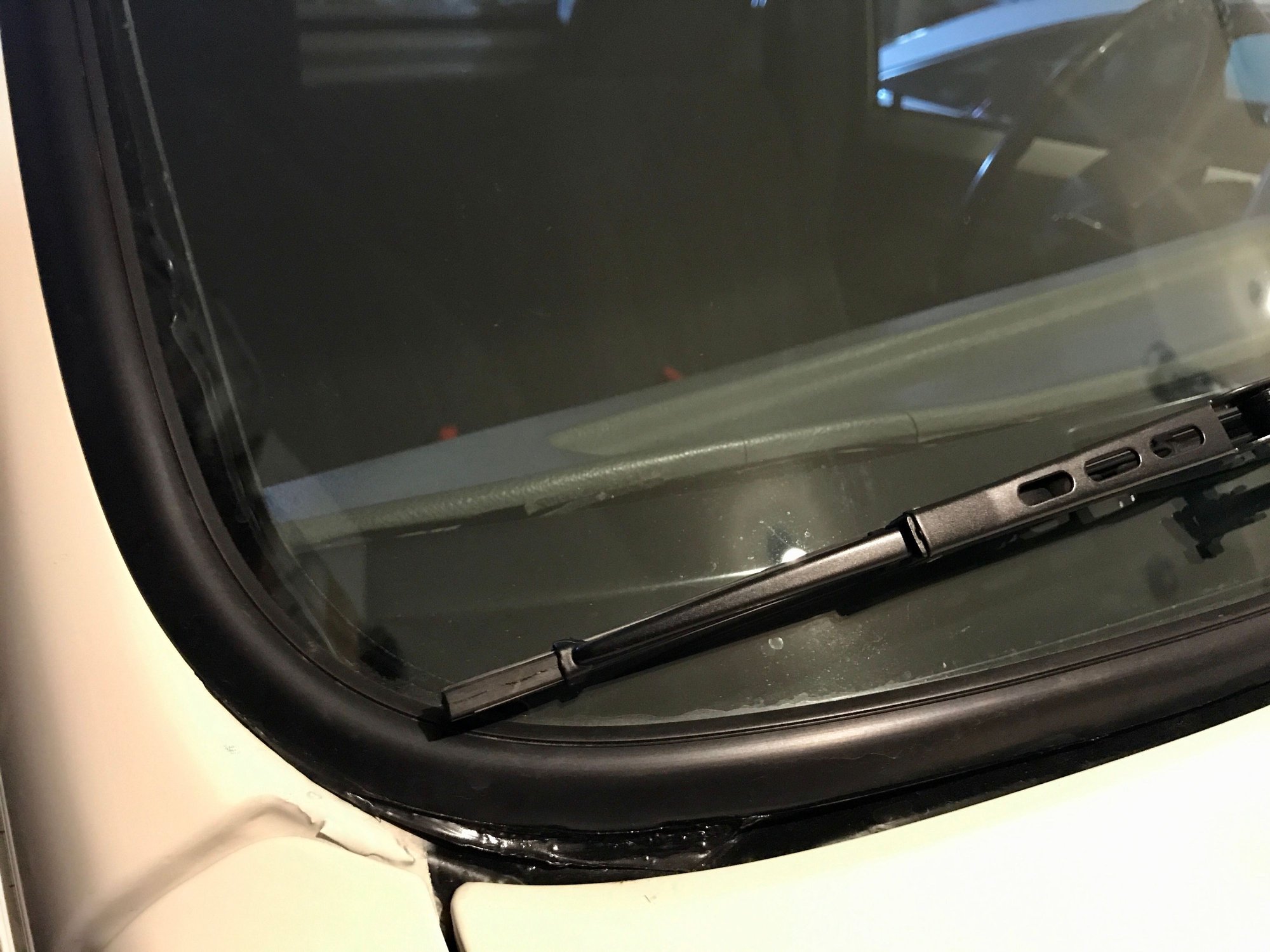

If it's any help, this is what it looks like with a generic gasket on it.
the top corner is the hard one fwiw.

I didn't know that but here's what mine looks like.
Is that urethane oozing out of the bottom left corner? if not....what in the wide wide world of sports am i looking at?
it is my understanding this type of gasket is meant to be used WITHOUT urethane.
Looks like it seals and sits well though urethane or not. Thanks!

Yes, that's what it is and it seems to work just fine.
It's "molding" not a "gasket", hence the " generic " reference from the poster and the window glued in place. You can see the window glue on the vertical surface.
Can see pinholes in the gutter seam sealer, if you start to get water intrusion fix this first before going crazy on the window.
