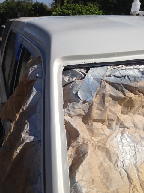

I dealt with my windshield rust in the same manner as 4beater did in post #111 of this thread.
Gasket link: http://www.4x4world.com.au/shopping/...roduct_id=5996
Ill let the pictures do most of the talking.

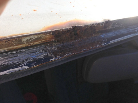

Glass, adhesive and rusted sections removed:
Attached Thumbnails Eliminating the metal windshield trim aka rust maker-img_2132-2-.jpg   Eliminating the metal windshield trim aka rust maker-img_2134-2-.jpg   Eliminating the metal windshield trim aka rust maker-img_2135-2-.jpg

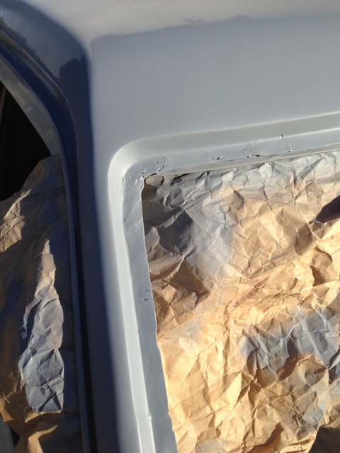

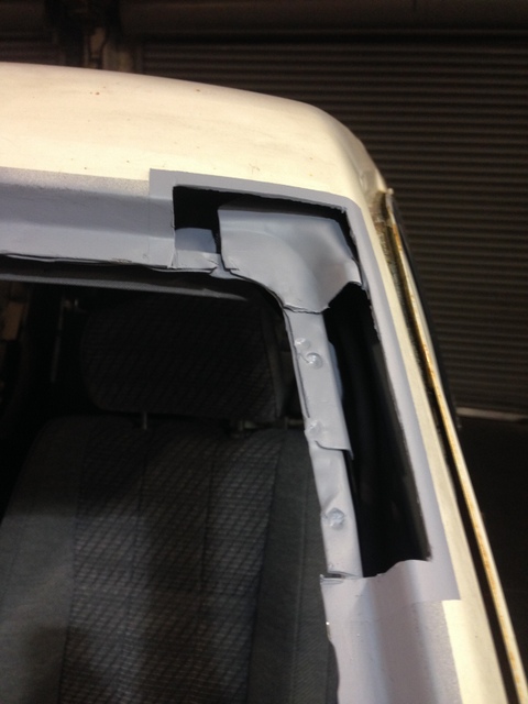

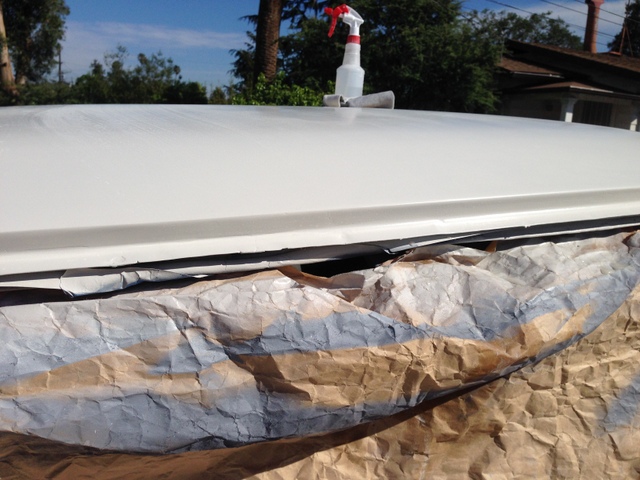

Repair sections welded in, body filler & primer.
Attached Thumbnails Eliminating the metal windshield trim aka rust maker-img_3088.jpg   Eliminating the metal windshield trim aka rust maker-img_3087.jpg   Eliminating the metal windshield trim aka rust maker-img_3086.jpg

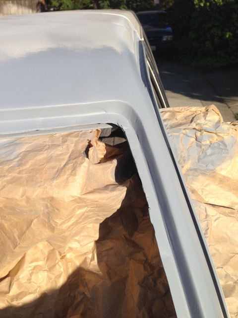

Rattle can paint job with OEM color coded paint mixed at a local auto body supplies warehouse ($23.10 a can). Rattle can clear coat (lacquer) has some tiger striping that I still need to wet sand and rub out.
Attached Thumbnails Eliminating the metal windshield trim aka rust maker-img_3098.jpg   Eliminating the metal windshield trim aka rust maker-img_3099.jpg   Eliminating the metal windshield trim aka rust maker-img_3101.jpg

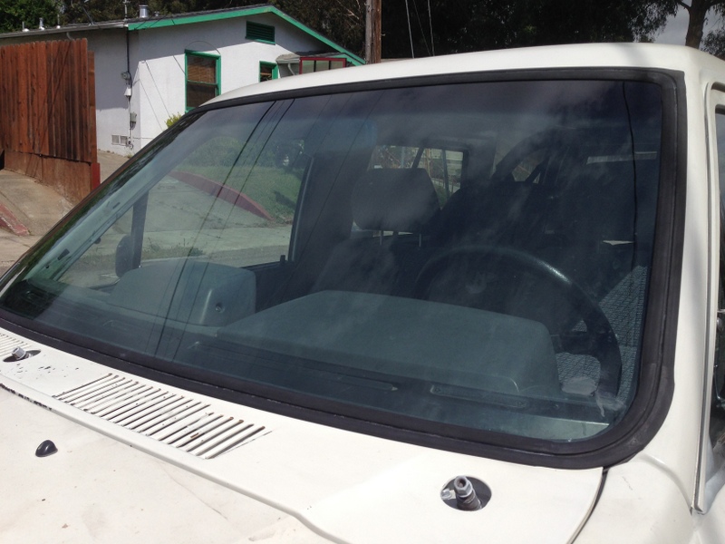

Finished product. No leaks, the dash didn't have to be removed and all the trim fits like it should.
The gasket installs just like an old VW bug (search for video examples). Have one person on the outside and one on the inside, take your time & use plenty of soapy water. I also used the rope & soapy water to re-install the cowl.

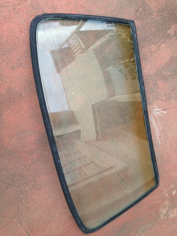

After doing a bunch of online research - I concluded that South American & Australian models (Hilux & Surf) came with windshield gaskets. I didn't think Toyota would re-tool an entire body just for different windshield mounting. I'd be more 'cost effective' to use the same body and glass and just adapt a rubber gasket.
I bought the gasket from the link above, tested it on a old cracked windshield and it fit perfect on the glass. After scraping, grinding & cleaning off all the glue from the windshield frame (hardest part of the job), I then laid the cracked glass with rubber gasket into the window frame. It seemed like a match and as you can see from the permanent install - it works perfect.
Gasket test fit & pre-repair pics:
Attached Thumbnails Eliminating the metal windshield trim aka rust maker-img_1070.jpg   Eliminating the metal windshield trim aka rust maker-img_1955.jpg   Eliminating the metal windshield trim aka rust maker-img_1957.jpg
