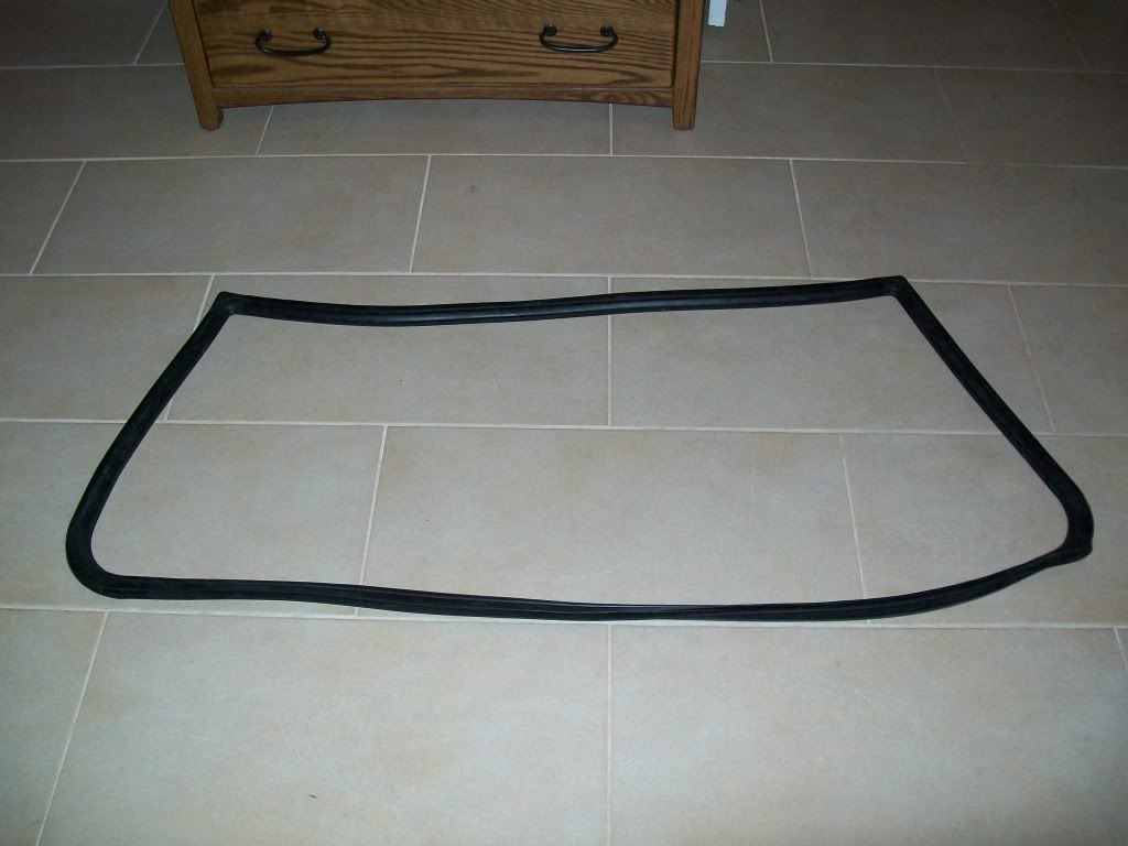

so i got the gasket on thursday.

it was about 90.00 with shipping. and the gasket is kinda like a truck rear window gasket. it has a channel for the windshield and a channel for the pinch weld on the truck.

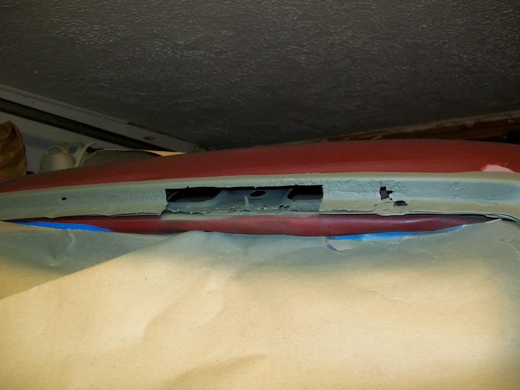

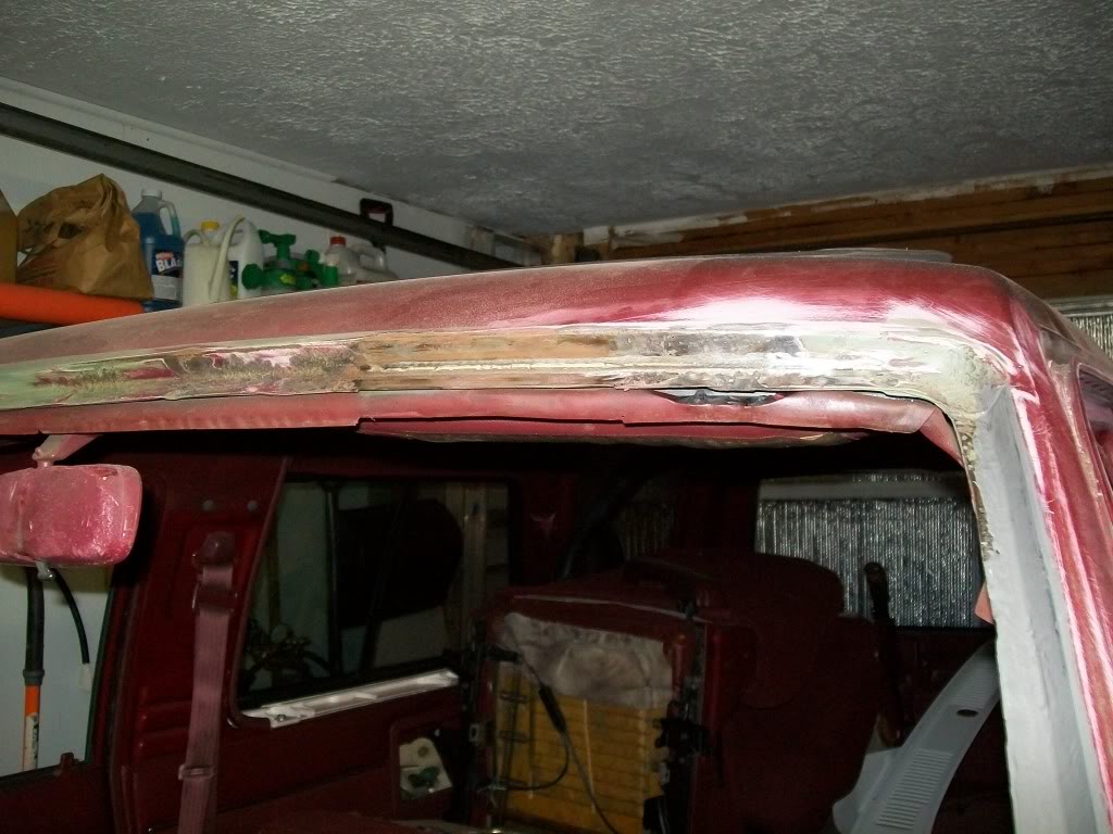

lets see some pics. this is what i did, i replaced the parts with steel that where completely gone, filled all small pin holes with silver solder. then hit it with a wire wheel to get all the pit-marks clean and used multiple coats of jb weld to smooth all the pit marks out.
i did sand that nub down on the top driver corner
