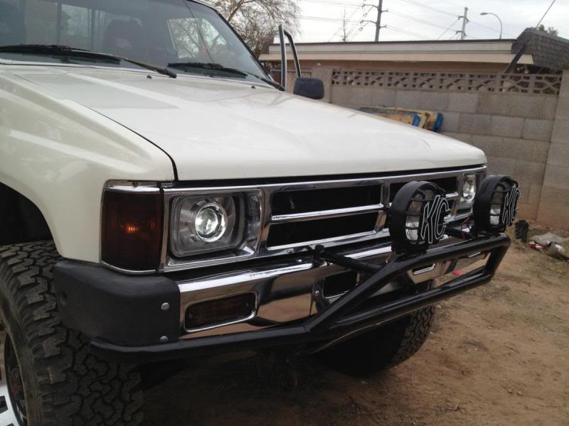

Check out http://www.theretrofitsource.com/ for a serious upgrade. I built my my headlights using Autopal housings and retrofitting their DS2 mini projectors into them. The output it amazing and the cutoff is better than any halogen. Just more options to consider.
xXbrutalXcoreXx, yeah- Proper HID is definitely the ultimate. I love the cut-off and wide beam spread. How labor-intensive is it? hoe expensive? Got a write-up?

I haven't found a clear cut write up for retrofit projectors into an h6054 housing, but the process was pretty straight forward. I'd say from start to finish, I had about 20 hours invested in the retrofit. Most of the time I spent wondering how the projector would even fit in the housing. Once I had the first one done, I had the 2nd one completely done start to finish in just 2 or 3 hours. You can check out the prices on the site that I listed, but it looks like the current price for just about everything you'll need projector wise is $110. So all in all, it is really not that expensive at all if you look at prices of buying completed projectors. This is the thread that got me first interested in retrofitting: http://www.hidplanet.com/forums/show...trofitting-it!
