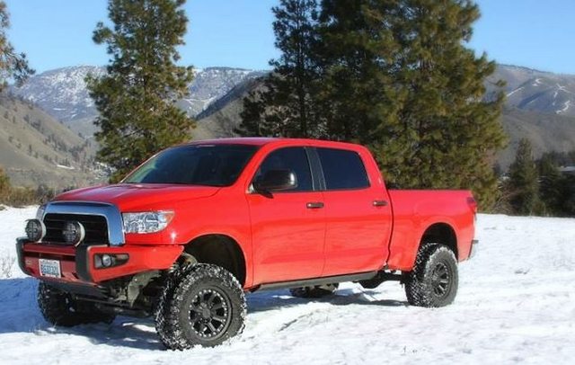

Before:

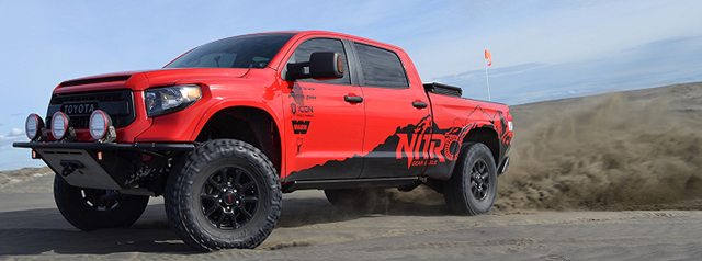

And after.
Just Differentials Toyota Tundra Crewmax w/ 6.5' bed-rilbfq2l.jpg

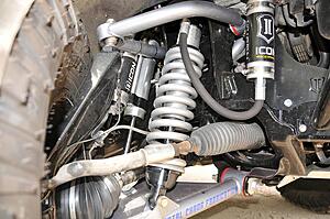

-Total Chaos Long Travel Front and Rear Suspension
-Icon Vehicle Dynamics Remote Reservoir shocks with secondary Bypass shocks

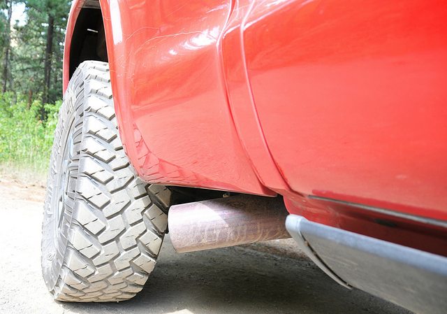

-Doug Thorly Headers & Mid Pipes

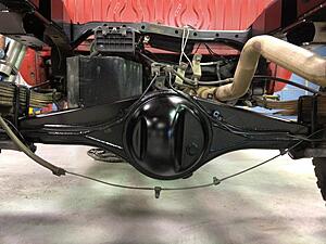

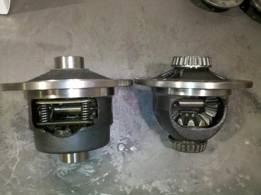

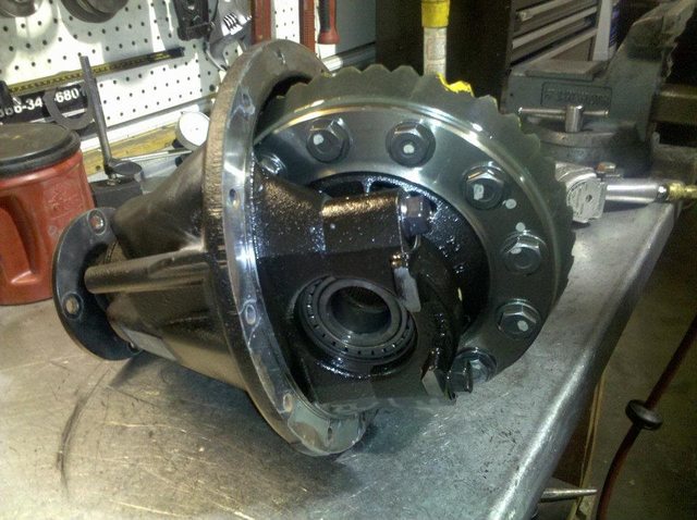

The Monster 10.5" differential got Nitro Gear & Axle 's 1st set of T10.5-488-NG 4.88 R&P gears:
Just Differentials Toyota Tundra Crewmax w/ 6.5' bed-lbwplxhl.jpg
And an Auburn Pro LSD, now the 500+ HP can get to the ground, much more beef to this one too:
Just Differentials Toyota Tundra Crewmax w/ 6.5' bed-p7dhqojl.jpg

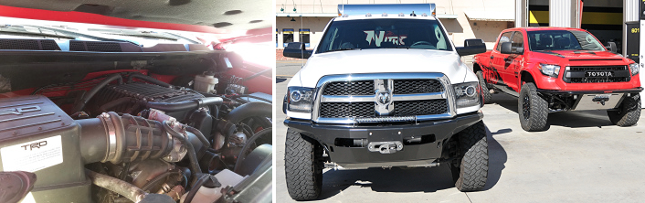

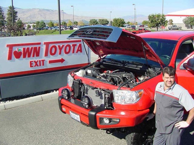

Roy at Town Toyota installed the huge Toyota Racing Development Supercharger:
Just Differentials Toyota Tundra Crewmax w/ 6.5' bed-cieib2ml.jpg

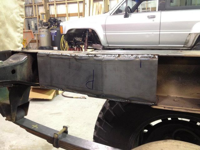

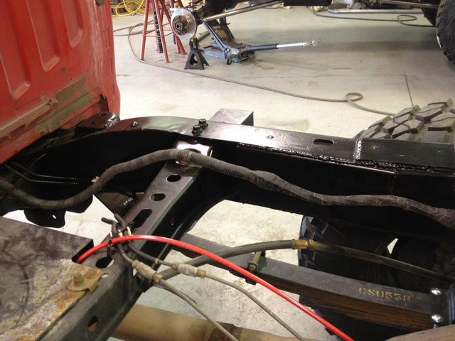

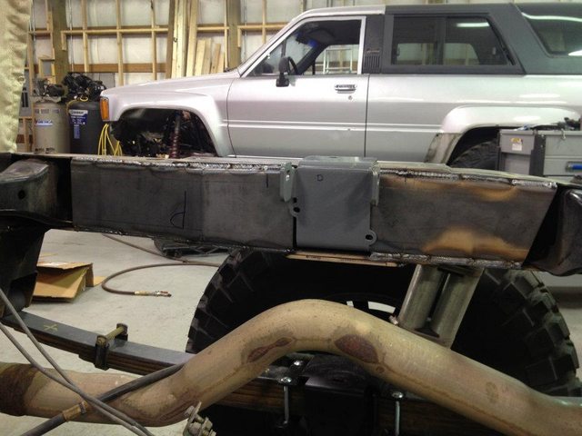

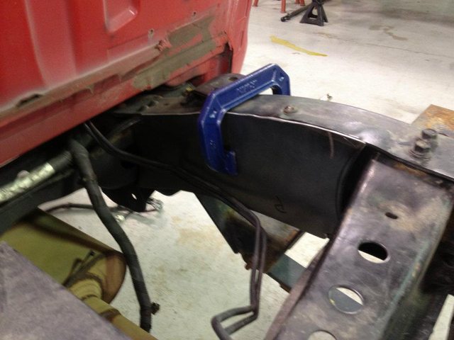

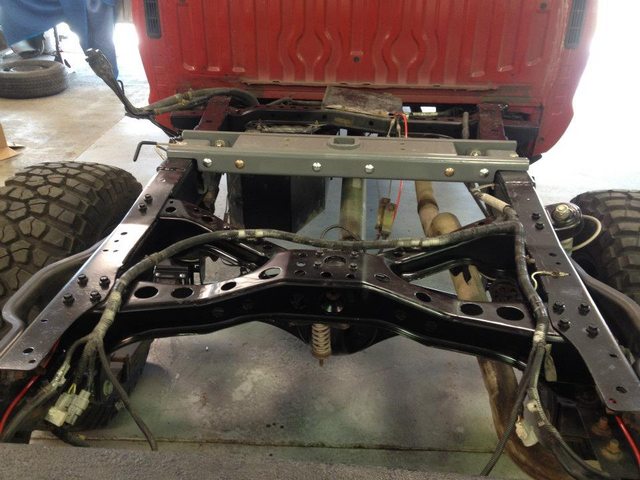

Time to box in the floppy tundra frame:
Just Differentials Toyota Tundra Crewmax w/ 6.5' bed-cktfib2l.jpg
Just Differentials Toyota Tundra Crewmax w/ 6.5' bed-qca4ut5l.jpg
Just Differentials Toyota Tundra Crewmax w/ 6.5' bed-3ppx3cql.jpg
Just Differentials Toyota Tundra Crewmax w/ 6.5' bed-sc94invl.jpg

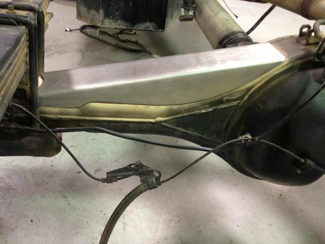

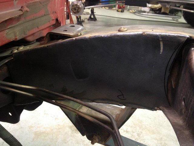

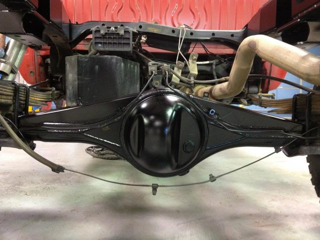

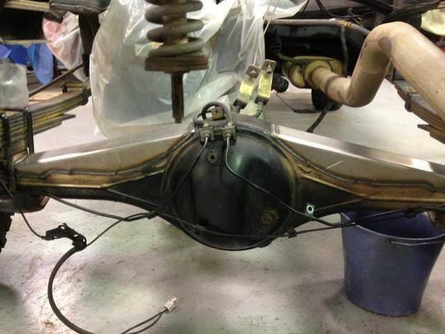

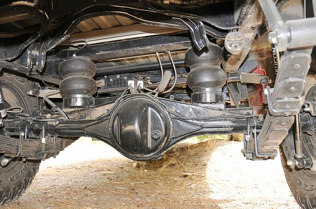

Toyota decided to use a huge 10.5 which is great. but then they put it in a housing with minitruck axle tubes:
Just Differentials Toyota Tundra Crewmax w/ 6.5' bed-s5teqwwl.jpg
Just Differentials Toyota Tundra Crewmax w/ 6.5' bed-allqurpl.jpg
Gussets welded and painted up:
Just Differentials Toyota Tundra Crewmax w/ 6.5' bed-hgdboggl.jpg

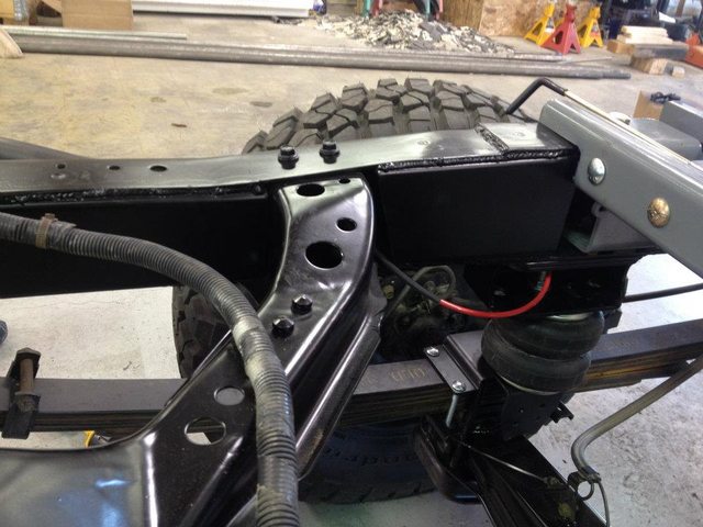

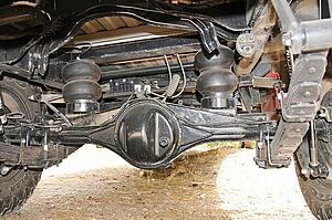

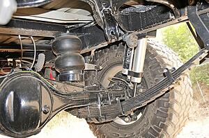

Airbags to keep the truck level under load as well:
Just Differentials Toyota Tundra Crewmax w/ 6.5' bed-cqerpbkl.jpg
Frame stretched and boxed:
Just Differentials Toyota Tundra Crewmax w/ 6.5' bed-zuncymkl.jpg

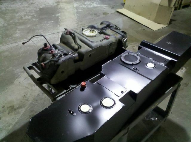

Added a Transferflow 46 gallon tank:
Just Differentials Toyota Tundra Crewmax w/ 6.5' bed-iqtoqhkl.jpg

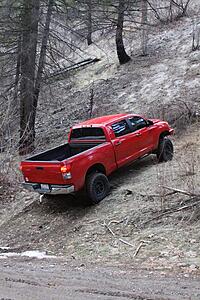

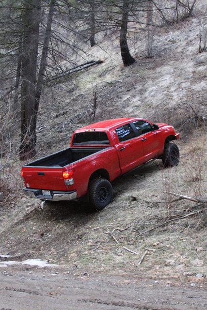

Getting off the road:
Just Differentials Toyota Tundra Crewmax w/ 6.5' bed-cy0pvtil.jpg
Just Differentials Toyota Tundra Crewmax w/ 6.5' bed-z17epvdl.jpg
Just Differentials Toyota Tundra Crewmax w/ 6.5' bed-fq7kpoxl.jpg

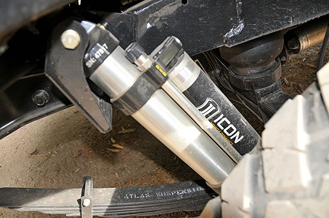

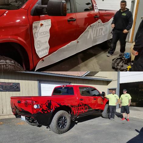

CW Wraps did a great job on the Tundra, we will be debuting this truck off at SEMA in a few weeks!

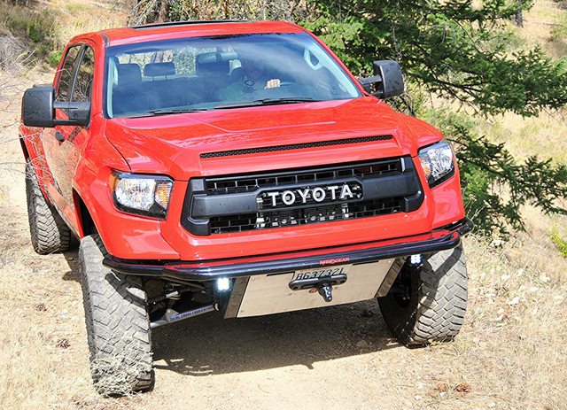

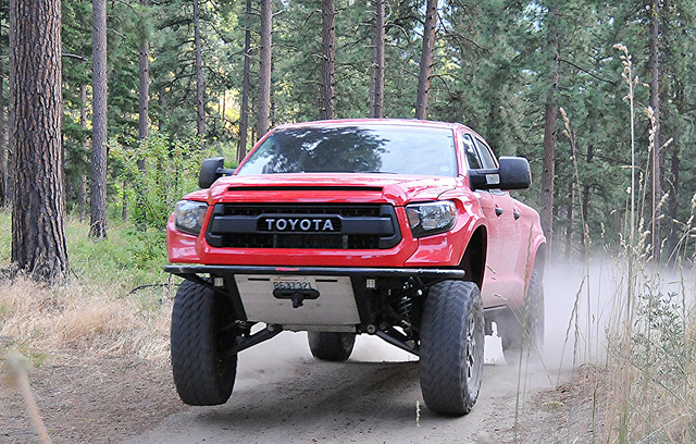

Here are some more pics of how it sits now:
Just Differentials Toyota Tundra Crewmax w/ 6.5' bed-pkjdbn9l.jpg
Just Differentials Toyota Tundra Crewmax w/ 6.5' bed-zd2o44hl.jpg
Just Differentials Toyota Tundra Crewmax w/ 6.5' bed-qohdxojl.jpg
Just Differentials Toyota Tundra Crewmax w/ 6.5' bed-7umb8rrl.jpg
Just Differentials Toyota Tundra Crewmax w/ 6.5' bed-nwdfuvxl.jpg

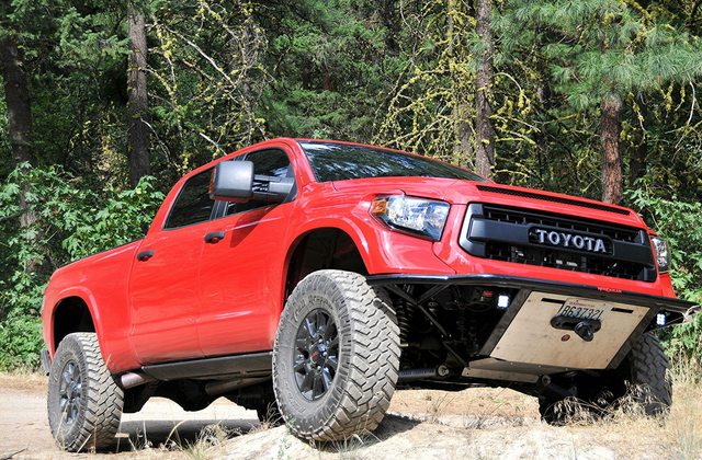

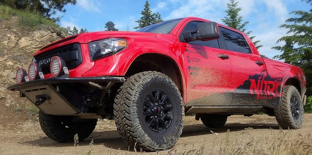

Just Differentials Toyota Tundra Crewmax w/ 6.5' bed-7bjjaqvl.jpg
The Nitro Tundra has been a very long lived project for us and gone through an evolutionary process from mildly modified with a stretched chassis to a full update last year for the SEMA show in Las Vegas. It’s been a great truck and is a ton of fun both on and off-road.
Just Differentials Toyota Tundra Crewmax w/ 6.5' bed-fqmaz0q.png

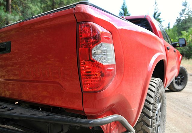

Summer 2015 we swapped 2015 TRD Pro Tundra sheet metal front and rear including the lighting combined with SDHQ pre runner style fenders/bedsides for more clearance in the wheelwells. Add in a combo of Total Chaos long travel control arms, custom Atlas springs (now sprung under with floating air springs for load capacity) and bypass Icon shocks all around and this rig was clearly build for more than just show. An SDHQ front bumper mounting 3 ARB Intensity lights and Rigid fogs improved clearance without sacrificing the Warn 9.5XP winch or nighttime illumination. Rear bumper and hitch assembly (it still tows regularly) were custom fabricated in house. Finally, new Nitto 37″ Trail Grapplers wrapping black TRD wheels put the power to the ground.
This wasn’t exactly a stock rig when we started. The earlier build included the aforementioned TRD Supercharger, ran a color matched ARB bullbar, upgraded suspension and a fully boxed rear frame section lengthened 12 inches to accommodate the long bed instead of the standard tiny box as this Crewcab was equipped from the factory. It was a good, usable combination with somewhere north of 500HP, but visually not very unique.
Here it is before:
Just Differentials Toyota Tundra Crewmax w/ 6.5' bed-gbqhcpul.jpg
And after.

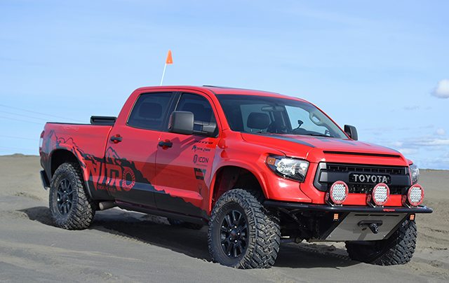

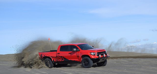

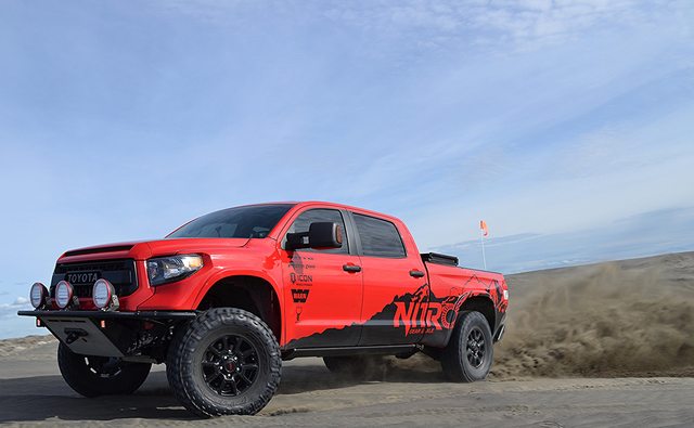

With the weather finally improving enough to go have some fun we took the Tundra to the only dunes in our area and let it off it’s leash for the first time since the rebuild. The Auburn Pro LSD unit and Nitro 4.88 gears easily took the power from the Supercharged V8 without issue and the Doug ThorleyDoug Thorley Headers headers and pipes sound amazing at full song
. The truck is an obsolute blast in the rough stuff as the suspension sucks up big and little whoops at ridiculous speeds for a daily driven street truck and sounds awesome doing it. Add in all that horsepower on tap with its supercharger whine and we’re really pleased with how this project has turned out. Nice on the street, still tows toys well and is extremely capable in the dirt.
Specs:
Sponsors: Nitro Gear, Toyota USA, Icon Vehicle Dynamics, SDHQ, ARB, Auburn Gear, Nitto, Warn, Total Chaos, Amp Research
Wheel Base: 160”
Track Width: 88”
Over all Length: 21’8”
Over all Height: 79”
Type: Toyota 5.7 3UR-FE, TRD Supercharger
Output: 550HP
Engine management: Bullydog / Toyota
Exhaust system: Doug Thorley longtube, magnaflow muffler, custom piping
Fuel Tank: Transfer Flow 46 Gallon
Transmission: ITP High Performance Valve Body
Differential gears brand: Nitro 4.88 (world’s first set!)
Birfields/CV brand: OEM, w/ Total chaos extended shafts
Locker-Rear: Auburn Pro LSD

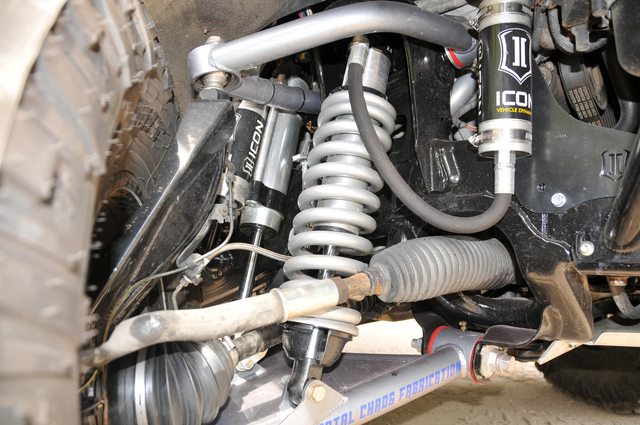

Suspension Total Chaos Long Travel front and rear
Shock absorbers, f/r: Icon Double Bypass, (dual front),
Springs, f/r: Eibach front, Atlas rear
Sway Bars: Curry Rear antirock
Bump Stops: Icon hydraulic rear, Timbren front
Seats: Classic Softrim Leather, heated seats
Front bumper: SDHQ Prerunner
Rear bumper: Custom Krys-Fab
Sliders: Amp Research power steps
Skid plates: SDHQ
Winch: Warn XP9000
Winch rope: Warn Synthetic
Other safety/Interior gear:Factor 55 Prolink
Brakes: Pads/Shoes, f/r: TRD Pads, Crossdrilled, slotted rotors, Stainless lines

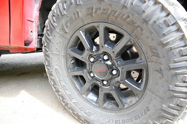

Tires: Nitto Trail Grappler 37/12.50R18/Toyota TRD Pro 18”wheels
