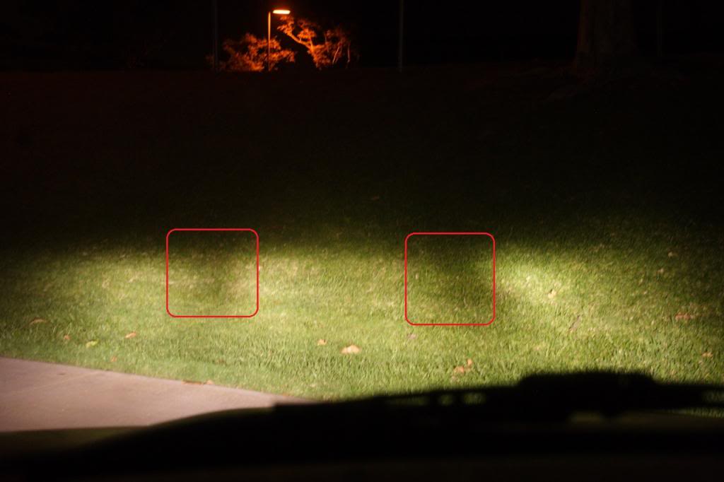

Do not get AutoPal (Ebay stuff) if you're picky. It has poor optics. Has dark spots, shown here on mine:

Improvement in brightness but that's a band-aid; You won't be fixing poor wiring design. See Daniel Stern Lighting website or my thread for explanation, Re: Voltage Drops and worse yet, wear on dimmer switch.
What are you pictures showing? Is this with upgraded lights and stock wiring harness? Also are you saying don't buy a premade harness like suggested above? Thanks for all the replies
please read post ^^ thoroughly

Originally Posted by blakefogt
Do these give even beam pattern, without voids like the Autopals in my post ^^)? TAI

I do not have stock wiring. I modified. It improved light output even when I had stock sealed beam. Later I installed housing upgrade by AutoPAL which came with "standard" halogen bulb. This further improved light output.
Also what do you recommend to put in for headlights. ...I would like to stay under $200... although they look really nice I don't want to spend that on headlights
Sensible decision not to spend too much on the light.
Housing:
Some housings come with bulb, some do not.
If you want to upgrade with least expense, and OK with the dark spots^^, Autopal housing is OK.
If you're willing to spend more, AND IF recommenders of Roundeyes or Hella housing ^^ say they have more even beam pattern than AutoPAL, then go for it.
