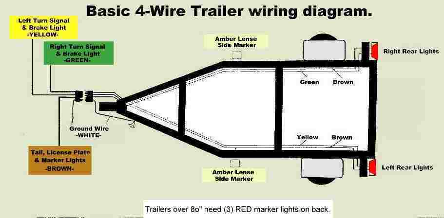

Did youcheck the trailers wiring harness for damage?
Could you doublecheck the trailers lights with a vehicle that it is known to work with? This isto eliminate damage from who used it last.
Do the wiringharnesses color codes match?
I am thinking itcould be that you need an adapter?
YourRig --- Wiring Harness ------ Connector --- Trailer Harness ----- Trailer
_____(White)=[Ground]___________[-]______( ?)_________====OO==
_____(Brown)=[Tail]______________[-]______(? )_________
_____(Yellow)=[L + Stop]___________[-]______(? )_________
_____(Green)=[R + Stop]___________[-]______( ? )_________====OO==
Those are the colors from my 98 4Runner.
I also have two different pigtail connectors the one shown, and another without the white ground wire.
I found a link that may help.
http://www.uhaul.com/MovingSupplies/Quick-connects/1/Toyota

I found this hope it can help somebody.
