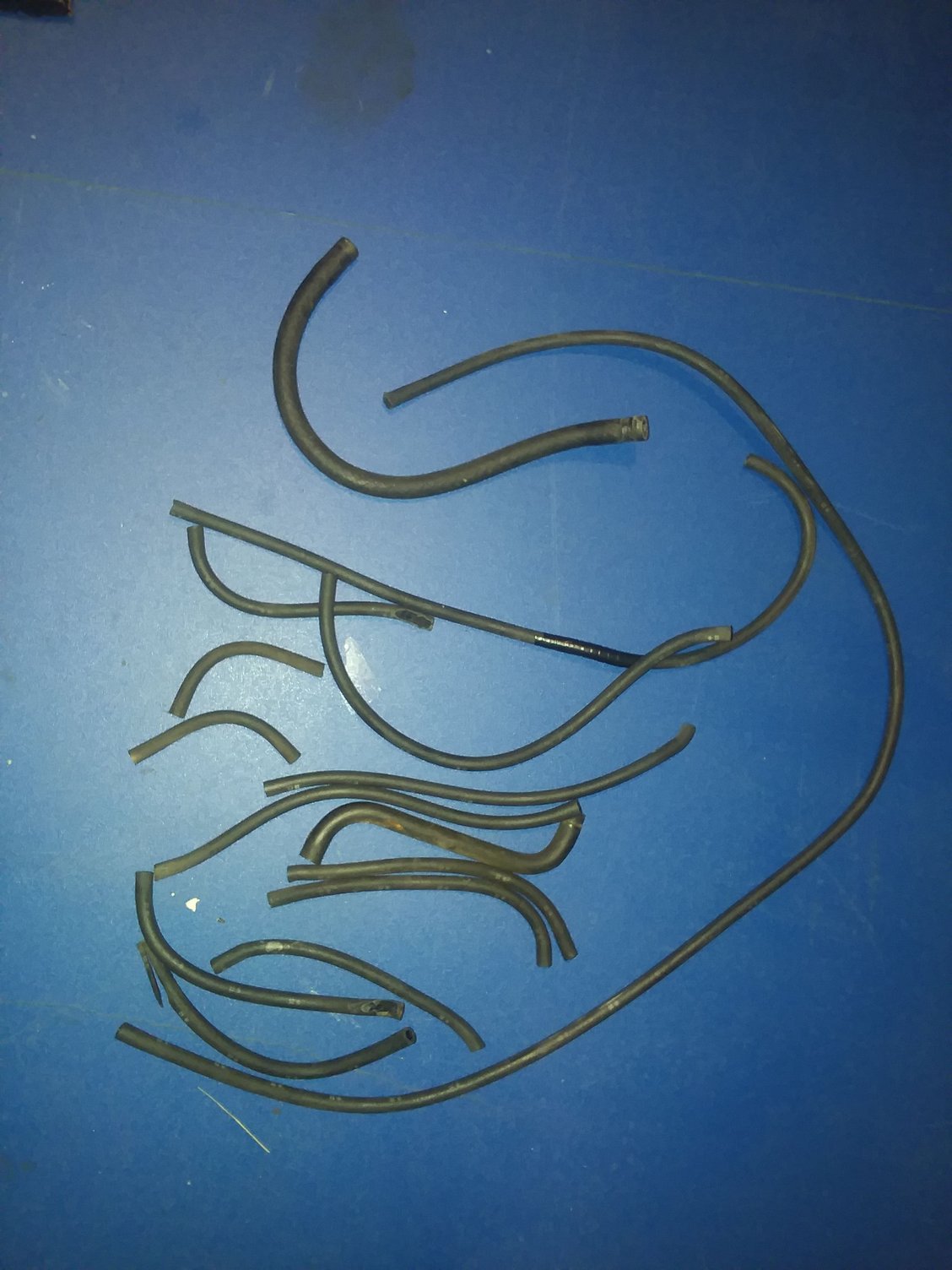

all the remaining vacuum hoses have now been switched to silicone plus I replaced the fuel hose from the charcoal canister going to tank with new ethonal resistant fuel hose. The only thing I have had for issues with the silicone is any place it may rub it wears through easily. I'll keep an eye on that.

Damion, do you remember total length of each size hoses you used? I'd like to replace mine, too.

I got the kit from LC Engineering and just cut to fit each one as I went. The power steering pump air hoses and PVC hoses are from 22RE performance.
and I'm wrong two hoses remain. The IAC valve hoses are still old. 76 bucks for them. I'm thinking about some other way for that.

Better than me measuring here the actual measurements that came with the kit 8 mm 1', 6 mm 4', 3 mm 12'. Or part #1 072442 from LCE .

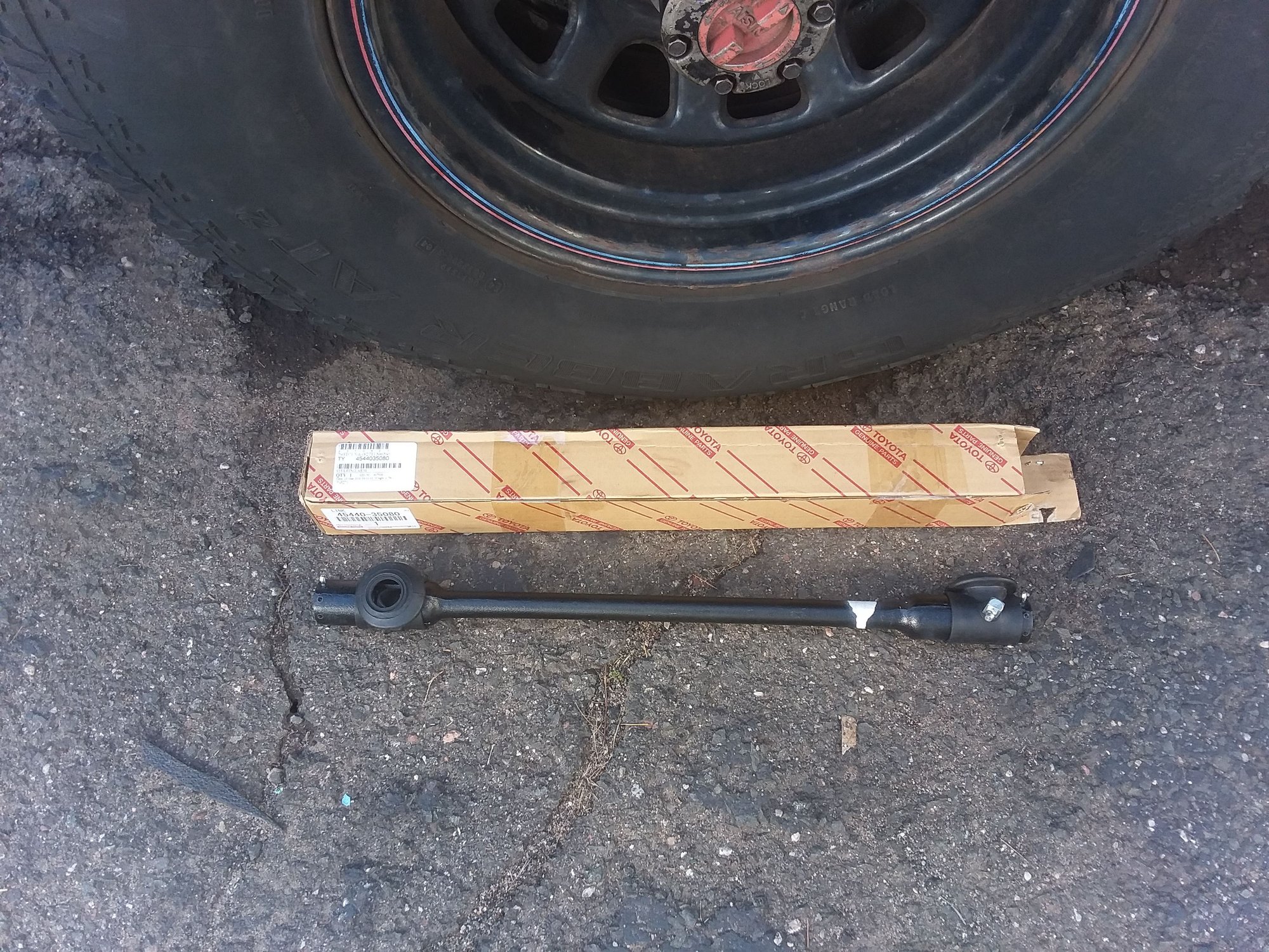

Latest score on e bay. For slightly more than the rebuild kit on the drag link I've got the complete OEM drag link. I'm guessing the original is not going to come apart on the hub side. It's fairly rusted together. I'll still attempt to free it up though but no worries now.

Yup the original drag link was a loss the end on the hub side had to be cut off . It had no grease in it and was rusted together. I'm glad I went with this.

Actually the steering was already good but that end of the drag link on the hub\ carrier was going to become an issue fast. No grease was going into it and the rubber boot was split letting water in for who knows how long. Even after cutting the drag link apart the inner cup is still rusted to it.

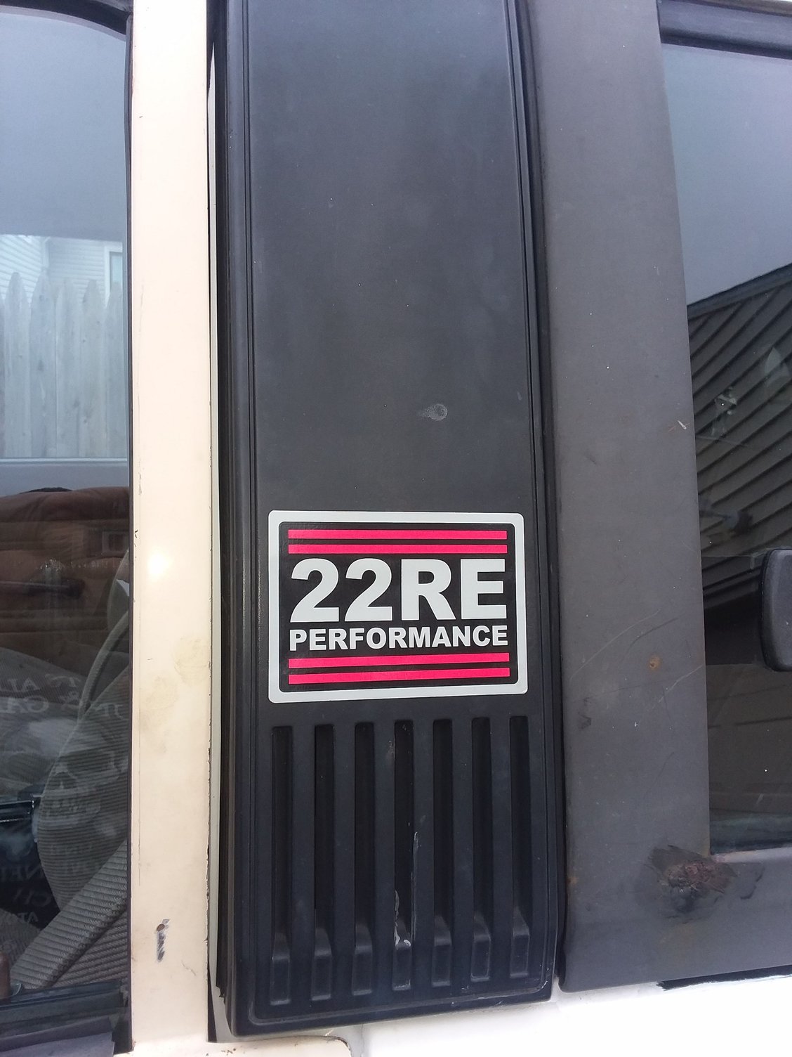

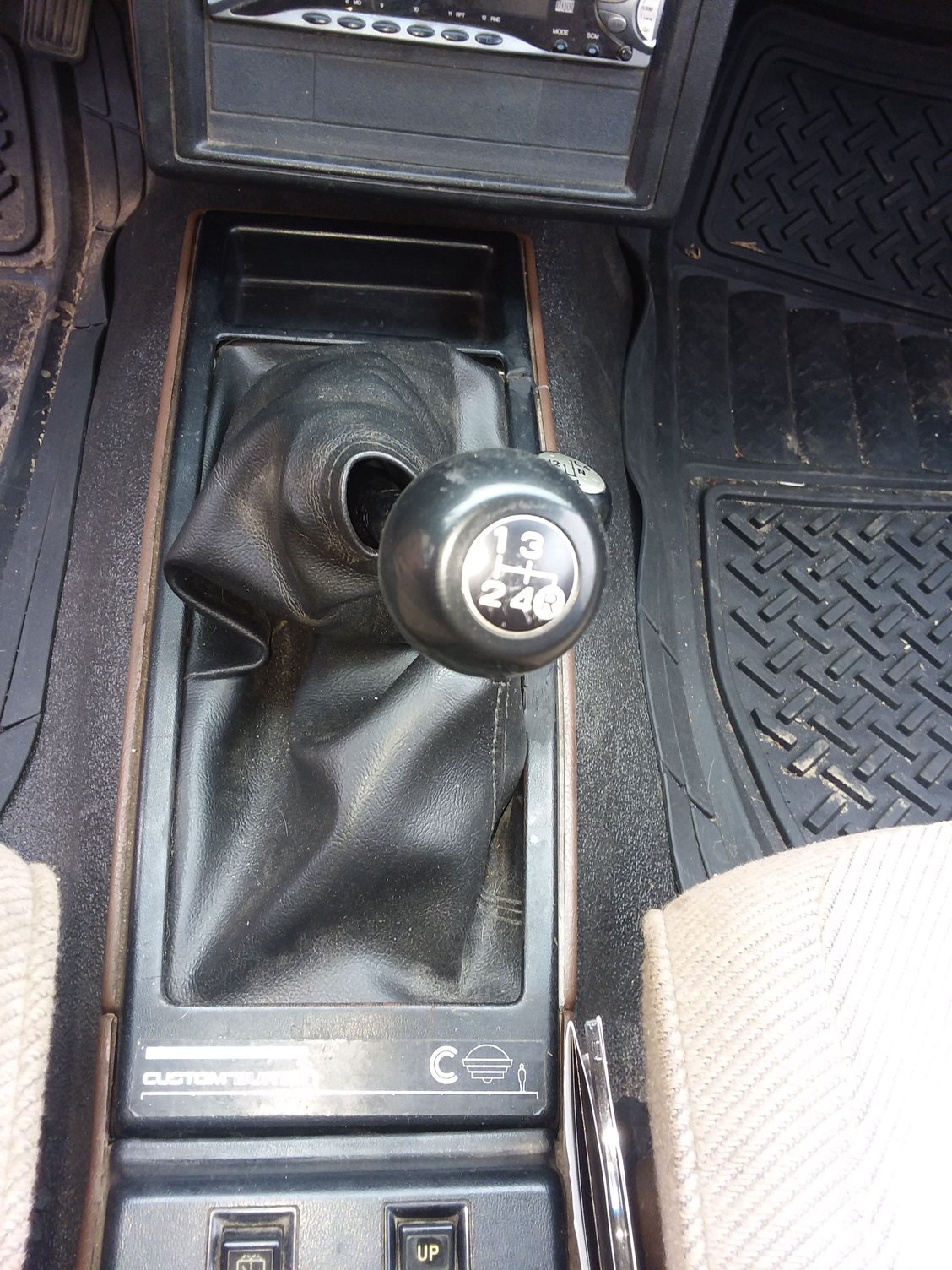

a couple more improvements. I was working on fixing and repainting the 4runner side badges but they are in bad shape and didn't really come out too well. So I just slapped some decals on the spots for now. The 4 speed shift knob is from my first Toyota truck and first new vehicle 1990 2WD. The original shift knob was missing the label like so many and this one was basically new since I switched to a T handle with in a month of owning that truck . It's just kinda nostalgic 😂

interesting that your console does not have the “window lock” button between the wiper and rear window control.

yeah, that switch must of come later. How about the symbol that looks like a guy standing next to a UFO?

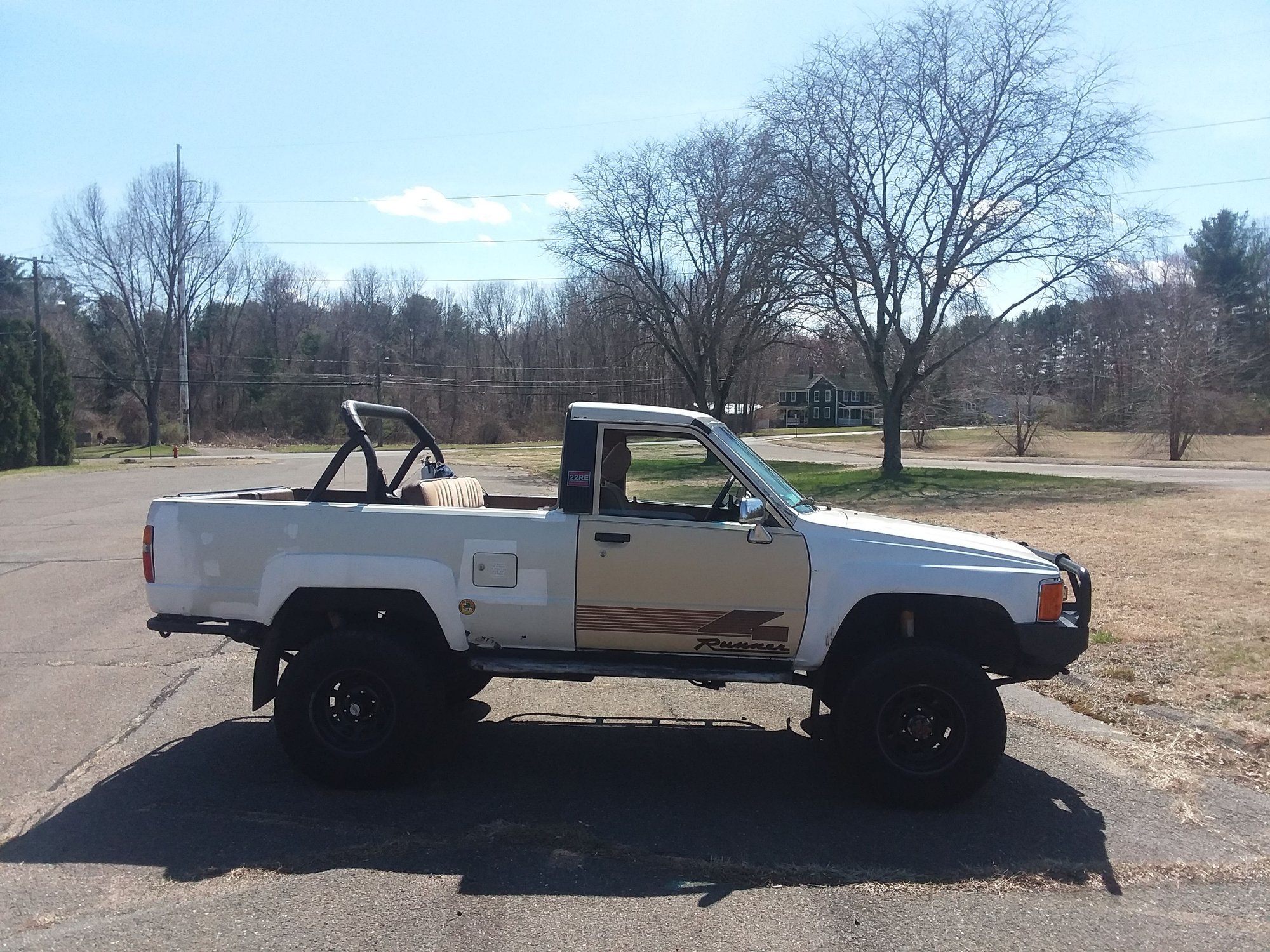

the top is off! For now anyway. I needed to set up my portable garage to do some work on it so figured I would see what it looks like without the top again.
