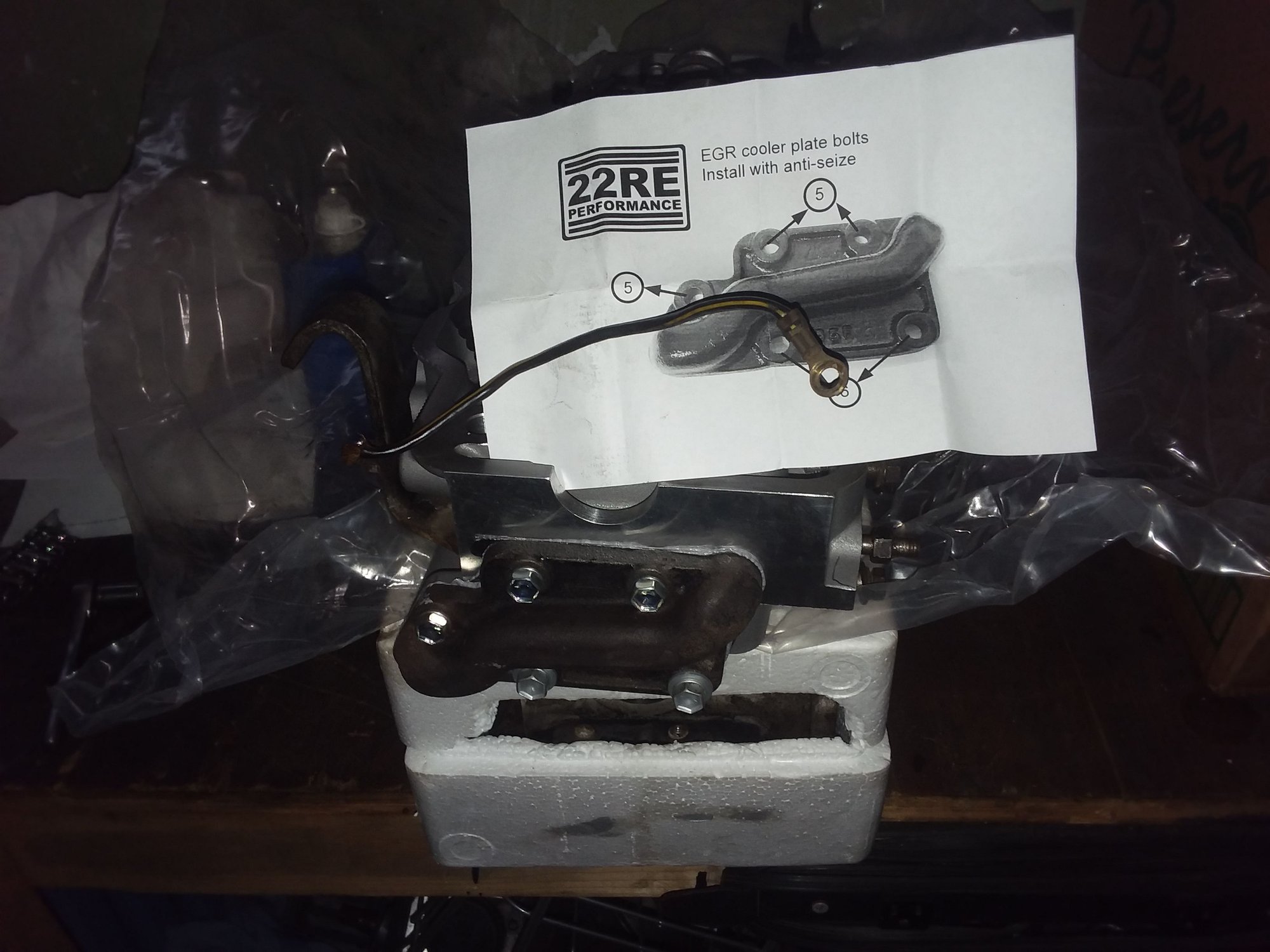

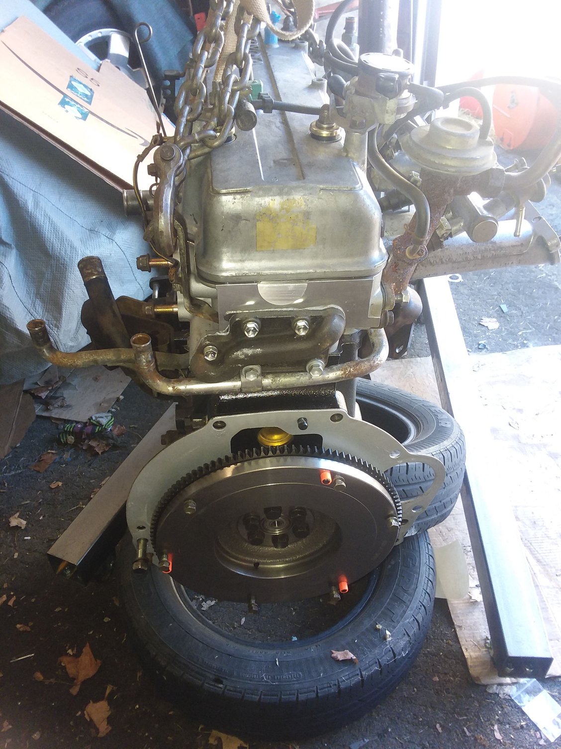

Would you happen to have pictures of the EGR Cooler (Does the 1986 have it?), and location? Reason I'm asking is I'm troubleshooting Running Hot issue here. Saw a post about EGR cooler clogging leads to hot exhaust going back into the intake.
Tnx in advance!
I think what you may be talking about is on the exhaust manifold right? Looks like 1985 didn't have that yet. All we have is the rear cross over plate.

The EGR crossover plate is the EGR cooler. Same thing.
The thing on the exhaust manifold you are talking about doesn't have to do with the EGR, rather it is the air suction / air injection system, which wasn't used on 22R-Es until 1988.

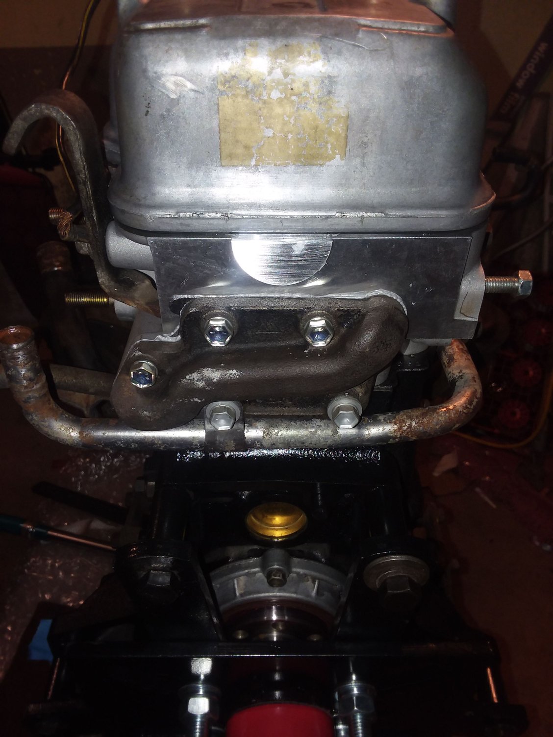

that's right I've got shots of the cooler then.
I was wrong in an earlier post that it's a part of the engine I'll never see again . If I lay under the passenger side and prop my head just right with some light , I can see it😂

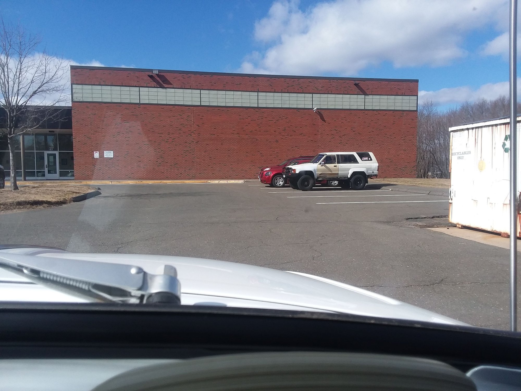

Just doing regular everyday things, parking next to planes and such.....
Toyota invasion!

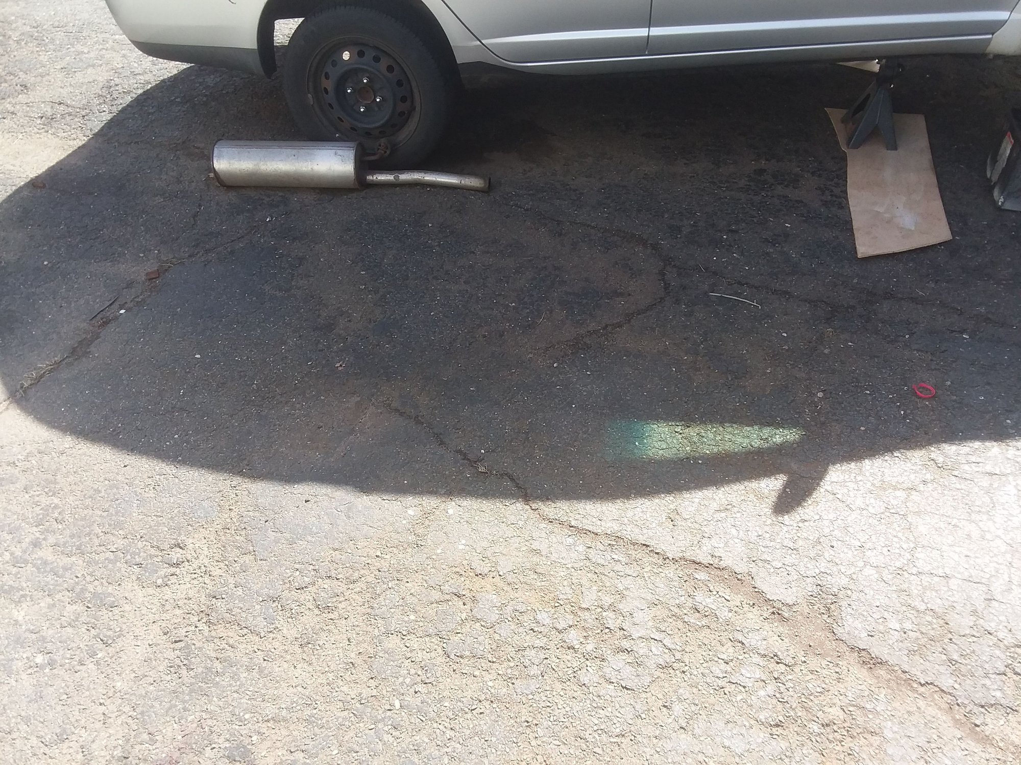

this was the place I used to work on the 4runner but some lady took it again! Just because the cars muffler is beside it's self😂
going on two weeks now.

I should of specified that's 2 weeks on the 4runner, lol. I've only gotten a few hours on the exhaust work. In between other projects and work lately.

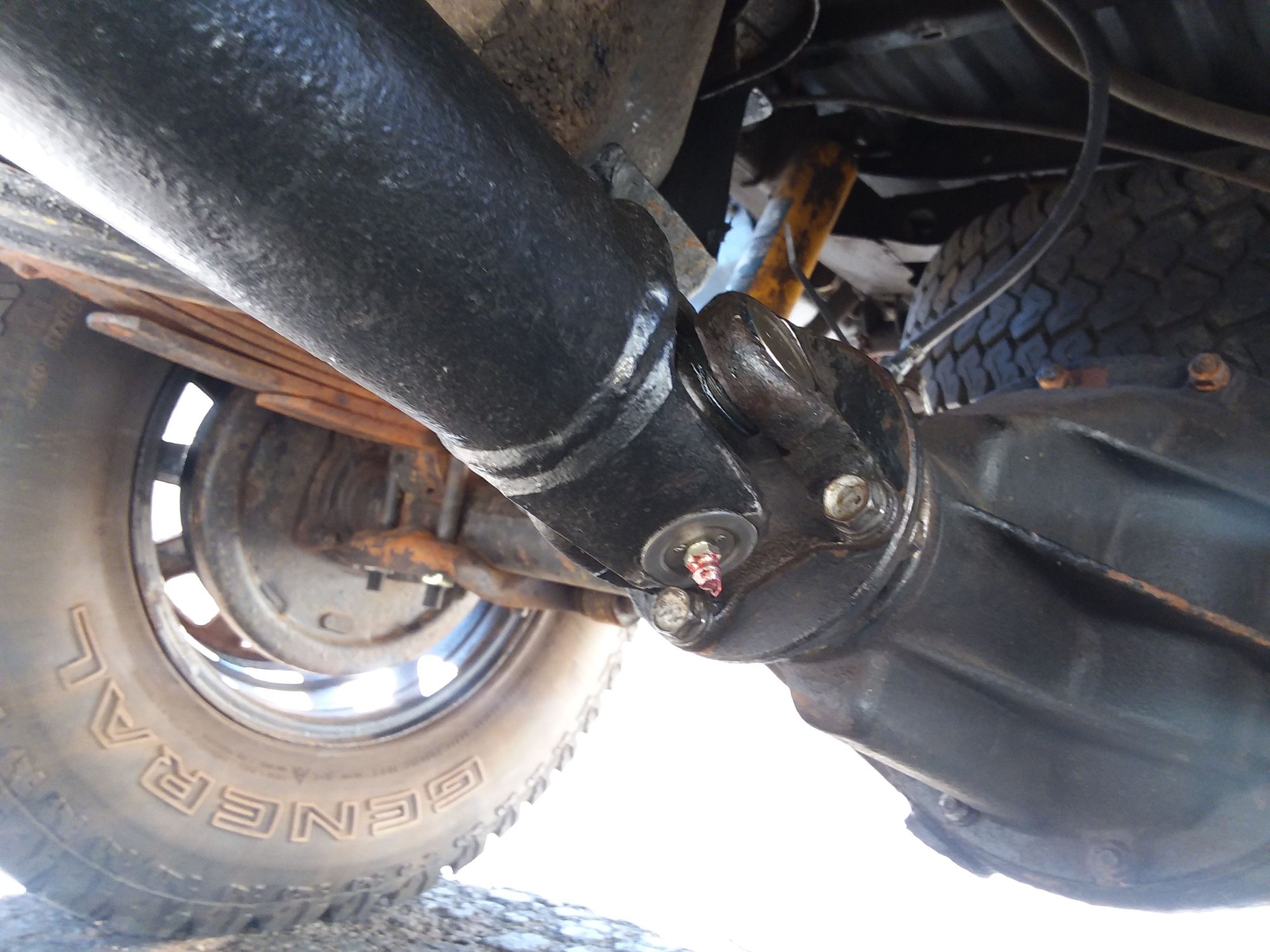

a couple more updates on Black Beard, now that the temps are in the 60s an 70s I finnely reapplied the Toyota badge to the new grill. I also got around to replacing The rear drive shaft u joints. I think the rear u joint was ether original or had been in there a real long time. The press had to really work to pop it out. Tomorrow I'm going to start working on rebuilding the power steering pump, that and the hose have been leaking.

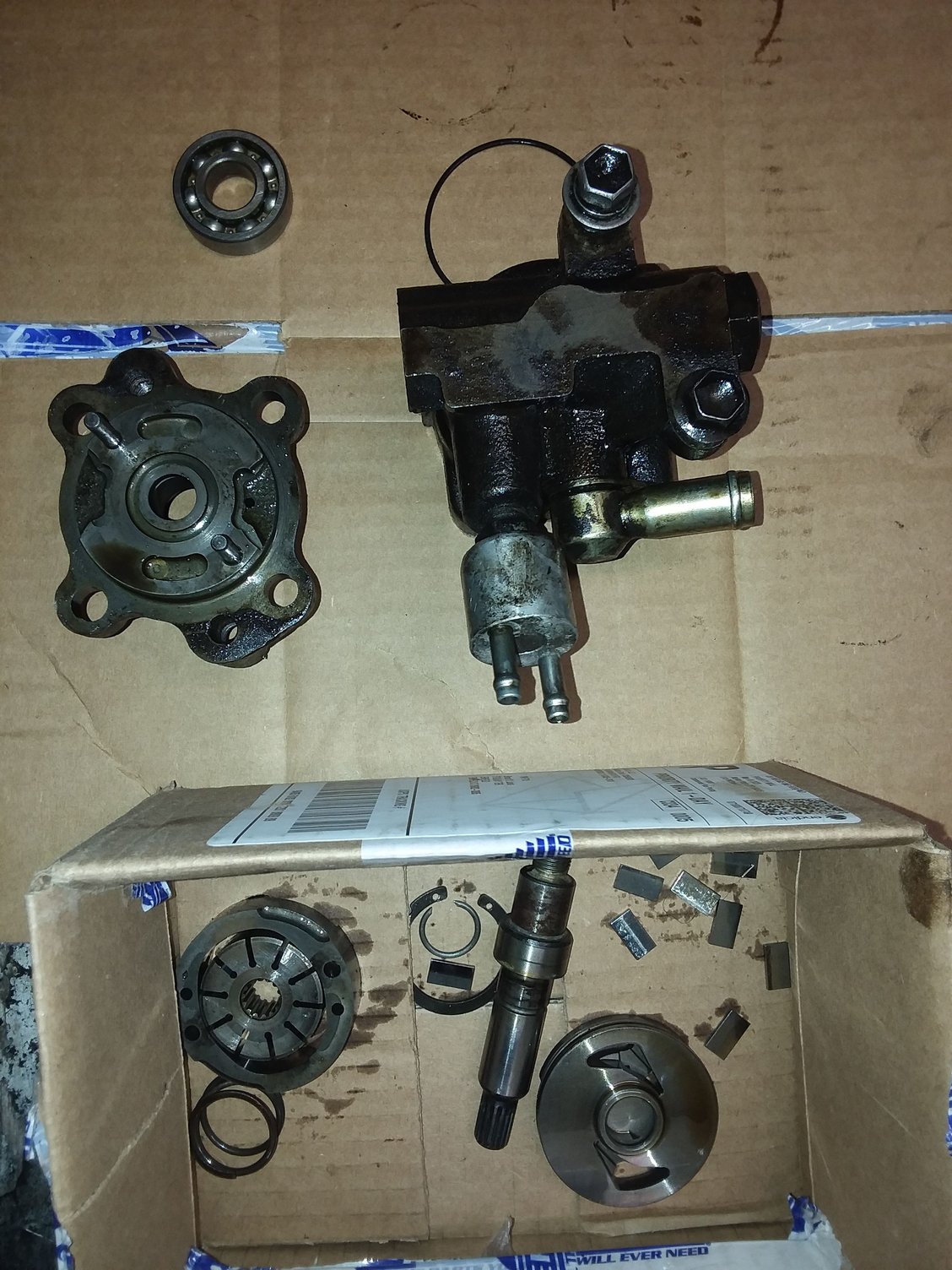

hope everyone is doing well. In hopes of keeping our minds off of all that is going on right now ( impossible) I decided today's home schooling project for my son would be rebuild the power steering pump. I also added a new bearing for it while I'm there. Now my son has rebuilt his first power steering pump, oh and me too!
Tommarow looks like a good day weather wise to reinstall the pump. I also removed the air filter box at this point to clean all the mess the leaking pump had made. I don't know how long it was in there but there was a gigantic mouse ness in there. I've got a new air filter for it now as well.
