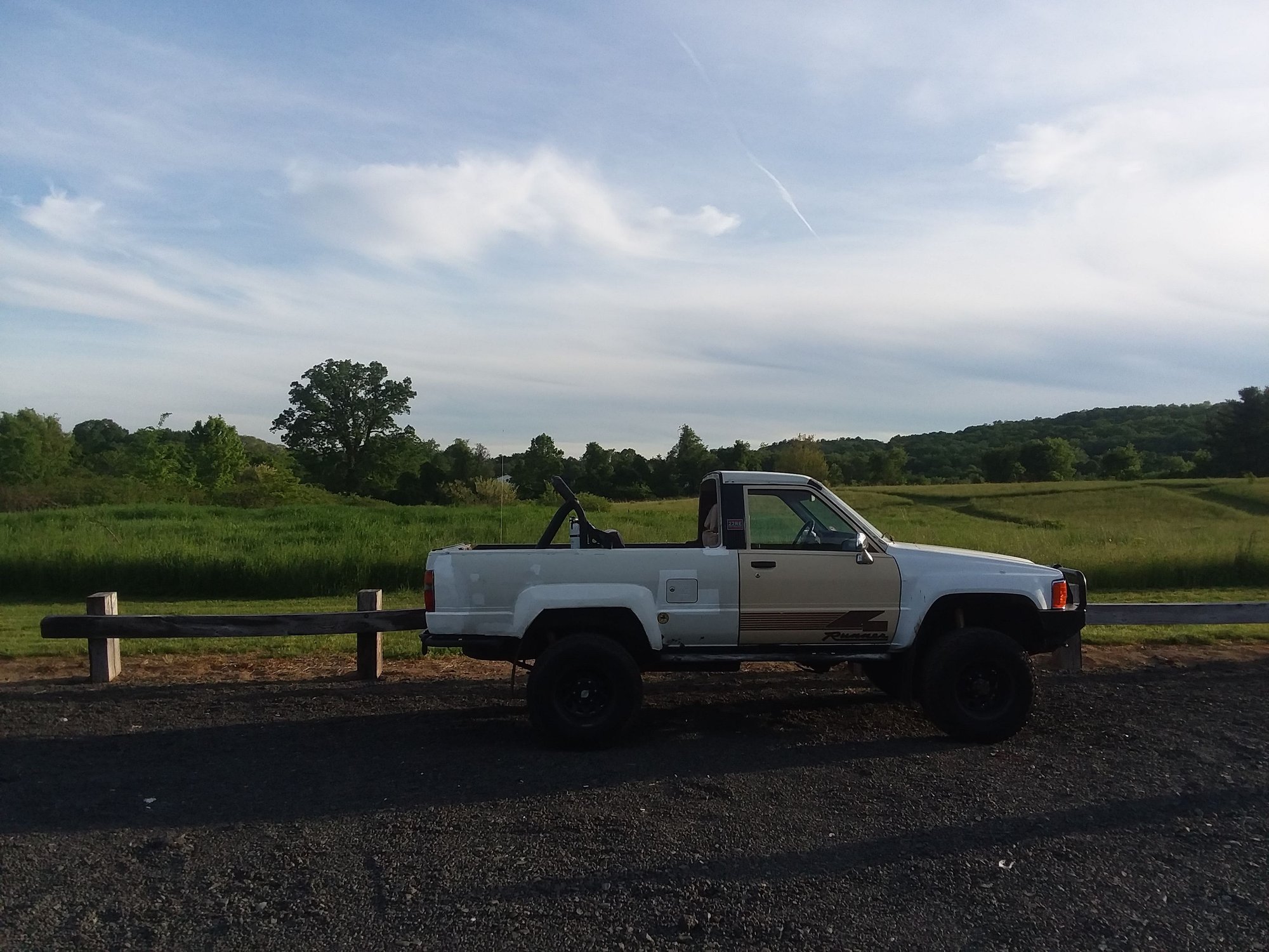

I think we found a less crowded place to hike and came at the perfect time for some interesting photos. It's East Granby Recreation area. It leads up to a nice scenic overlook (cliff) . This parking lot it the less popular spot to park. There is another place closer to Old Newgate Prison that is a real popular spot.

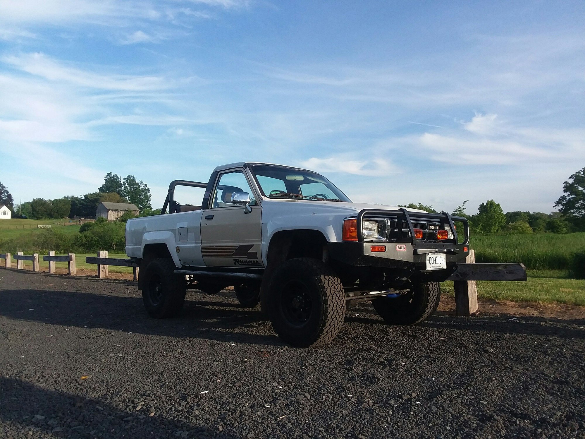

Yesterday I got a bunch of grease and dirt in my eyes fixing an exhaust leak. Seems the guy who installed the engine back in February did a bad job hooking up the manifold to the y pipe 😂 ( me) I unhooked all the hangers this time so I could bolt the y pipe on flat.
anyhow it's quieter now so went back to that same hiking spot with the cliff after a short test on the highway. This was the first time on the highway since the engine rebuild.

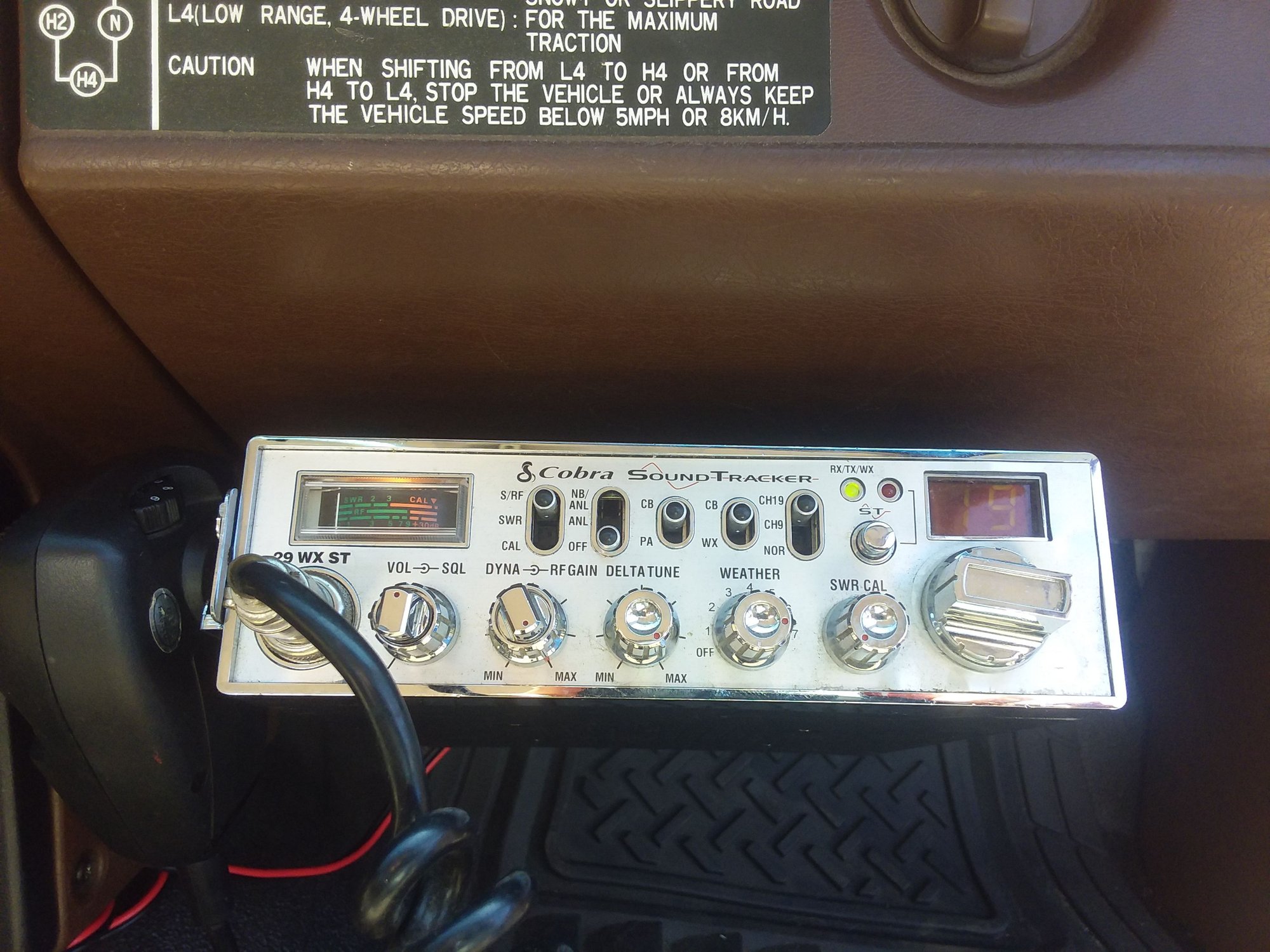

1985 is calling and we are tuning in. Today I hooked up the CB Antenna. I'm still having reservations on permanently mounting the CB yet.

meanwhile I pulled the trigger and mounted the CB. It's on with bolts and wing nuts because it won't always be left in there with the top off.

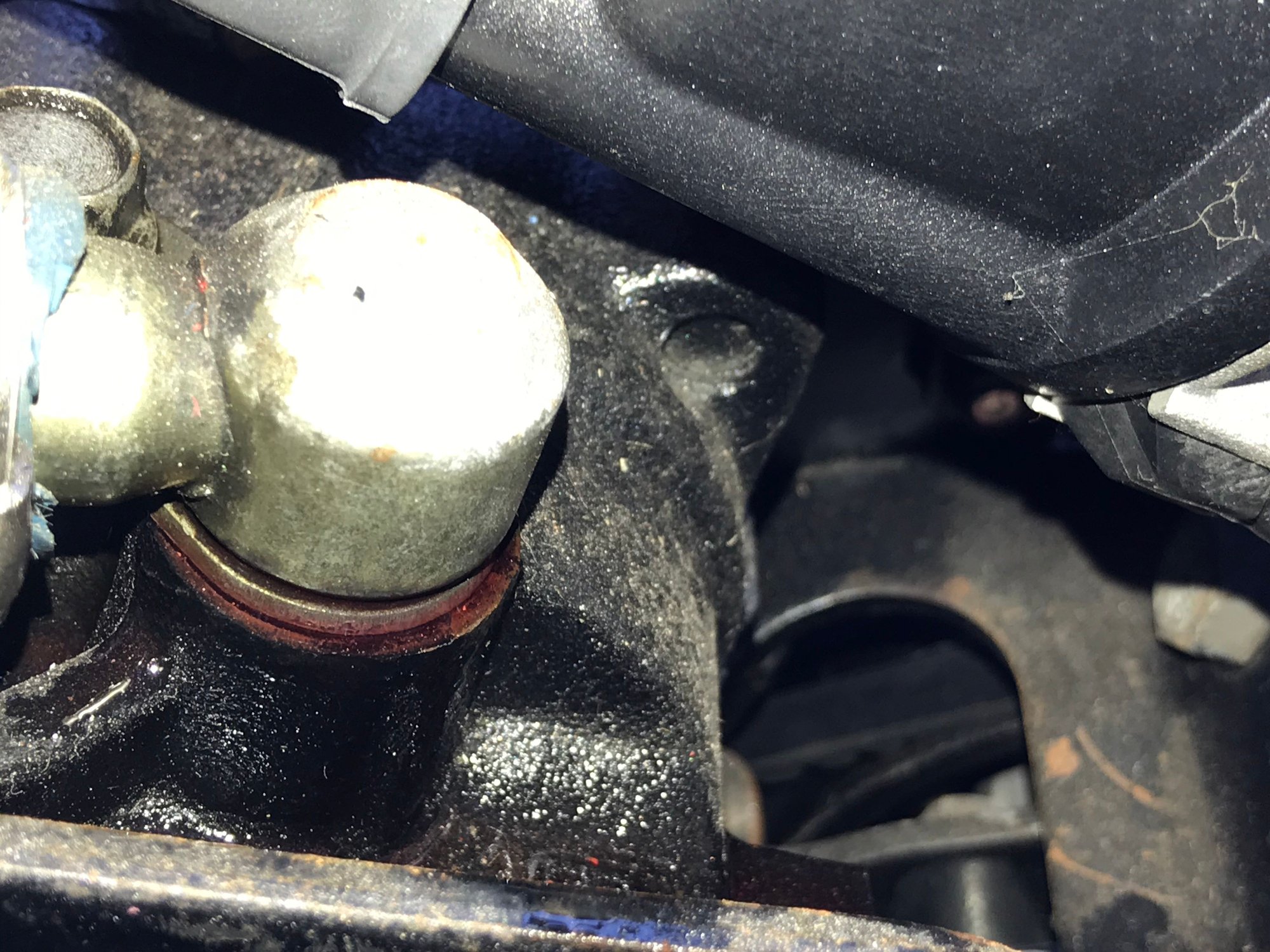

Top of Power Steering leaking
So I am having problems with my power steering leaking onto my radiator. This is the only leak I have and I am sure the hoses aren’t leaking. How can I fix this? Is it just a bad gasket? Has anyone had any experience with this? I haven’t taken this apart yet and it doesn’t look like it tightens like a bolt.
His is the top of my power steering pulley. Why is it leaking? Is it just a bad gasket?

You posted in the wrong place but I would start off with the correct hose to the pump. That blue one looks too short, the original has a bend in it. I think for the engine movement. It's also said (22RE Performance) that any other hose will constantly leak. There is an o ring in that part of the pump. You have to unbolt the part the hose is clamped on.
Hope this helps.
