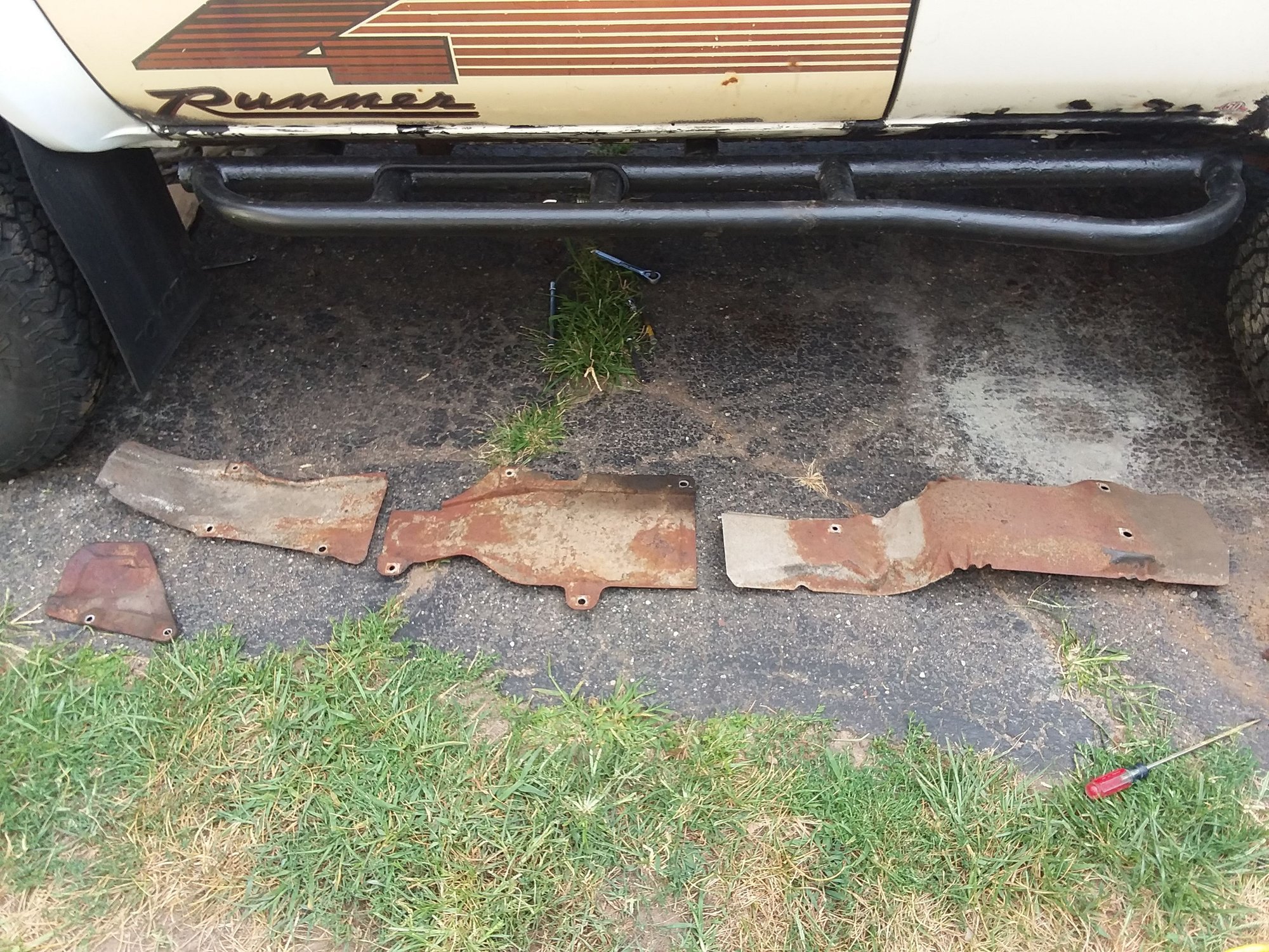

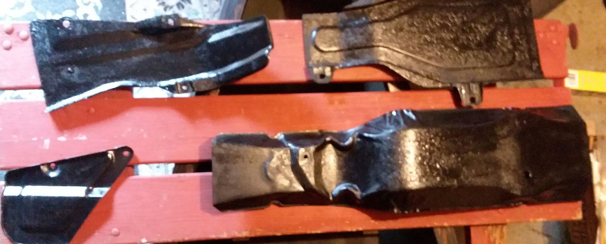

Then just after we got home I started to clean and paint the heat shields. Painted with som Eastwood Rust Encapsulator. No problems with any of the mounting bolts thanks to the coating of fluid film. Some of the bolts still have the zink coating on them.

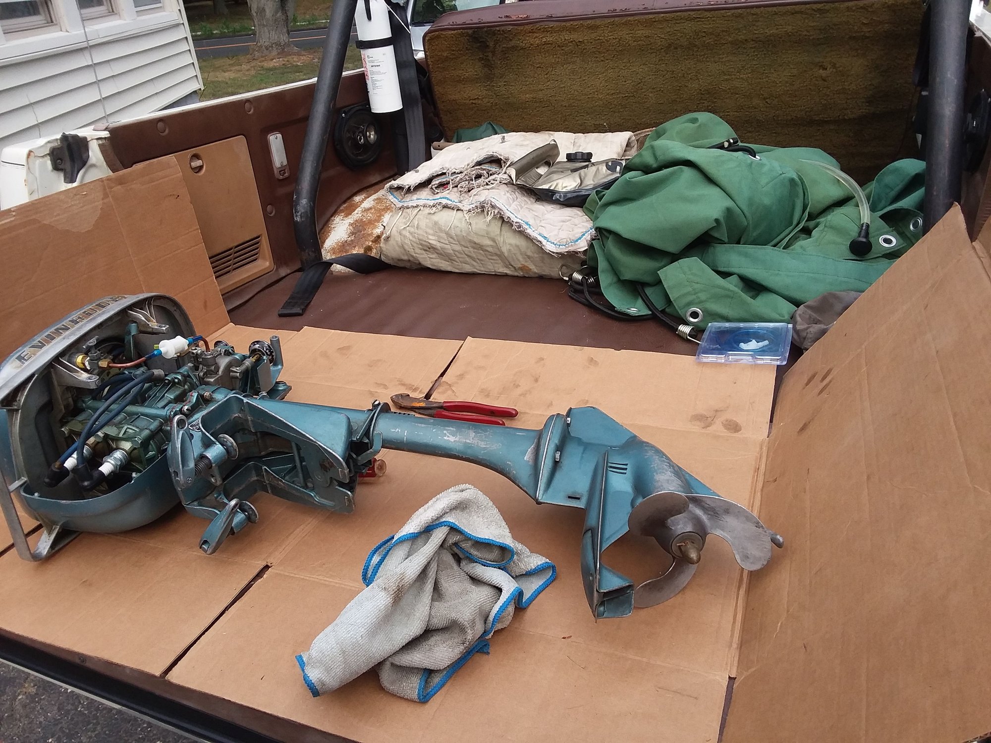

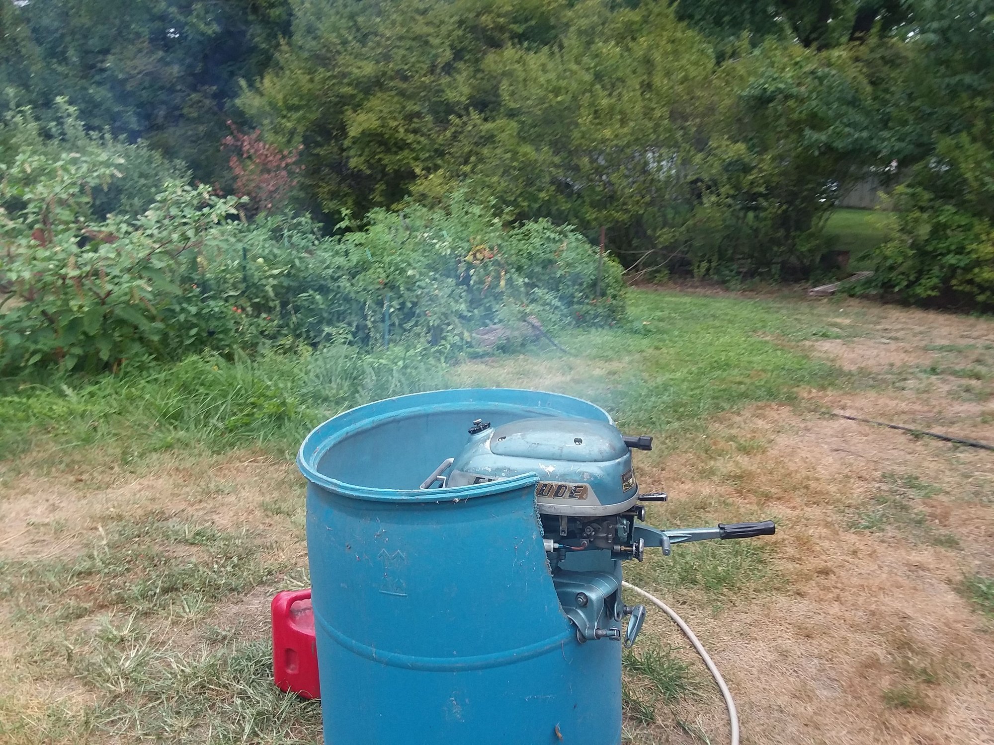

Not only is it a good picnic table tailgate but it turned out to be a good work bench too after being a parts getting vehicle for other projects.
And it lives after a carb rebuild.

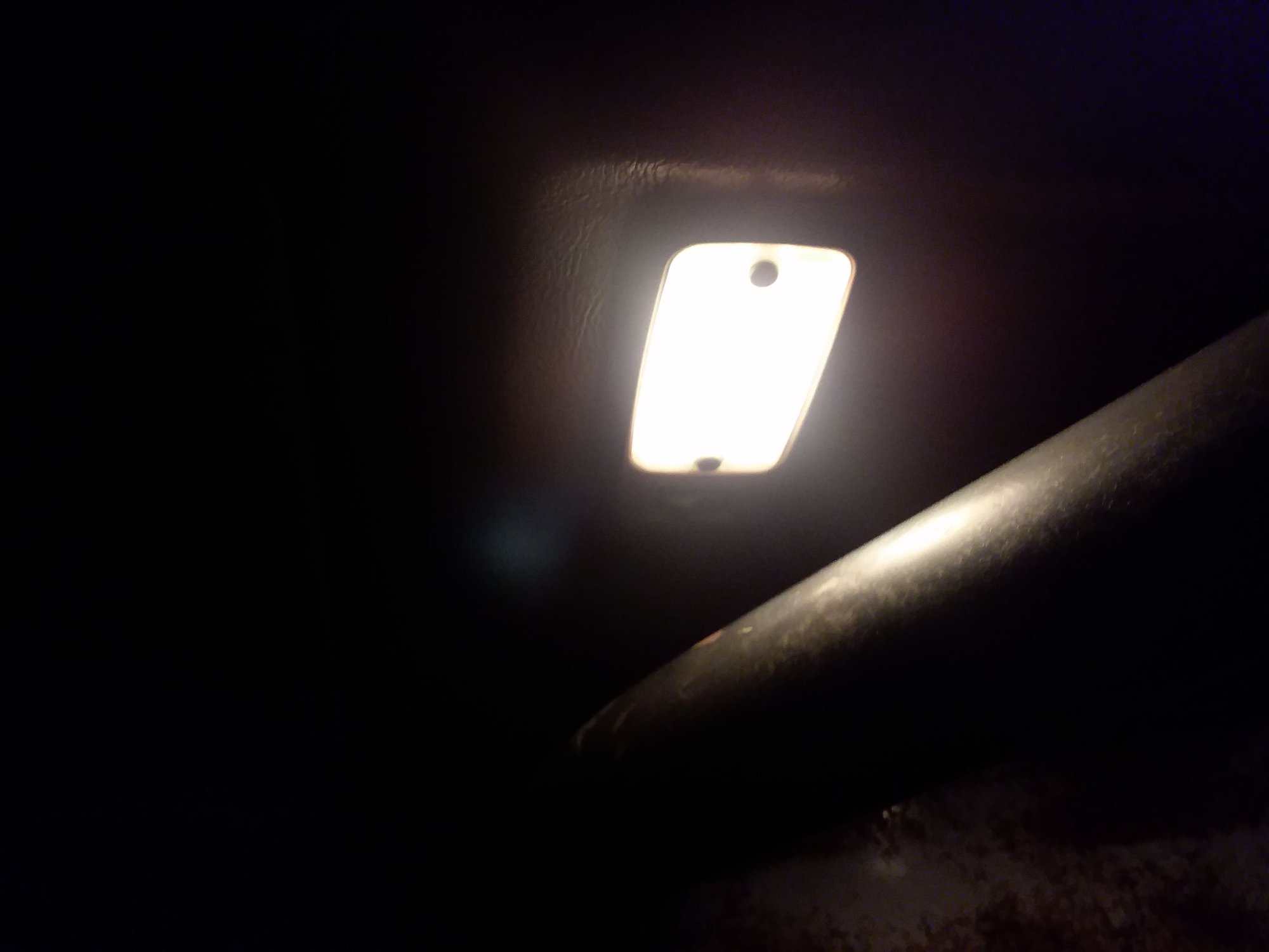

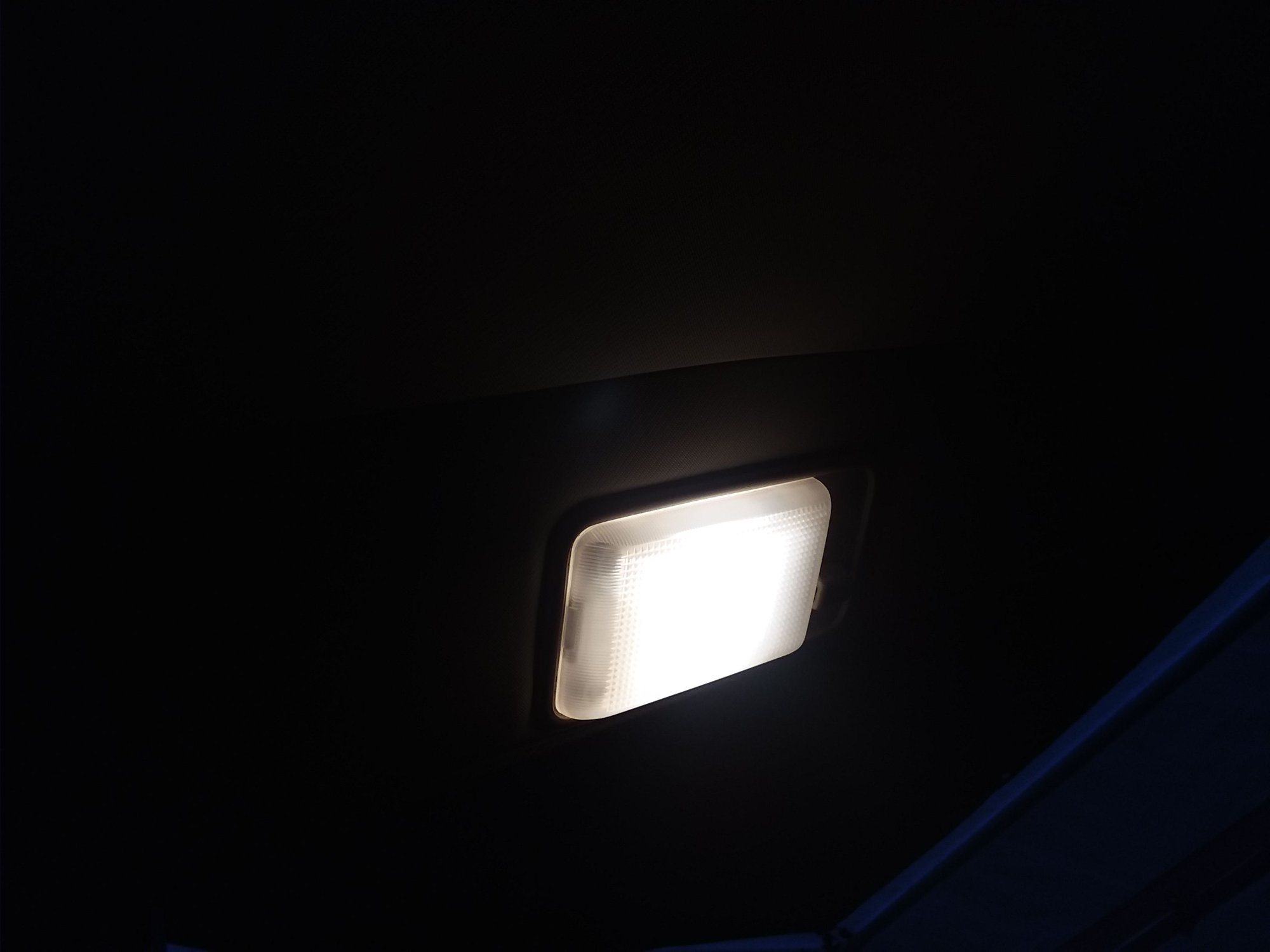

peaking of parts I got a new dome light cover since the old one disintegrated and got the rear cargo light working for the first time since owning the 4runner. It just needed a bulb.

Originally Posted by Damion812
Heat shields you say? Where do these go? I think mine are all long gone
Cool trips!
Cool trips!
I know right what are these things? 😂 always the first thing to go on a vehicle. I found that out on the FJ but my wife's WrECHO they came off at the same time even though it's 8 years older. Must be my driving. The heat shield on the cat for the FJ affected the clutch plate or slave cylinder. After a long drive and let it sit for a few hours it made the clutch grabby and difficult to get in gear. Once I put it back on I never had the issue again.
come on it gets hot in Connecticut, I have to fix these things. Lol. With the amount of driving you have been doing you probably drove away from them, ha ha. I just started to go through your thread and haven't been able to go through all of it yet but wow! Epic road tripping! I have got to do that one day but need to prepare for something like that. I did something similar in my 66 VW beetle a few years back and all didn't go as planned but the car got us back home. Ahhh memories.......

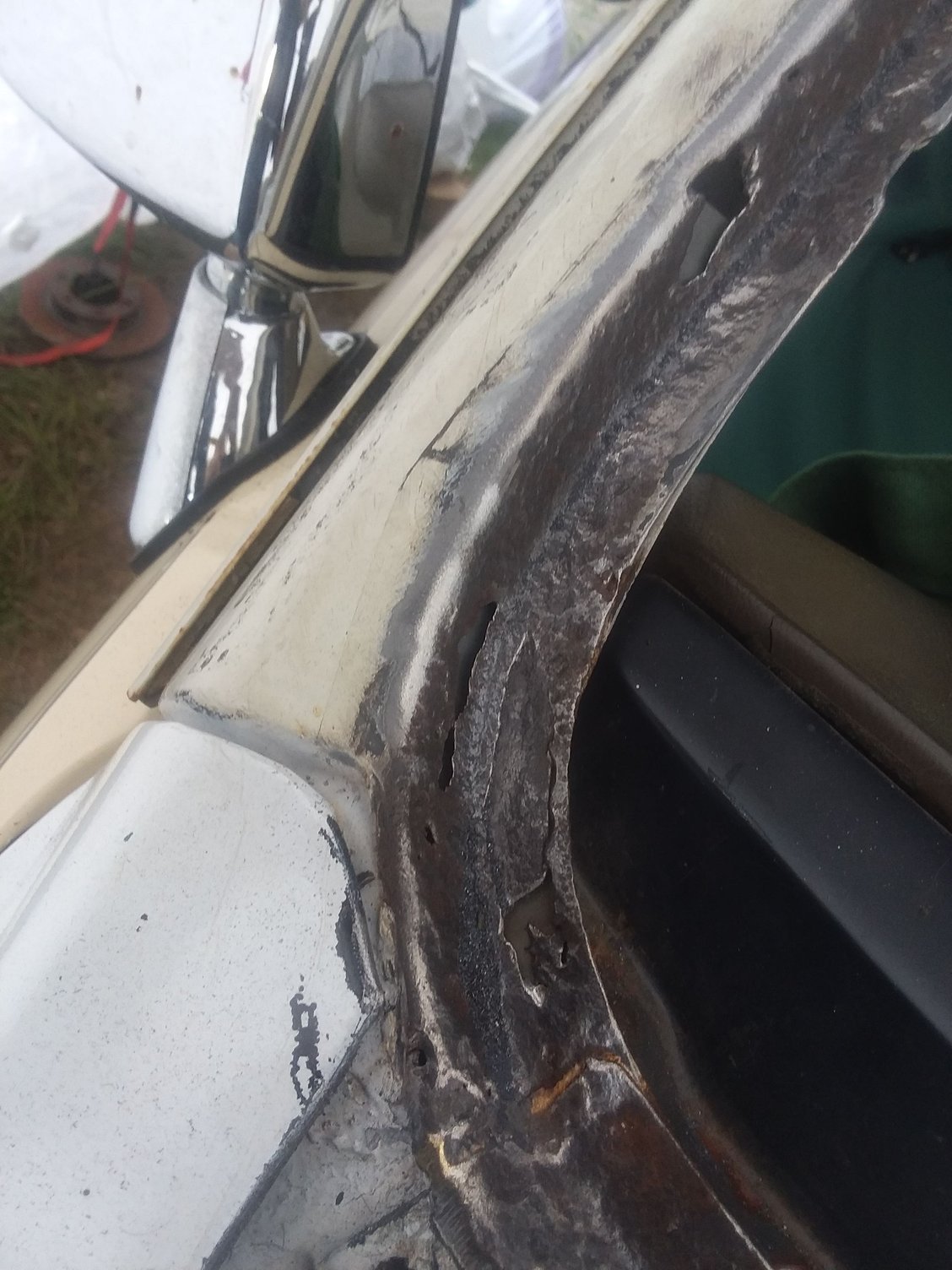

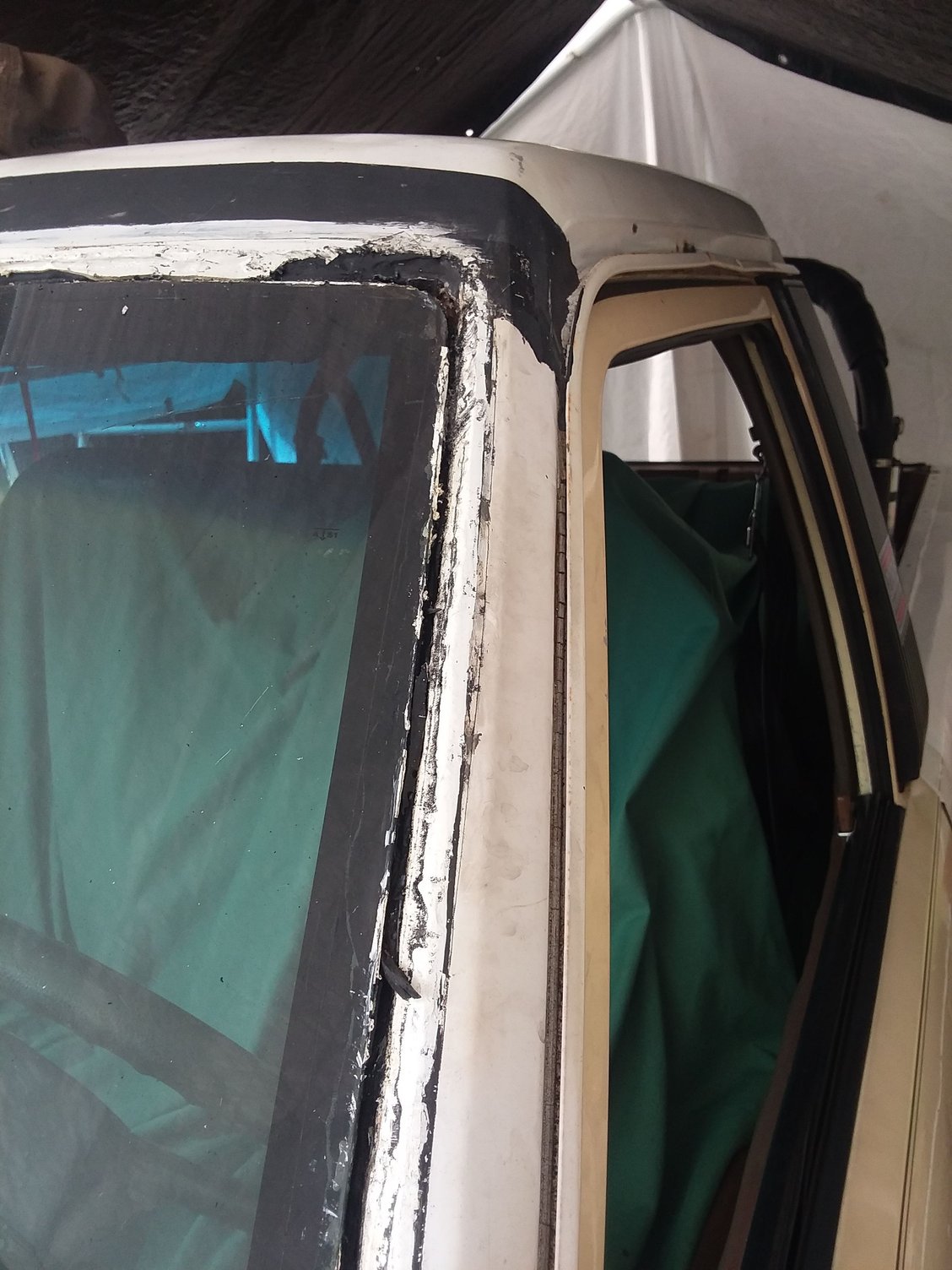

I'm hoping in the next couple of weeks to get into repairing the rusted windshield frame, finally. So with that in mind and today's weather being so nice we went on one last adventure before the 4runner is out of commission for a while.

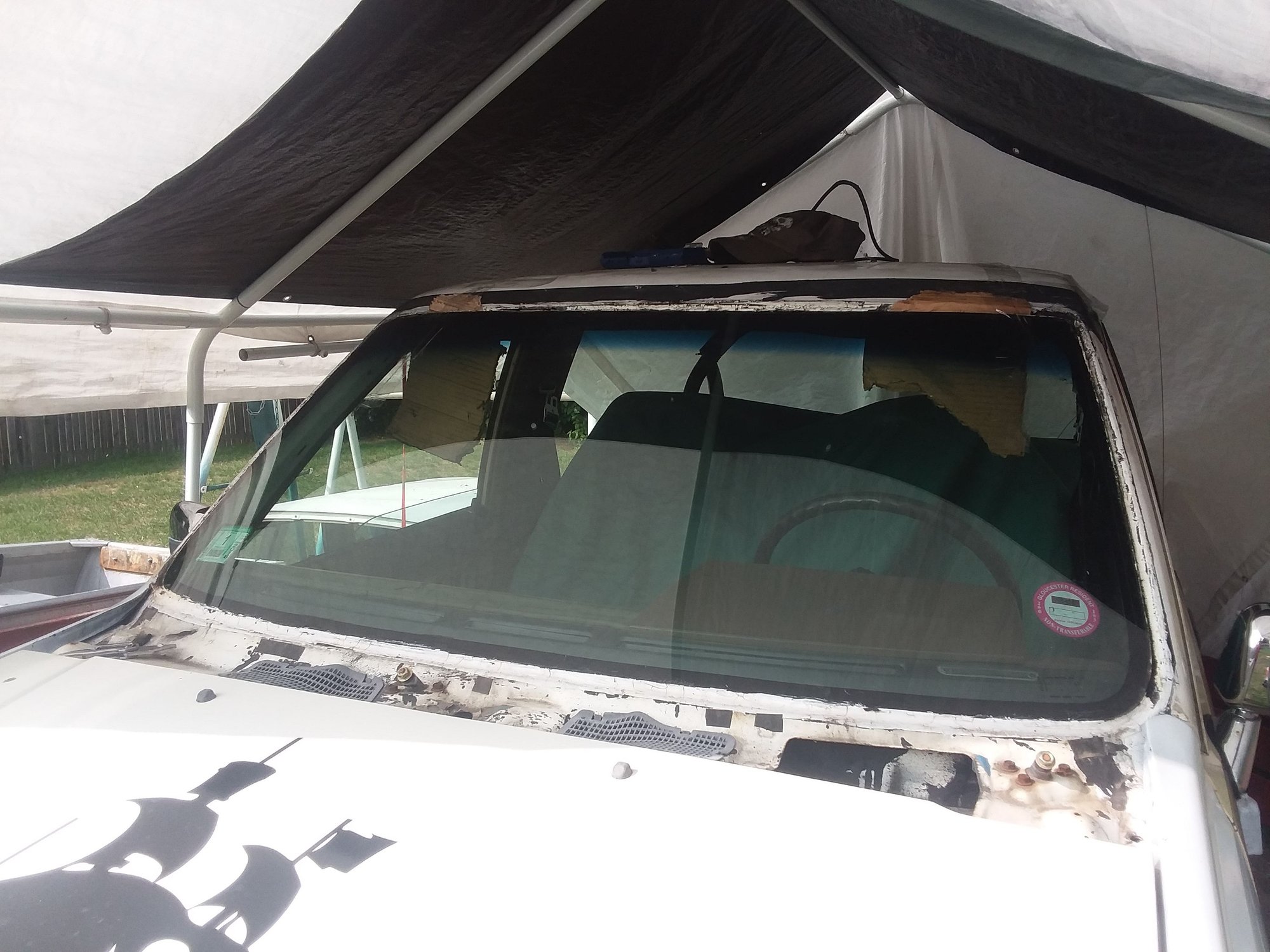

yeah I do plan on replacing the windshield due to the crack in the top of the driver side from welding over a year ago and the heat got to be too much. I did want to get this windshield out in one piece to use as a guide to help in rebuiling the frame. I have a rubber seal for installation to illuminate the trim. We really didn't have the trim anyhow. Also whoever installed that windshield did a horrible job . Gobbs of adhesive that were not even holding the entire windshield in. Plus it was glued in crooked as well.

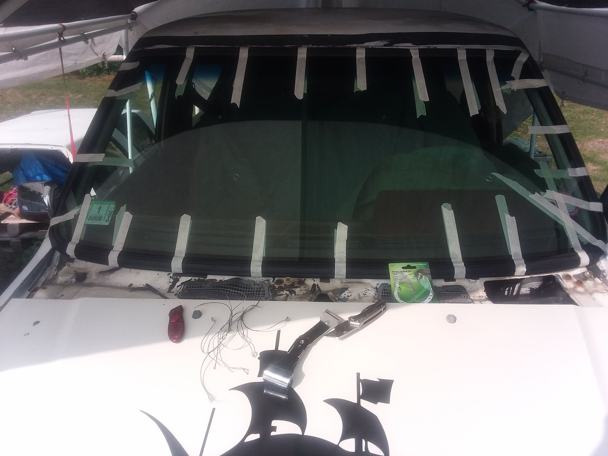

Windshild cleaned up and new gasket in place, I could just pull the windshield in if I wasn't planning on fixing all the rust. Notice at the bottom of the windshield , a few tools for getting the glass out. I broke a bunch of the cables to cut the adhesive. The
cable gets so hot that it starts to smoke.

Two of the corners are starting to look like corners again ( drivers side upper and lower) . I didn't take a before of the corners but they all look like the rotted one above. Anyway more sanding, grinding, welding, sanding and my special filler and some paint......
forward progress.
