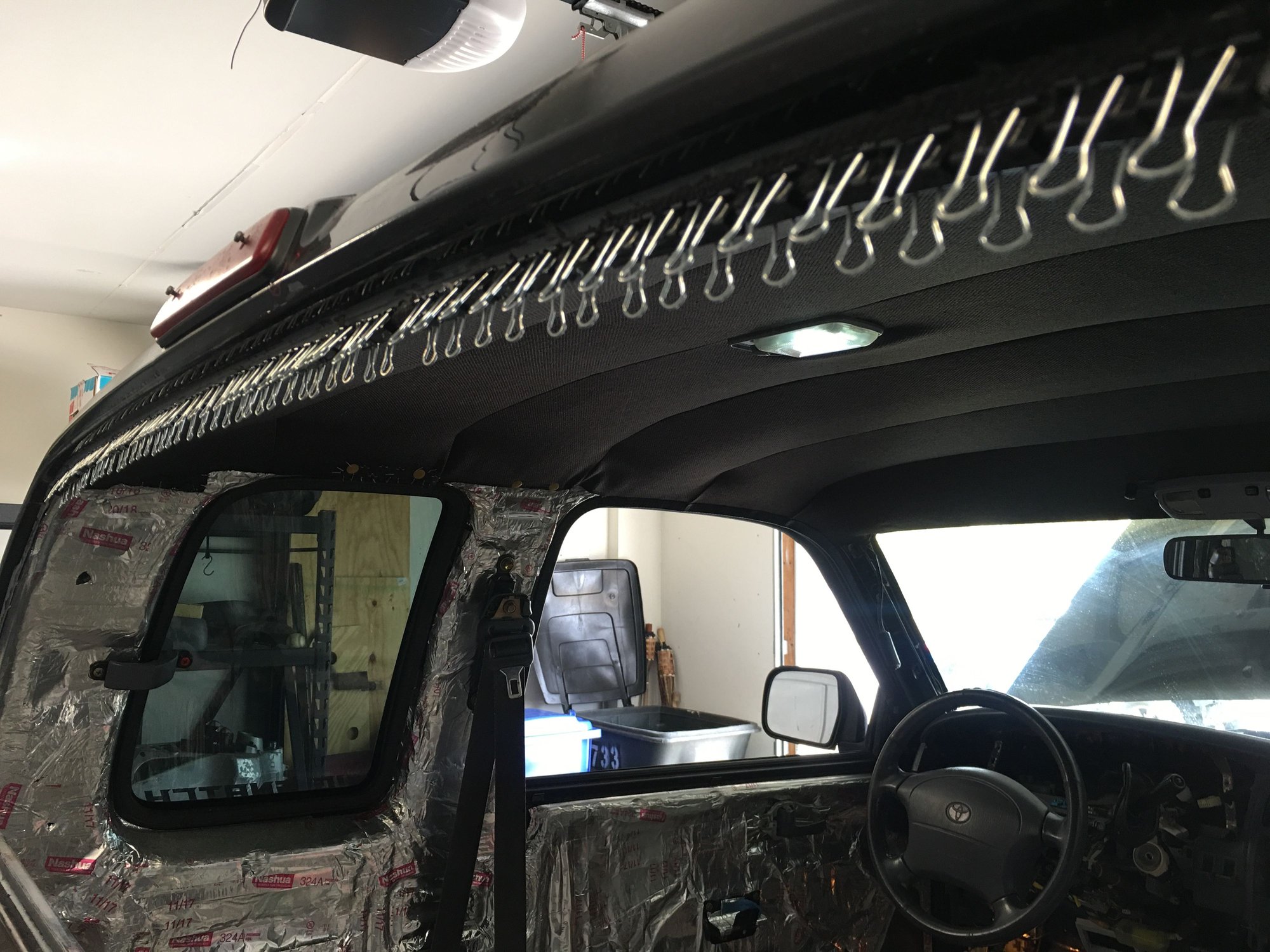

I need more binder clips though.
The edges in the door seals have to be glued tight and every inch counts with the adhesive.

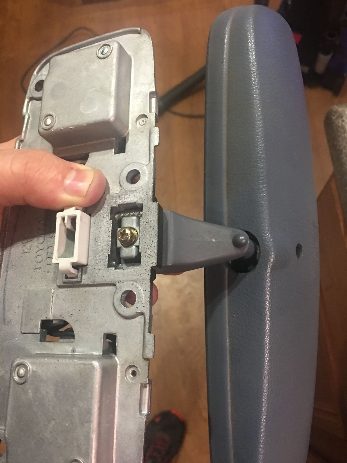

Does your rear view mirror shake and rattle?
I discovered when putting it back in that the mirror mount had play in it.
I devised a plan.
Cut some cardboard pieces (old loctite package) the same size of the metal tension cylinders.
Wrapped it around them.
Put all that inside a piece of heat shrink.
Heated it up to compact it.
Put it all back together.
SNUG!

Headliner progress
The adhesive I’m using on the edges is amazing stuff, but it has a 2 WEEK cure time. (yeah really)..
So it’s basically 2 weeks per segment.
Anyway, it’s starting to look like a truck again.
