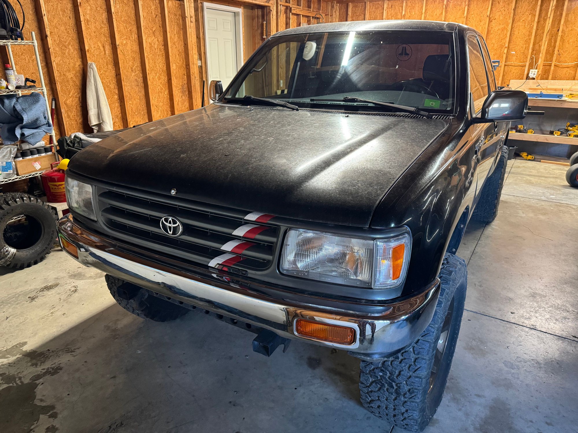

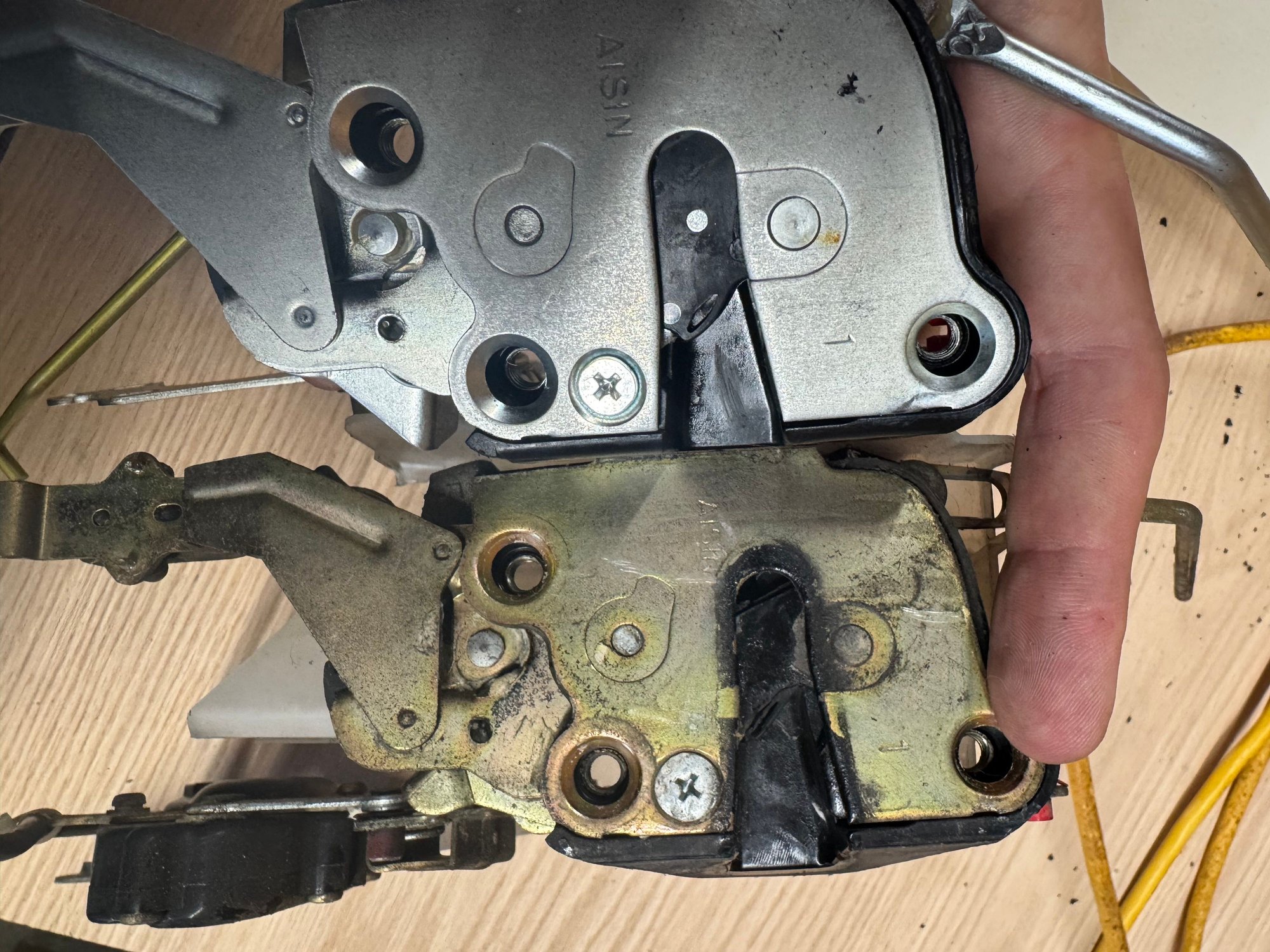

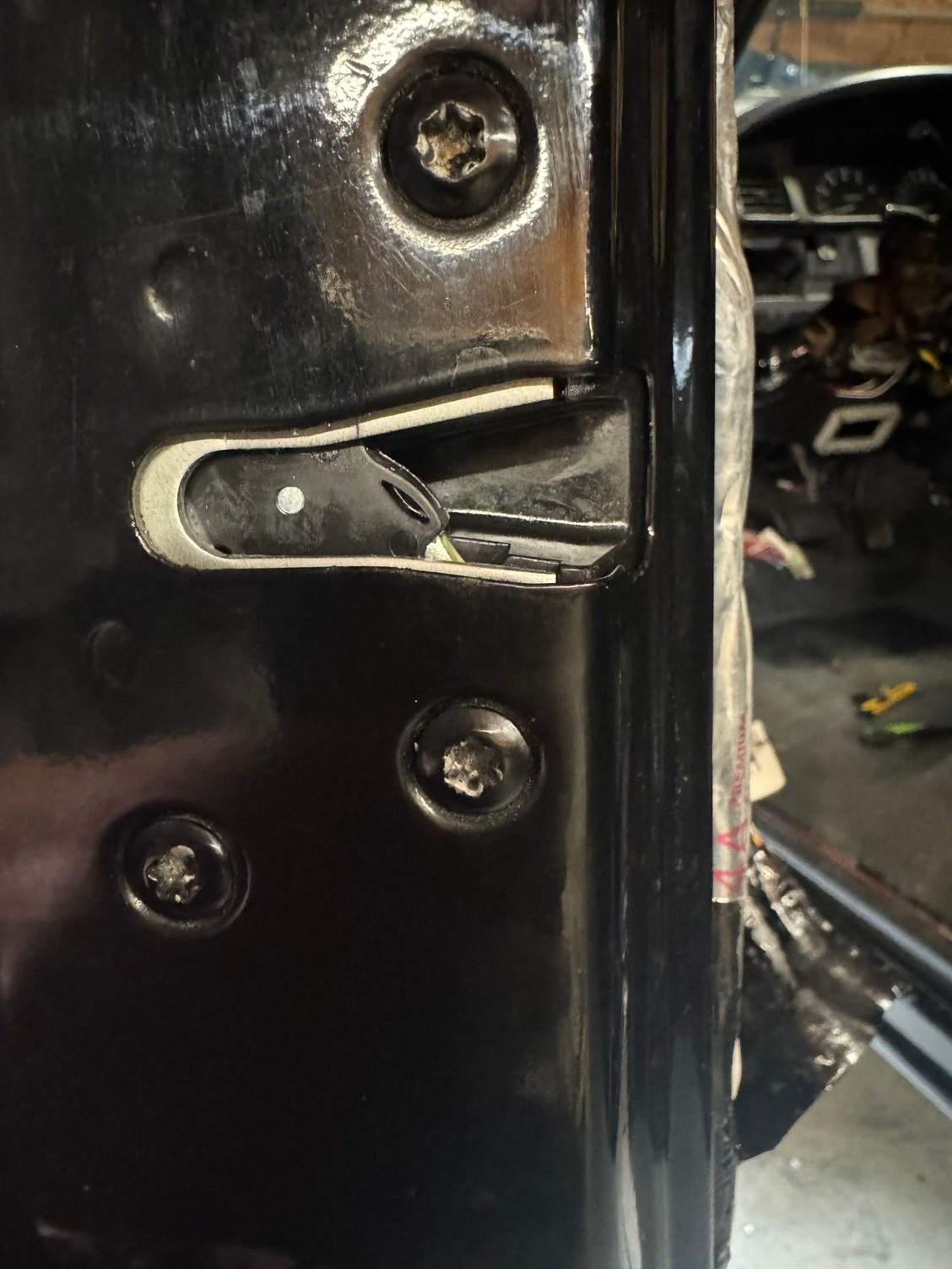

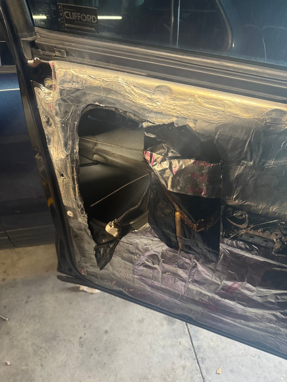

Just purchased the truck in this thread, will keep the rebuild progress rolling. When I purchased the truck it had been wired for a sound system but the amp and several speakers were missing. It came with parts for a front end rebuild and some other stuff. One issue was that the doors wouldn’t close all the way due to the latches being completely worn out. Put new latches in on both sides but had to cut up the sealed door to get that done, will be resealing before the doors panels go back on.

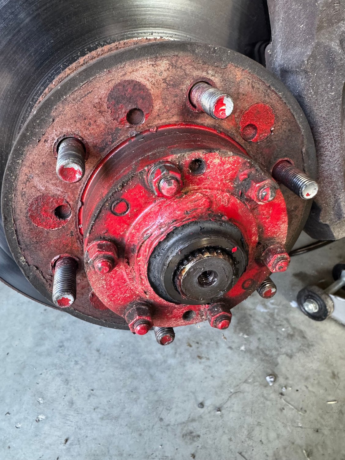

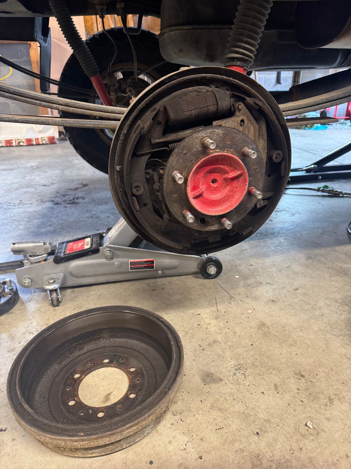

New wheel bearings, brakes, rotors
Needed these, all the parts came with the truck so the work just cost me time and elbow grease.

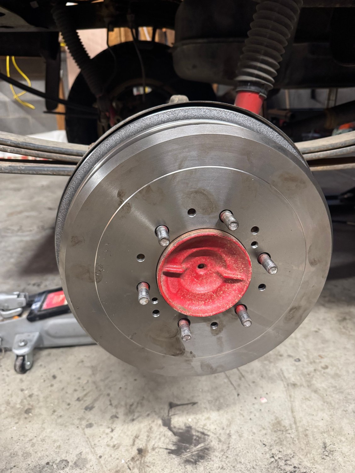

More brake work
Drums, shoes/springs, fluid flushed. Also went back and got new front calipers. All that should fix the spongy pedal.

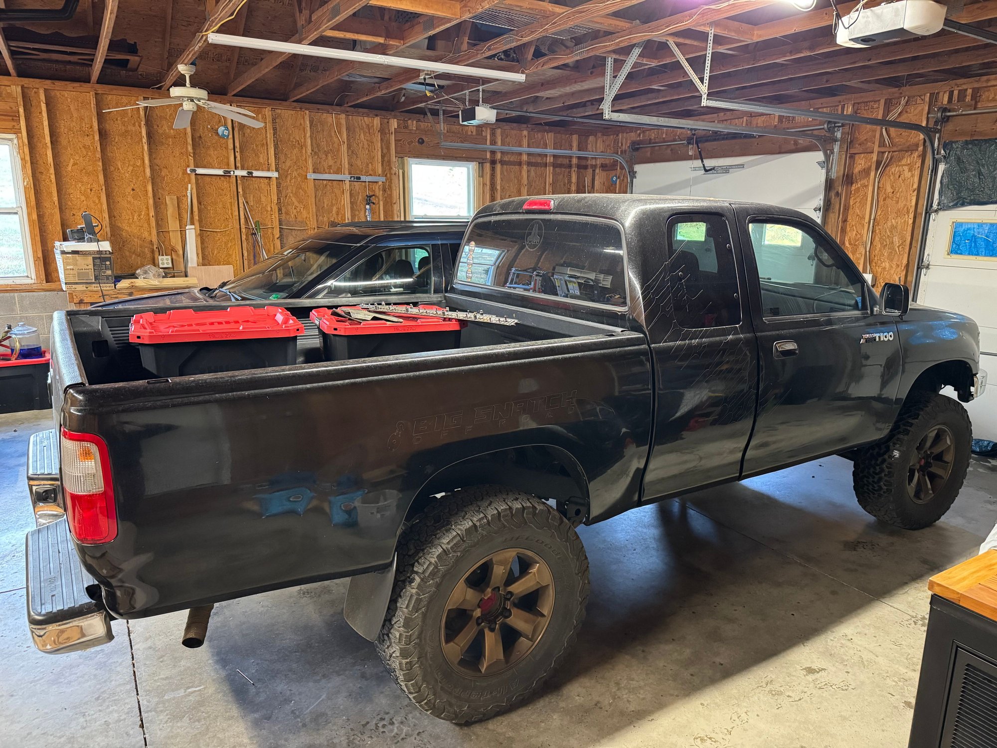

guessing the custom made trailer wasn't part of the deal?
It was offered but I didn’t pay up for it.

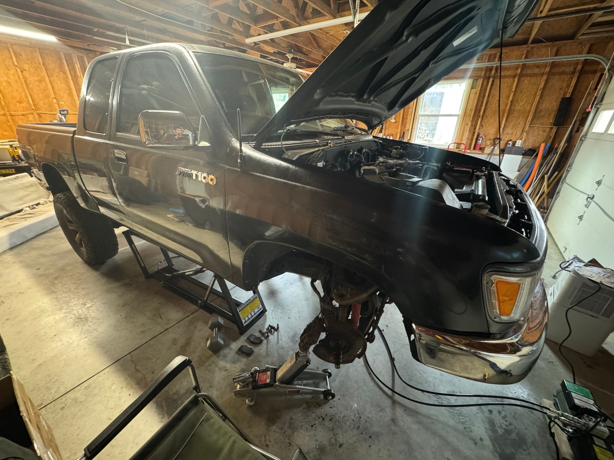

More mechanical stuff
Upper and lower ball joints done. Next is brake master cylinder (hopefully won’t have to do a full bleed again), engine oil, transfer case oil, and front/rear differential oil. Coolant was done by previous owner when they replaced the radiator just before the sale.

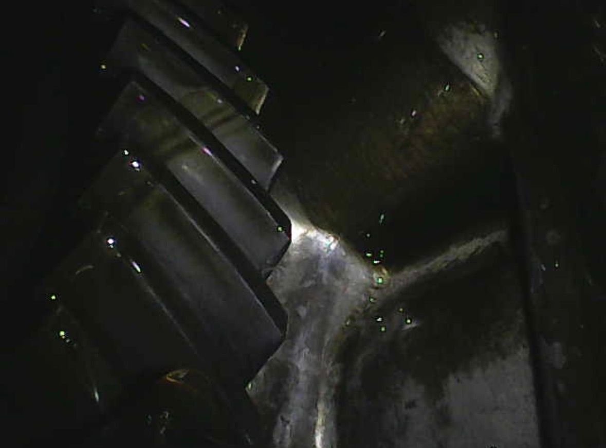

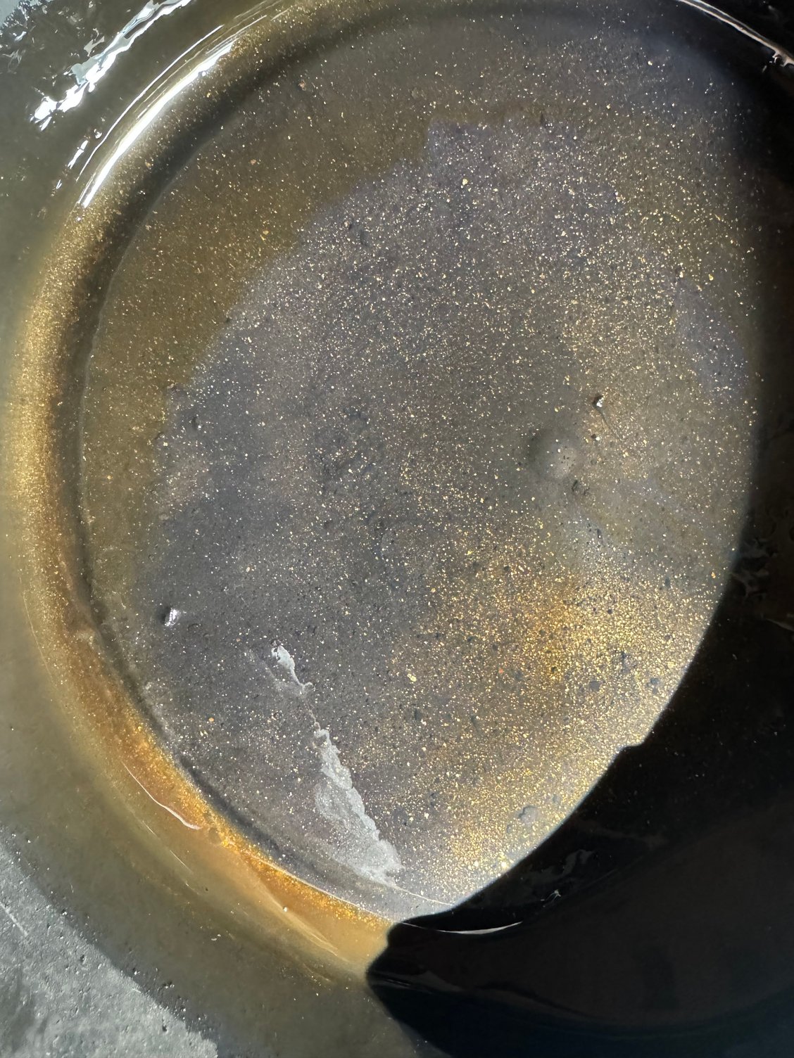

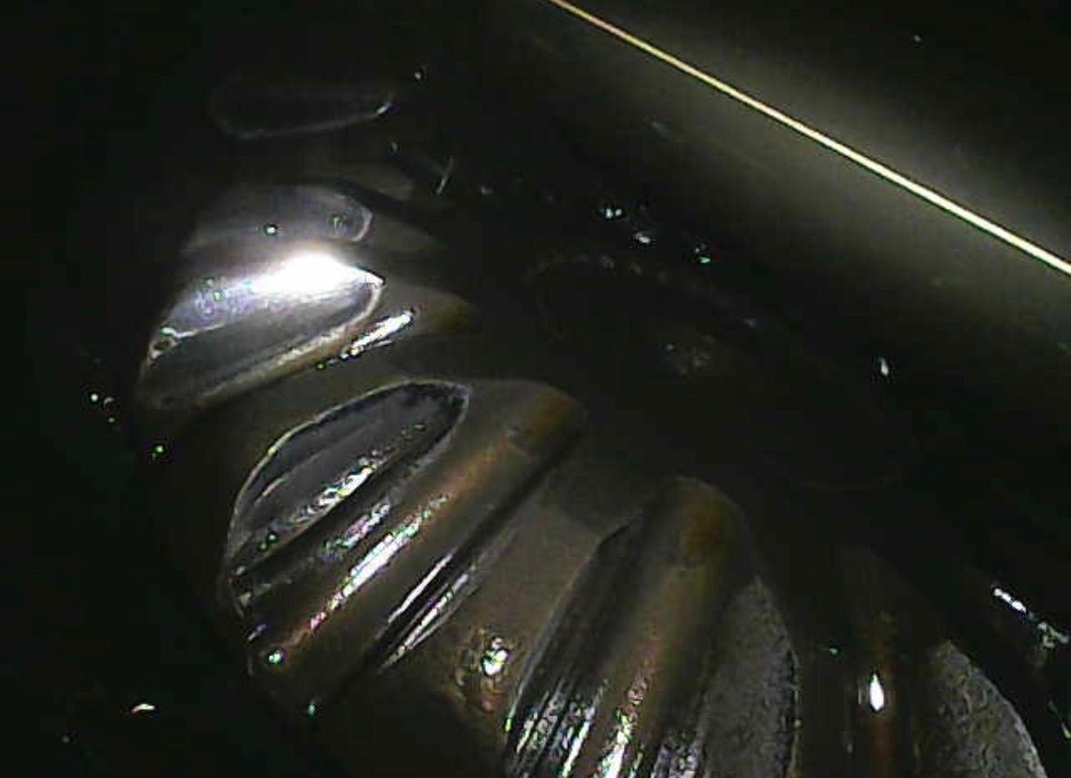

The old differential oil was a little too sparkely for my liking, see image of the pan. Endoscope images aren’t of good enough quality to really see anything, was just curious to peek inside.
