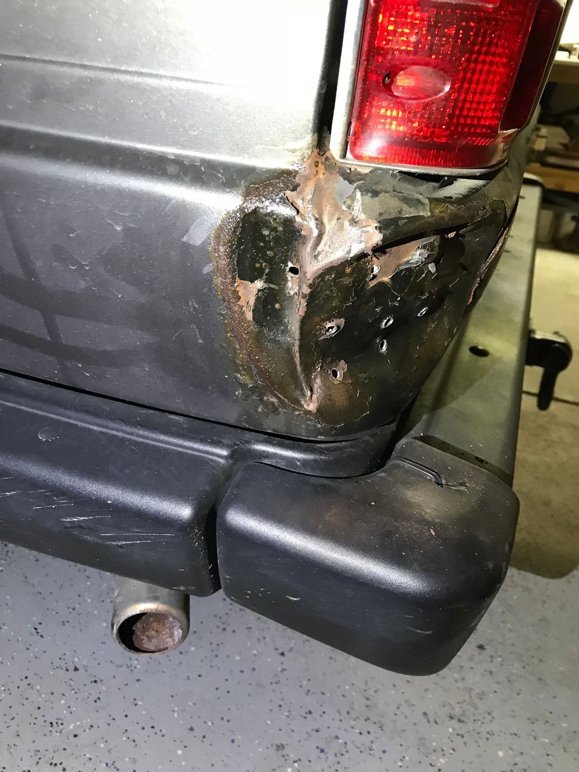

Working on getting the body ready for paint. One major dent is holding me up. I’m attempting to do as cheap as possible to avoid cutting and welding in.
Before
Before
After some work
Old Jun 16, 2018 | 06:32 AM
hellgrunt5643's Avatar
Joined: Apr 2018
Posts: 30
From: South Carolina
That is using a slide hammer and c clamp to try and get it out enough so I could bondo. That seems to be as far as I can get. Any suggestions??

Nice looking runner. To pull the dent out I would remove the tail light and use a pry bar to help push the dent out. The curved part of a pry bar might get in behind it to help get it started to move in the right direction so that you can work it some more with the tools you have and then start with body filler. I will move yo to the correct section.

Thanks for the advise fellas. I will probably end up cutting and welding if the above doesn’t work. Also thanks for moving me to the correct thread.
