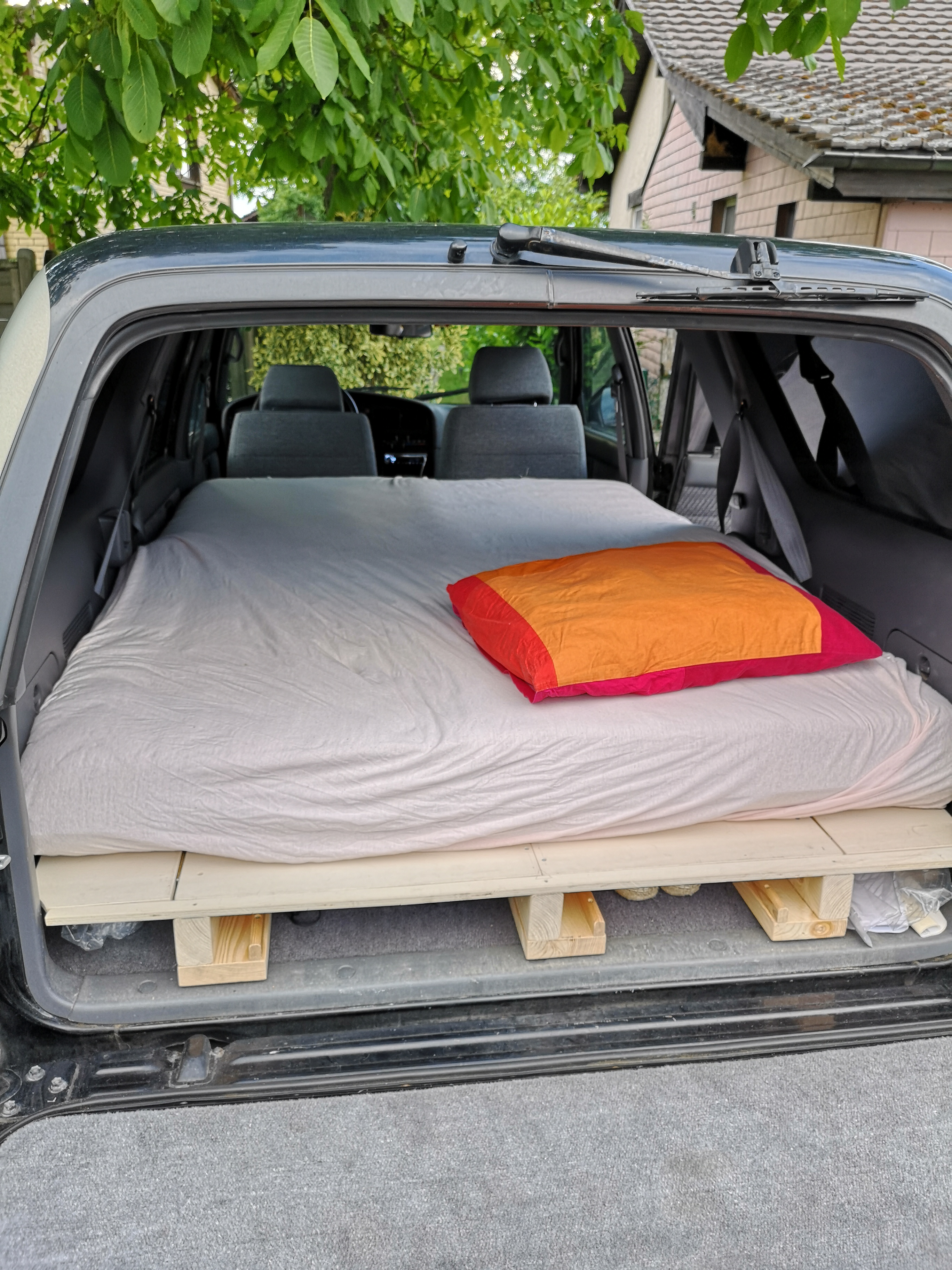

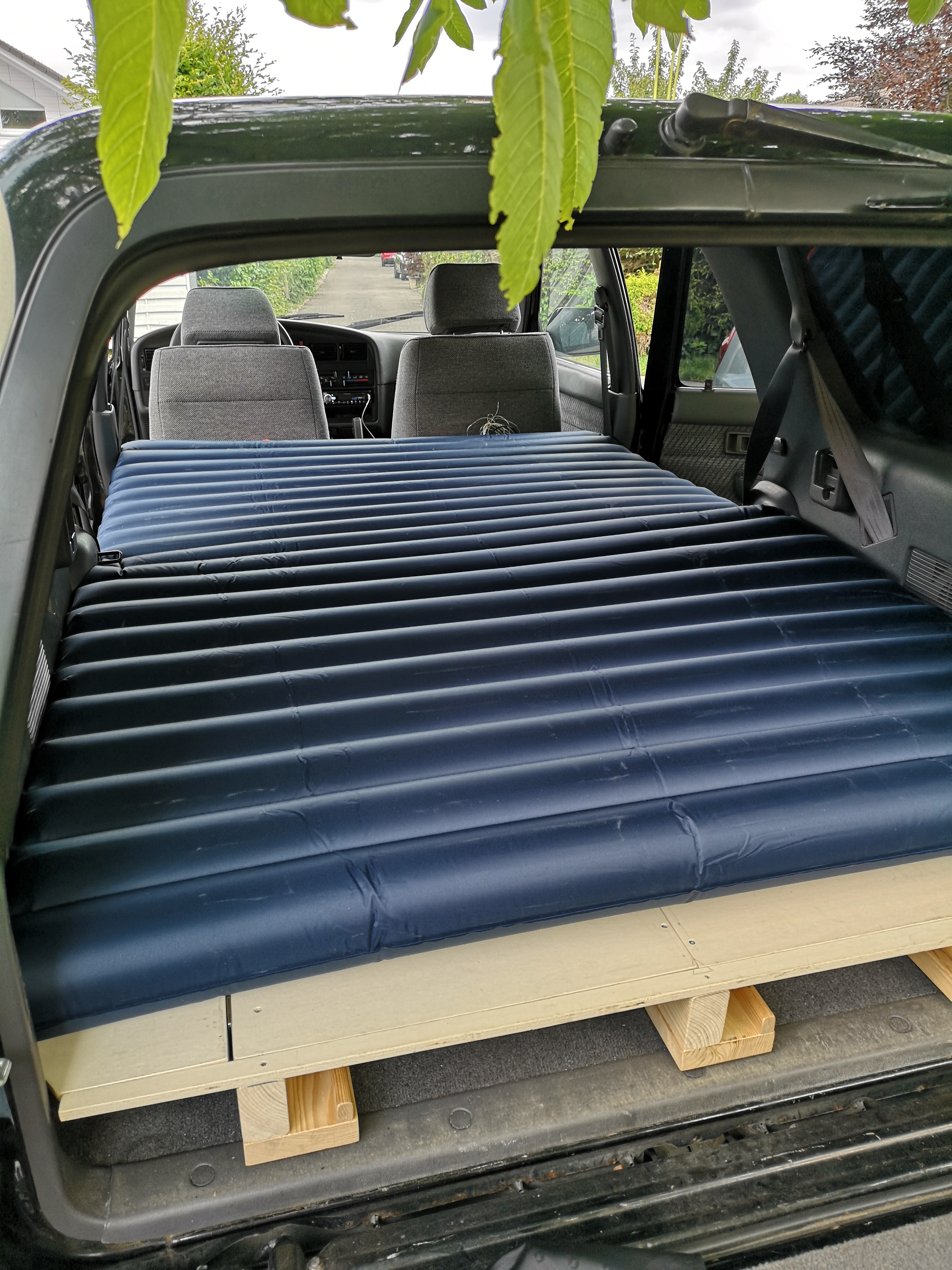

2) take out second row seats and make a platform to sleep on
3) build in cruise control

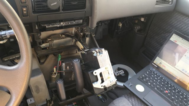

Interior 1) build in new radio
I have used this thread to help me with it: https://www.yotatech.com/how-tos/a/t...-stereo-414734
Basic summary of steps i took:
1) Looked for a radio online and bought it. I wanted to have a 1-DIN radio with DAB+, bluetooth, front USB, external mic
2) chose the Pioneer MVH-X580DAB and an external DAB antenna for ~150€
3) removed old stereo unit + the front amplifier
4) cut off old connectors
5) rewired cables to get them fit to the new norms - I have used this source to make sure I wire it correctly: https://www.the12volt.com/installbay...tail/2022.html
6) on the first boot, only the front speakers worked, since the second boot ALL speakers, even the small ones in the back work perfectly fine. no other adaptions needed!
SUCCESS
SUCCESS

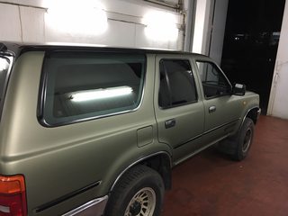

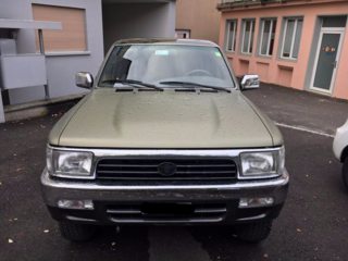

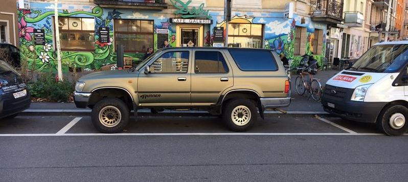

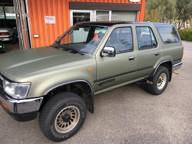

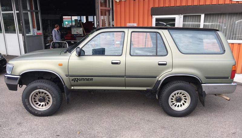

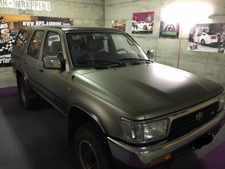

Exterior 2) give it a new color

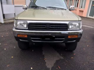

This is the car how i bought it (to be fair, there is 4 wheels in the back, so it sagged even more on the pic:
I then got to know a guy who wraps cars in his free time and got a really good deal (for Swiss prices) on wrapping the car in Matte Metallic Midnight Sand:
Before wrapping it, I also got rid of the running boards to make it have seemingly more ground clearance
Hope you like it as well

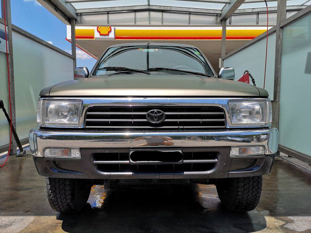

Welcome to Yotatech, it's neat to see someone from Europe on here. I like the wrap, makes the truck look much better. I don't know much about the 3.0, but lots of info can be found here on it.
thanks cory! i am already reading on the forum since >2 months and got great value out of it.
my questions now mostly concern topics I have not found still valid or in-depth enough information (e.g. current cat-back exhaust system suppliers that are EU or Swiss regulatory approved)

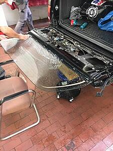

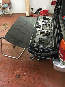

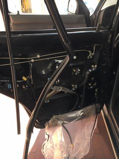

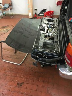

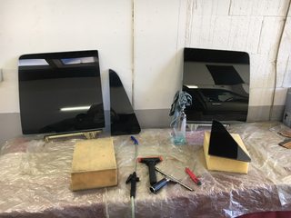

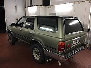

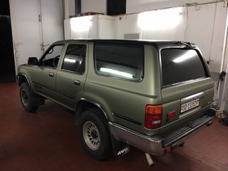

4) window tinting (potentially)
took out the ones on the rear side doors to make them borderless. got a 95% tint
the rear window was a real bi***. it was hard to get it on, because we didnt have a nice rest for the window being out like that. after putting it together, the automatic lock/unlock of the trunk doesnt work anymore. maybe we got some water over something, it only works manually now
overall i am really happy with the finished product (even though the fixed side windows in the rear kind of have a glare/reflection to it from the factory tint)
7) smoked backlights
still looking for any recommendations - cant find any :/
'Performance':
1) get a new muffler to make it sound better
still looking, doesnt seem like there is anything useful out there for me.
Exterior

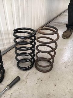

finally got the new Moog CC255 springs and installed them yesterday. As some people already mentioned, the springs are a tiny bit shorter than the stock ones.
But they still fixed my rear sag without any spacers. Gained about 4cm / 1.5 inches - makes me really happy
Here is a before and after pic:

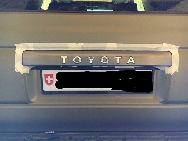

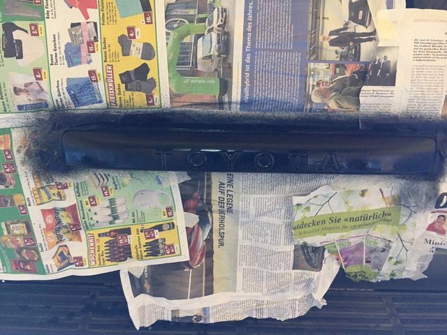

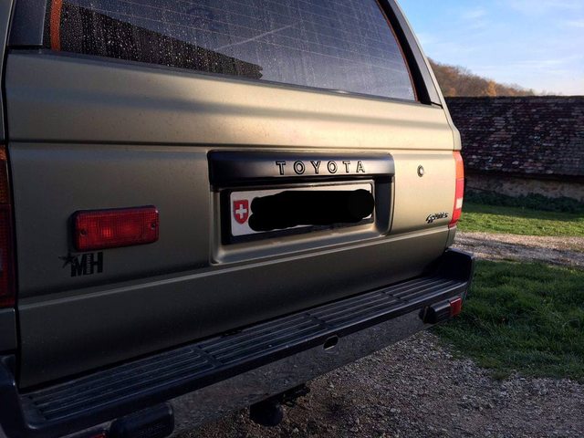

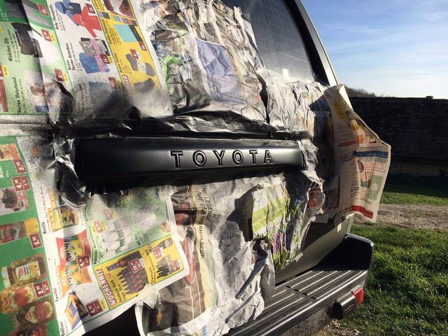

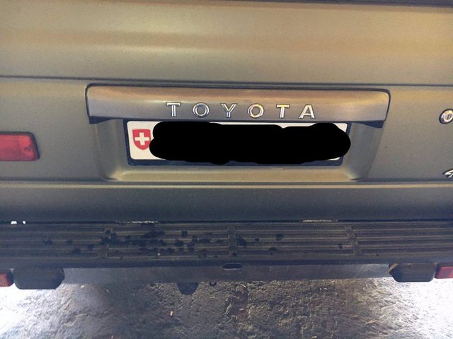

Had to do something quick yesterday, so I painted the back door 'latch' in matte black.
Process steps were
1) clean + alcohol to get rid of grease residue
2) mask of car wrap, license plate + license plate lighting
3) put on ~4 coats of paint
4) remove mask
now I am also thinking of getting the bumpers done in matte black and remove the already partially rusty chrome. what do you guys think, would it look weird?
Process steps were
4) remove mask

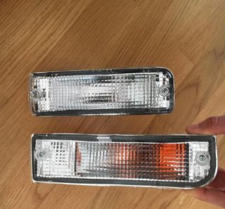

today i finally got the correct set of clear signal lights; had to mount them instantly of course:
Ps: this is what they sent me before (bottom one is the correct one)

3) get more ground clearance
installed new moog cc255 which gave it a nice stand. it was a freaking nightmare to get the old springs out at first, because i dont have a high jack.
5) change rims
well they are not really changed, but rather painted black. re-drew the white letters on the tire as well and put a new hubcap on. need to redo the center caps at some point.
6) modify the look of the front grill (satoshi / mesh?)
i have painted the grille and the logo black
what i initially wanted to do, was to make a satoshi grill, but i was scared of destroying the grill like this

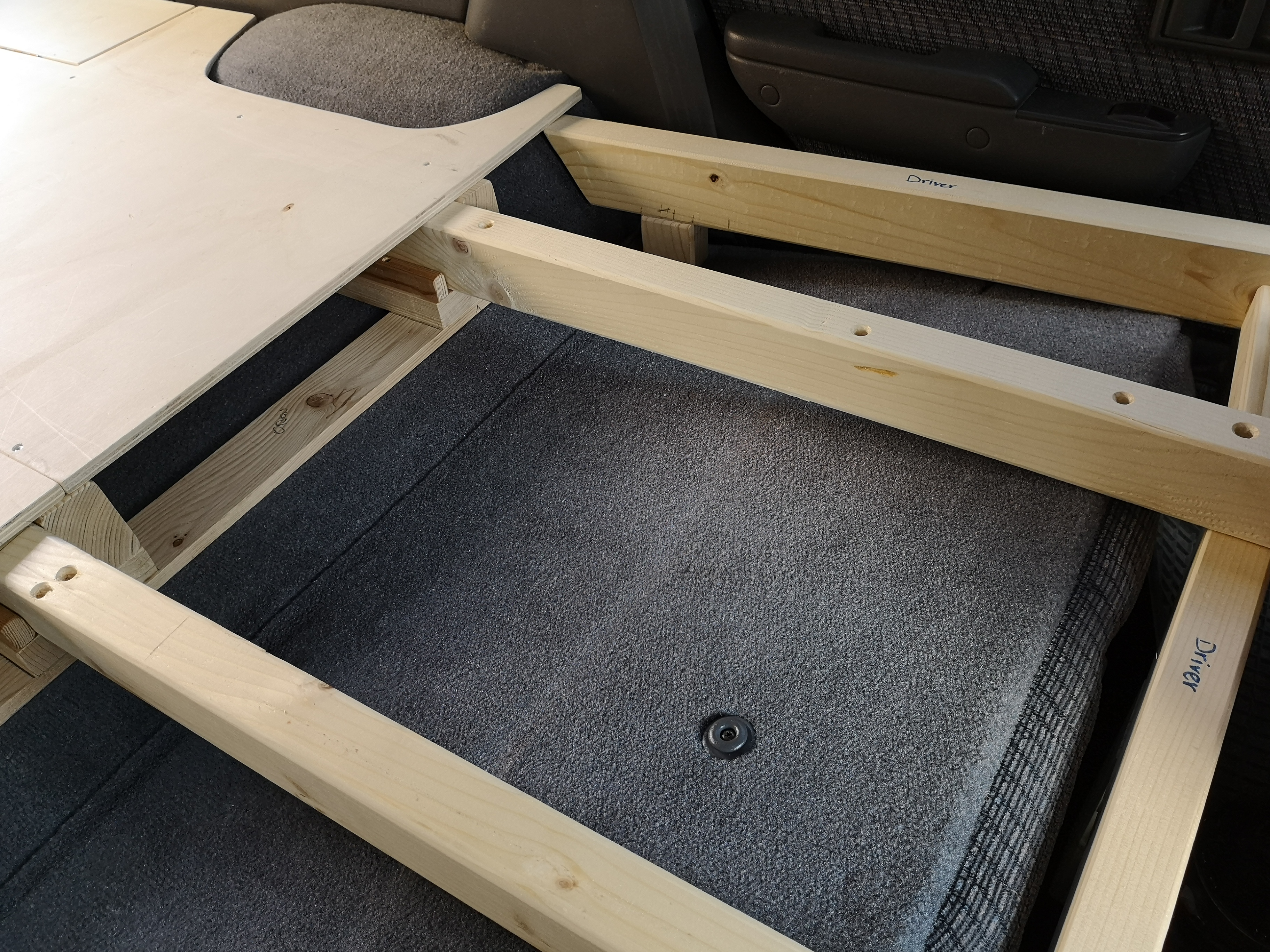

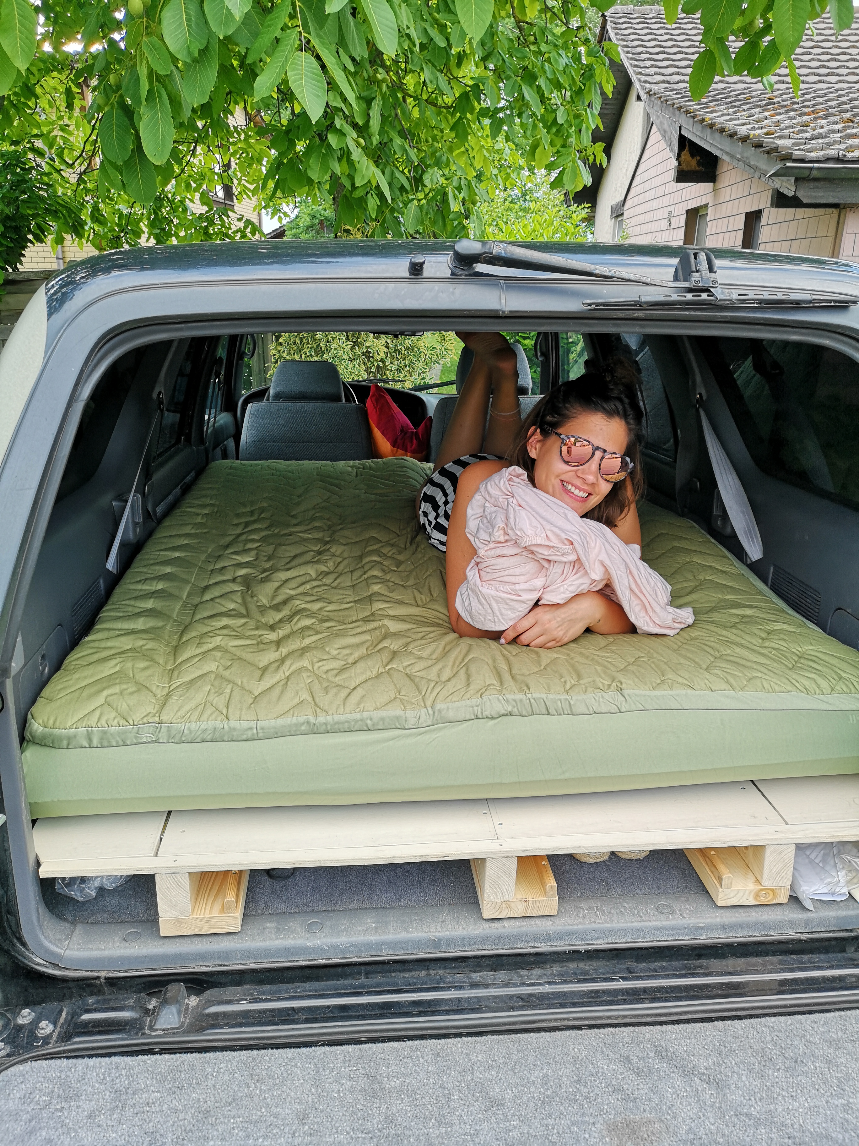

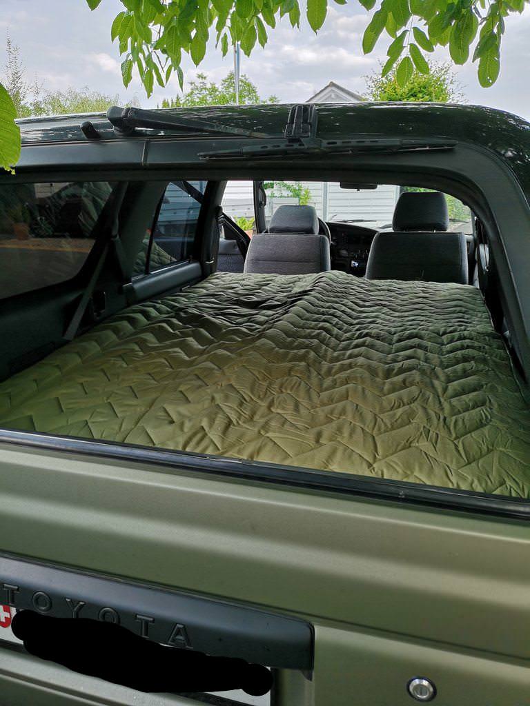

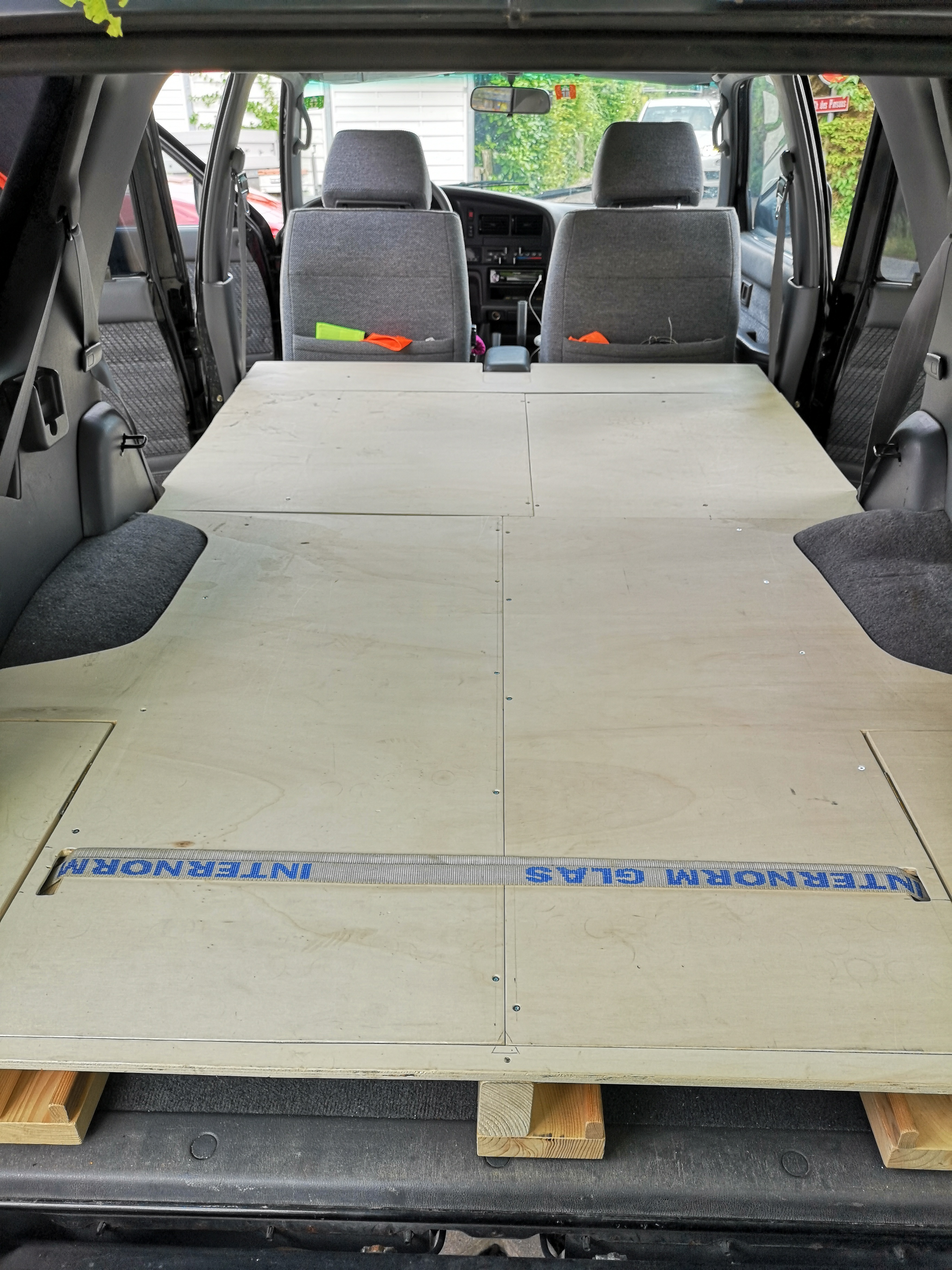

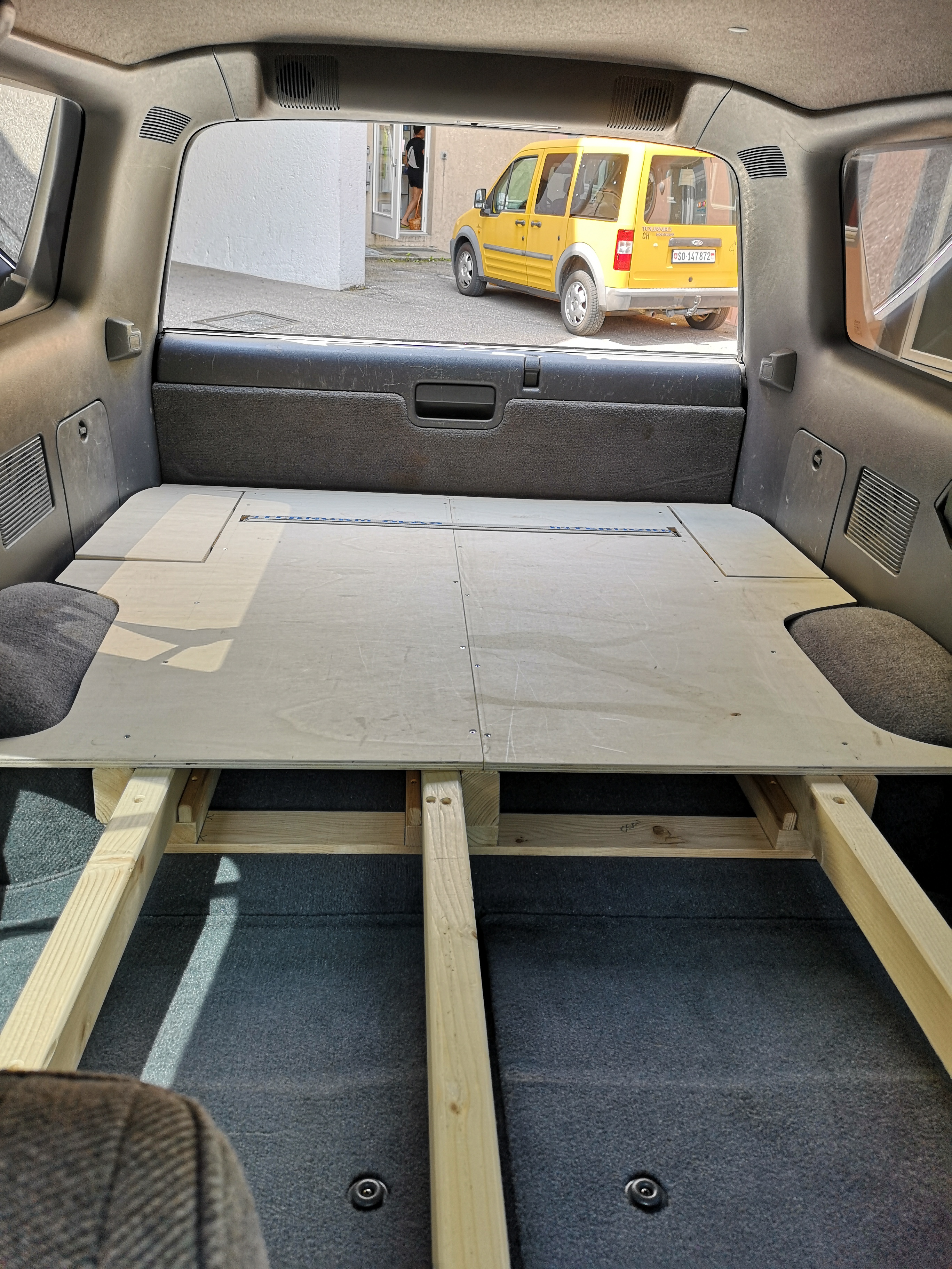

that was one of my favorit jobs here
took out second row seats
built a platform in the back that looks like a pallet (or panoply - sry dont know the correct english word). i built it in a size so i can always keep it in the trunk, even if the second row seats are in
also, on the sides there are two little compartments for storage
inside of it are some 2 by 4s that extend to a) the first row seats and b) even about 3' further in case i want to have over 6"3' of space (so i can lay down comfortably)
in the 2x4s i drilled some holes in which i bring wooden dowels from the top wood sheets
secured the base in the back with - just in case
installed some dimmable led lights for some nice pizazz
then i bought a combination of air mattress and memory foam topper
