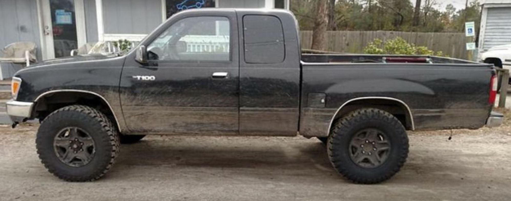

Picked up this T100 for my son for his first “car”.
Decided to post up a thread here for the intimate trials and tribulations of bringing a T100 back to life that was absolutely BEAT as a hunting truck.
I should have posted walkaround pics when I brought it home before I got to work on it to illustrate how bad it was, but you’ll get the idea as time goes on.
Feel free to chime in with any good advice along the way.

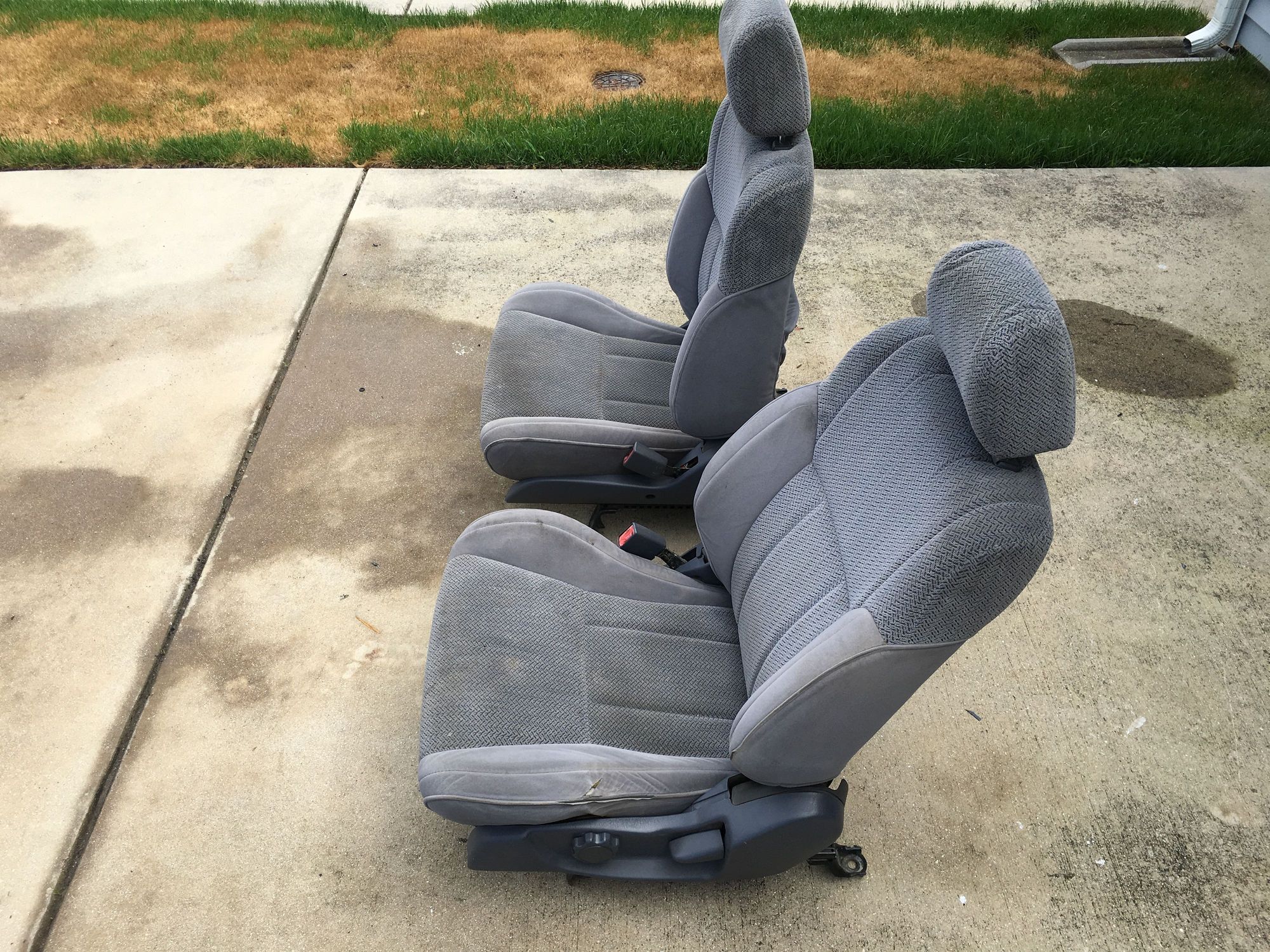

Pulled the seats. They had to go. Words cannot explain how much I hate the stock seats in the T100.
If anyone wants them, come get ‘em.
