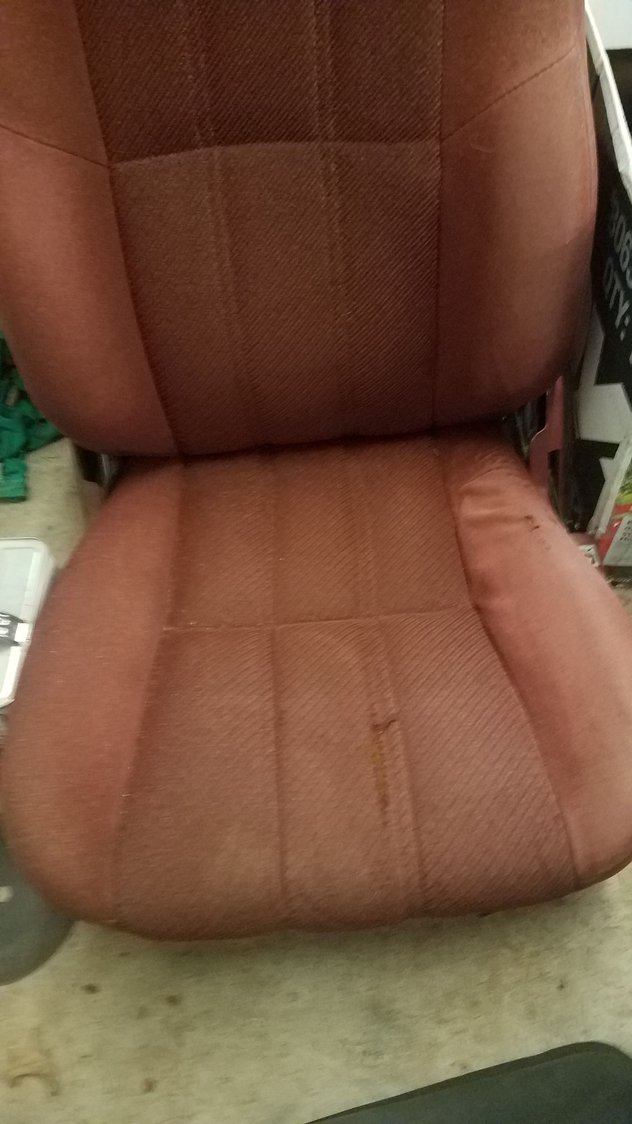

What seats you got?
These will do till i get my factory ones fixed...
