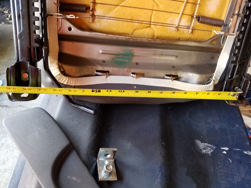

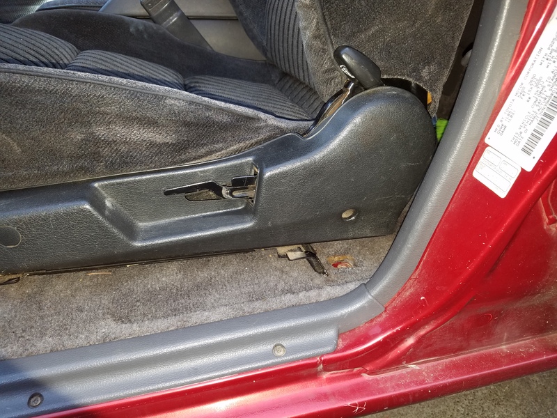

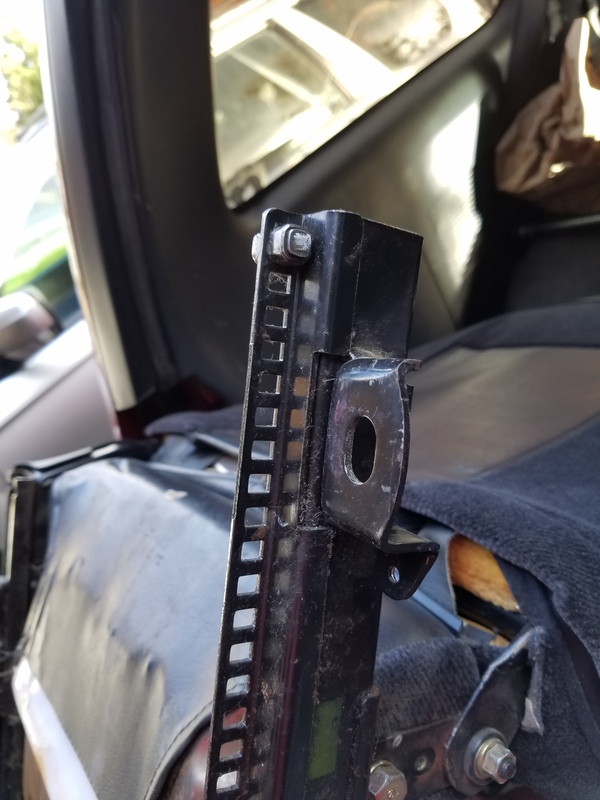

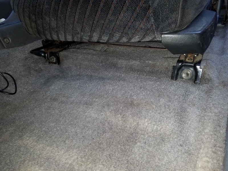

My driver's seat is ripped in the typical spots for a 20+ year old 4runner with close to 200K. It has also reclined one me a few times while driving like the ratchet mechanism was about to die. Not a good thing to happen I had looked around for a good replacement but no luck finding one that was cheaper than what I paid for this thing
Several years ago I installed a set of 96'ish Prelude seats in the Trekker. I had replaced those with a set of suspension seats. Attempted to sell the Prelude seats and even tried to give them away..No luck, they sat in the garage for a few years. They are still in great shape so I busted out the tape measure.
busted out the tape measure...front mounts were 16.75" on the 4Runner seat
hmmm...Prelude seat front mounts are 16.75"

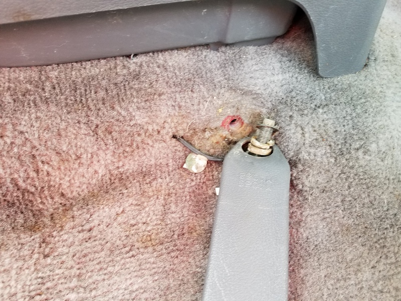

i throw the seats in the 4Runner to test fit..the inside mount for the prelude mount of course hits the seat belt mount causing it to cock the seat at the wrong angle
At first i thought about picking up some camry or corolla latches that would mount to the seat rail similar to the prelude latch. I was gonna have to make a mount to the inside rear corner any way, so I cut that sucker off and mount the seatName:  20161027_172307_zpsz3kxc0nu.jpg
pretty cool that the stock front mounts work perfect
outside rear mount will get extended tomorrow with some flat stock. Inside rear should be a simple 'L' bracket.
it will end up being bolt in install..
Not a perfect match but i think it will work
I will be able to finish the install in the morning

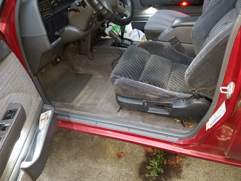

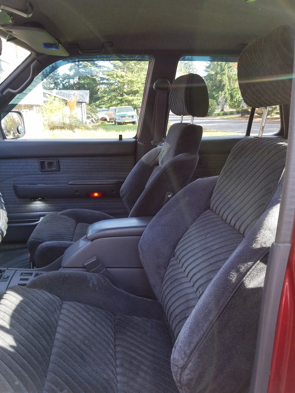

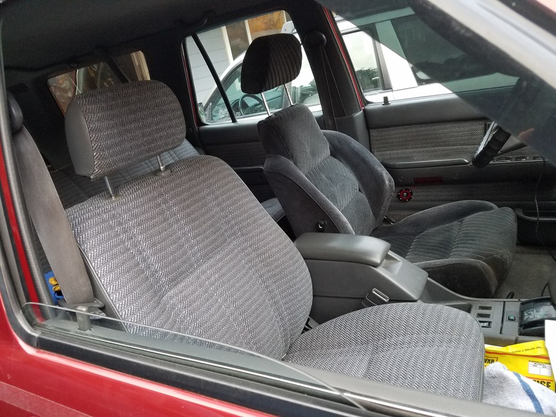

Finished up the seat install
They don't look half bad

No, they don't look half-bad. I'd say pretty awesome. Looks like they have that front hamstring support thingy. So adjustable? I like the deep side bolsters or whatevers too. Quite nice indeed.

Seats look great!
I didn't notice if the front of the seat was adjustable, gonna have to check. I know the side bolsters are adjustable, and it has lumbar support which helps this old paratrooper's back out..
Glad you like them. It was a nice and quick install that only cost me time

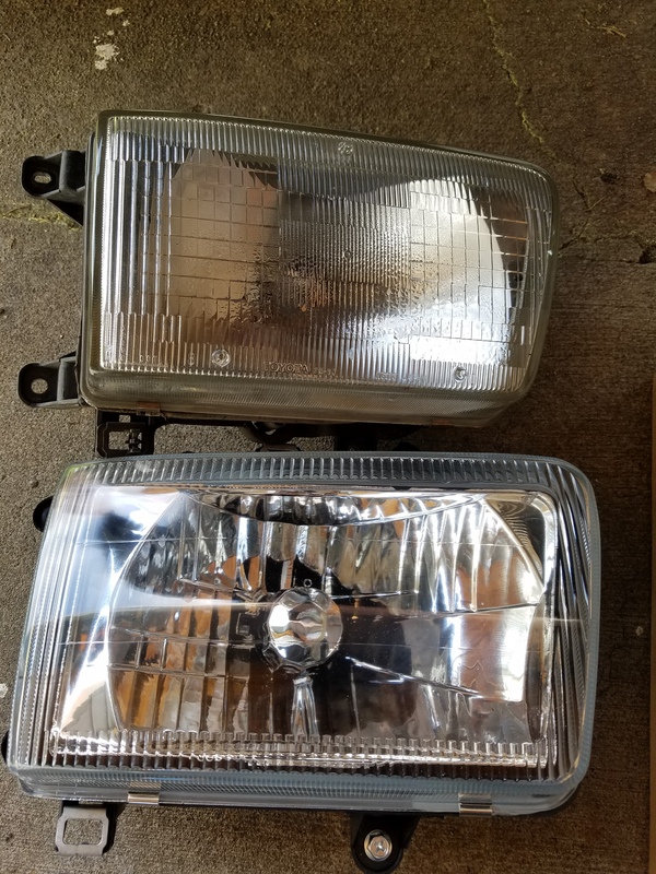

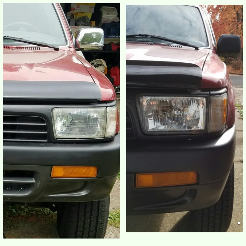

Reluctance did a set of upgraded headlight housings recently so i decided to give them a shot.
while doing the install Wiley E. Coyote was strolling down the block in front of my house:
these things are definitely clearer than the old foggy with moisture housings:
they look pretty decent
install is pretty straight forward, remove the corner lights, remove the grill install and re-install the other junk.
I went ahead and pulled a PIAA H4 headlight harness from the trekker and used it with these headlights (which use a H4 bulb)
Daylight they definitely seem brighter. Will get them aimed tonight see what the verdict is.

I initially tried it with out the harness and relays...I was about to ship the housing back because the light pattern sucked..I am using a set of LED's off amazon. I swapped in some H4's that were slightly better.
Decided to give the LED's another shot using the harness, with a separate relay for each bulb it made a huge difference. Still not sold on the LED's. Keeping the H4's in the back of the 4Runner in case something whigs out with the LED's. I was gonna get some night shots yesterday but the weather sucked. The out put is great but the pattern is not like the Truck Lite's I had in the Trekker. I think I got spoiled.

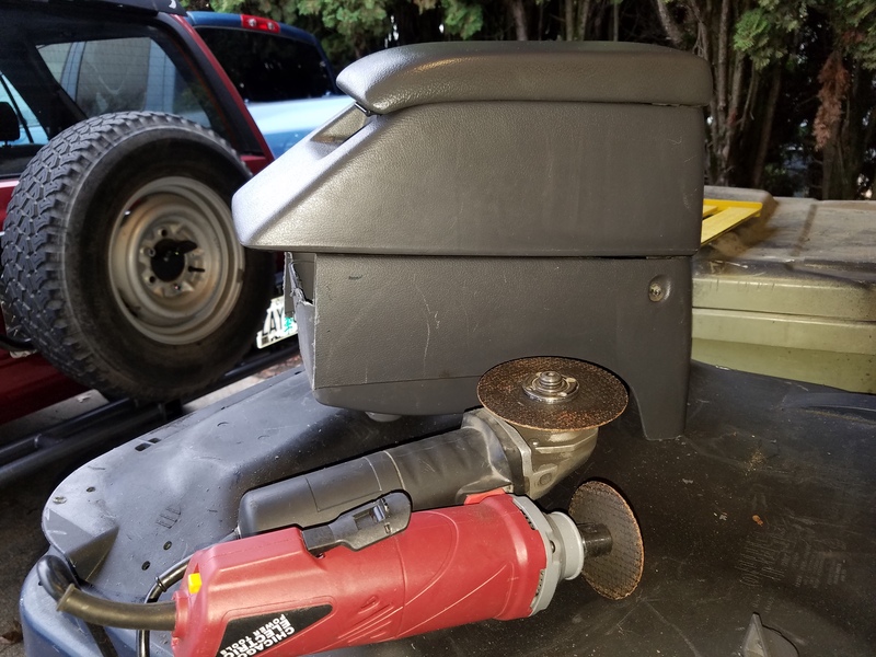

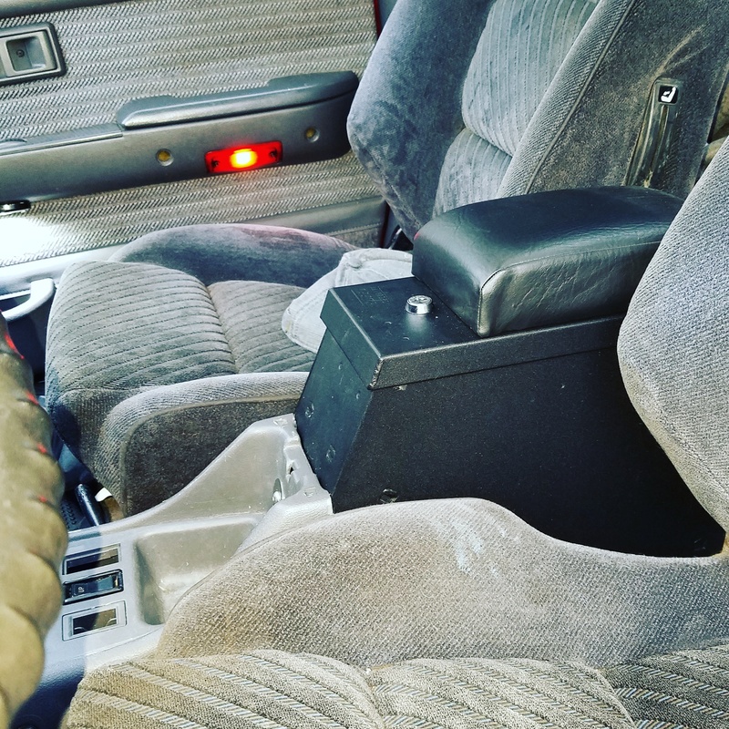

Pulled the center console today and it ran into some cut off wheels
and ended up with this Hybrid Toyota console with a locking console from a Samurai
Looking at it i could have used more of the original console for more of a fascia covering.
maybe on version 2.0

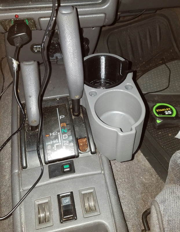

Everybody knows next to the 3.0 the next worst thing about a 2nd Gen 4runner is the cup holders.
Got my 3D printed cup holder from BH3D today.
http://www.toyota-4runner.org/classi...p-holders.html
Very happy with the fit
