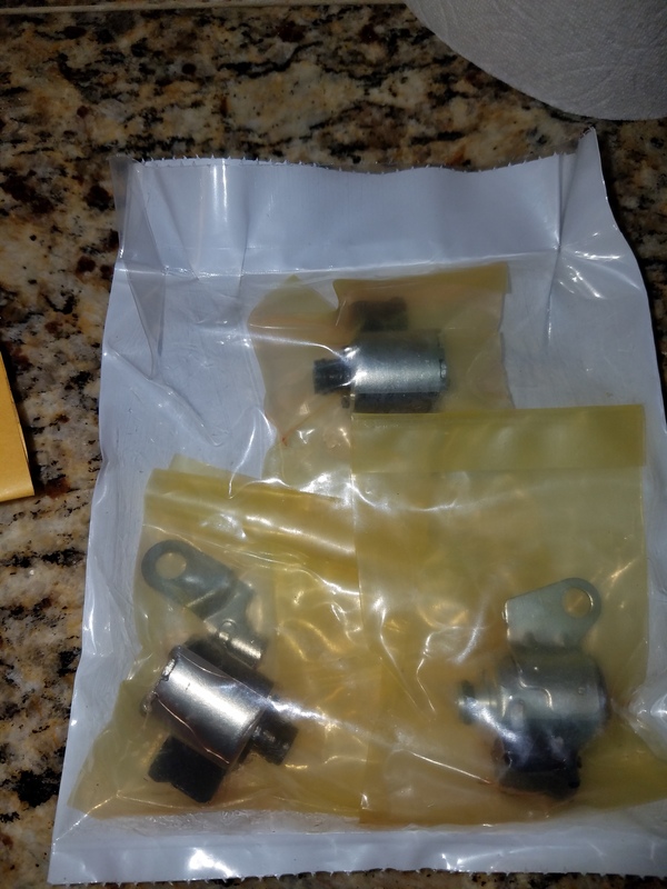

Ordered some solenoids on ebay that will hopefully fix the transmission shifting issues
