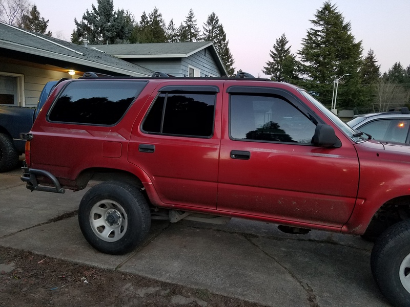

The missus gAve me a tint job for Christmas. Got it done this afternoon. Should add some privacy for sleeping in the back when this thing finally hits the trail

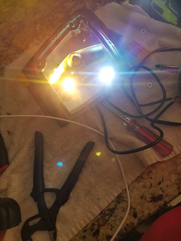

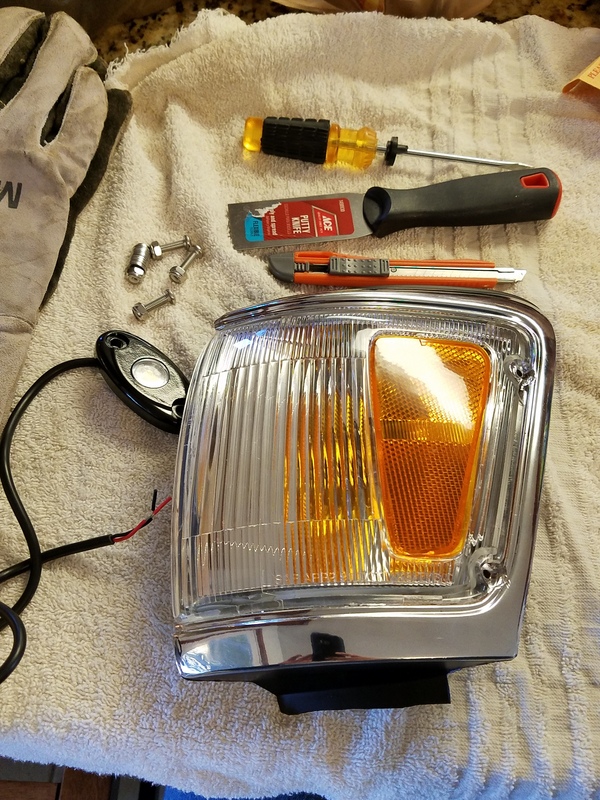

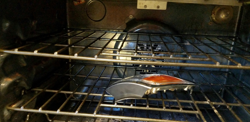

Found a few amber LED pods in my stash. Decided to try an experiment with a set of my extra corner lights.
The pod is a 9w so minimal draw to the electrical system Plan is to wire them into the turn signals. Other drivers can really only see a 2nd Gen signal from the front, this will hopefully allow the signal to be noticed from the side

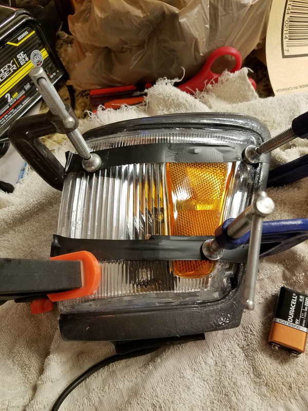

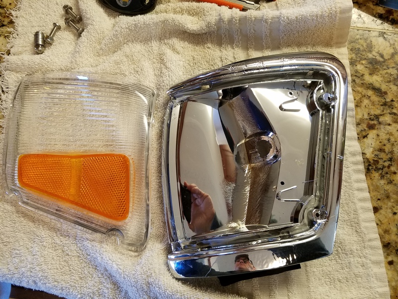

I tried the oven method for separating the housing and lens. 5 minutes at 225° worked but was a little too long. It wrinkles the plastichrome and warped the lens a bit
Lens and housing popped right apart

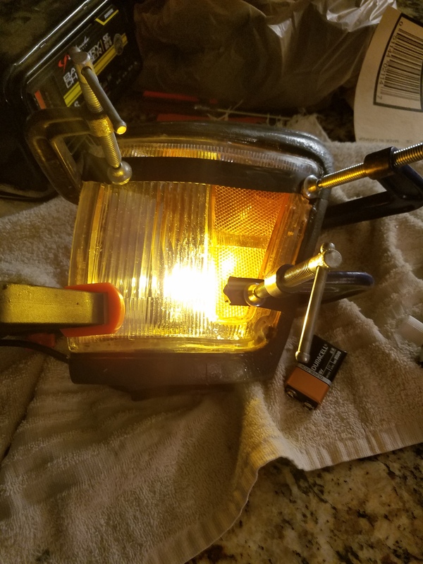

Sanded the housing and gave it shot of paint. Sealed it back up with silicone and clamped it down. Gonna let it sit over night to hopefully get a good seal. Should be able to wire it up in the morning
It will get another shot of paint, jumped the gun and got finger prints all over it

Looks like there wasn't enough room to get it mounted in the very bottom corner, which measurement got too tight to the lenses if so? Why did you not out in a light separator, not concerned or just never seen it? I thought you were mounting those silly but awesome at the same time turn lights. You know the white ones that light up the side of the road when you signal a turn and turn the wheel.
You've reminded me I need proper indicators, thanks.

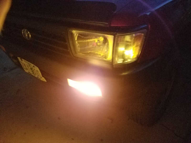

Night shot of V1.0
Originally Posted by coopster
Please post of pic of the lamp or pod, I'm curious to see what it looks like.
Co_94 is correct. There is a better picture of them below
Originally Posted by Co_94_PU
It's the little black UFO in the first image.
You know, I was so fixated on using amber I didn't even think about using a white LED.
edit: just re-read your post again, those little corner lights would be cool too...hmmmm may have to find a circuit diagram on the web that shows constant power with a blinker. I think Caddy's had or have something like that

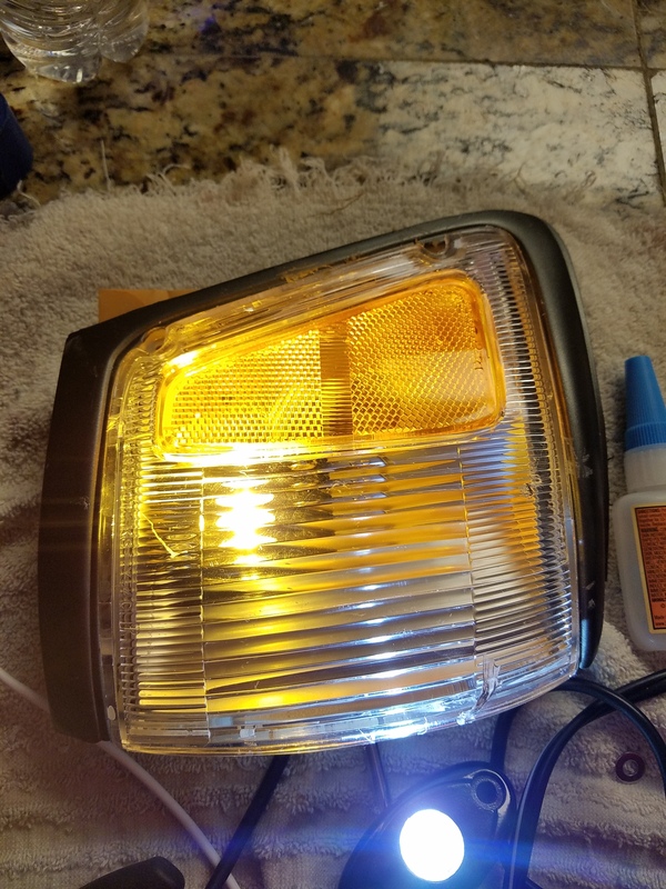

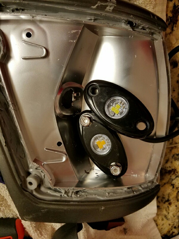

So I did a comparison.
didn't even think about a light separator..
anyway on to the passenger side aka V2.0

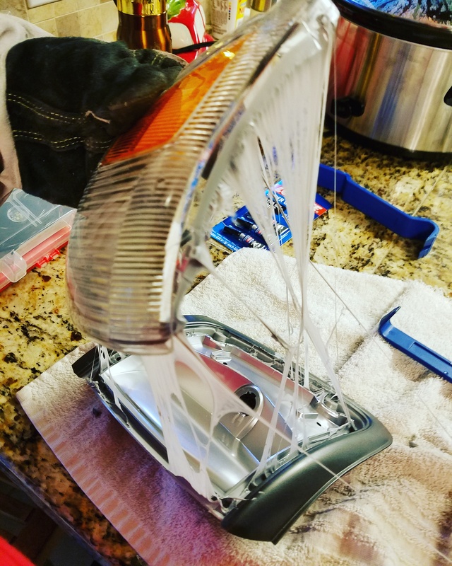

I dropped the oven temp down to 210° for 6 minutes.
That eliminates the wrinkles in the finish and no lens warping but reminded me of why I hate butyl adhesives
Close up of the pods. The amber is bolted in with a white one in for comparison
side by side with no lens
amber
white
So looking at the output of 2.0 I will swap the driver's side V1.0 amber with a white LED

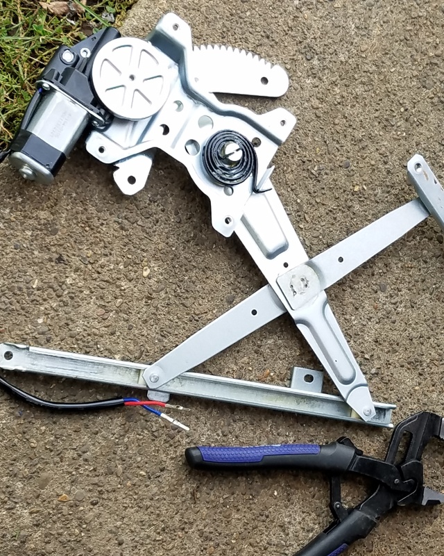

Well it finally warmed up and I had a free afternoon to get a couple of things fixed
I have been having intermittent issues with the left rear window so I ordered a replacement regulator a few months ago. Tear the door apart to find out they send a passenger side regulator..
And too late to send it back..

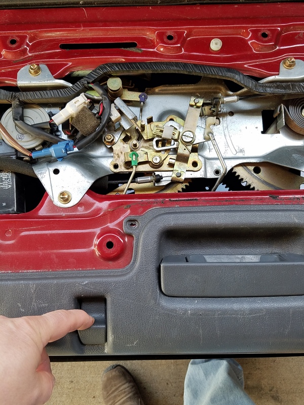

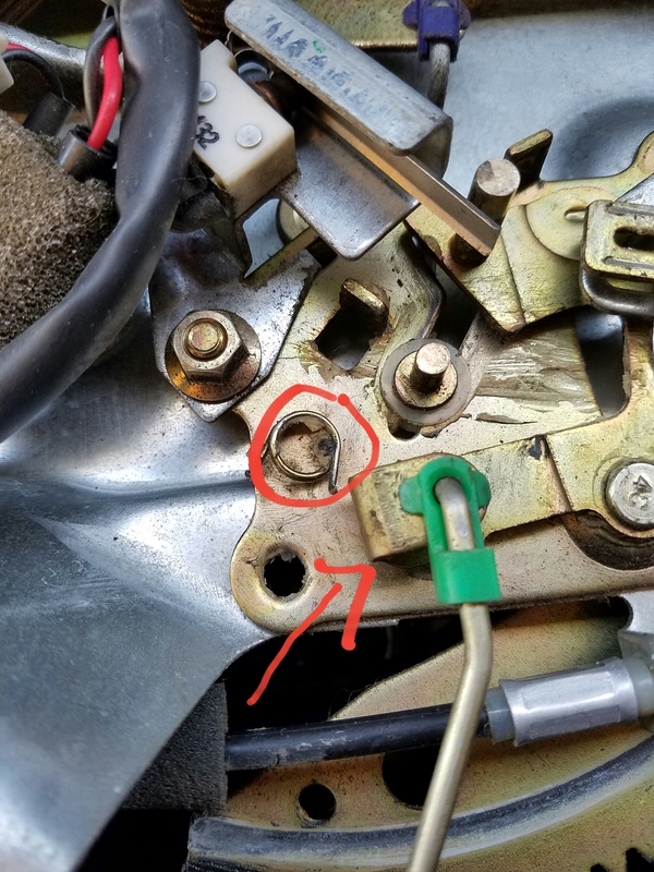

So with that being a bust I started to tackle the tailgate. I could roll down the window but not open the tailgate.
This of course is a major PITA.
Started taking it apart, I was able to get it unlocked and the tailgate down.
Digging around I found a small broken spring that goes being the lock release pivot.
Ran out of daylight so threw it back together. Plan is to replace the broken spring with a coil spring.
Upside I can get the tailgate open now

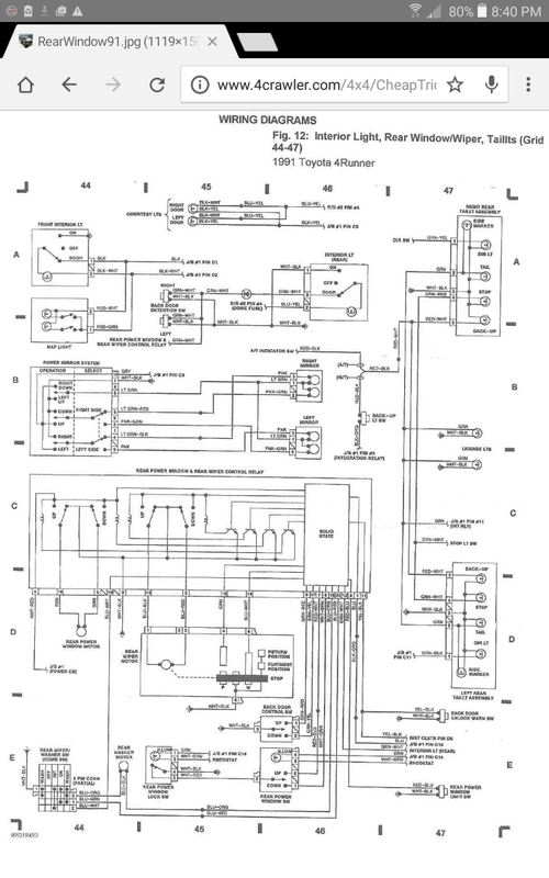

2nd Gen Rear Tailgate Taillight wiring diagram
Saving for future reference, borrowed from 4crawler
http://www.4crawler.com/4x4/CheapTri...arWindow.shtml

That is frustrating to get the wrong part. That pin in the slot just above the green clip, seems like I have had issues with it in the past where it will not move easily and can cause issues with the tail gate not to open. If I recall right, I just used some wheel bearing grease to lube it back up. While back there, I like to use wheel bearing grease on the track that rolls the back glass up with the metal wheel in it. I coat that track down in hopes of keeping it from rusting up. I think the 2nd gens were better about keeping moisture out of the tail gate.
