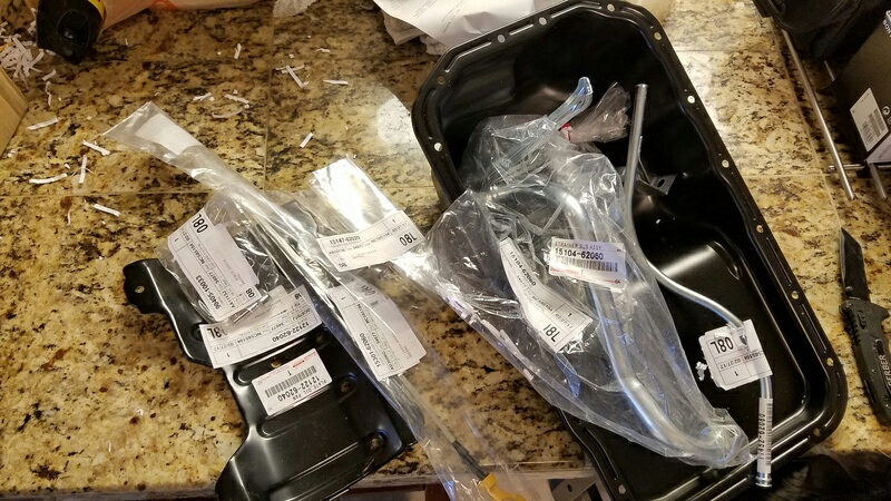

You have a 3VZE? I think you can use the same windage, dipstick, and location. 2wd and T100s had the correct oil pan you need, but you know this. The rest of the list looks right from memory.
i went ahead and ordered the parts, additional cost wasn't bad and figured i would rather have them and not need than have to wait for them to get here.
it was good to find out they were all still available
I looked at a few discount toyota sites and they were all priced very close to each other.
ended up getting them from https://www.toyotapartsdeal.com/
ordered on March 1st, had them by 3/6..
it almost seems counter intuitive to put 2wd stuff on a 4wd

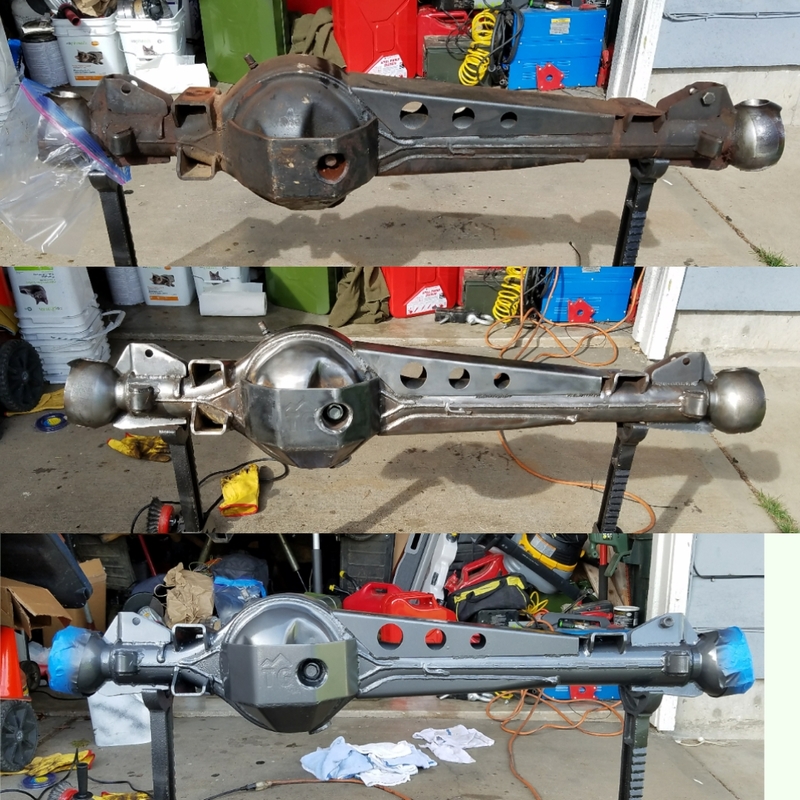

After 35 years under the 81 it was time to get rid of some rust and road grime.
About to start round 2 under the 4runner

Lookin Good. You decided to put that axle back together? Excited to see this thing slung under the 4runner!!!

Wow you ordered new parts! I never even thought of trying to buy new, ended up with junkyard parts.
The 1KD swap requires a new oil pan and sump, prices in the neighborhood of $300...ouch. So I think I will just end up modifying the existing by flipping the pan(not an option on the old IFS oil pans) and drilling a few holes. The sump will need extending. Wish we had these engines in the states.

Still plan on having you put it back together, just figured I should clean it up, it was sort of nasty

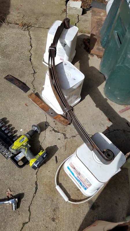

Thanks Ed! Original plan was to reuse the wheels and tires but I have never really been happy with the Goodyear MTR's, they almost seem like a bias ply and act like they have flat spots if the truck sits for a few days.
I am debating about selling them and getting some BFG KM2's. Some old school Outlaw II's would-be cool on this thing.
The sun showed up today so decided to try to clean up the 4" Trail Gear springs from the Trekker that are being recycled and thrown in the 4runner. Wasn't really happy with how high it sat so gonna give pulling the two smaller springs a shot to see if it ends up lowering the 4runner a little
