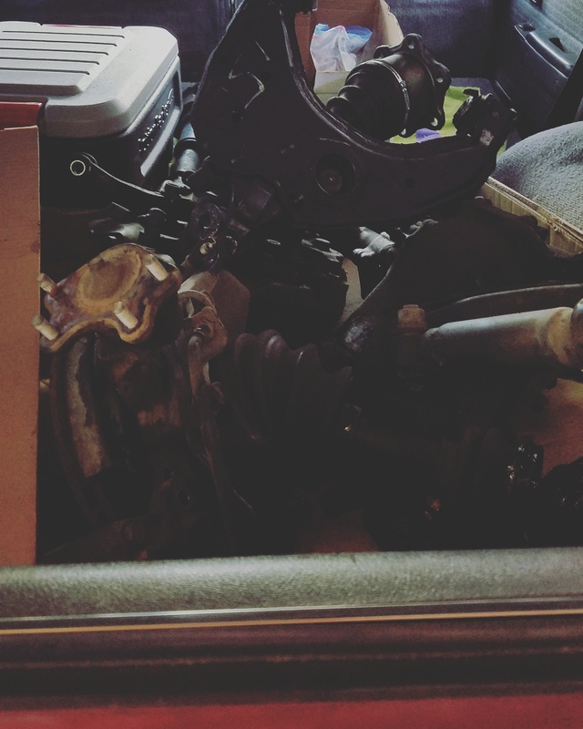

she is headed off for surgery

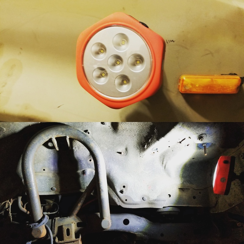

meanwhile was at harbor freight awhile ago and picked up this cool little gadget, not bad for $10

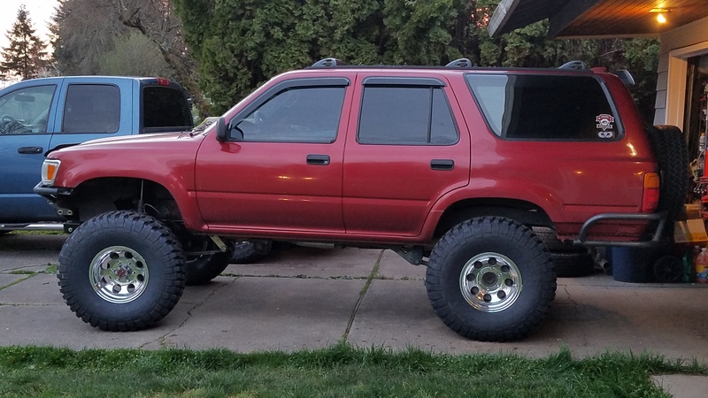

I was able to get down to a friend of mines shop today to pick up the 4runner. *I was in Texas visiting family last week so pick up was delayed a few days. *I am really happy with what he did with my limited budget.
Had a co-pilot on the way home*

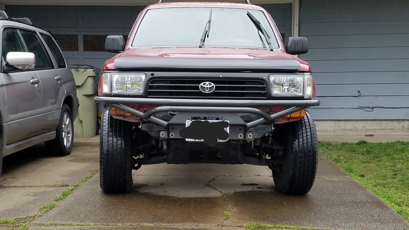

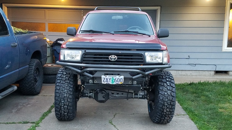

Anyway on to pics
what he started with
Front view:

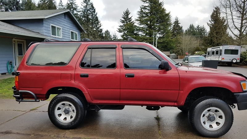

side view
Will be swapping the front shackles to a set of boomerangs from Sky's to help clear the front body mount
going from a 235/75/15 to a 35x12.50x15 was nice

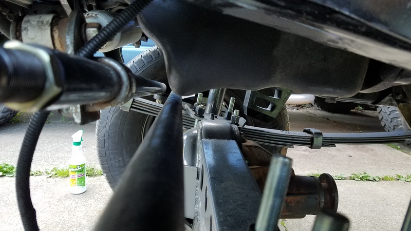

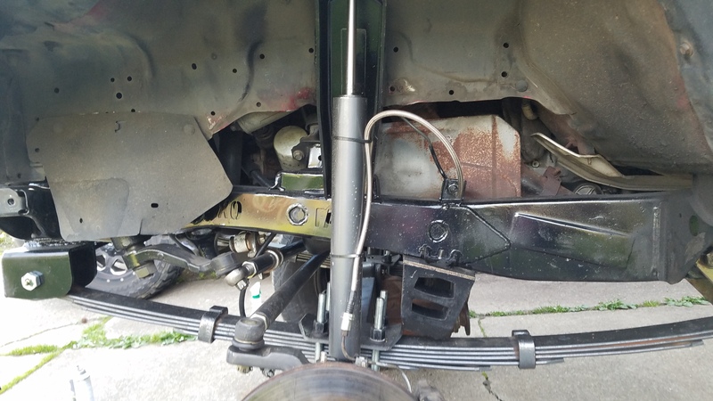

I will probably be swapping to rear leaf springs in the near future. the FJ80 springs I had didn't raise the rear as much as I had hoped.

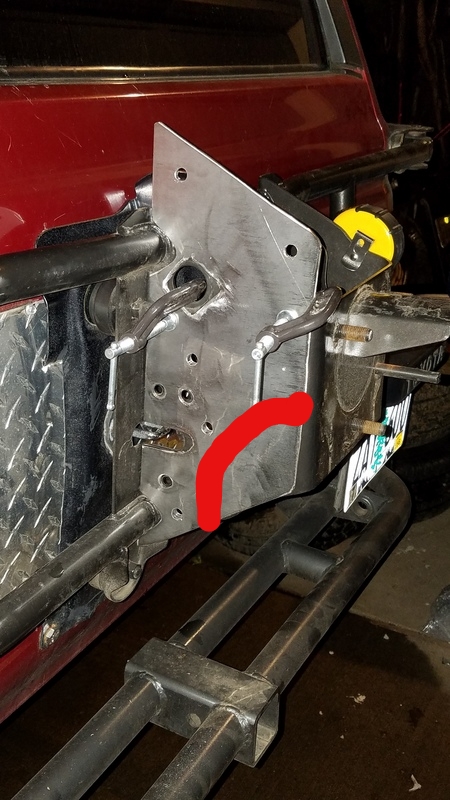

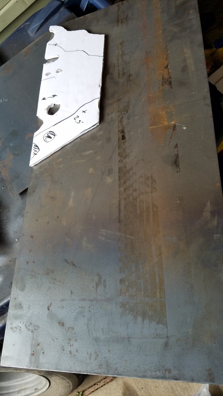

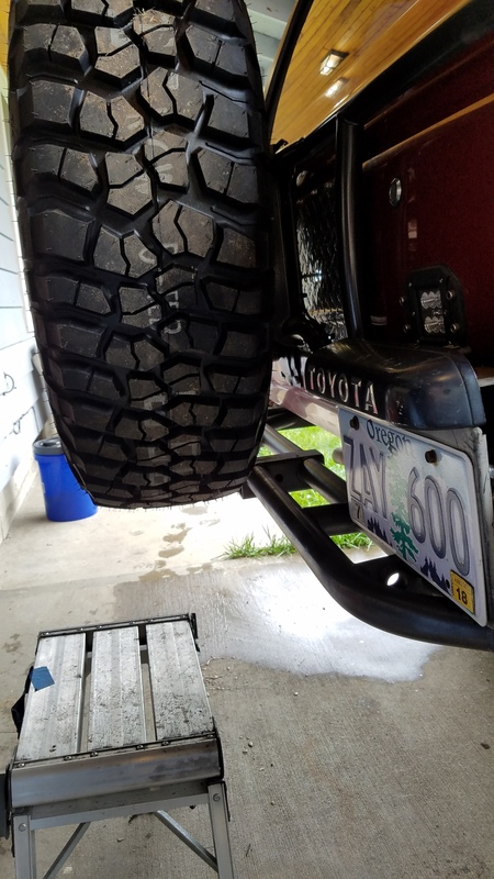

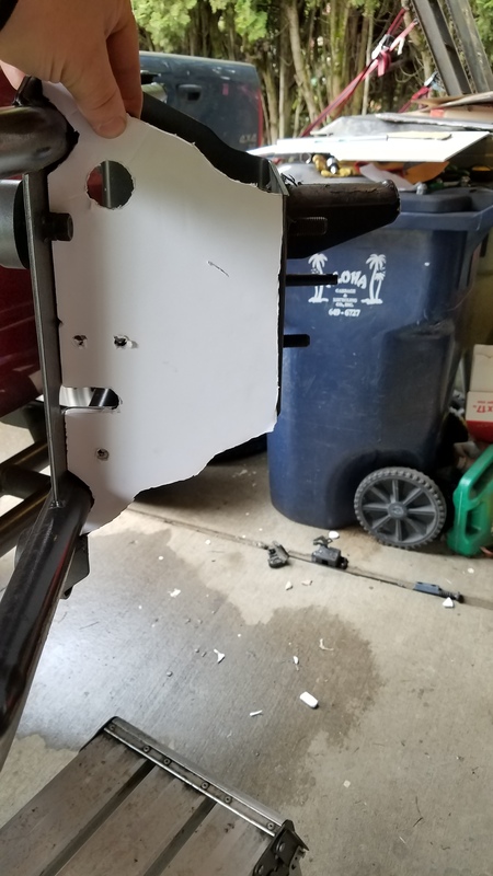

tripped over a grinder in the garage and decided to try an idea for adapting the rear swing out to clear the lower part of the rear bumper with a 35" spare
measuring it I would need to raise the mounting surface 2.5-3"
made a stencil out of some old poster stock. my idea is to cut 4 pieces of 11 or 12 gauge steel that I picked up last summer. Angle it so that it will clear the rear, cut the mounting plate and raise it up the distance I need. I'll use a combination of welds and bolts to support it.
test fit of the 1st piece. the red line indicates where i will probably end up angling the bottom to clear the rim
got the idea from this post. I think having the plates on both sides, with a few beads on each side and grade 8 bolts should support it fine.
