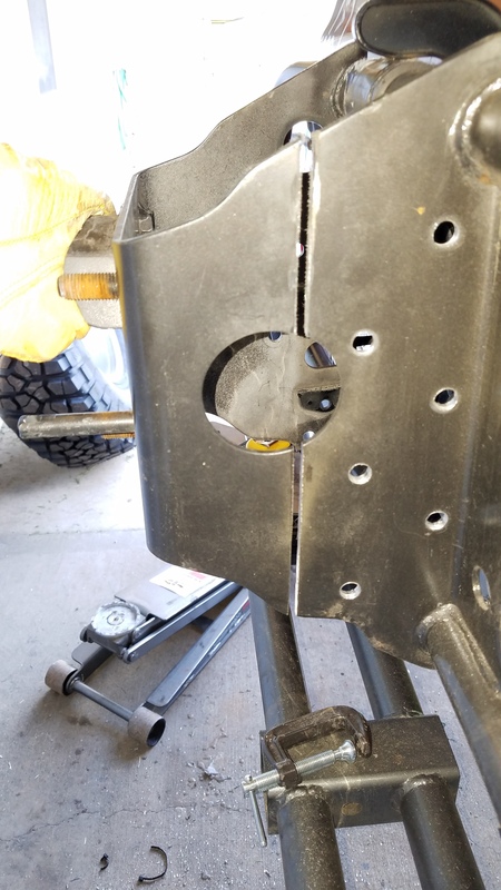

no turning back now

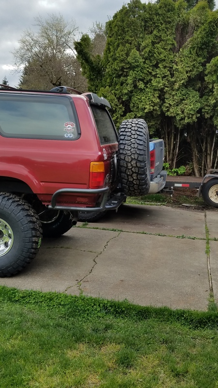

got all 4 plates cut and most of the holes drilled. Got one side welded u and of course ran out of wire.
raised it up about 3" to clear the receiver. Need to trim the bottom plates a little to clear the rim

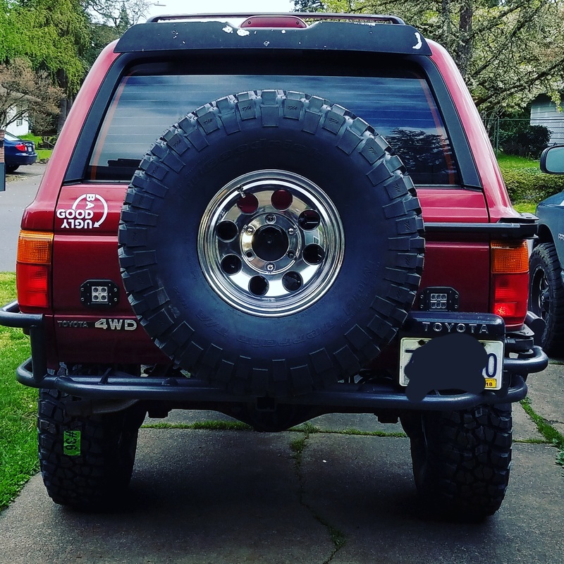

Added a 1.25" spacer to the rear, it helped even it out a little. will see how this works over the next few months.

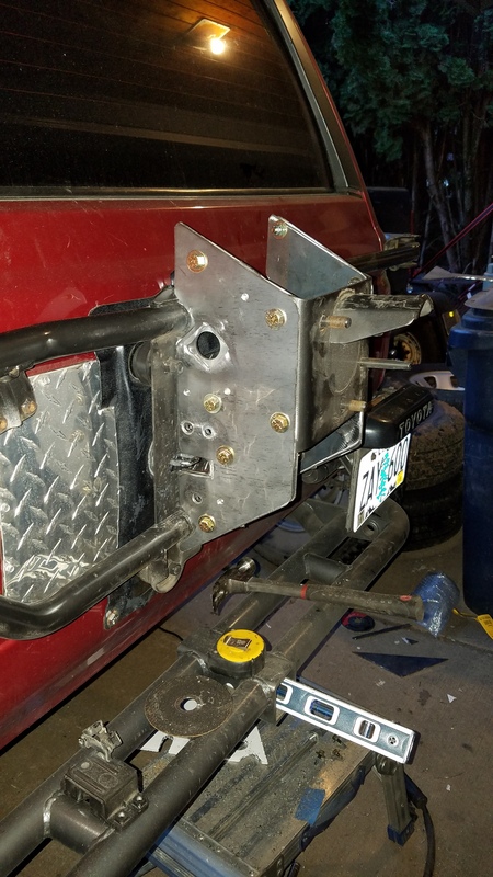

got the raised mount on the spare tire carrier back together.

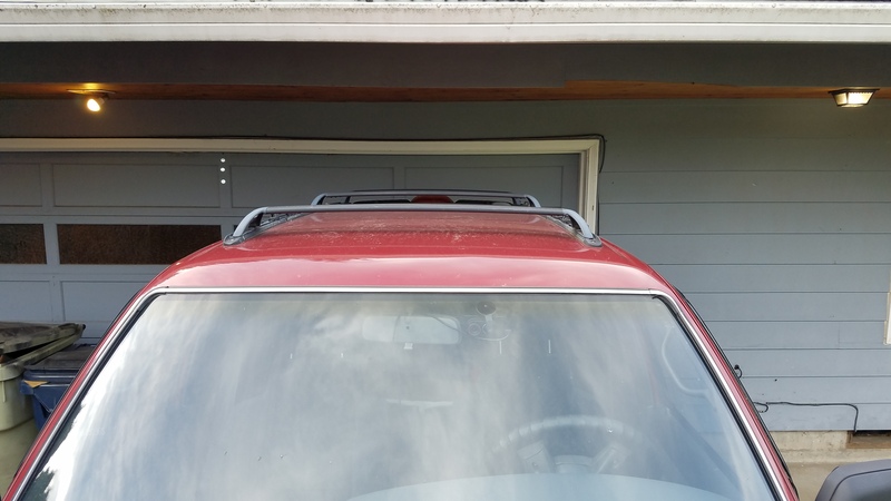

and i did a clearance check, looks like it will still fit after i rework my roof rack

Nice work on the spare tire carrier, it looks really good! The rear spacers look like they made a big difference, looks like it's sits level to me, looks great, I like the good, bad ugly sticker on the back!

As usual, love the sticker, you find some great ones. Truck looks great and more level so hopefully the spacers work well for you.
Heh, just saw rustED's post. What he said.

Looks awesome Rob! I love the rear shot. Sticker is cool too. Might have to get one of those as well.

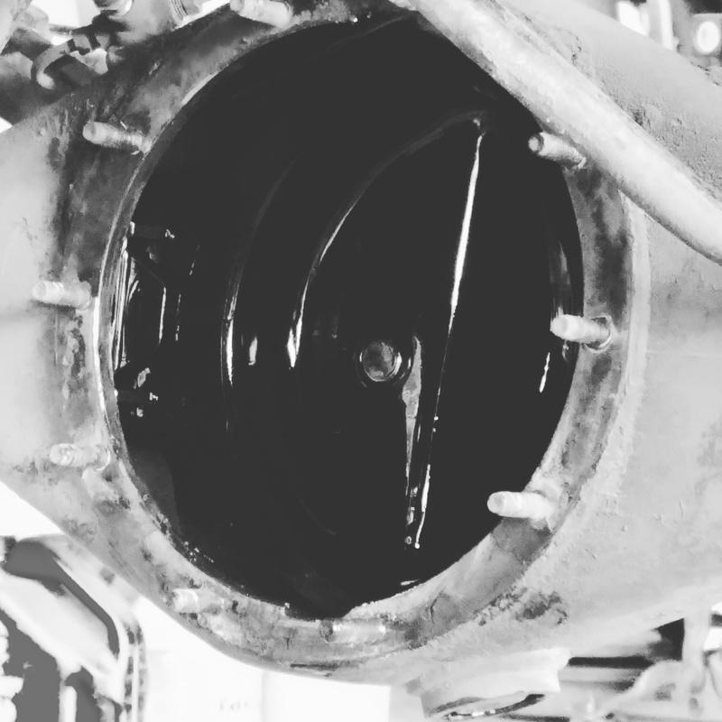

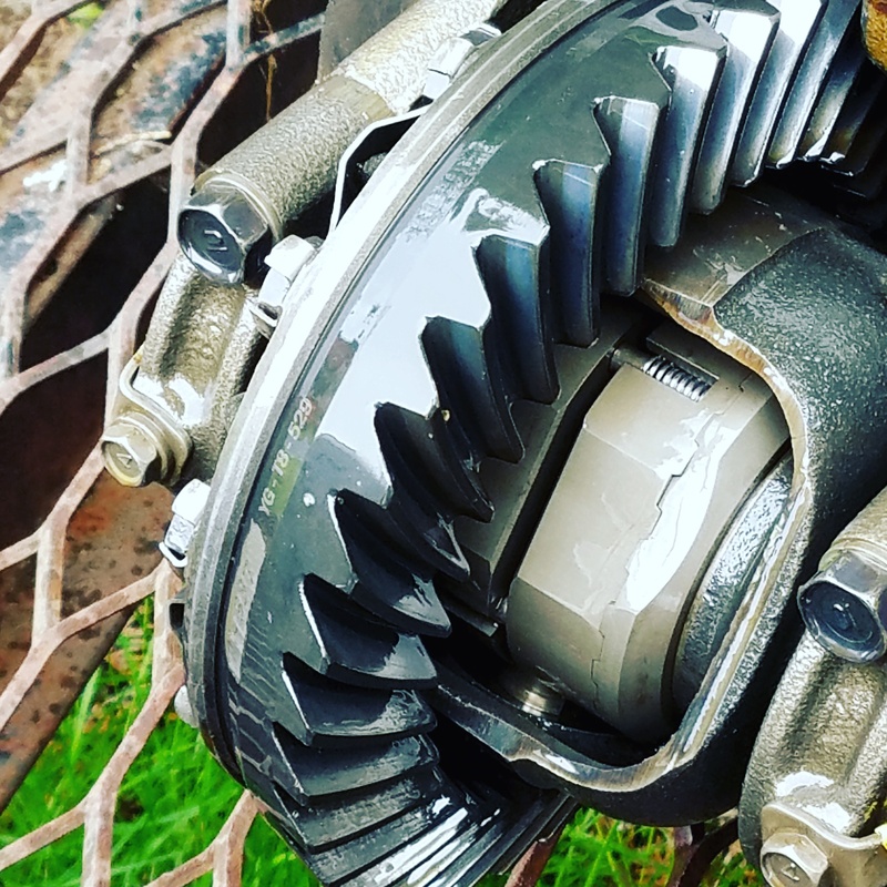

Got halfway through swapping out thirds so I could throw in 5.29's

Didn't have as much time as I wanted to work on Project Recycle today but I got the old 5.29 third pulled from the Trekker rear axle. It was good to see it was still in great shape. Not too bad since when I installed the Aussie 7 or 8 years ago I had no clue what I was doing other than taking a look at some of Zuk's write ups on gearinstalls.com
The third when in with out a hitch with the exception of me being thwarted by the 94 flange needing 10mm holes. I could have sworn I had a triple drilled flange but nope. So ordered some 10mm bits off Amazon so I'll just drill the flange on my next day off.
