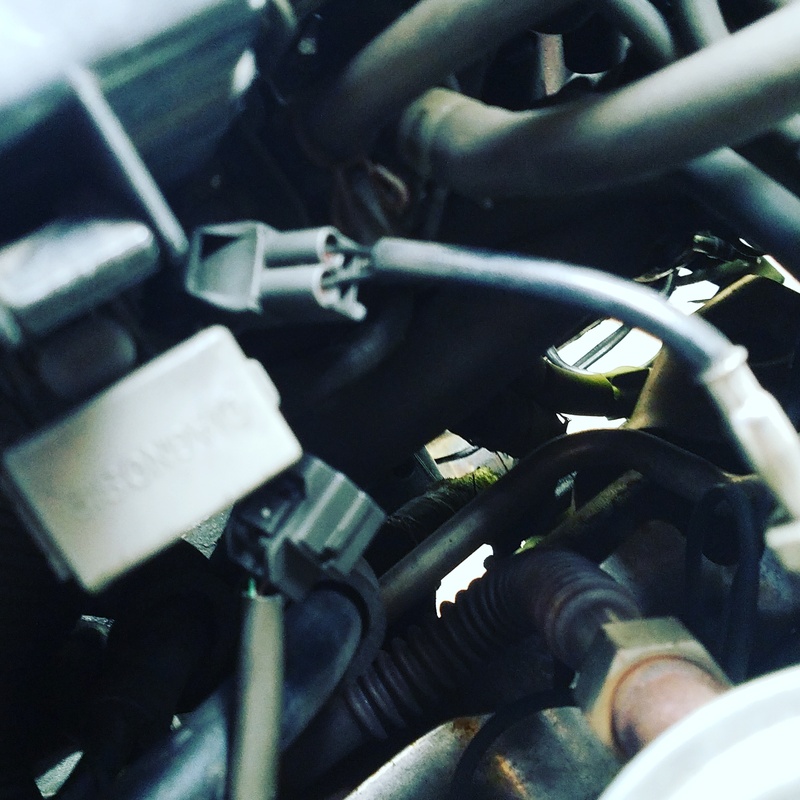

4runner's CEL came on a few days ago. Go to pull the codes, since it is pre-OBD2 so you have to jumper the diagnostic port. Found the EGR temp sensor unplugged(right next to port, plugged it back in, pulled code sure enough code 71(EGR fubar). Pull EFI fuse to reset, CEL out..i love free fixes, new sensor runs about $150.

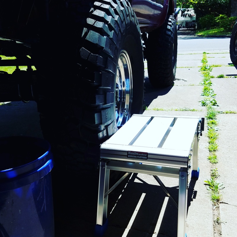

after having a spring time flu I finally felt up to getting vertical and had some time so tackled replacing the master cylinder and brake booster
when you are short like me this thing from Harbor Freight comes in handy

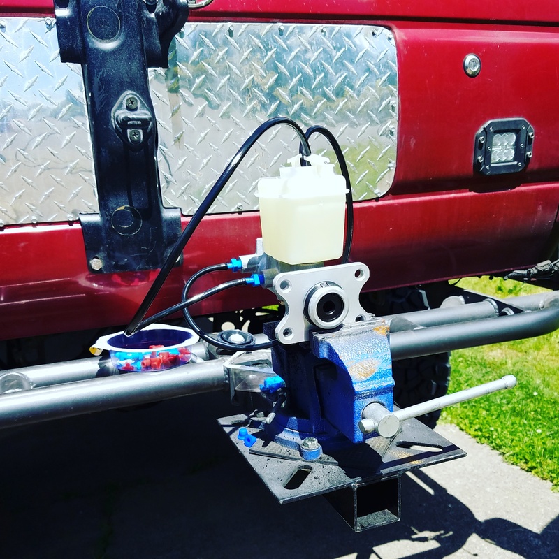

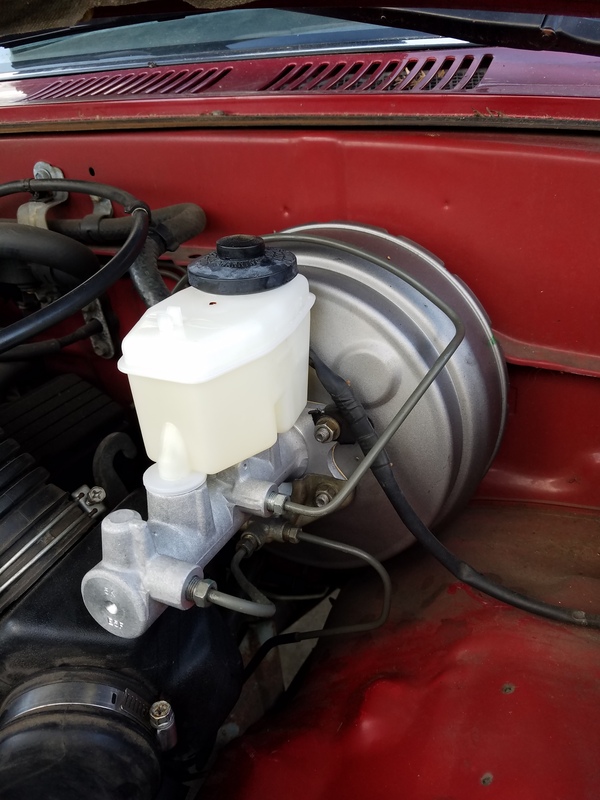

the hitch mounted vice has been proving it's worth a lot lately. Bench bleeding the master cylinder went off with out any issues

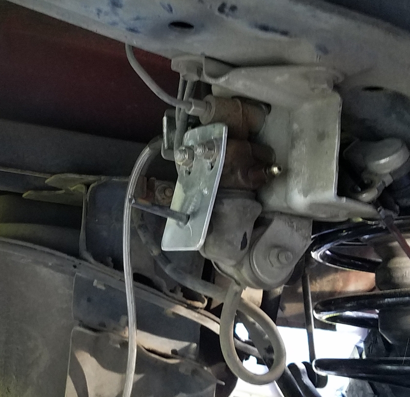

When i pulled the old master cylinder there was quite a bit of corrosion inside the brake diaphragm it so I went ahead and replaced it too.
instead of doing the usual zip tying the LSPV rod up out of the way I went with a small bracket idea that 85toyman had mentioned works like a charm
with pretty much all new brake parts with the exception of the backing plates and hard lines the 4runner stops like a dime now.

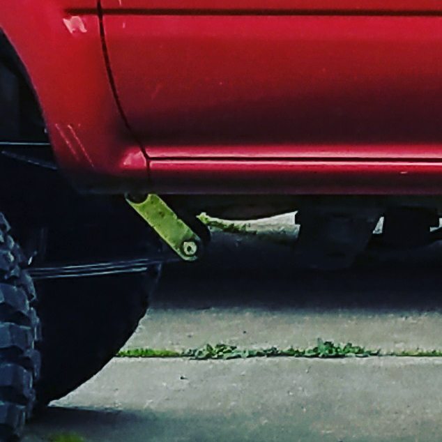

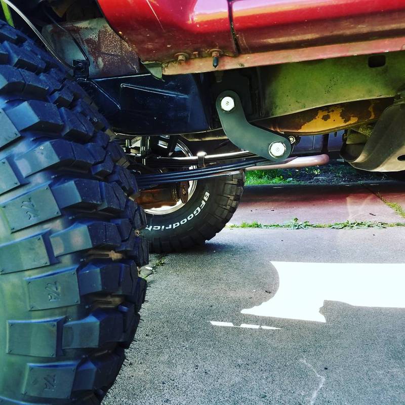

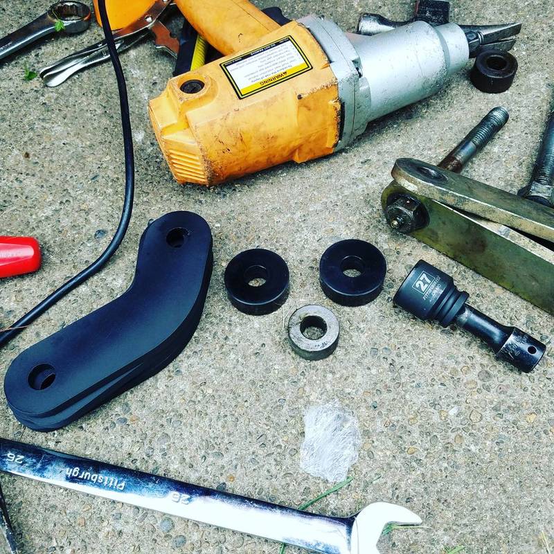

swapped out the Trail-Gear shackles that were pretty close to hitting the front body mount with the truck sitting still

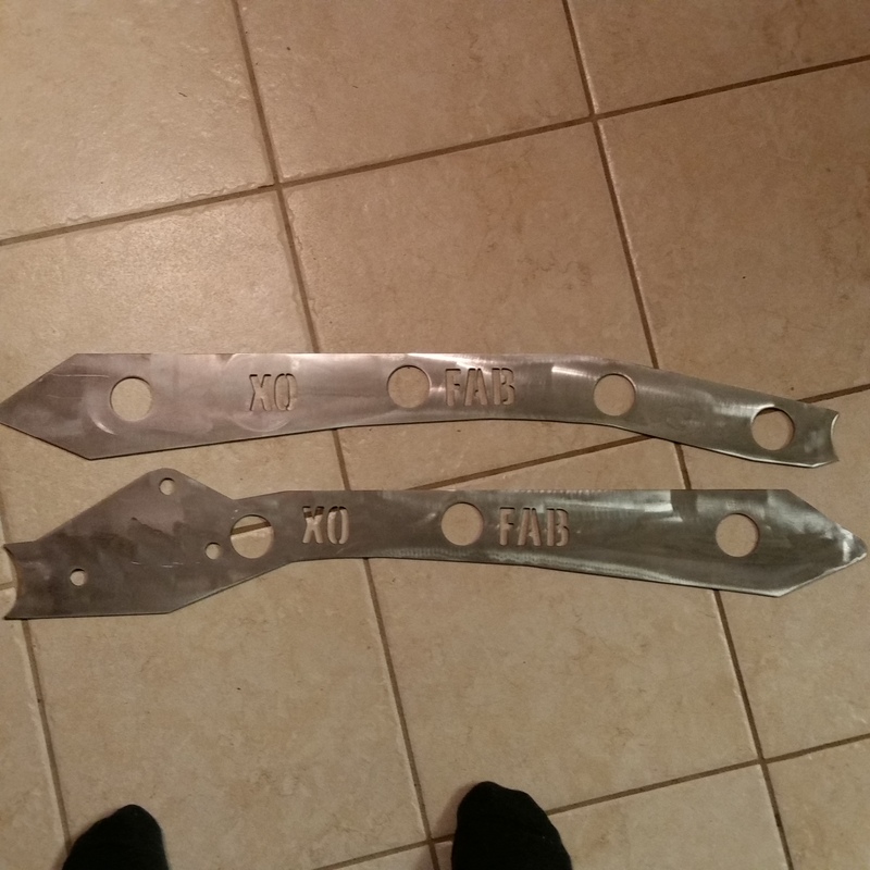

shackle angle was pretty crappy due to using this X-O Fab frame brace with integrated steering box mount, with it you are limited to how far forward you can push the front spring hanger as the steering box mounts in the stock location.
it will be interesting to see how the Sky's Delrin spacers treat the spring bushings, with the steel spacers provided by trail-gear the bushings don't have a steller service life.
Sky's Off Road Boomerang shackles installed

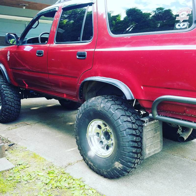

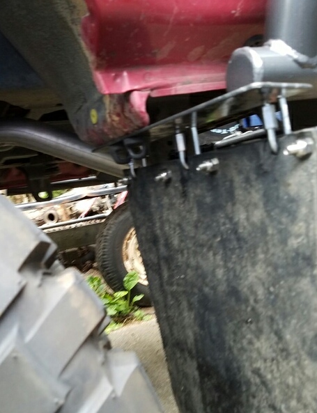

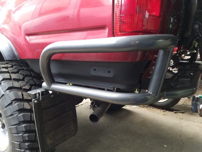

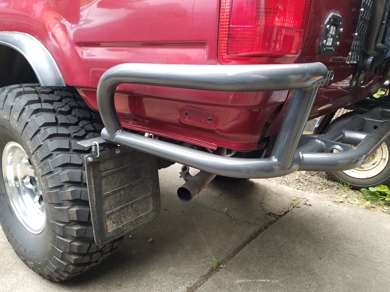

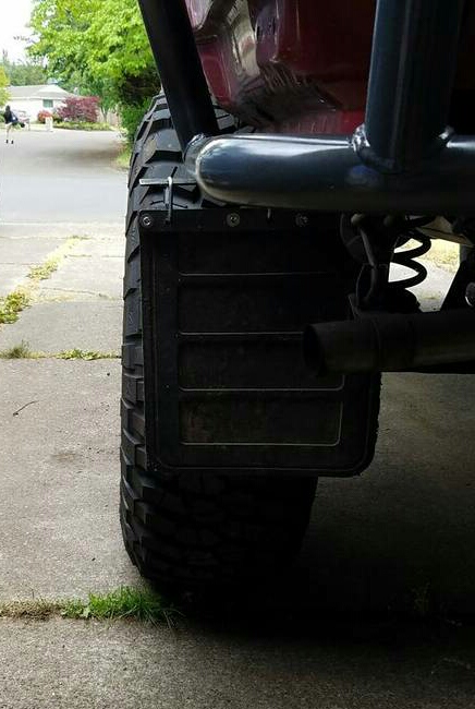

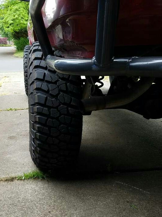

Time to do legal stuff - tire coverage
got pulled over saturday for my tires sticking out beyond the fenders and no mudflaps. Told the deputy I would get it fixed in the next few days, he said no problem.
Pulled the old mudflaps from the 81 off the shelf and looked at what I had to work with on the 4Runner. A couple of pre threaded holes...hmmm
looked at the luggage rack and a plan started to come together
two threaded lugs and removable mudflaps
tomorrow i'll see what i can do about flares

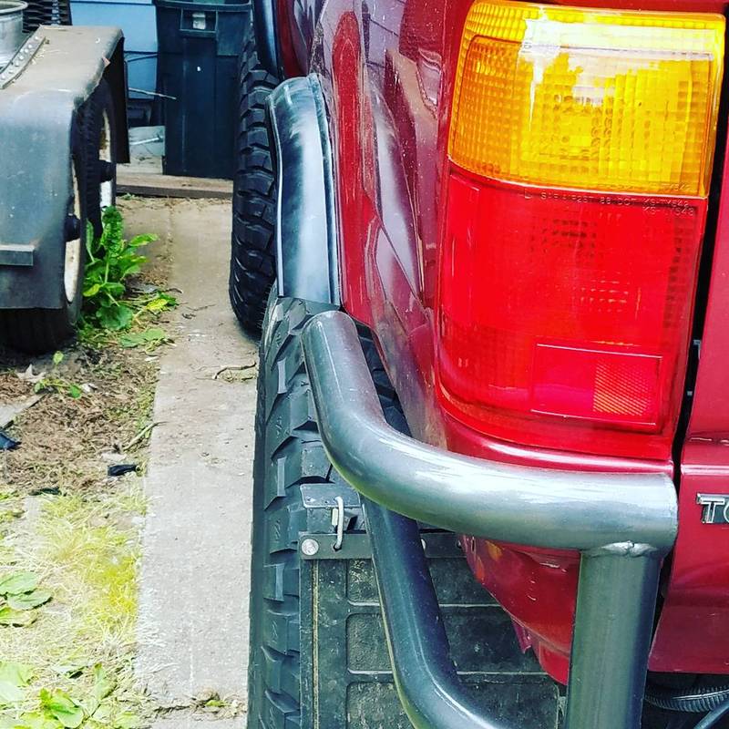

On to Operation Keep the Law Happy part 2
Added some flexible rubber fender flares compliments of Amazon prime

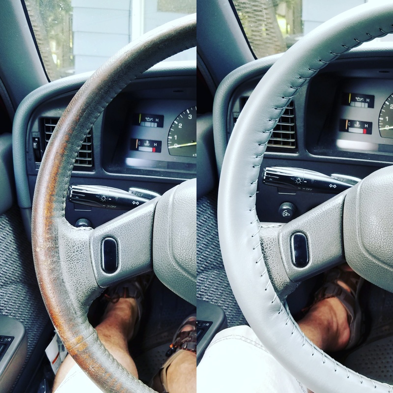

Also pulled the steering wheel cover off and found some nastiness, found a good deal on the Wheelskins cover

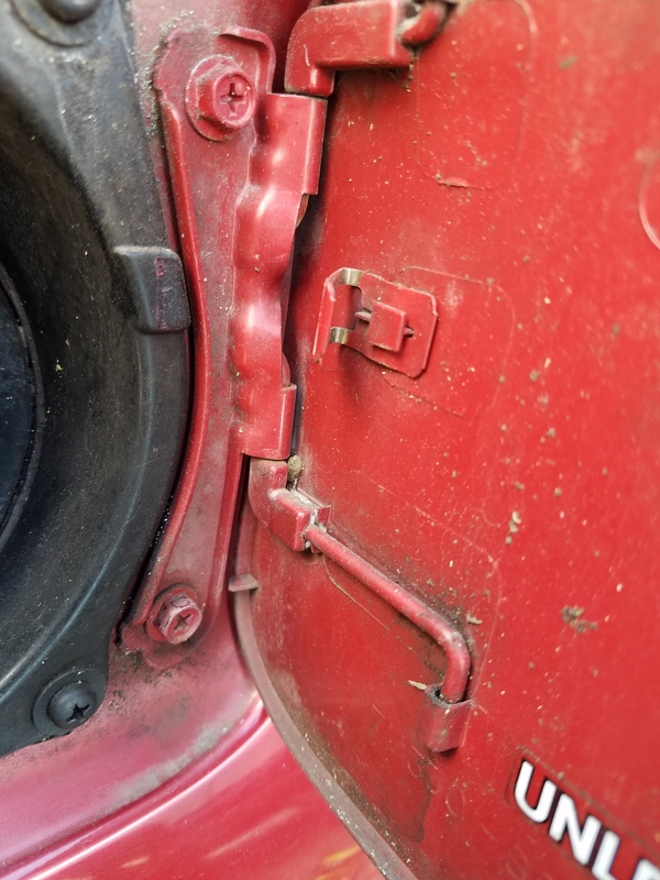

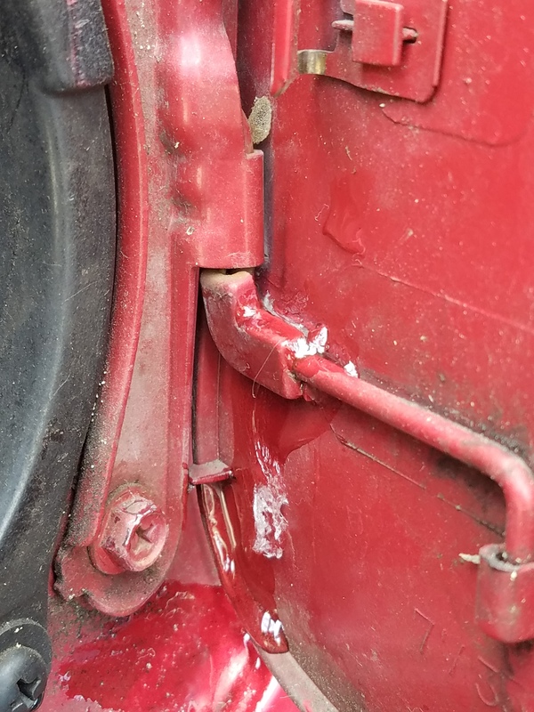

Went to get gas and the gas door wouldn't open. Popped it open and found the lower hinge mount had popped lose, slapped some epoxy in there and clamped it, works like a charm ..for now
wiped up the excess, looks like crap but who cares on the gas door

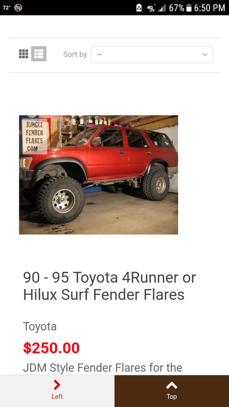

So the missus agreed with me that the flares came out looking like crap so got the go ahead to order a set of flares
https://www.junglefenderflares.com/t...er-hilux-surf/
Should have them in time for a Father's day install

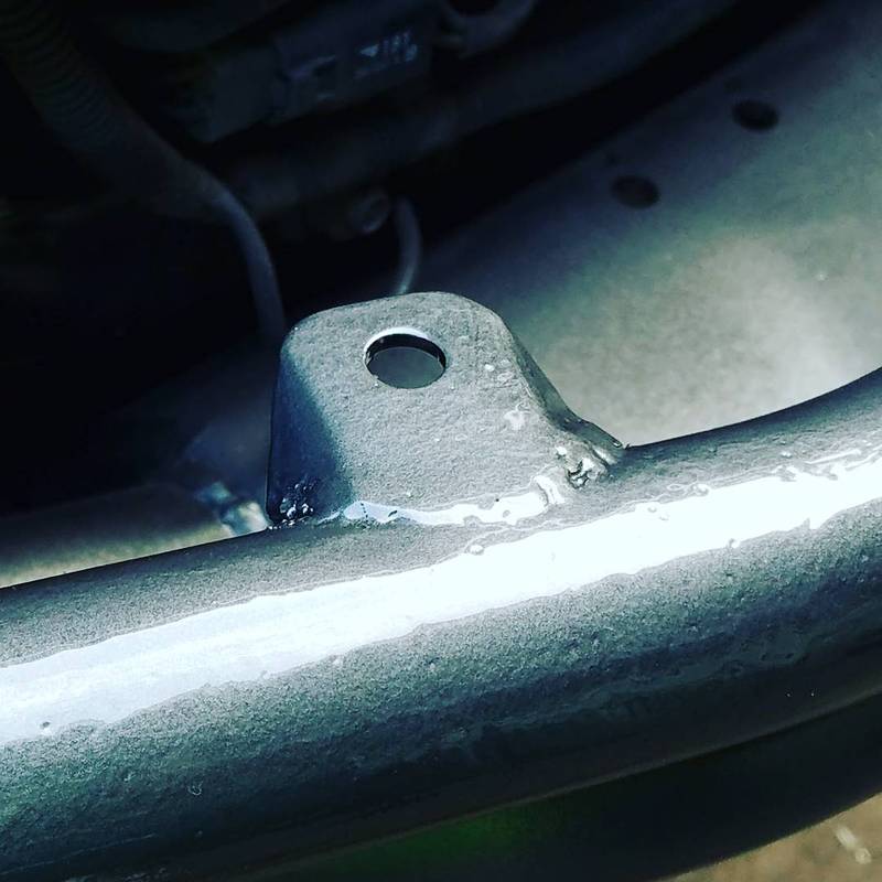

I busted out my $64 Harbor Freight Booger Splatterer (aka flux core welder) and used electronic snot to mount some light tabs

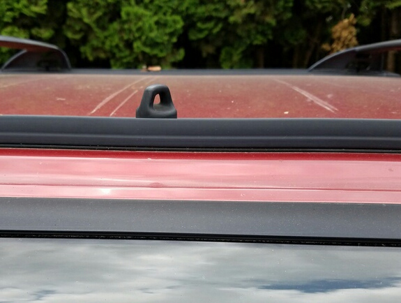

thanks Tony, I tried to find out about the paint on their website but did not see anything. I guess I will find out in a couple of weeks.
Was trying to find a simple way to sort of hide the body line that was opened up when I swapped bumpers..dunno but it so have to do
