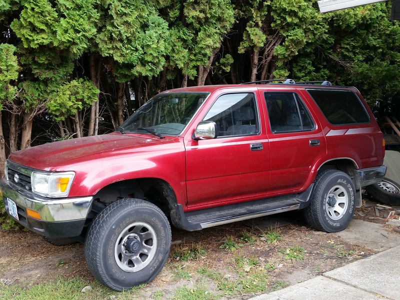

dropzone 09-02-2015 10:07 PM
1 Attachment(s)
not much of an update but since I forgot to post a pic of the driver's side
Attachment 118937

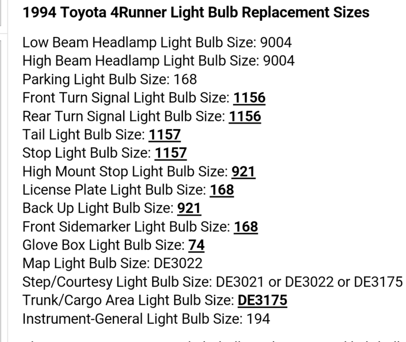

1994 4Runner Bulb Reference Chart
Attachment 118880
